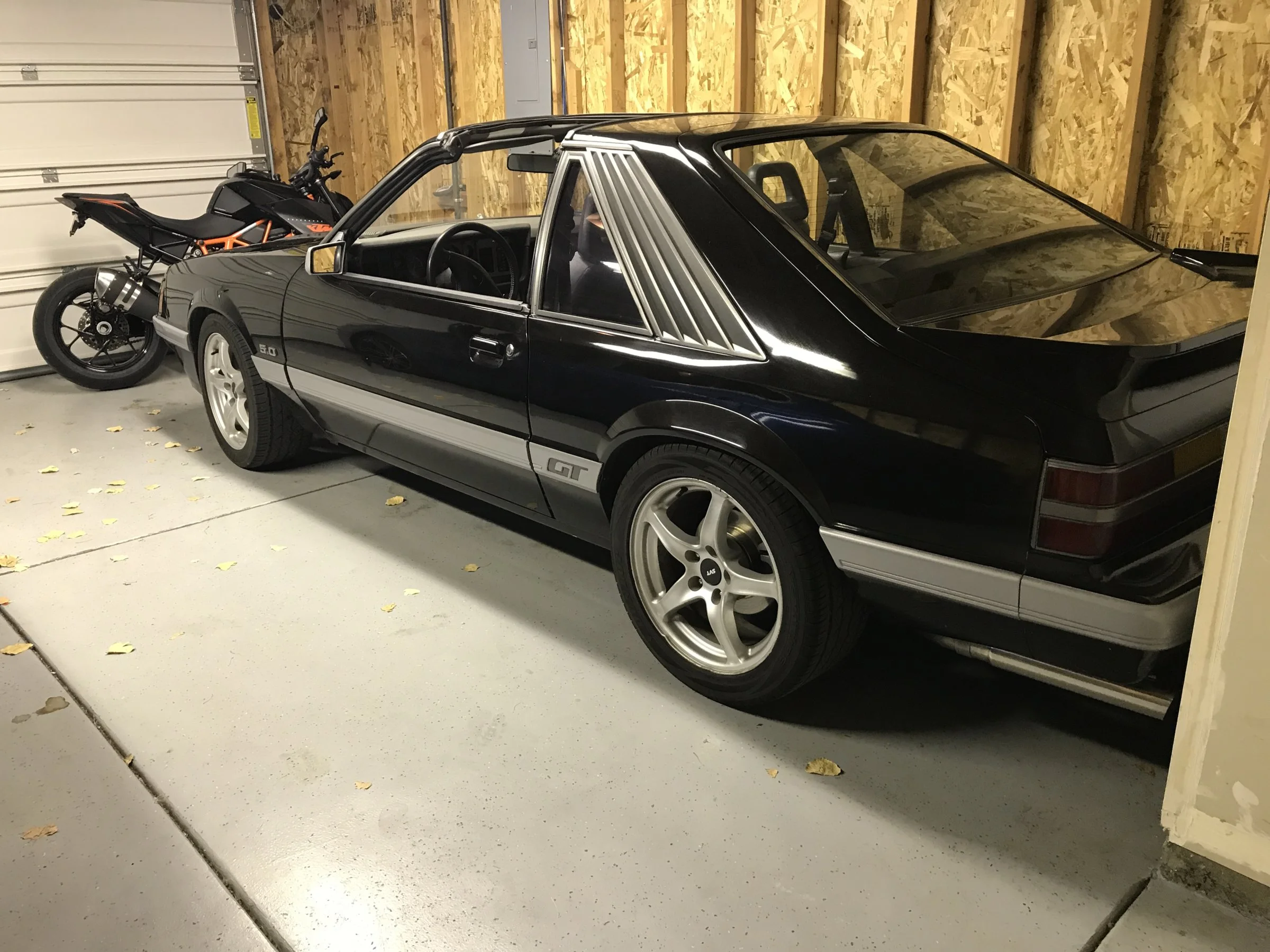

I finally used my fender roller!
Was rubbing a tad when the tank was full and over :poo:ty roads, I liked the stance so I rolled the lips vs raising the rear. Attempted to also get an alignment but was turned away ( no appointment ) I should have known.
Finally washed it, and it is raining. Looks pretty good but could use a paint detail/buff

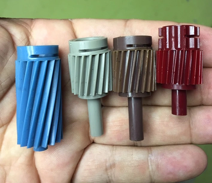

interesting, i never knew that different years had different internal drive gears. LMR calc says I have a 17 and need an 18, for 15 bucks its worth a shot!
I am assuming this is the stock 85 T5
245/45/17 rear end
3.27s
You can try it Joe but likely the new 18t plastic gear is going to disintegrate just like my 21t did. Maybe it'll last a little bit longer than mine :shrug: I stuck the stock plastic gear back in and now I use my phones GPS to get my mph
But that throws the odometer off. That would drive me absolutely nuts.
My 21 tooth, and current 20 tooth gear are doing fine. Key is to skip LRS, track down the Ford oem part number and see if the local dealer can get you one.
Does it make a big enough of a difference in strength? The 21t gear has such thin teeth on it which makes it too weak to hold up to the task. Mine maybe lasted 400-500 miles.
Yes, the Ford gears look much beefier than the aftermarket LRS versions. I'll see if I have part numbers to see if the local Ford dealer has some. My purple 21 tooth I got from Ford for my AOD lasted 40-50k miles, and the red 21-tooth went 1k before I swapped to an LRS 20-tooth for my new tire size.

Red 21-tooth (manual) C4OZ-17271-A
This may be OEM (say's it's a Ford part), but I would try a local dealer first to get one that actually comes in a Ford bag.
Amazon product ASIN B000O0V4JWView: https://www.amazon.com/Ford-C4OZ-17271-A-GEAR-DRIVEN/dp/B000O0V4JW
For other gears, check this chart out
https://performanceparts.ford.com/download/tipsPDF/SpeedometerGearUsageChart.pdf
If you notice, they only give a partial p/n. The middle digits are all the same, so see above. "17271" is the constant. So for a blue 18 tooth manual gear the part number would be C0DD-17271-B
Unsure if ford has discontinued any of these though

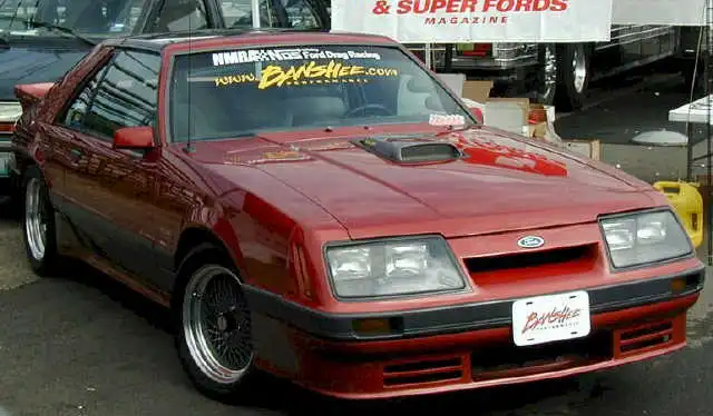

Id be tempted to install one of these:
...but alas, this shaker has been gone a long, long time.
If anyone ever comes across one, snatch it up, even if you don't intend to use it.
