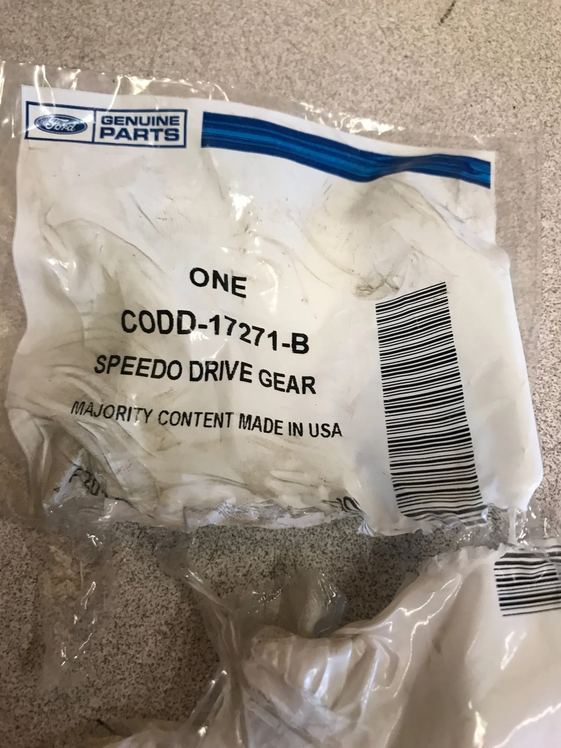

Oh so it seems LMR is selling Ford speedo gears

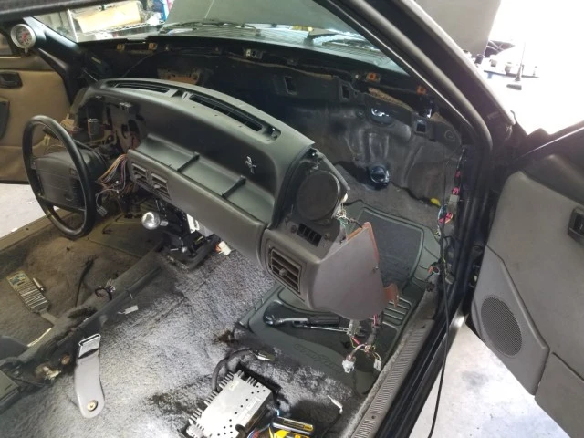

The heater core was bypassed when I got the car so I assume I will need to pull the dash to do a heater core replacement,I have not done this before and I can say I am not looking forward to it. Is there a preferred heater core to use? I don't want to do this again.

Pulling the dash is not that bad. I read all the "horror story" posts about it and was a little scared to tackle mine. Once I did it I realized its nothing more than some nuts and bolts. I literally had the dash out in under an hour. There are some good videos online that can guide you. For the AC, I would just buy new parts from a parts store, not sure the kit from lrs is cheaper. It might be, but I found the parts I got from Orielly was better for me....but I pay triple the shipping that most of you pay.

Little late to reply but did an 86 and it went ok. Pretty similar to the 87+ being a PITA but plan a day with a friend and it’s 2-3 hour job.
