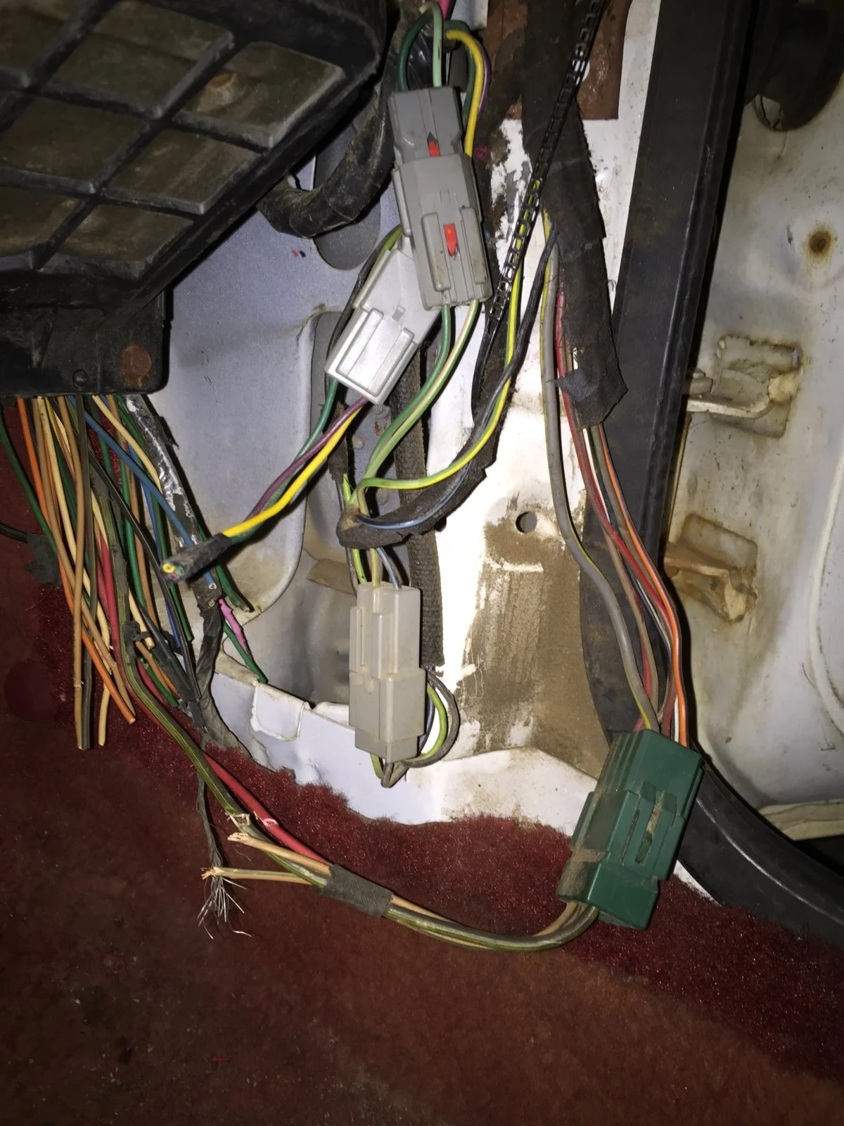

I bought a nice mustang, cranks but no start, and realized pretty quick someone cleanly cut the ECM out, along with the pigtail. I presume that it was stolen, but maybe the owner needed some fast cash and that was simple enough. regardless, what ECM actually belongs in the car? I went ahead and ordered the harness since the pigtail itself was roughly the same price. It's a 1987 5.0 hatchback with the AOD transmission

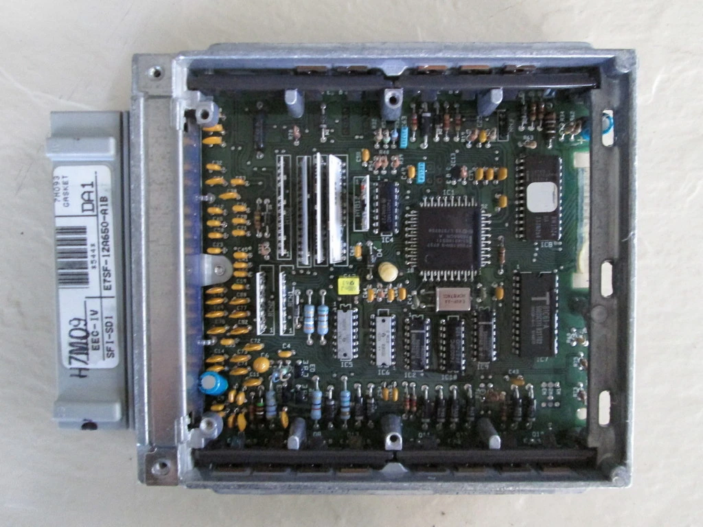

If you had the 5-spd, my DA1 for 1988 would work. It's for sale to anyone who needs it.
jrichker's list is missing the '88 year.

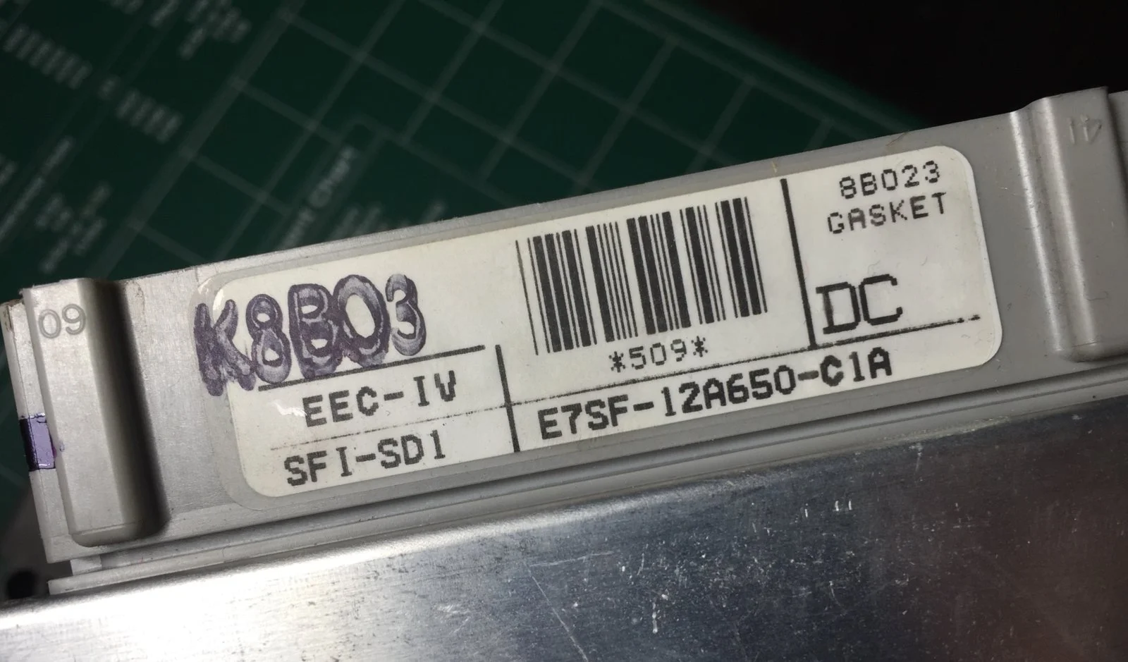

I tested it, and the DC does work. one thing that i didn't quite notice until i went to go put the ECM in, it actually says it on the mounting bracket which one belongs, a big ol DC printed on there. my dumb*** didn't even bother to look.

This list has an error.
1988 5.0 AOD is a "DC" Computer.
Part number E7SF-12A650-C1A
I took this one out of my car
