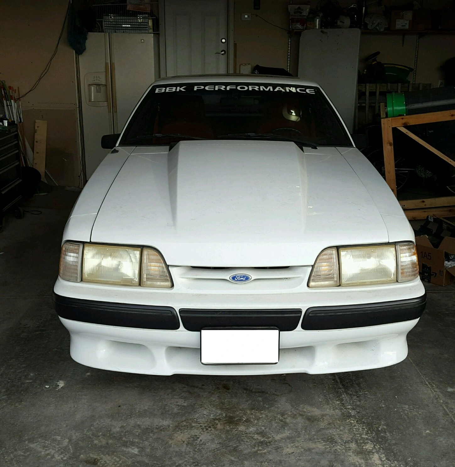

As you will see by the picture, the pump took care of the problem and I was able to move my Mustang with ease...mostly. It has plenty of power and no hesitation/stuttering. The only problem remaining is it doesn't idle at all and we found early on in the troubleshooting that the throttle air bypass valve wouldn't actuate at all. It was tested while still attached to the wiring with the car running and completely removed and running 12v directly to it, no movement at all. I suspect this is the problem with my idle, agreed?
