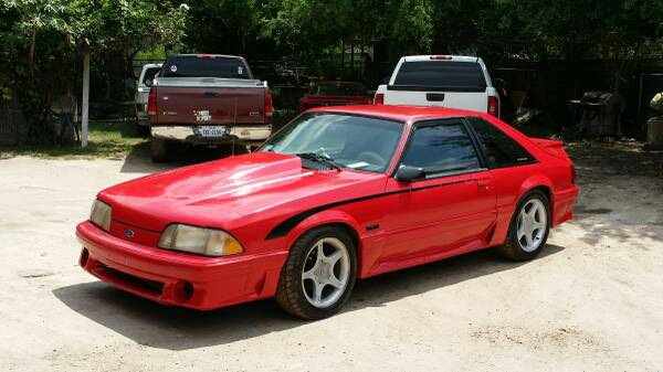

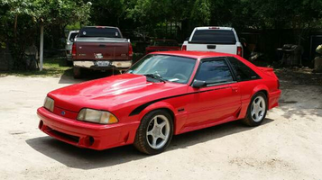

Post up pics of entire car. If lowered, you might want to run a slightly narrower tire. 235/45/17
Pre-91 cars have smaller front fenders so there is sometimes clearance issues. If stock height, stick with 245/45/17.

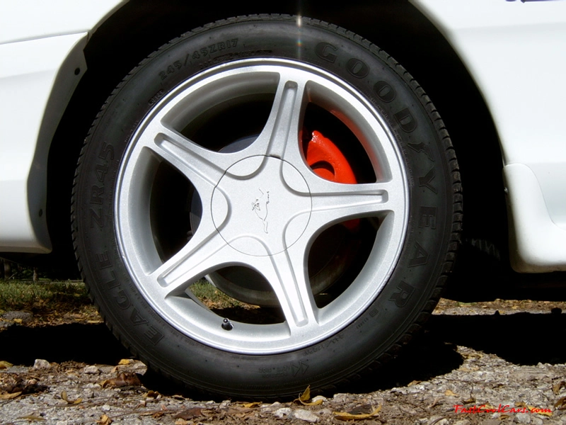

Those are 99-04 mustang GT wheels. 17x8

The front kinda looks a tad bit lower in person but seeing as how there are all different size tires on it I can't tell. But all center caps fit correctly.

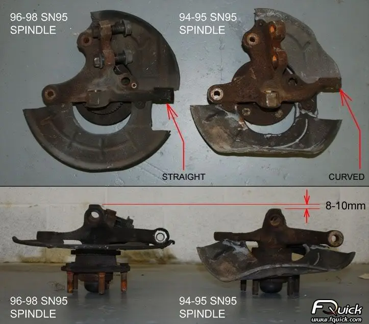

What they are saying is, on the front wheels, the year spindle used on the swap may dictate front rim selection. If you turned the wheel all the way left then right and took pictures of the spindle we could most likely tell you. The spindle is the piece the wheel and brake mounts to the body

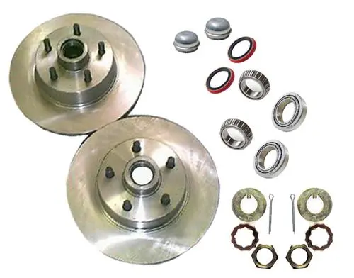

You may also have a 5 lug rotor which just replaces the brake rotor with 5 lug vs 4 lug. it is easy to identify as the brake rotor is both the brake ring and hub, where as the newer ones is the brak ring but not the central hub
rotor has no hub its part of the spindle, see pics below.
No spindle swap just 5 lug conversion rotors below
Rotor does not have "hub" in the 94+ spindle scenario

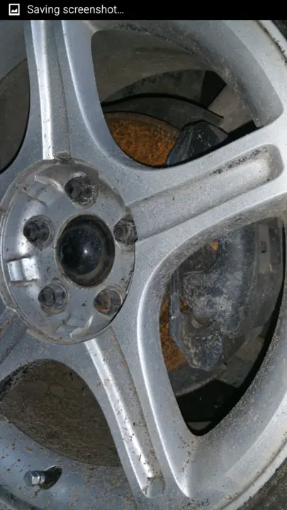

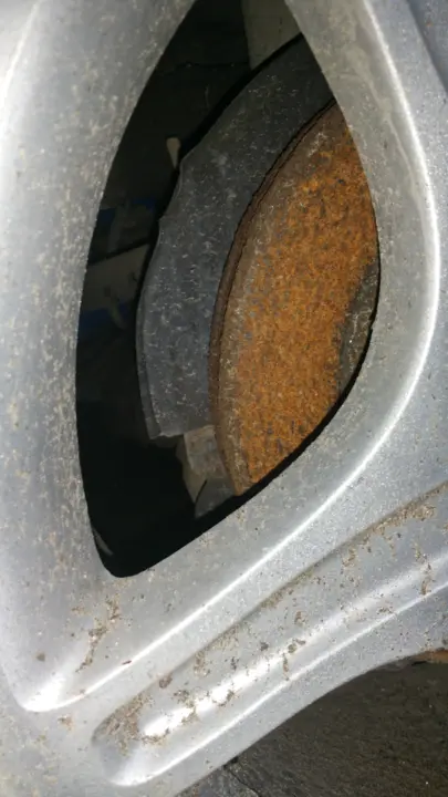

Thanks for your very detailed answer I appreciate all the help because he has a passion for this so I'm just trying to understand a little more about it! Its hard for me to tell with the wheels on and because I'm guessing these have been on so long the look rusty. So it may be best to change that too while I'm at it???? I'm not sure but these are the best pics I can get hopefully you may be able to tell?
Screenshot_2015-06-18-19-56-10.webp Screenshot_2015-06-18-19-58-58.webp Screenshot_2015-06-18-19-56-12.webp
Disagree. Have seen pics of guys cutting circles out of the center cap to let the dust cap of the 5-lug conversion rotors poke through. The are concaved in.

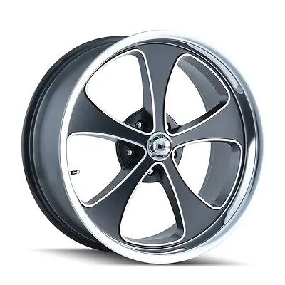

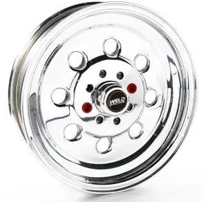

We were watching a car show and somebody had redid an old Mustang and I casually brought up what he would like if he got the mustang he was wanting he said he didn't much like the cobra style wheels or stock wheels...he said he likes skinny tires in the front with a little smaller rim and bigger thick fat type of tire in the back with a little bigger rim...he said something like 17x6 fr and 17x9 back??? The wheels picture are not exact because it was a lot to take in all at once haha 1990.webp $_1.webp wld-9054030_1011.webp
