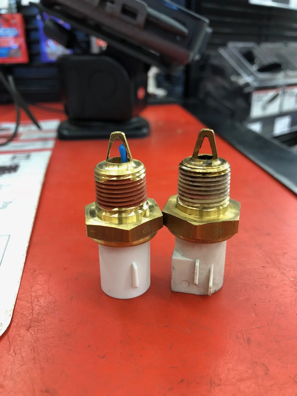

either there is a valve issue or you need to be sure that there is no loose connections anywhere also the MAT sensor is not reading at all. this could be a bad electrical connection.
Installed new IAT sensor drove the car some, it seemed lean at idle and driving 14.6-15.9 so I enriched it a bit to get idle closer to 13.2-13.4. I notice a lot of bucking and stumbling at partial throttle 1/8th throttle range smooths out at 1/3 to 1/2 throttle. I also seem to have to use a lot of throttle and feather the clutch to get it rolling or its easy to stall. Not sure if IAT sensor affects AFRs that much hopefully I didn't get a bad one from the store? On the plus side.....it drives!!!!!!
