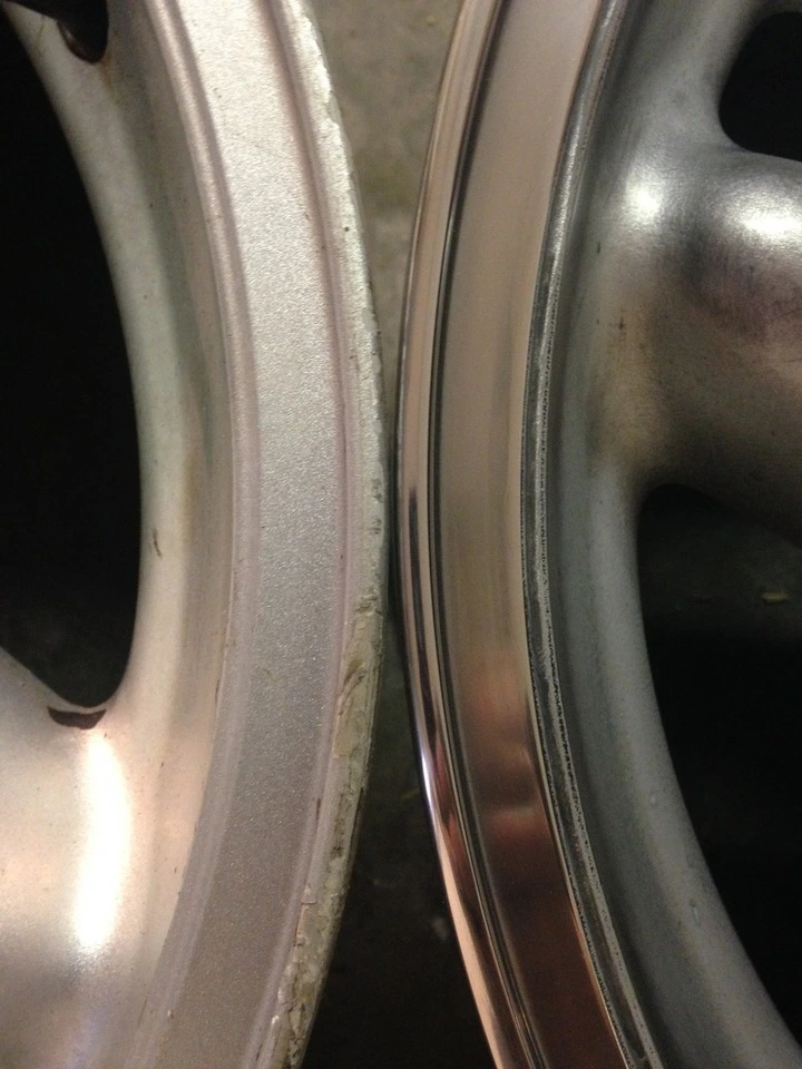

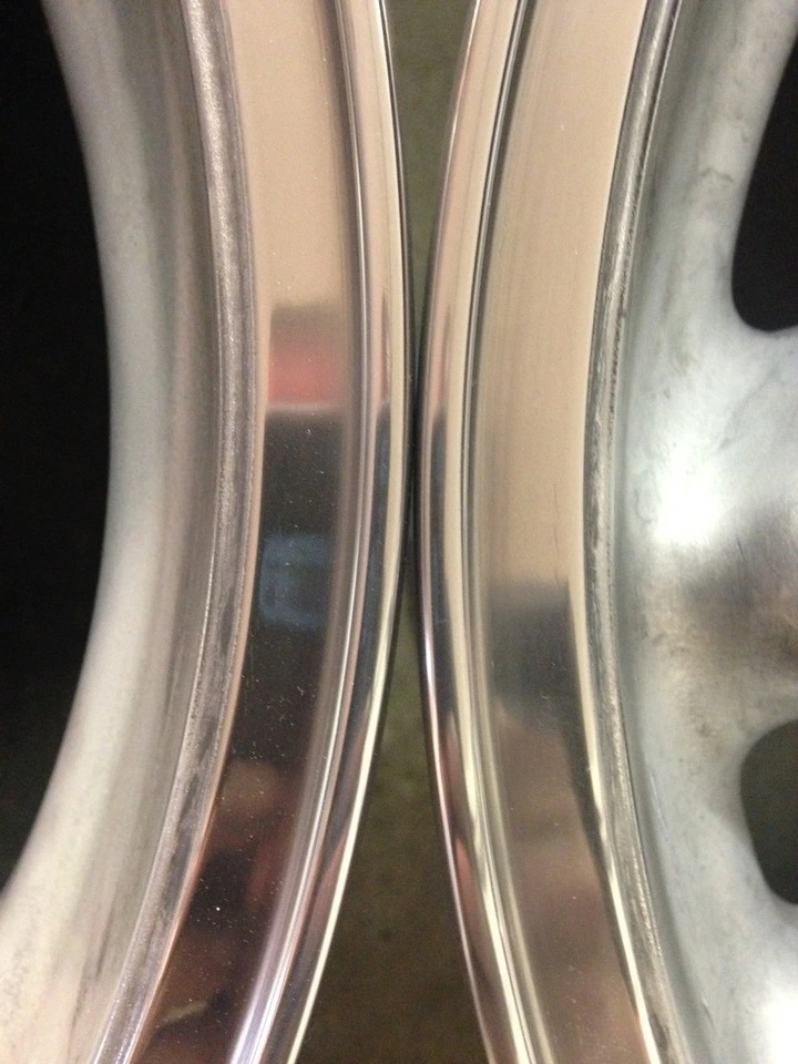

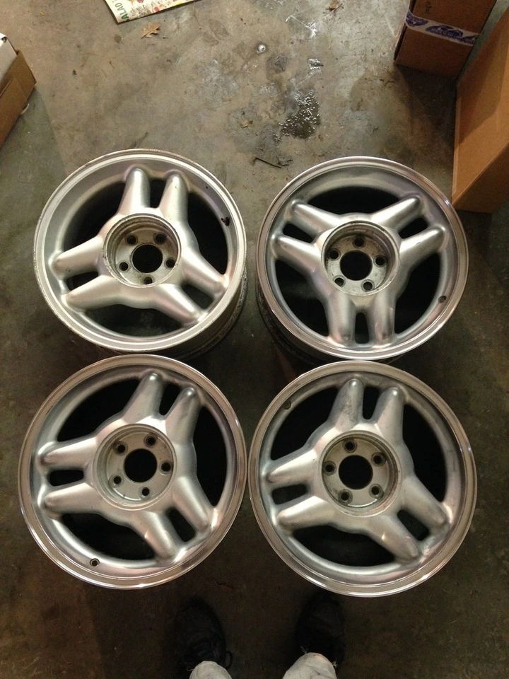

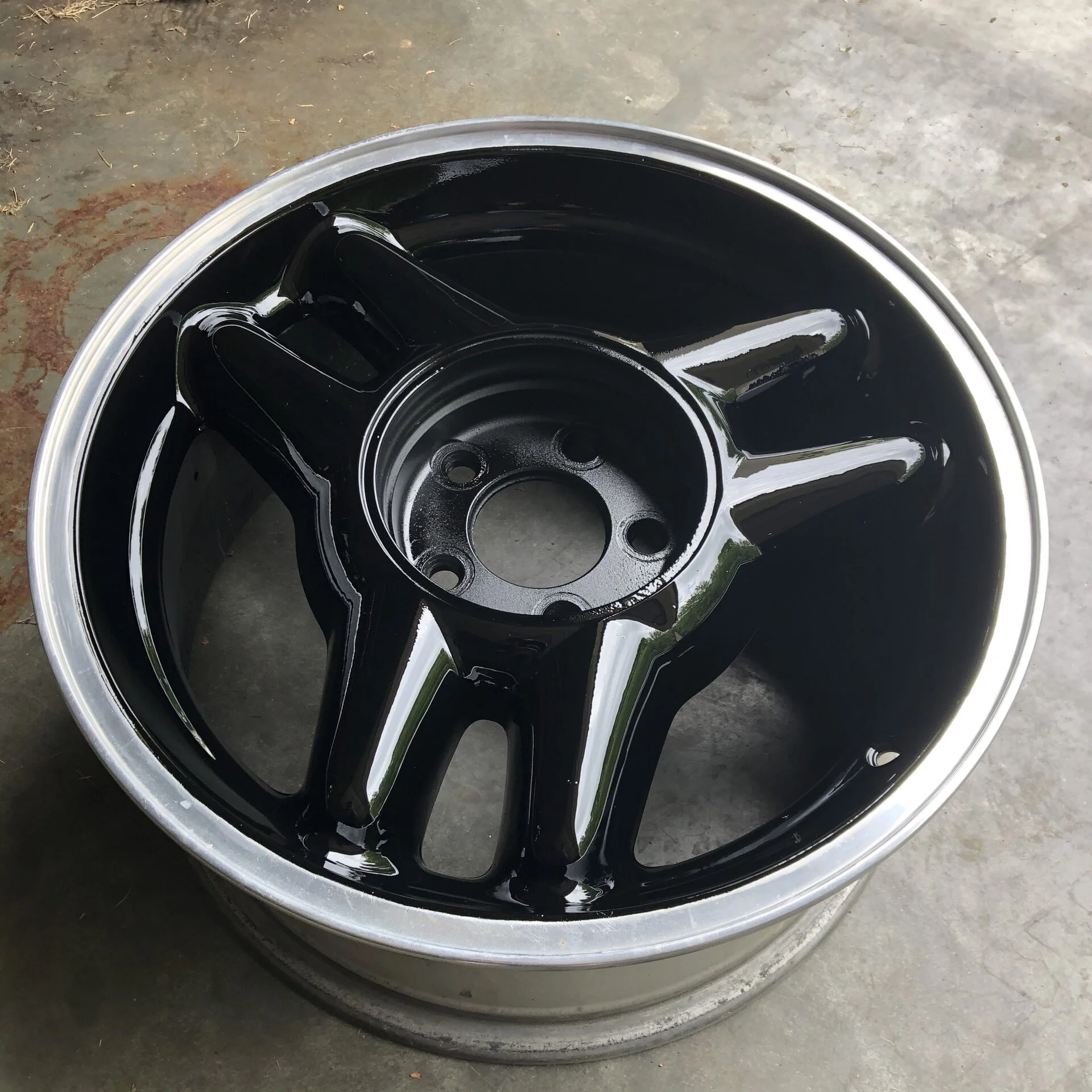

Today was basically a redux of last Sunday. Sand, sand, polish, sand, sand, Polish.
3 of 4 polished up and ready to start painting. Haven't touched the last wheel yet, though. Not going to touch this stuff for a few weeks, but still feels good to make progress.
Comparison shot with the unfinished wheel.

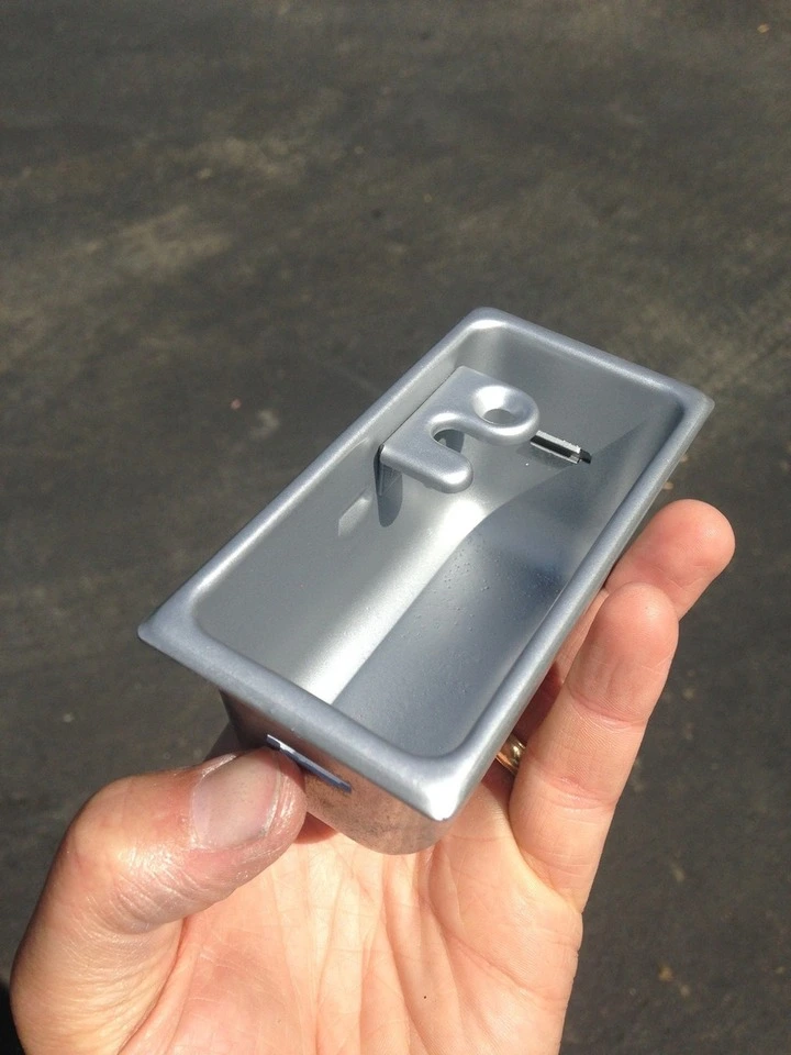

First thing was with the interior mostly painted up and ready, some of the details are still getting worked out. The ashtray was well used in this car, and very rusted, so we sandblasted it and hit it with some silver paint to make it look nice again.

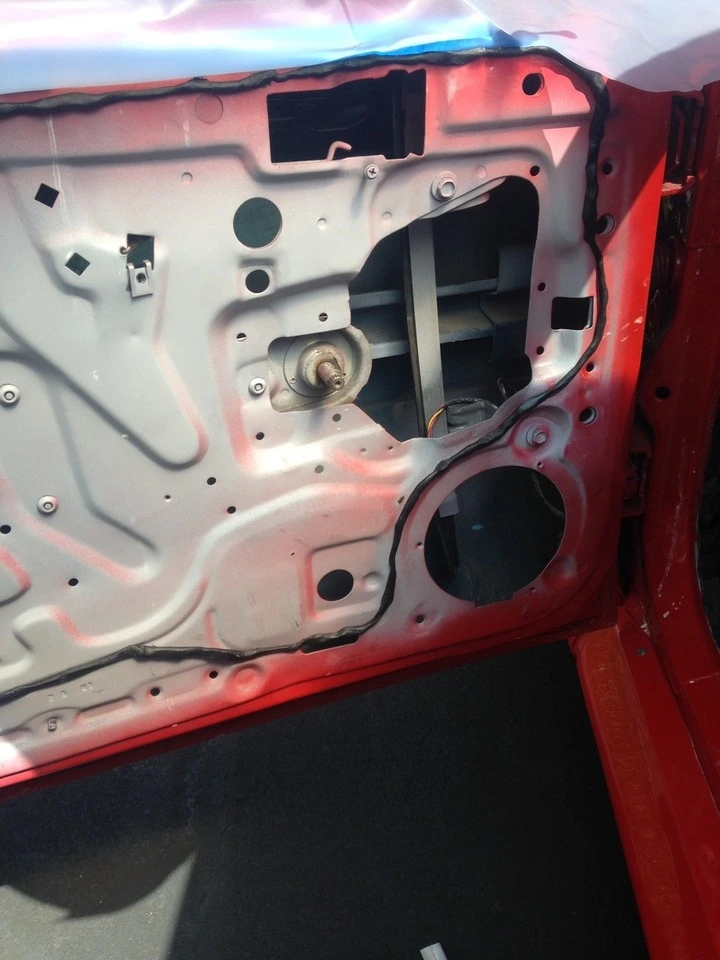

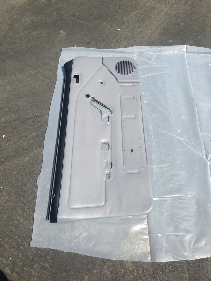

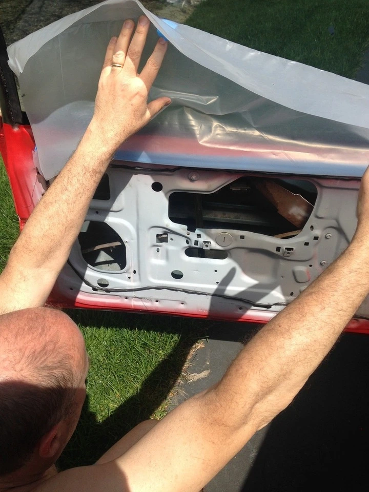

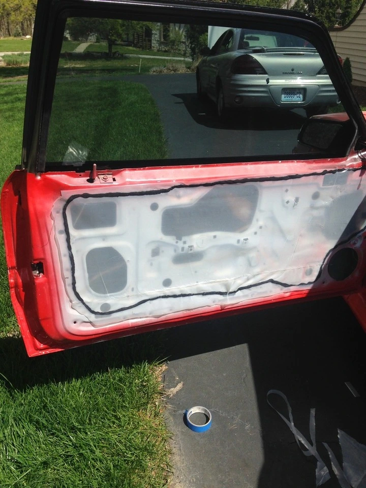

The other thing is fairly minor but kind of neat. The plastic moisture barriers for the doors are long gone, but I didn't really care to spring for another 45 bucks for the American muscle ones. I had plastic sheeting left over from the booth construction,
and decided to make my own.
We mocked up the plastic in the door to trim it to size.
I used butyl tape to adhere it to the door panel so that I can remove and reinstall it without destroying it each time.
And the finished product (less some trimming for the door handles, etc.
I will trace the tape line with a black sharpie on the plastic to guide reinstallation down the road.

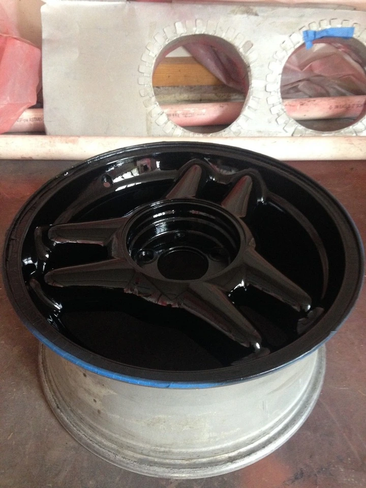

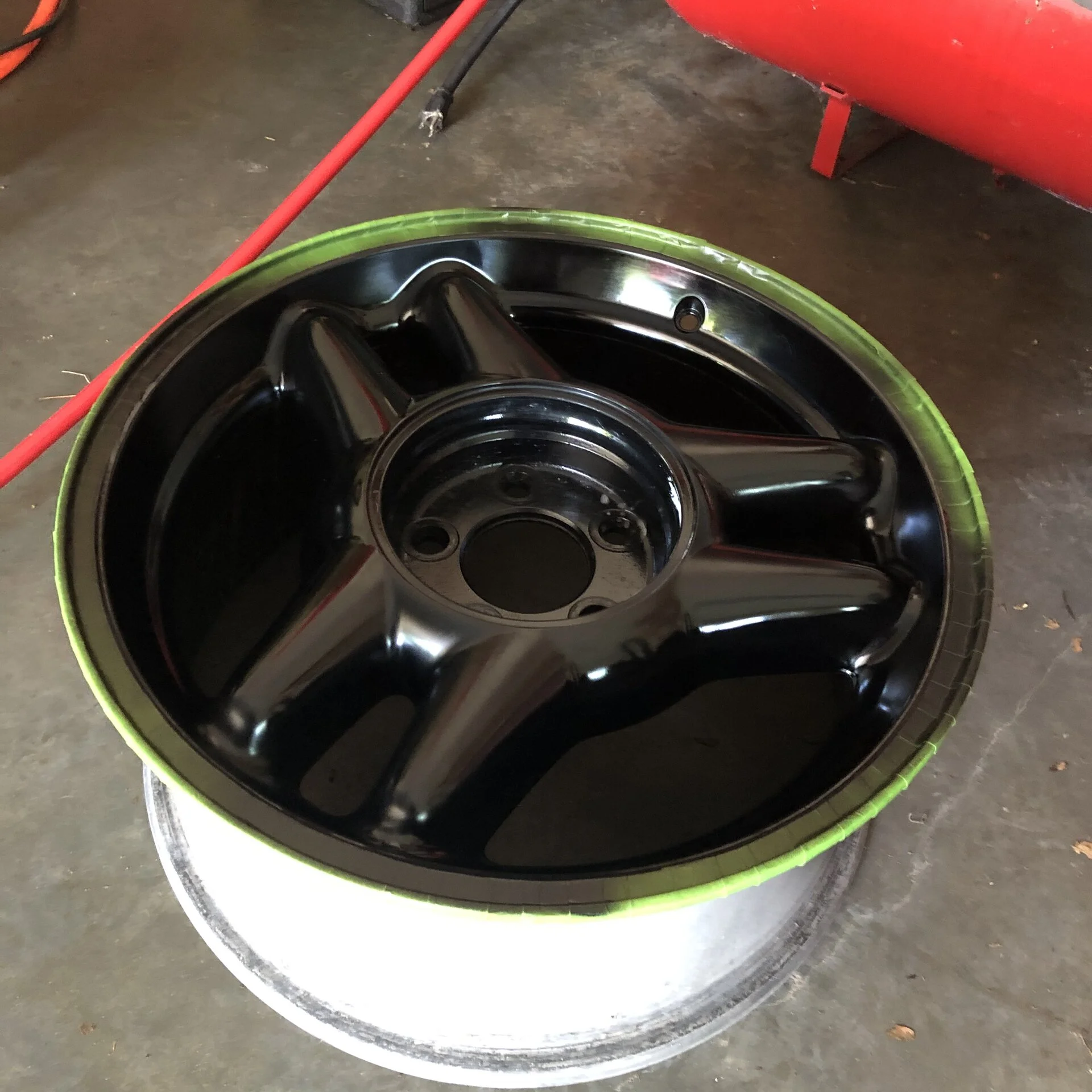

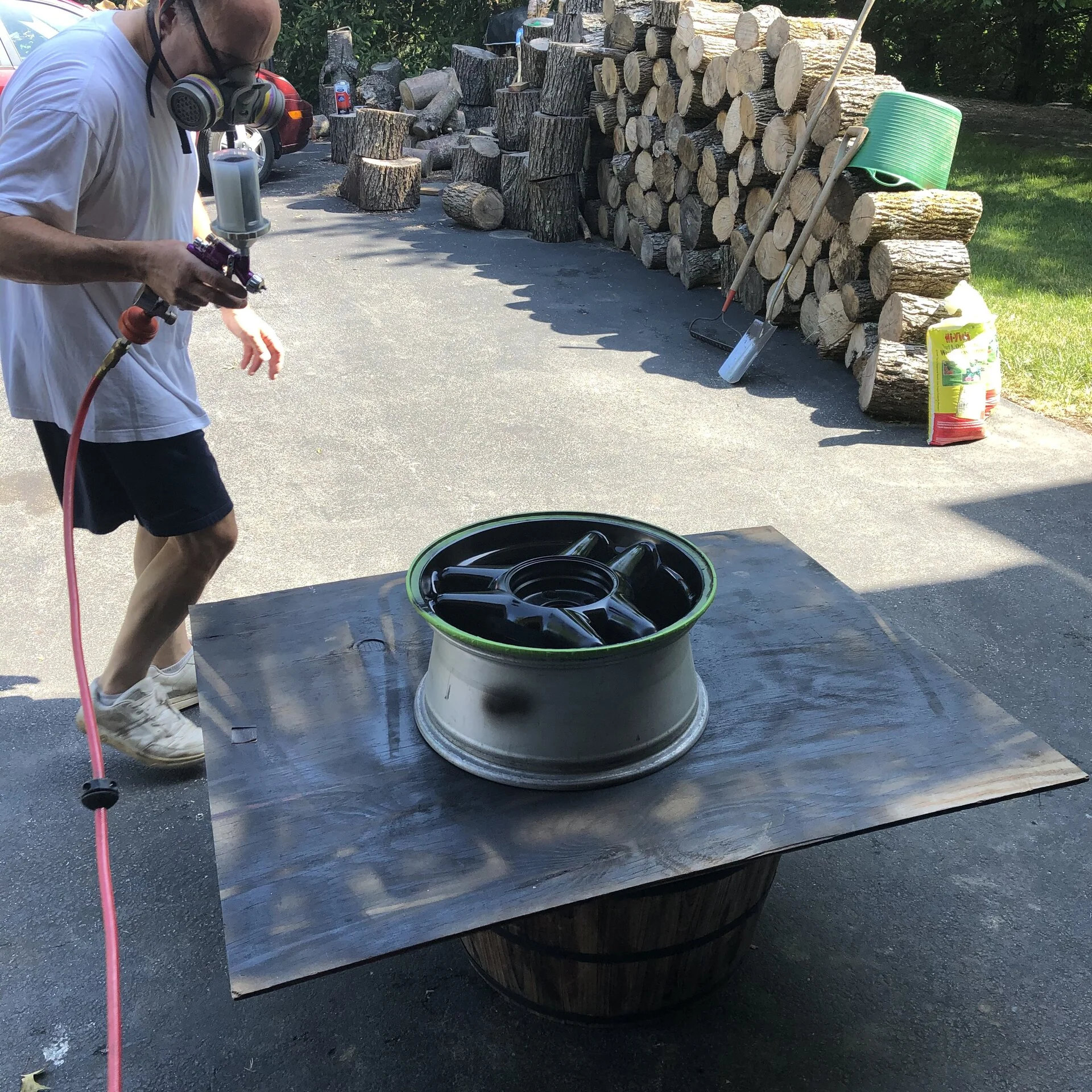

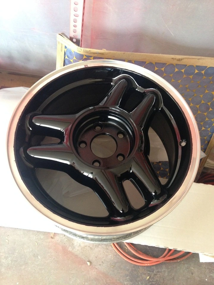

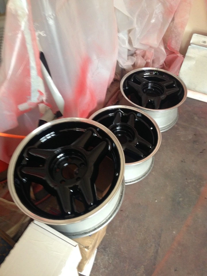

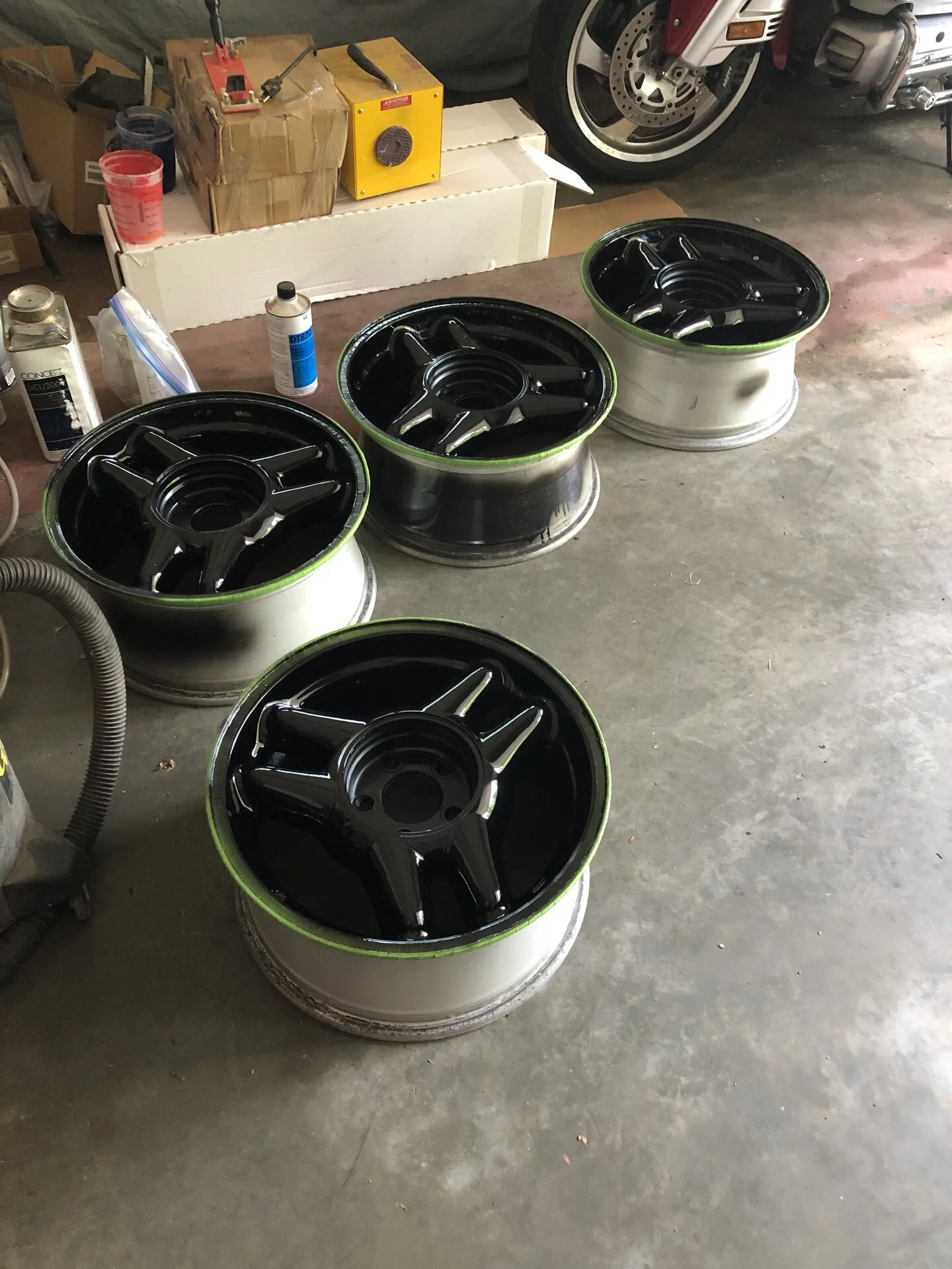

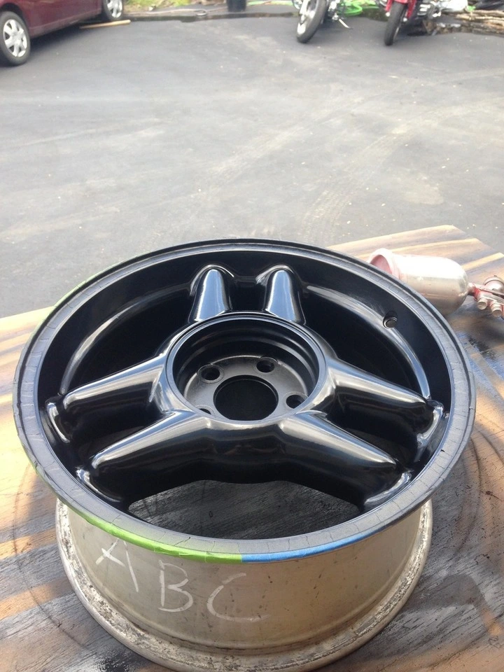

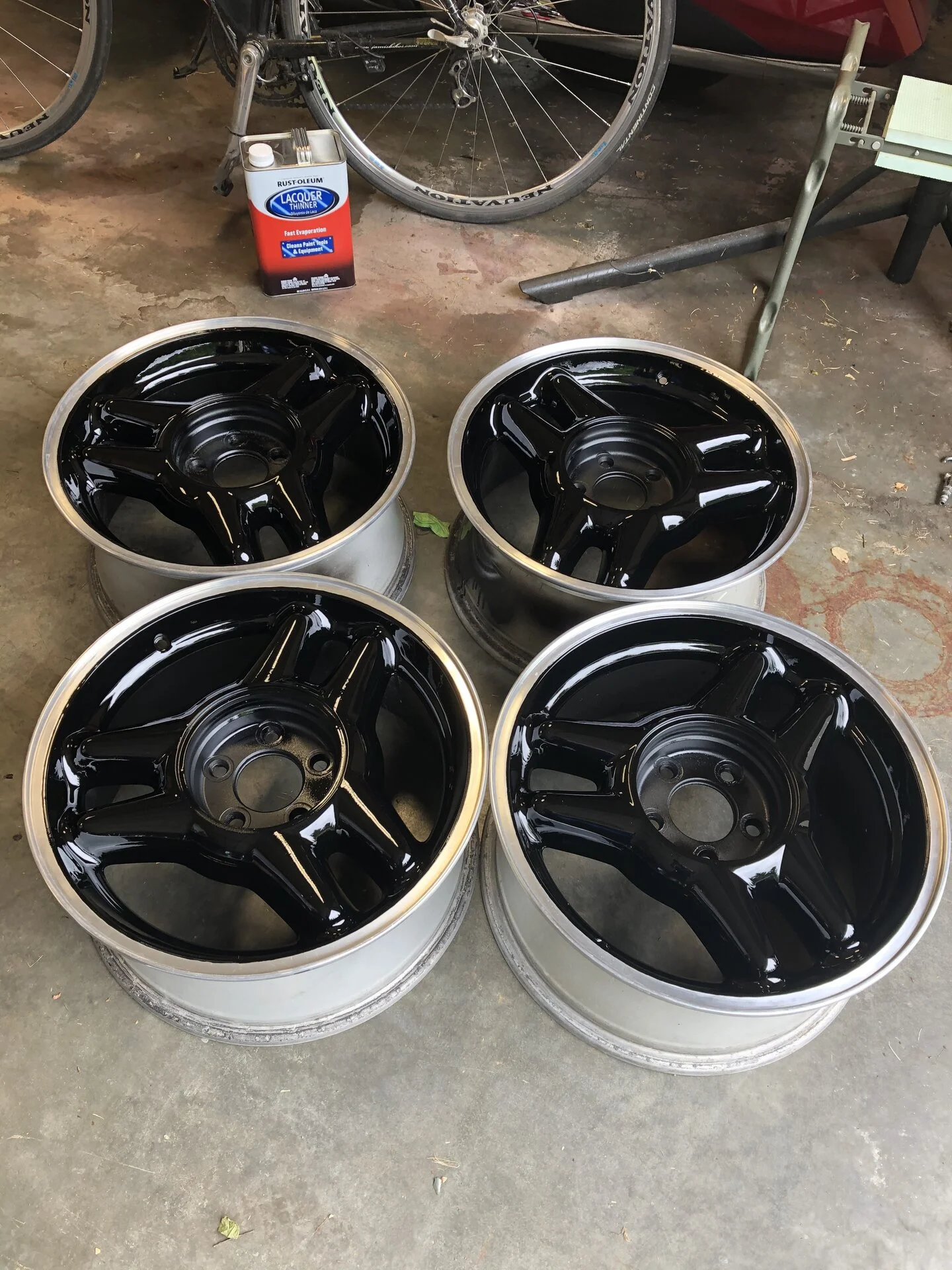

Lastly, we finally got the wheels painted.
Black base coat went down well.
Then we put four coats of clear with a mixture of black base.

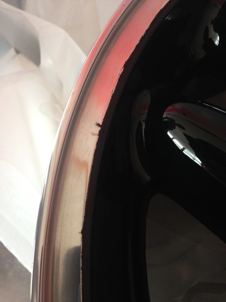

After we pulled the tape off there is some finishing work to do on the edges of the black. We couldn't make a perfect circle with the tape, and were worried that the edge would look imperfect. Hopefully a sanding block held at an angle will smooth it out and make it okay.

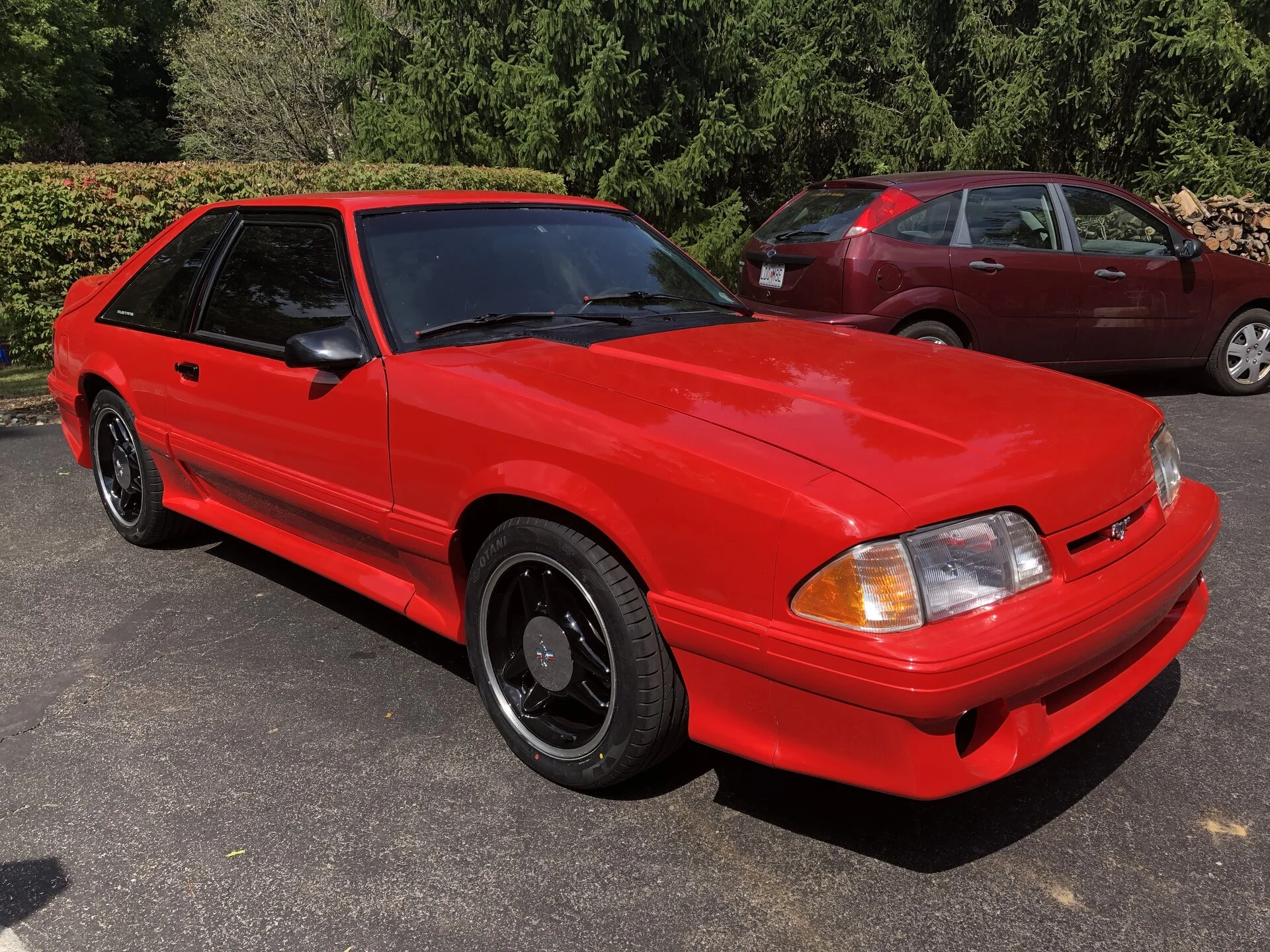

So, got a wedding to go to next week, but hopefully we can get the wheels all finished up the following week so I can get some tires on them. Once those are on, we will swap to five lug and I hope this is the last picture I post with this thing wearing turbines.

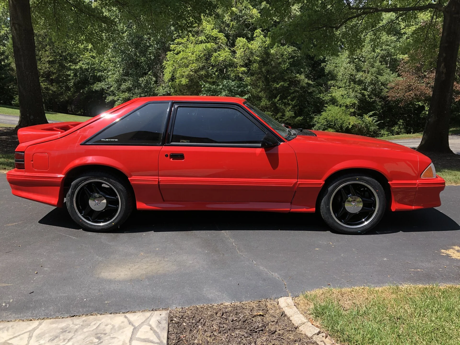

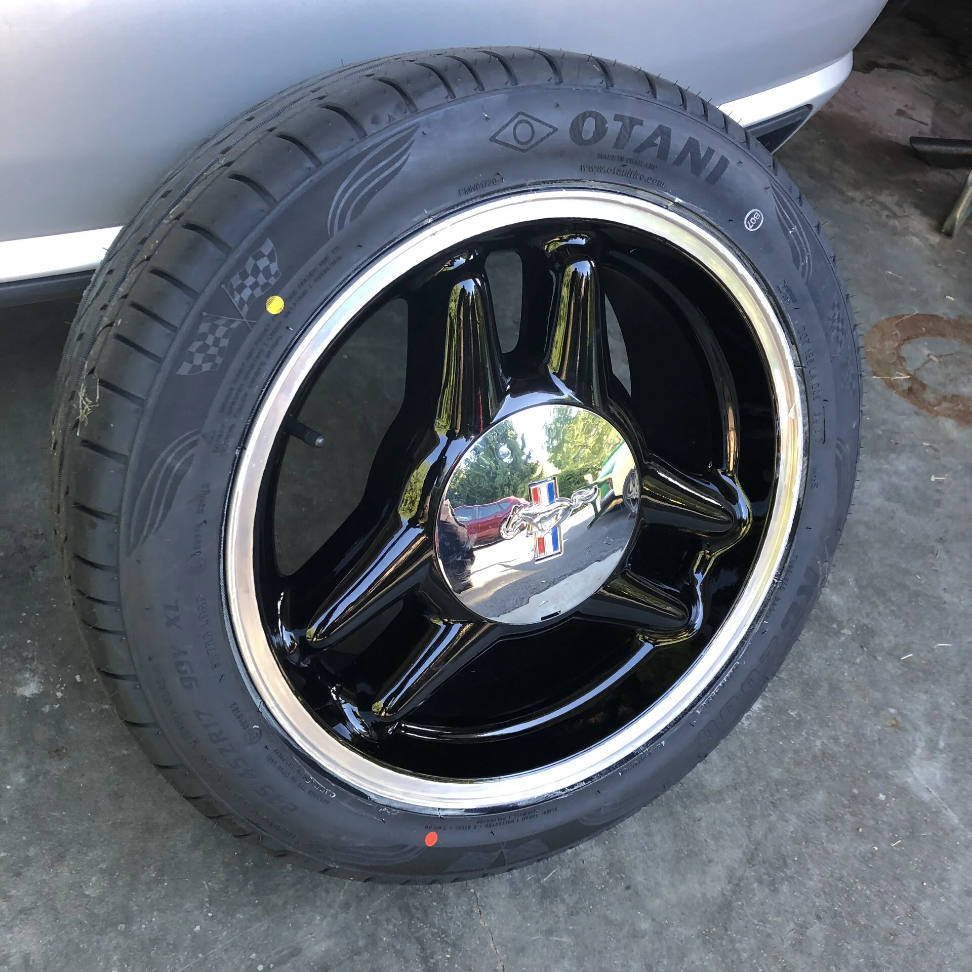

Finally, the wheels are done!
Those came out nice.
Did you find chrome center caps for them?
Thanks!
Yeah, they accept the Chrome Pony centers. I bought a set of 4 a while back for about $100 IIRC, and I test fit them to make sure it would go okay. If all goes well I will have it swapped to 5 lug with wheels and tires installed in August. After that I need to respray the damaged area on the rear bumper cover and I should be good as far as paint and body.

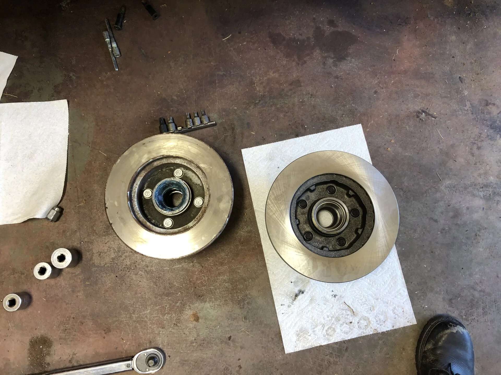

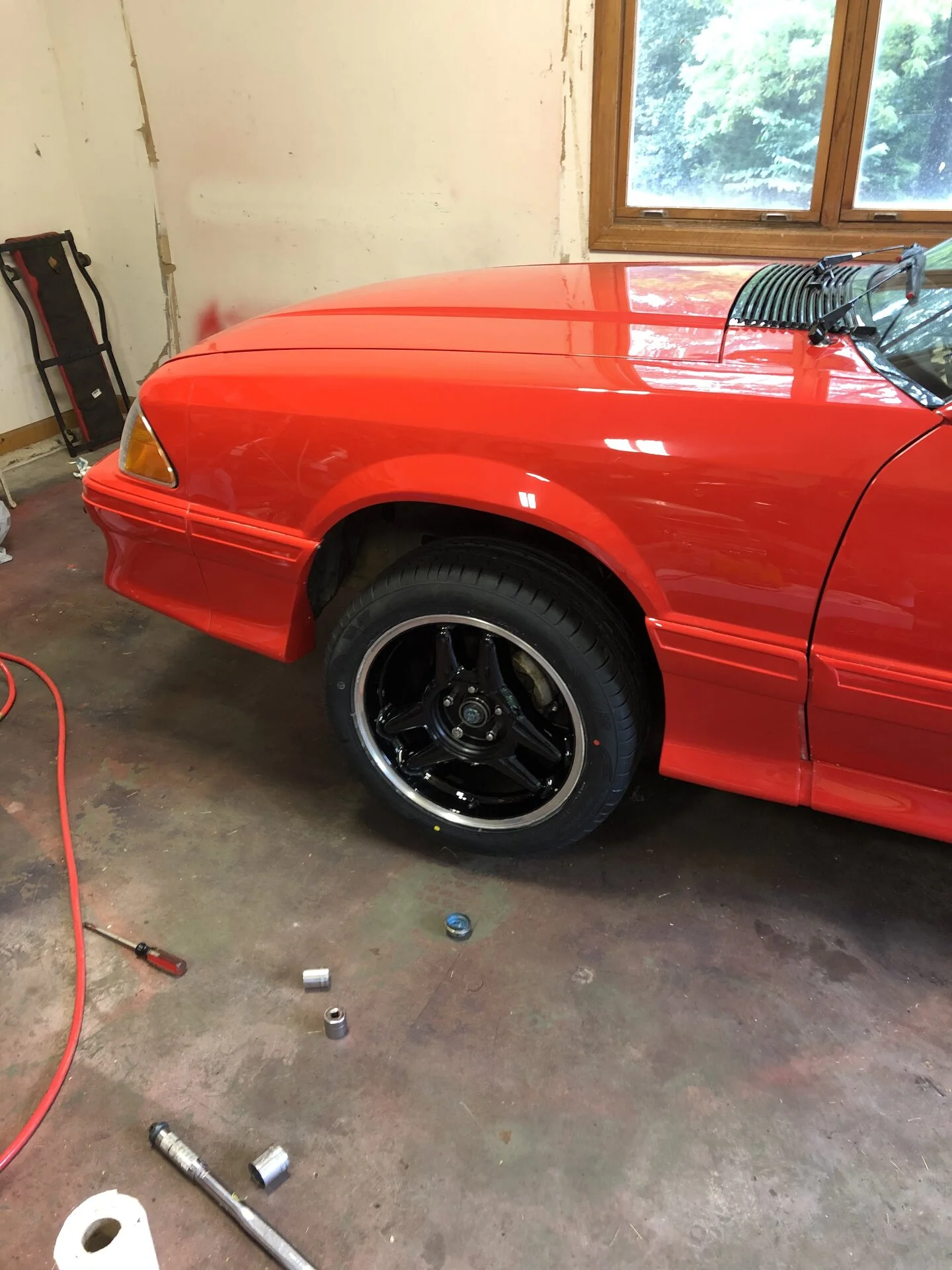

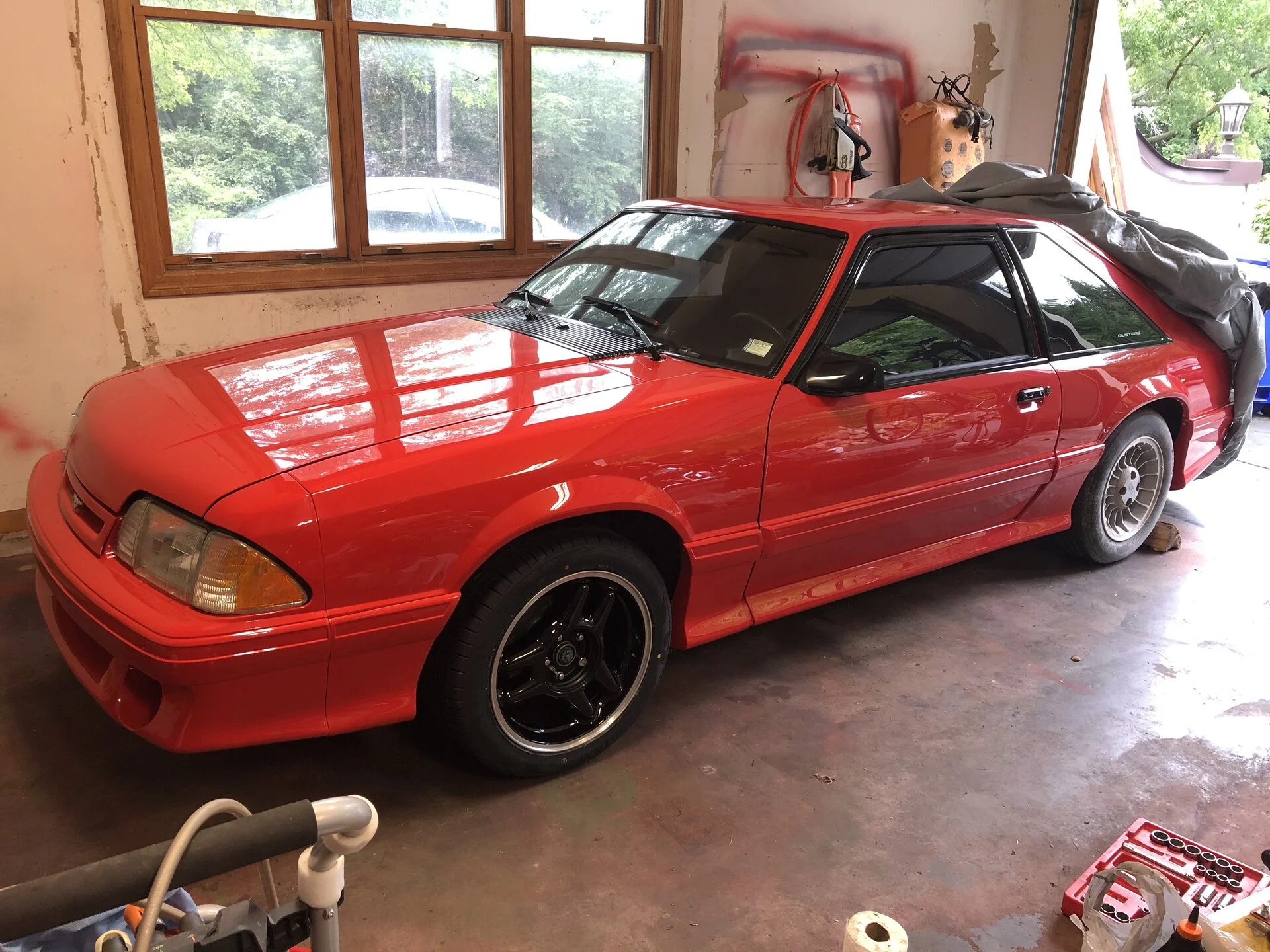

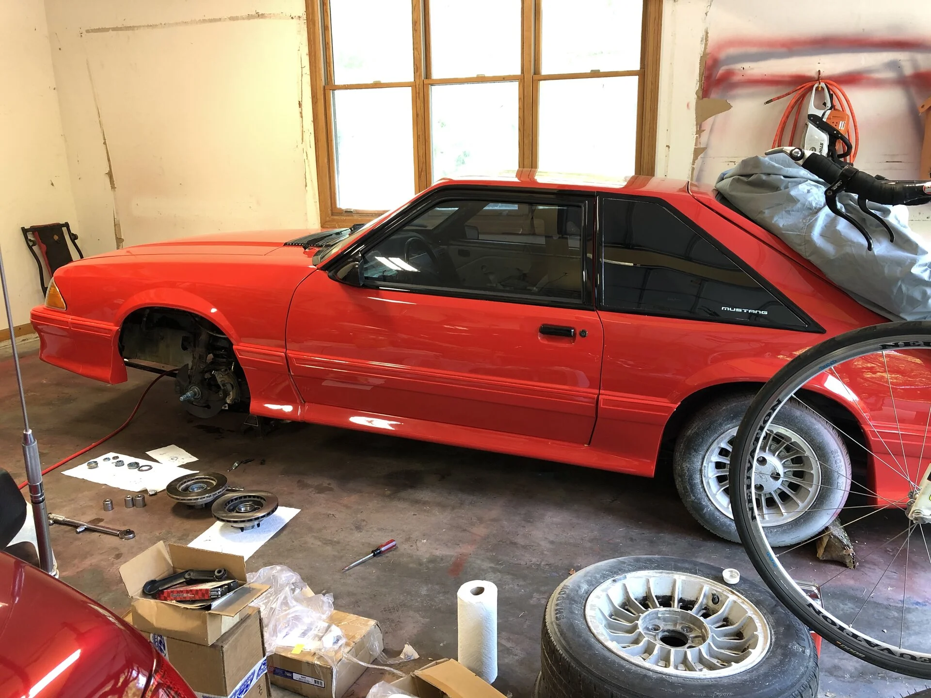

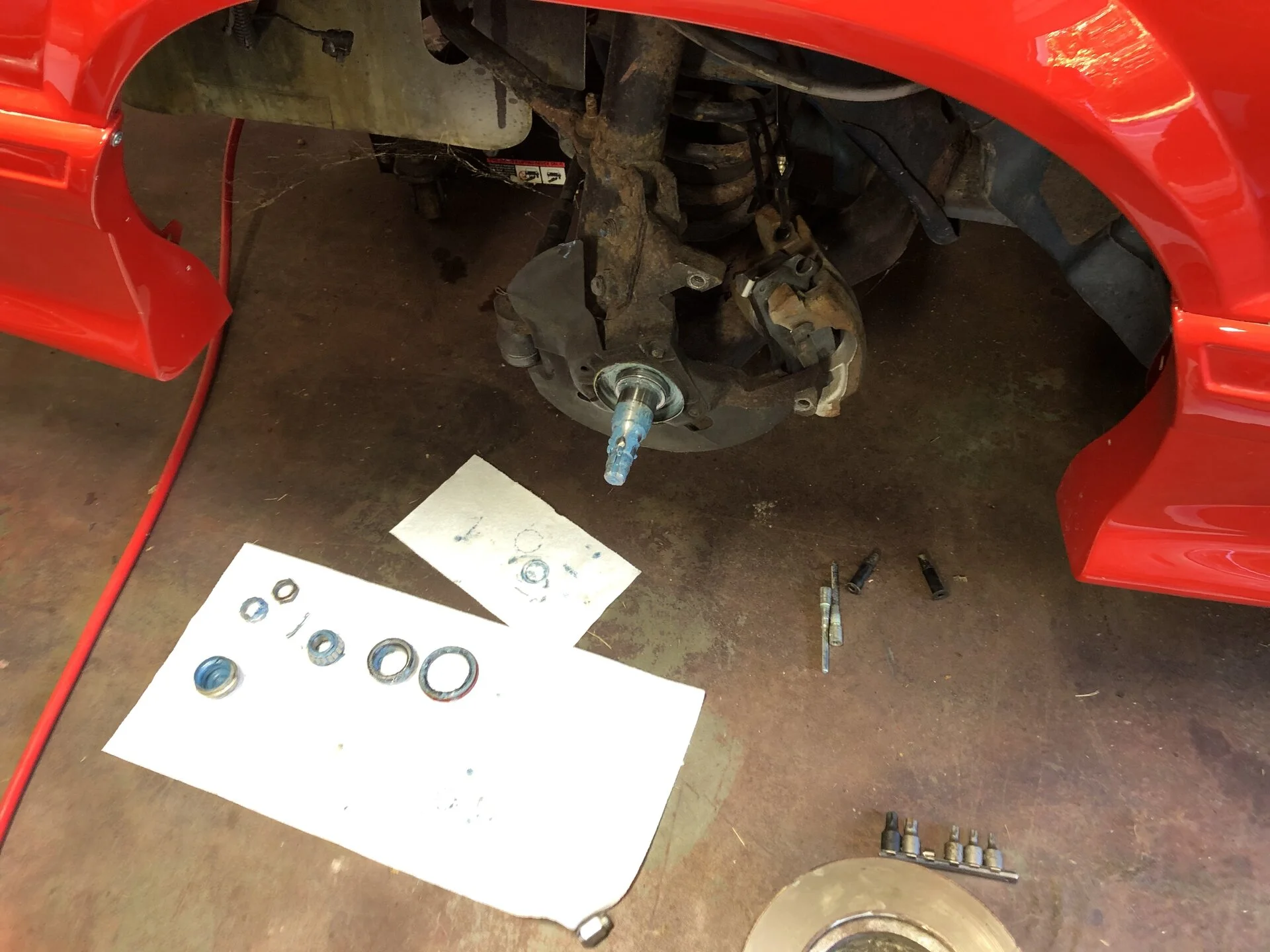

With a limited time to work, I knew it would be difficult to get much done this weekend, but every little bit helps! Front is finally converted to 5 lug (the cheap way, one day I’ll do a proper swap to SN stuff) with a few minor hiccups.
#1 - I didn’t realize that my dust covers wouldn’t fit on the Ranger rotors so I need to order up a couple of those.
#2 - The outside brake pad is just slightly rubbing the rotor hat. I may need to take the pads out and grind a bit of clearance, although they might clearance themselves after a mile or two.
Hopefully next week I’ll get the rear axles swapped and can the turbines once and for all!
Baby steps, baby steps...

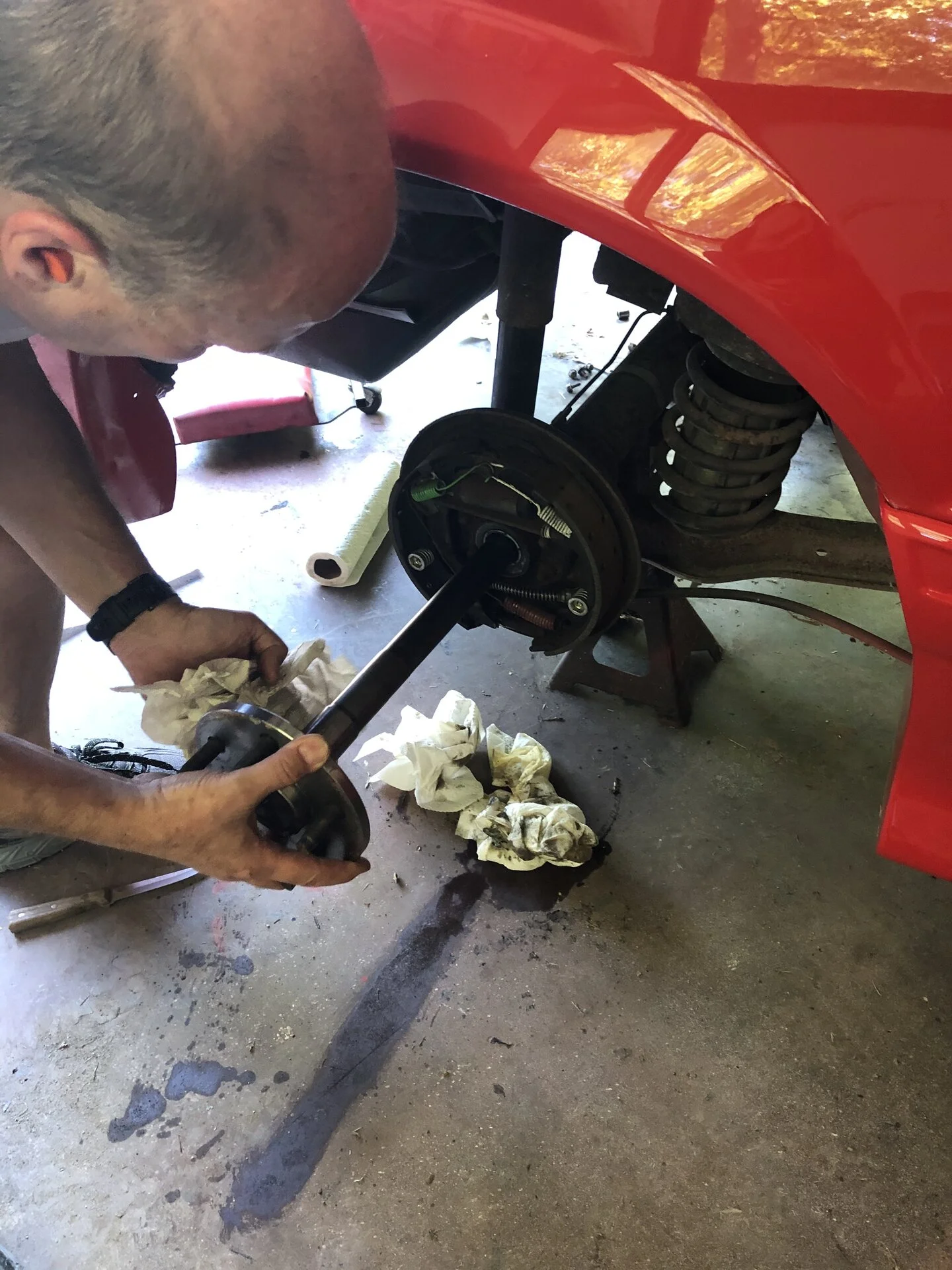

5 lug swap is complete... except that we made a mistake and the axles have to come out again
Unfortunately when you buy things years apart, you kind of forget about them. We pulled the old axles out...
And didn’t realize that the new axles didn’t have any studs, so of course a quick run to Autozone to get wheel studs. Not a huge deal, but the time schedule was tight because we had my Daughters birthday party so it just put a little stress on the time table.
So, we get the new studs installed and quickly reinstalled the axles. As I was tightening the differential cover, my Dad made an observation... “You know, these old axles have rubber o-rings on the splined side of the axle... we didn’t have those on the new axles.”
Well, we are out of time today so I guess we are pulling them next time
The drum was going to be coming off on the right side regardless, though. There is a cable inside the drum that rusted in half, so I need to replace that anyway.
Still, even with the setbacks we made some progress.
Rear end is full of gear oil, and the center caps have found their way home! Also got the factory air dam reinstalled, as well as the filler neck housing - it was hanging loosely behind the gas door.

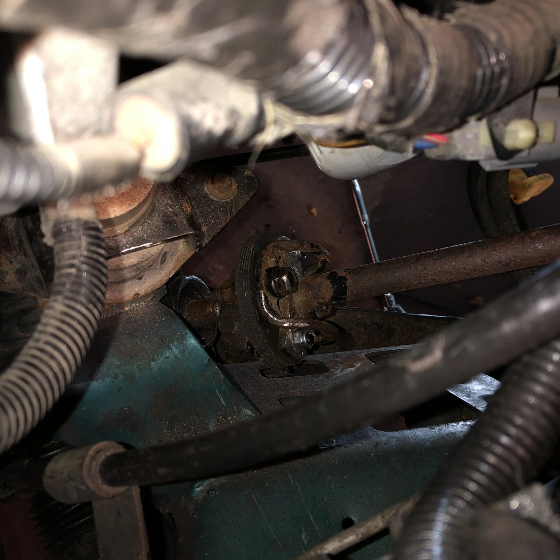

unfortunately, the good news ends there. I had the intention of running the car up and down the street a couple of times to make sure everything was good and there were no leaks, but when I went to pull the car out of the garage the steering was extremely sloppy...
The rag joint has disintegrated. Sigh. It’s not a big deal, just a bit of a distraction from wanting to focus on the interior. Still, the car was movable so we pulled it out and started taking inventory of the parts and determining where we stand.

Not a super productive day, but at least we can steer again!
The job wasn’t terribly difficult, although we wasted an hour trying to grind out the rivets in the car instead of just pulling the steering shaft out and doing it the easy way. Shame on me for not realizing that the shaft comes out fairly easily, and that there was zero chance of removing the rivets while the thing was in the car.
Overall it wasn’t a terrible job and I didn’t even bust any knuckles breaking the bolts free!

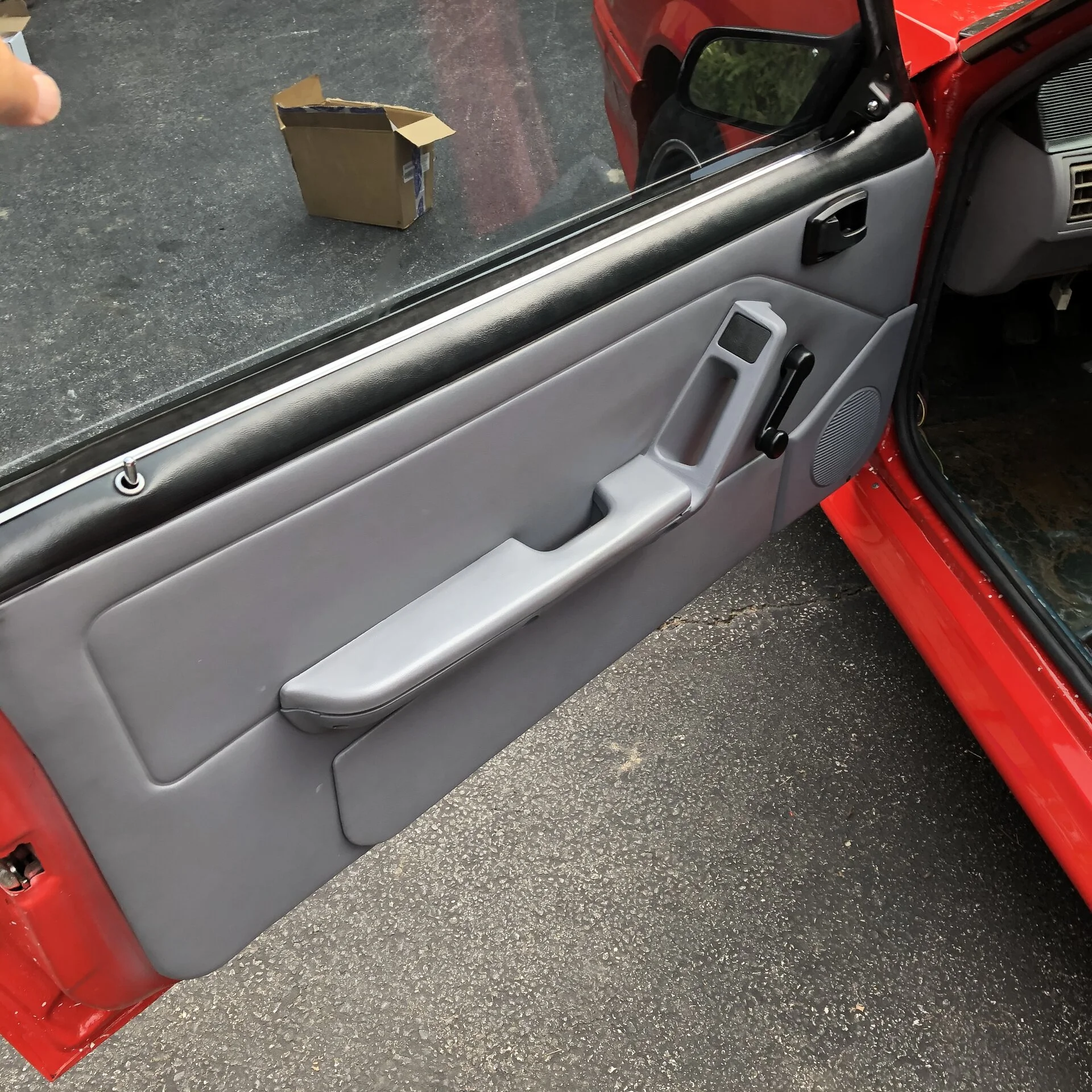

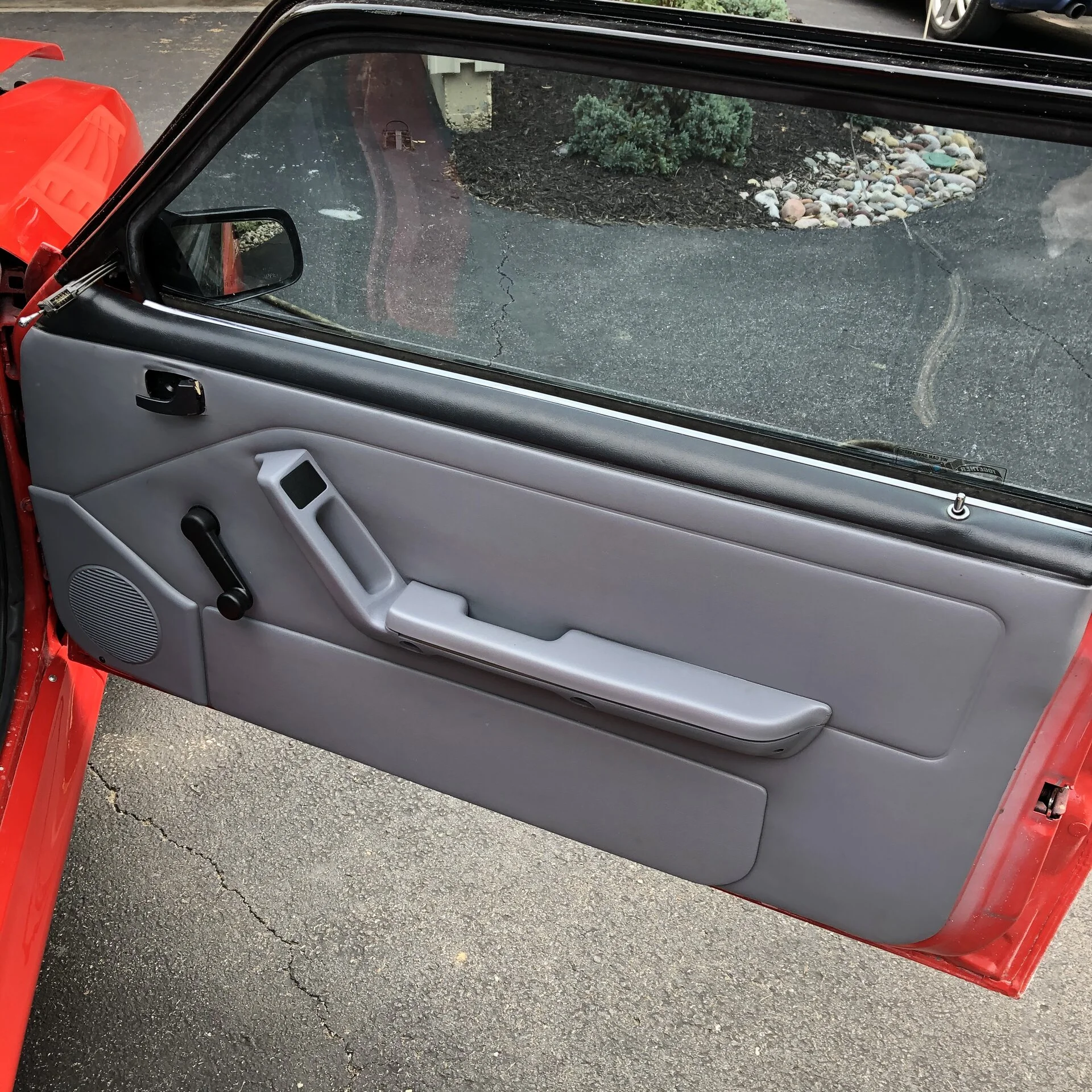

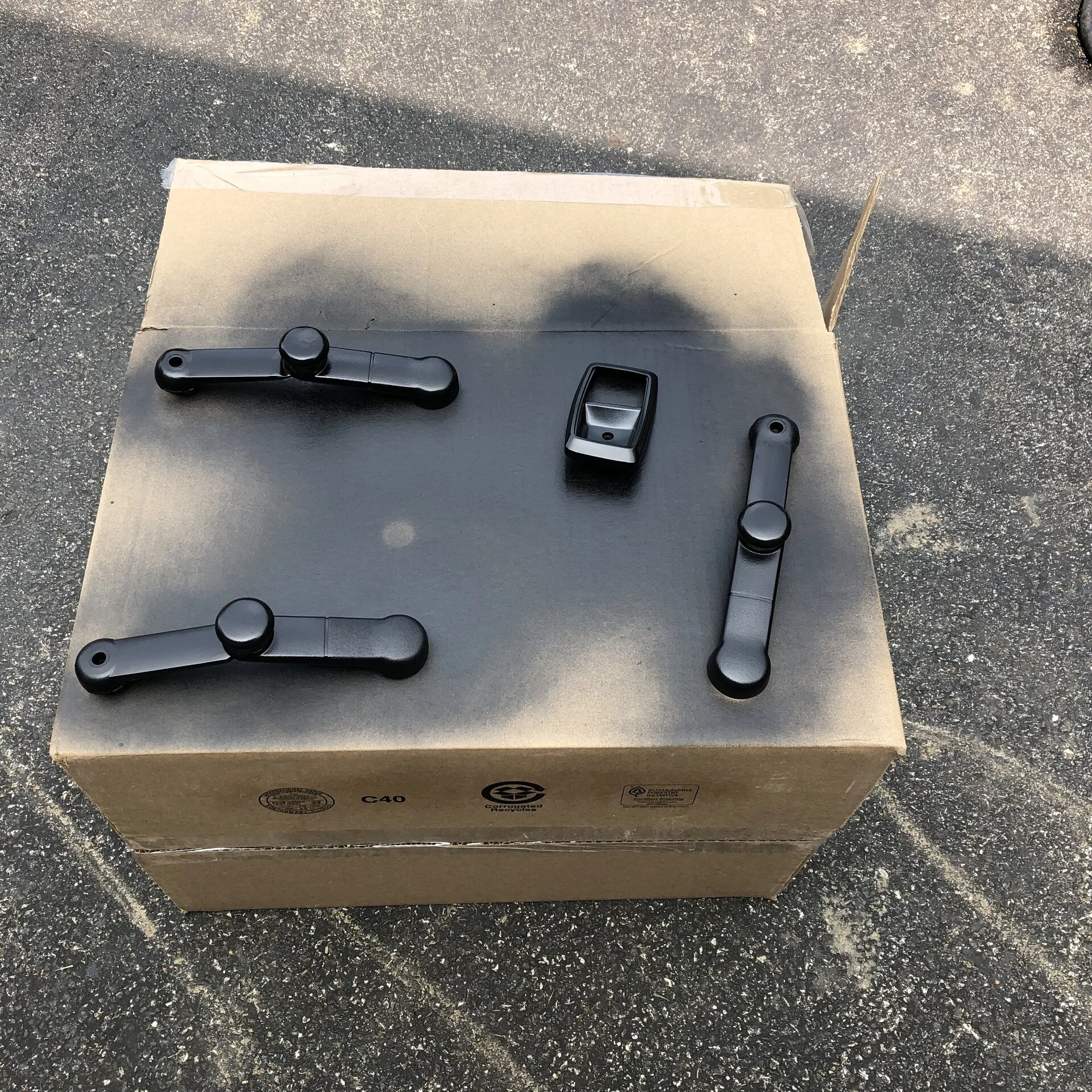

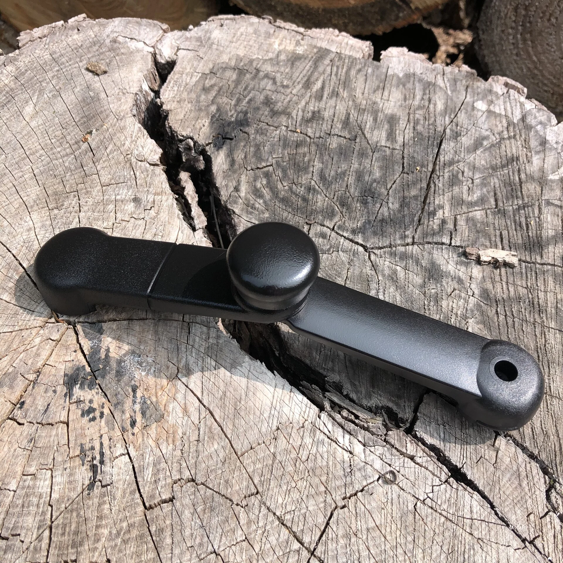

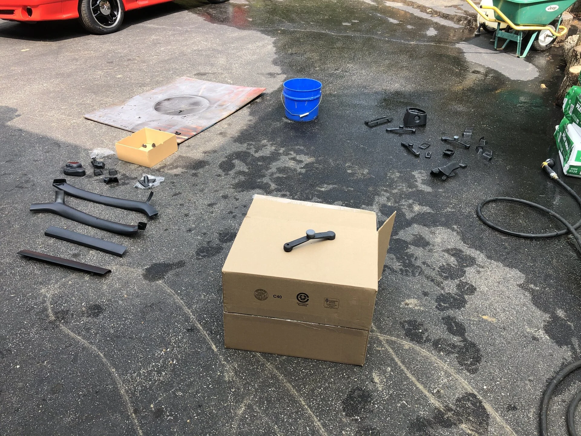

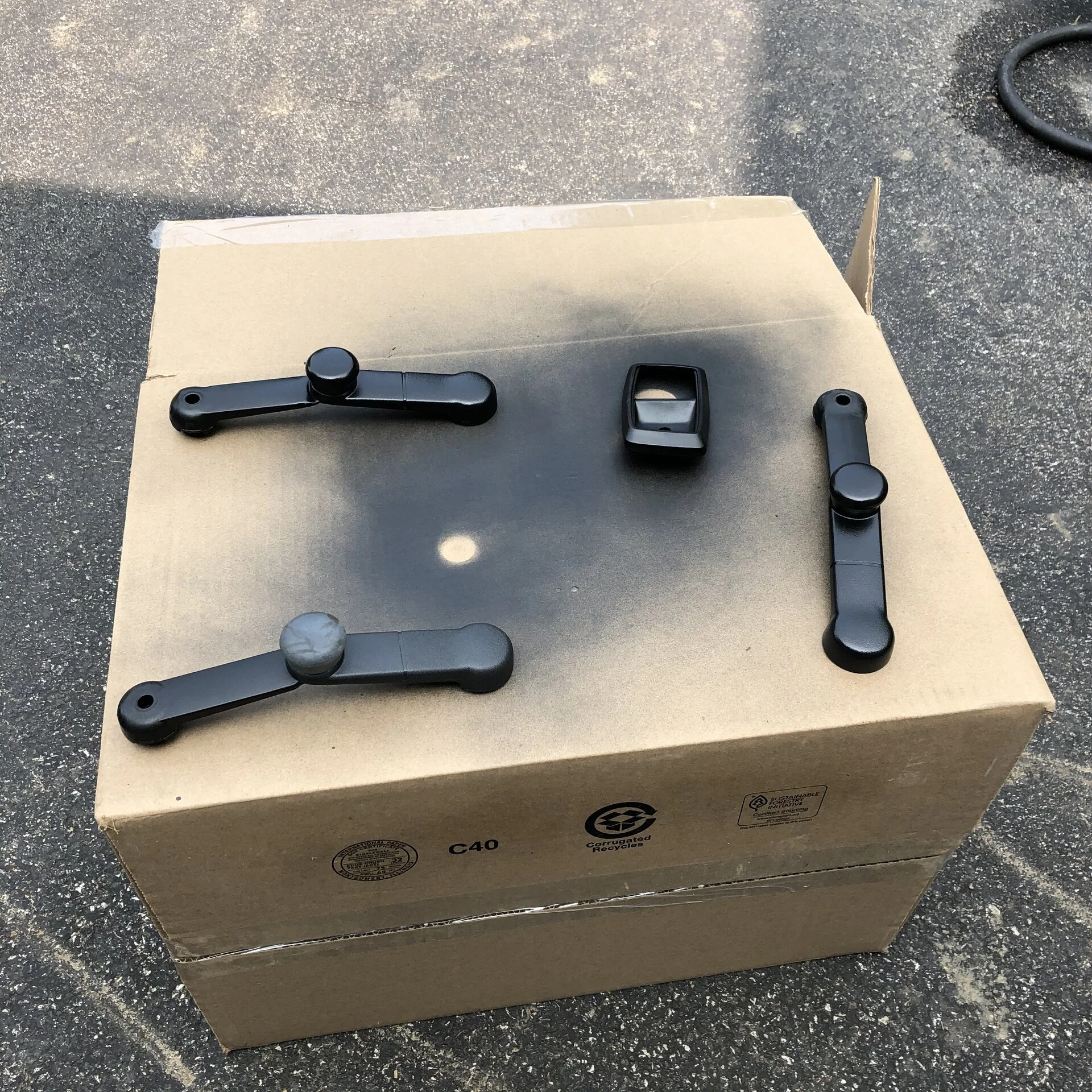

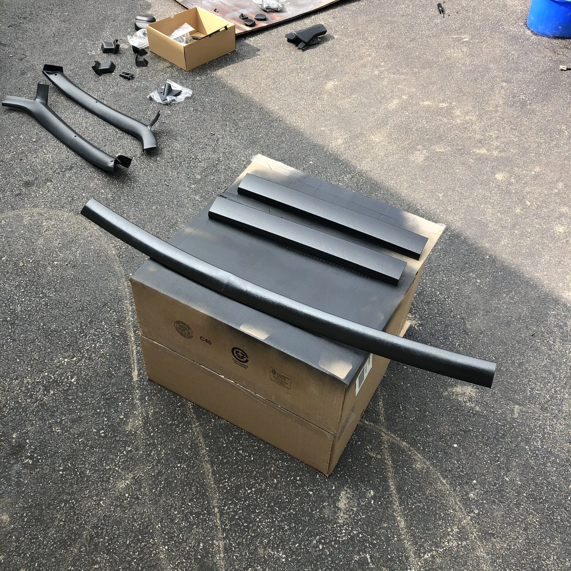

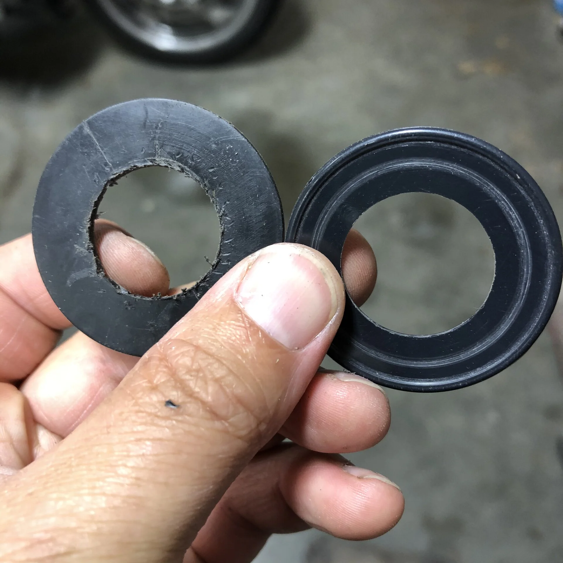

Got a bit more done today. Kind of annoyed that my interior screw kit omits the door hardware, which slowed me down. Ultimately I ended up just going to the hardware store and replacing the 10mm anchor screws with some Phillips headed sheet metal screws.
Mainly today was just a painting day, putting some fresh black on some interior bits...

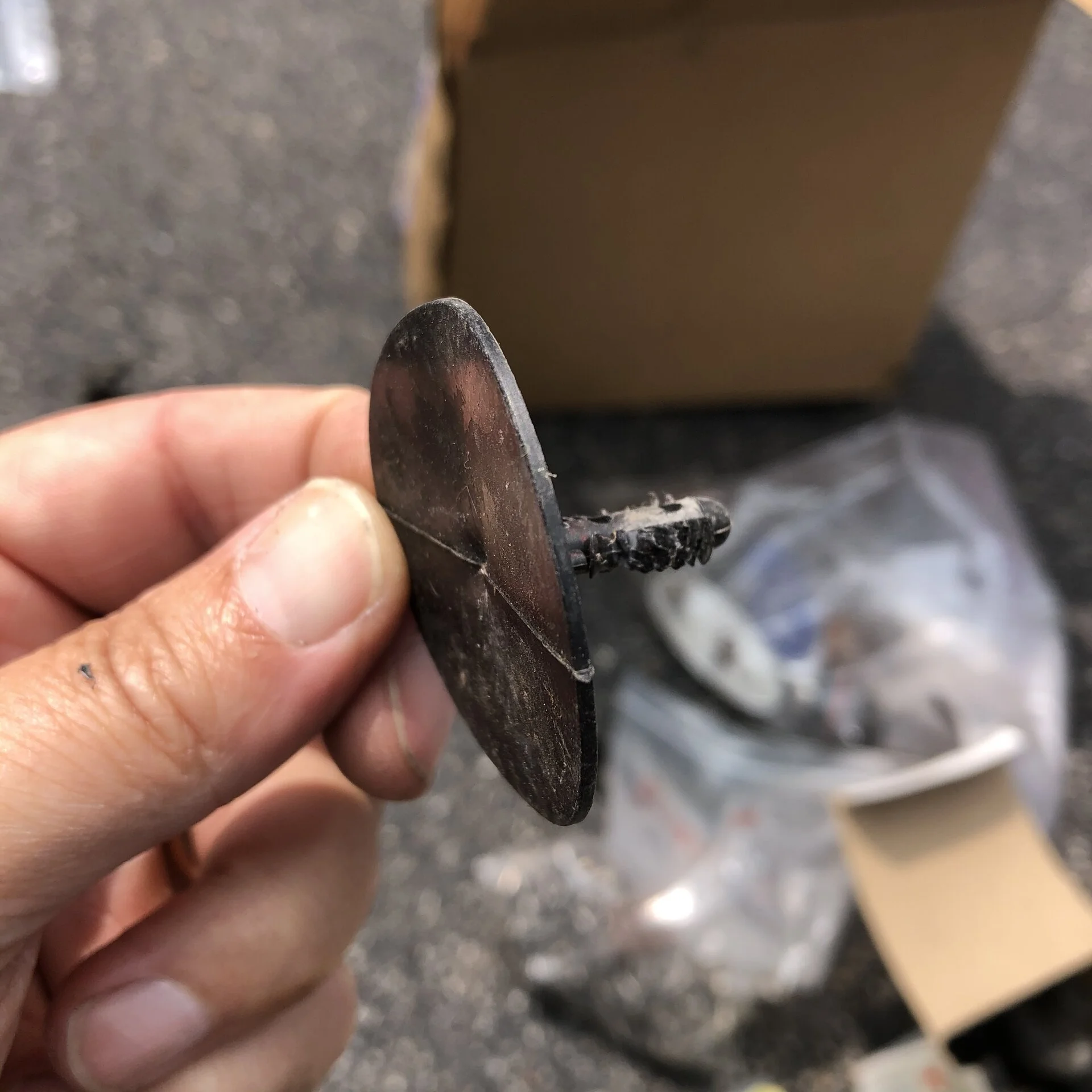

After that I needed to fab up a window crank washer, because I only had one. Fortunately I was able to take a worn out large push pin and knock out the center. Worked out pretty well!
Had to do a bit more work to get the inner diameter good from here, but you can see the basic idea.
Finally, got the doors back together.
