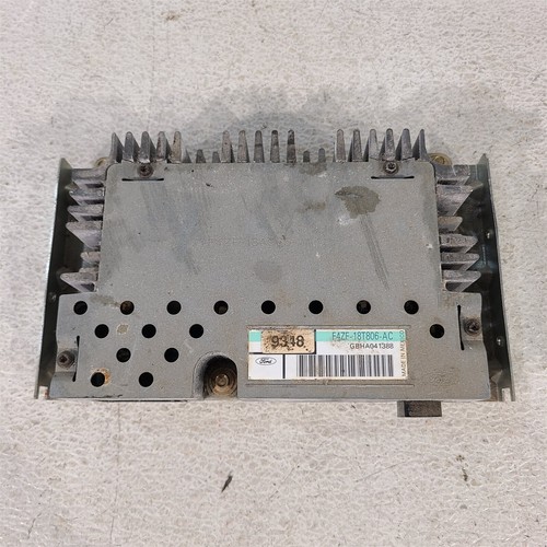

Those 1993 specific amps still pop up on eBay from time to time. About $75-150 when they do. Unfortunately I see non on eBay now

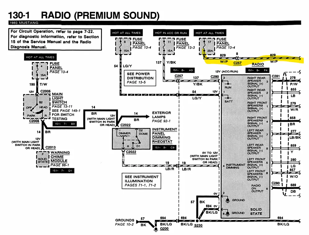

This is an old but helpful thread, my 1993 amp gets constant power to the amp with the key out and with the factory head unit out , is this normal? Appears to be a White and pink

Yes, that is normal. In 1993, the amp has it's own power wire that is not connected to the head unit at all.
White/Pink wire runs direct to fuse #17 and is a 20A fuse. It is hot at all times
Reactions: Charlie1
Thanks!!! Yep just located that fuse the manual left blank. Again I appreciate it

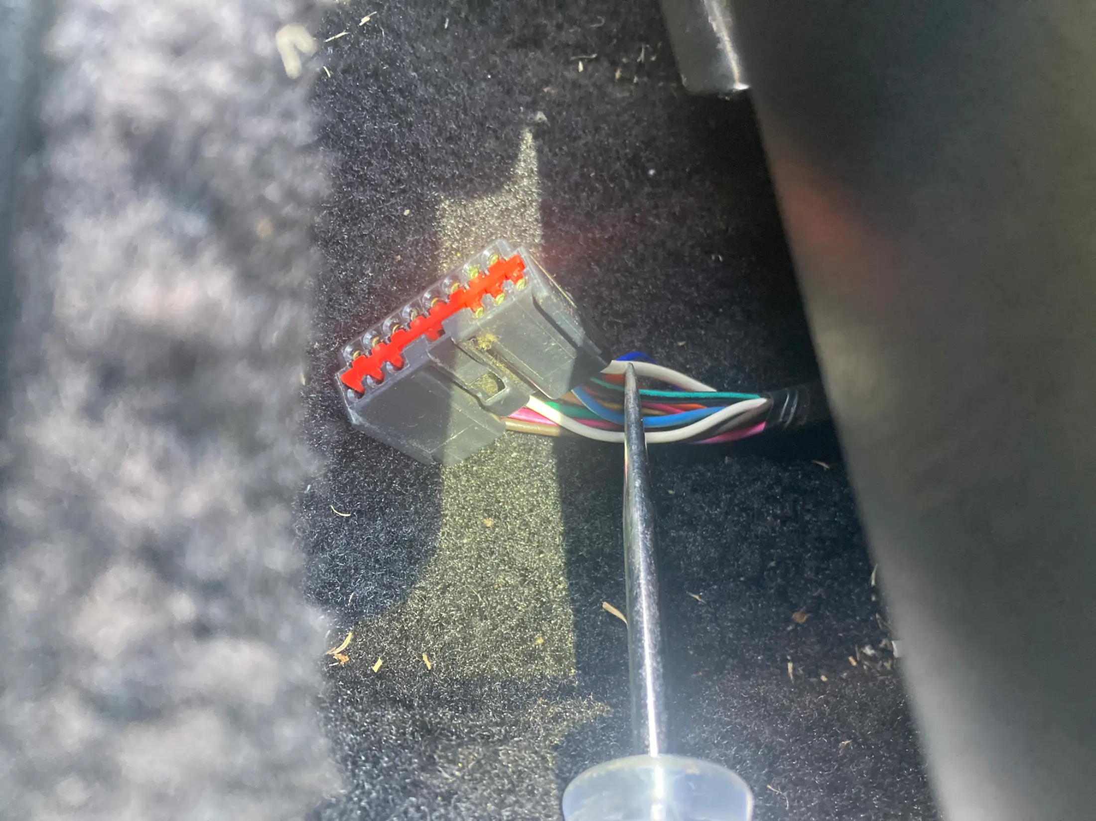

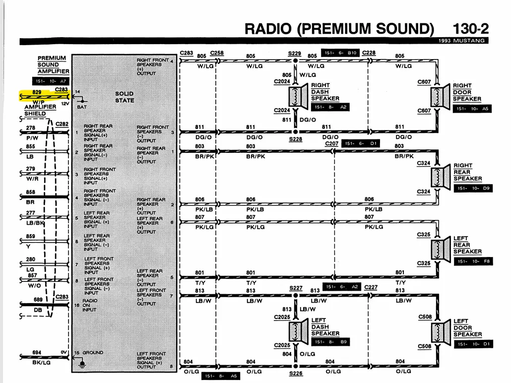

Ok I’m checking for some parasitic draw. The amp appears to have a ground and power at all times with the head unit removed and key off. So is there no trigger for the amplifier at all on the premium sound systems? Looking at the wiring diagrams it appears to get power/hround at all times. Thanks
I’ve got to check pin 16, that appears to be an additional ground. is there a harness that will bypass the factory amp utilizing the “factory” head unit? I’m not sure how loud it will be with just the head unit. I’ve come across several post with different part numbers online but most are using a aftermarket head unit. Thanks again!!!
It can be done but you would need to change to a non-premium head unit. That won’t be easy to find.
The original head unit is meant to work with the amp.
If you go aftermarket you bypass the amps as it’s only 80watt and most aftermarket head units output that with much better sound quality.
