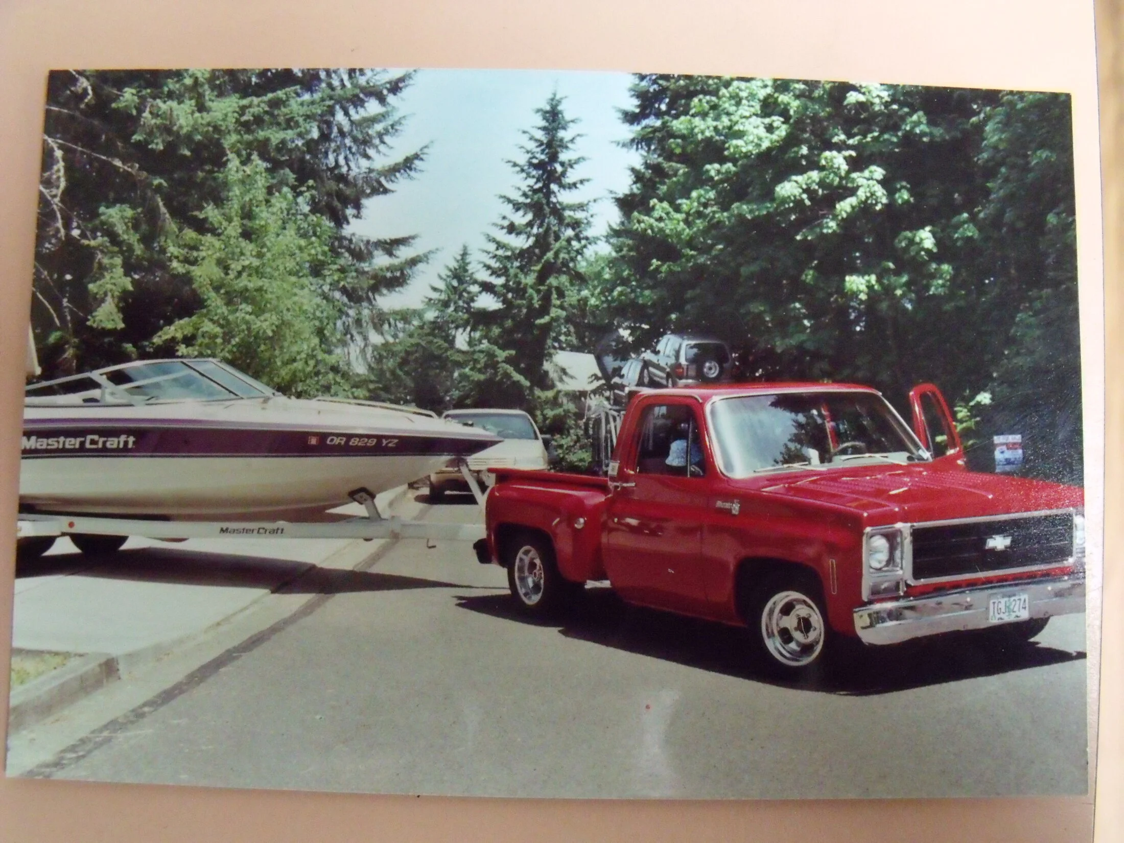

The truck in the pic came with a louvred hood from a previous owner.. Factory 454 / Turbo 400.. I installed a 2:50 rear end gear set.... It never once overheated or actually went over the 180 degree temp bar on the gauge.... Towed that heavy 23' boat all over the state.....
I am sure the louvred hood helped keep it cool..... You can make out the louvres ( sp?) on the back half of the hood in this pic
