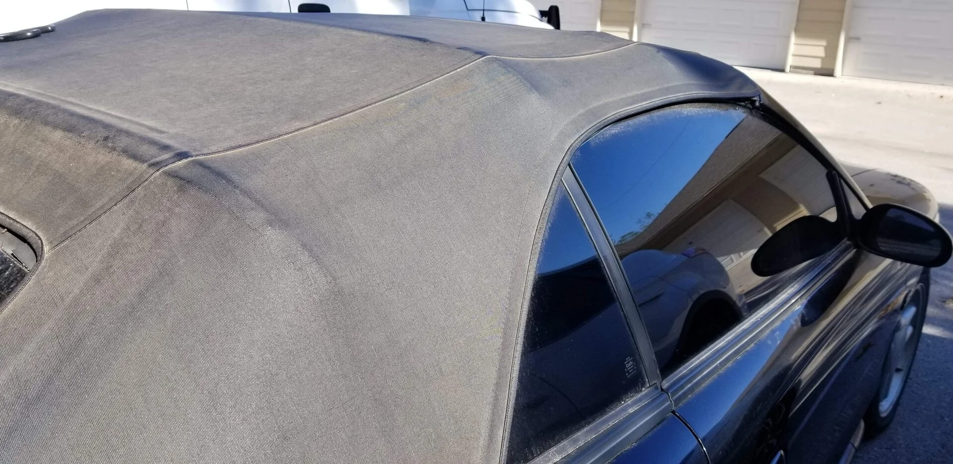

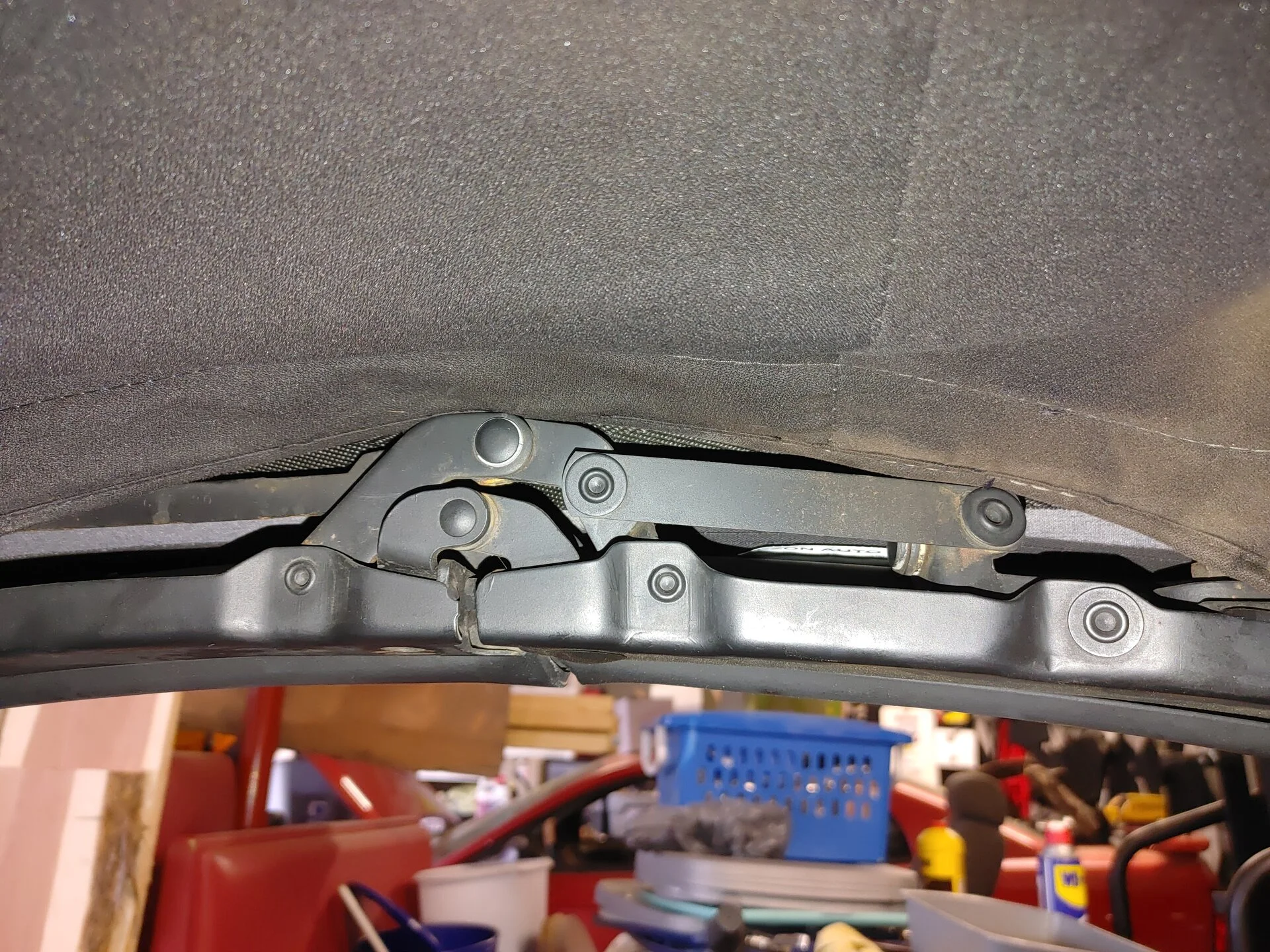

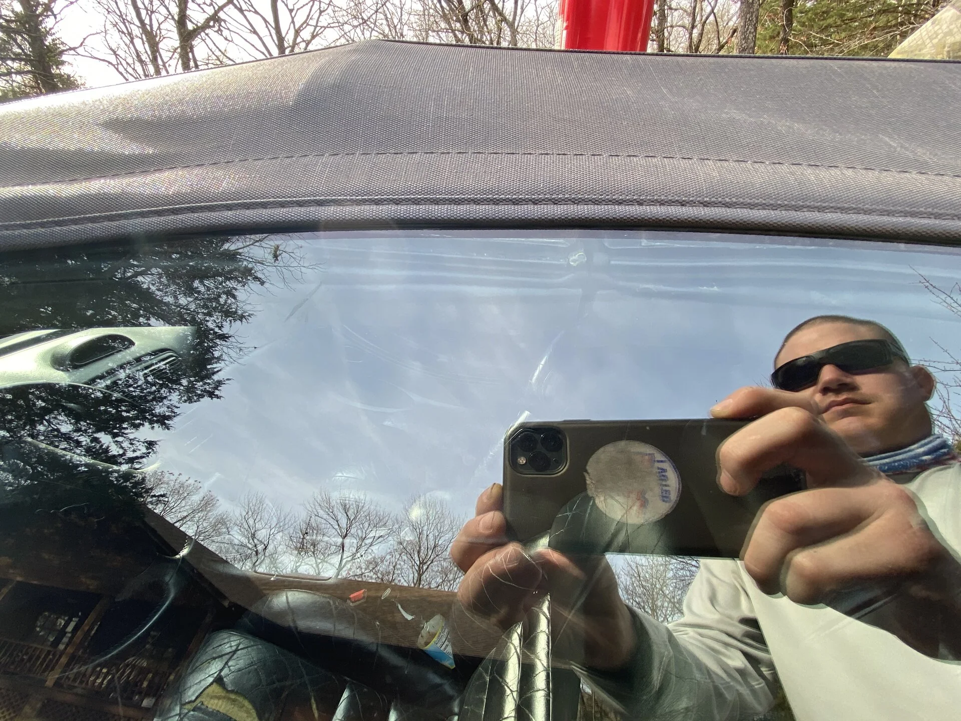

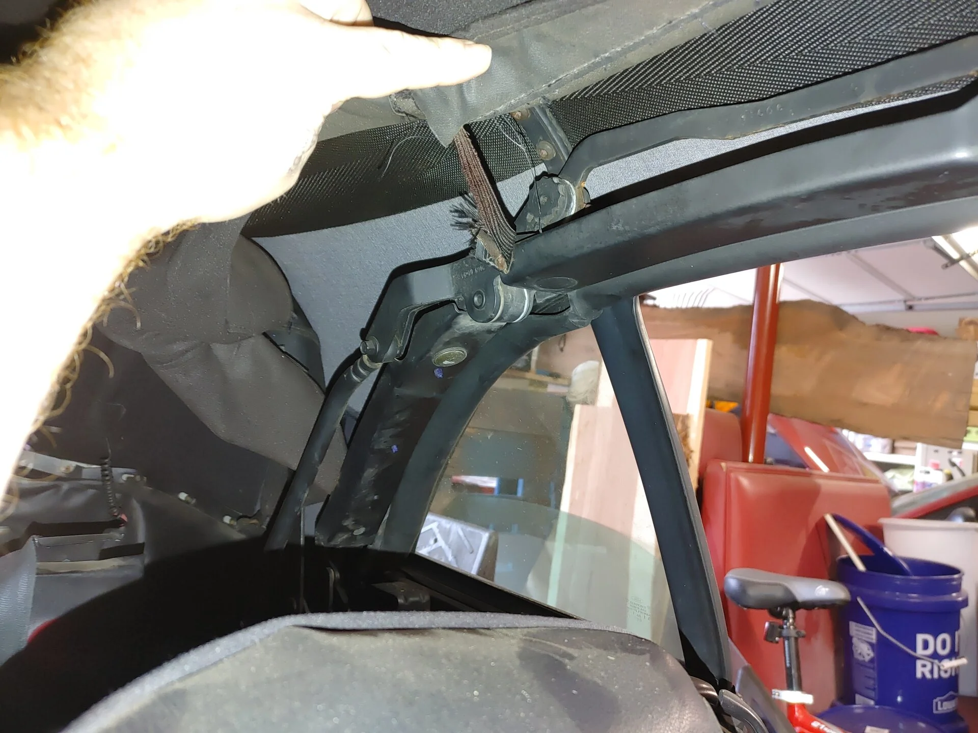

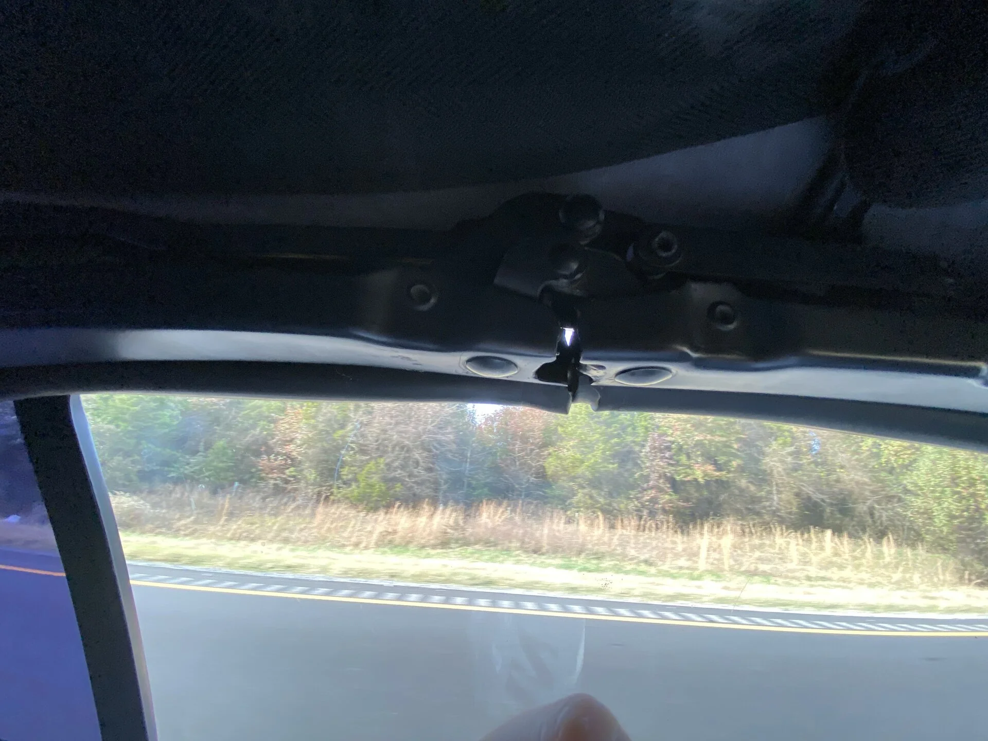

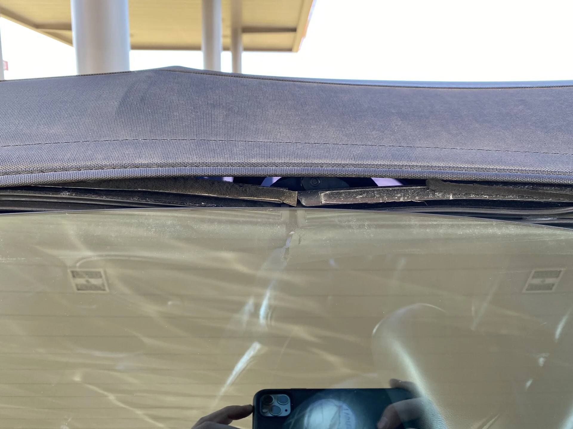

Ok, so I’ve adjusted the top on the drivers side as much as I can. I can’t get the sag out.‘I cannot find the balance adjuster link. I loosened the rear bolts, pulled down on the bar, and turned that adjuster wheel like it said but I can’t get it out. I’ve searched and searched for the balance link adjuster for the 1194 GT and can’t find it. I put new weatherstripping on today because I was tired of hearing the wind noise. I’m about to sell this thing if I can’t fix this issue. I hate giving up o anything but I’m at my wits end here. I’ll post a pic of the inside and what it looks like outside. The passenger window is below the top, but the drivers side saga so much that it sticks out past the convertible top and doesn’t shield it from rain. The hex head adjustment where you can slide it back and forth to adjust the sag I never could find it, all the listings were very vague snd didn’t show where the part was at, I’m showing a passenger side look before weatherstripping also, the other three are one right before new stripping and two more are after new weatherstripping. Also do I adjust when top is locked or unlocked and raised with the pins out of the holes?PLEASE HELP!!!!

Ok, I redirected myself from that other archaic thread that we both commented on. I probably won't be much help with this either, I've not really messed with my convertible top other than ripping the old top off before finding another and just replacing the whole thing frame and all. But just by looking at this while I'm at work, it looks like there should be some hard stops somewhere AND/OR the top is stretched too tight. I have my old frame just sitting, I can take a look at it when I get home from work to see if there's anything I can help with from that aspect of it. I mean there's no material covering anything, I should be able to see that area with no problems. Other than that, my suggestion would be the same as it is for myself, I'm going to let someone else handle replacing my car's top when it comes time to do it. Granted, mine's not an SN, but I'd think the mechanics of it all would be more or less the same. :shrug:

I looked, I took everything apart even the rear apron, and it’s not there. That Ford manual portion that shows those parts aren’t in the 94. I sent it to a body shop owner and he verified it’s not in the 94. I think I’m just going to get the entire top replaced.

They quoted me $1300 for top plus labor with defrost. Not sure if that’s a good price or not but having a new top would sure beat dealing with what I’m doing. Least they can take it all off the frame and see what needs to be done.

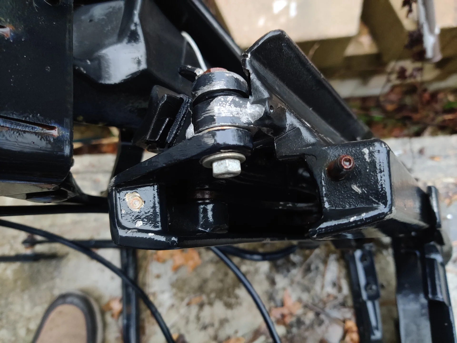

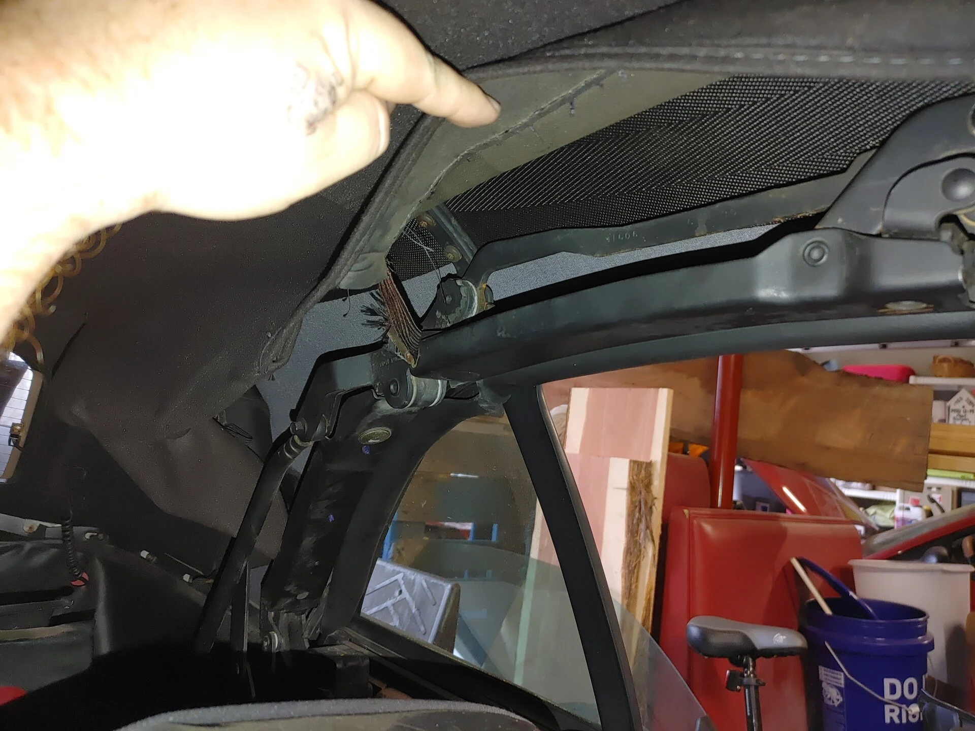

I took pictures of my top (frame) car was manufactured in late 94 but slotted as a 95 model. Driver's side.

Frame isn’t wrong the link in the description for how to adjust it is wrong. We don’t have the barnacle link adjuster with the set screw like it shows in the link, and several other pieces. I’m gonna get my top replaced and have them money with it
Ok, I took a pic of what looks to be a hard stop at that joint in the frame. It looks like a setscrew and all you'd need is an allen wrench. :shrug:
Yeah that’s the stopper for it if it’s too close, and bumping my problem is it’s not going far enough up to do that, so adjusting mine doesn’t do me any good. The pic they are talking about shows a long set screw on a device that will allow you to turn in and out and make it go forwards and backwards

I think I posted earlier that it could very well be that the (canvas/vinyl/whatever your top is made of) could be too tight. If that's the case, and you're looking to just have it replaced now, having it redone should alleviate the issue completely.

The top is vinyl and is overstretched for sure. It had set under a car cover for over 2 years when I got it, and the old lady said the top was original cause her late son never had the money chance or money to replace it. Oddly there is no tears or anything it’s just stretched to the limit. Now I’ve got some other issues to fix in the meantime. I did the gauge cluster repair with the worm gear and main cog, and then going to figure out the wiring. There’s an aftermarket alarm on the car I just don’t have the fob. So I may see what brand it is and get one for it, oh and the drivers door if you lock it she says it won’t come back open and unlock. I’ve got the door key I think more than likely that little yellow elbow that keeps the arm on is broken, I’ve got another one so it’s no big deal. I also need to get in my brothers shop he’s been wanting to use for his drag car and get the rear main seal replaced. It’s getting too damn cold out to do it outside.
