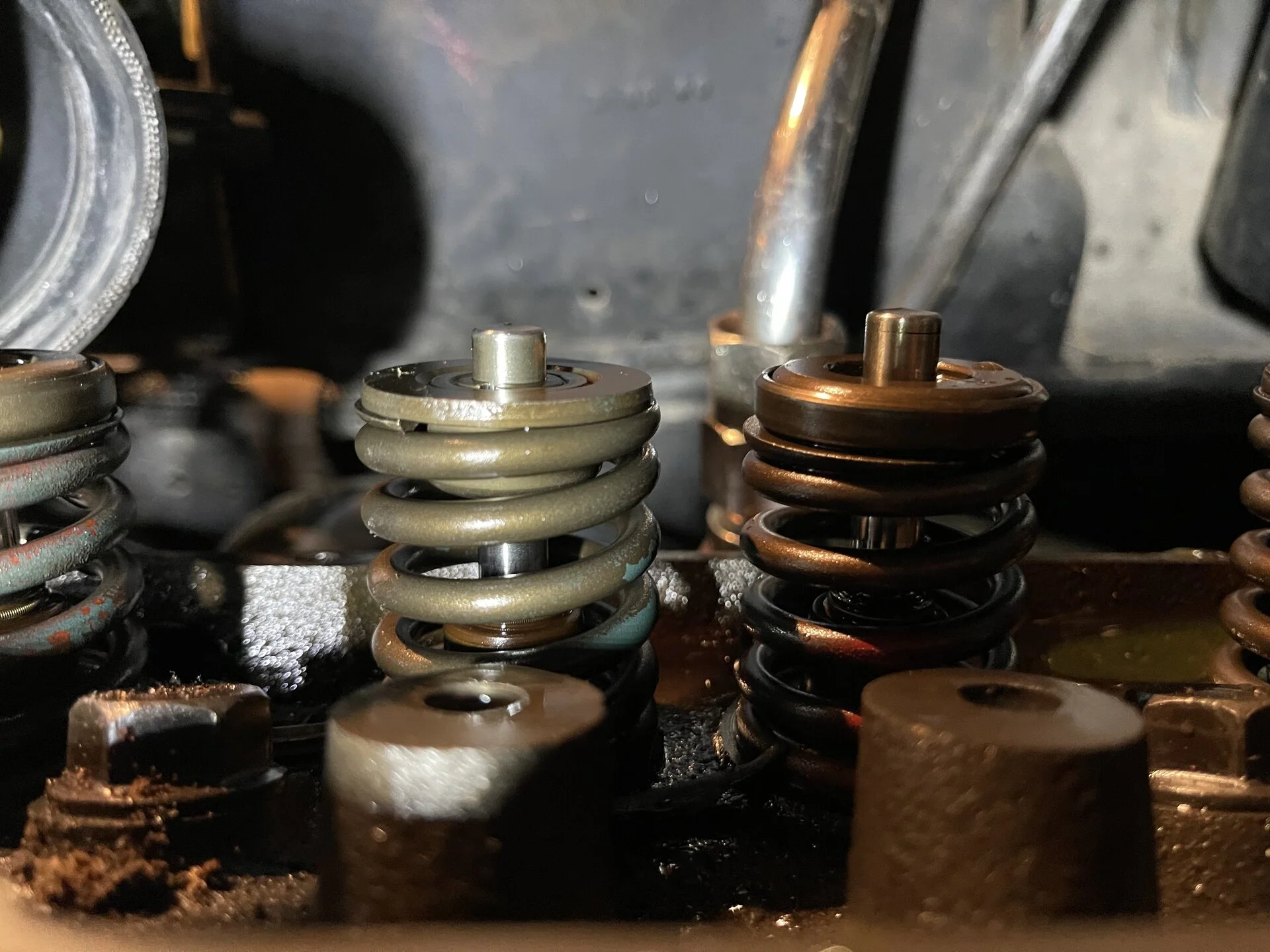

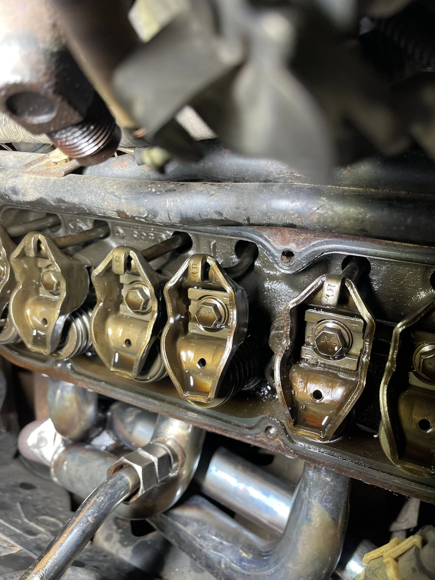

Update: Pulled all the rockers, pushrods, and lifters last night. I had 4 bent pushrods, all on intake valves. Cylinder 3 intake pushrod was really bad, and the intake valve is not fully seating.
E82D369B-5E2B-4E63-B0C8-B61FDB83BD53.webp E60B7773-347C-410B-80CC-C6416AB8BCC3.webp

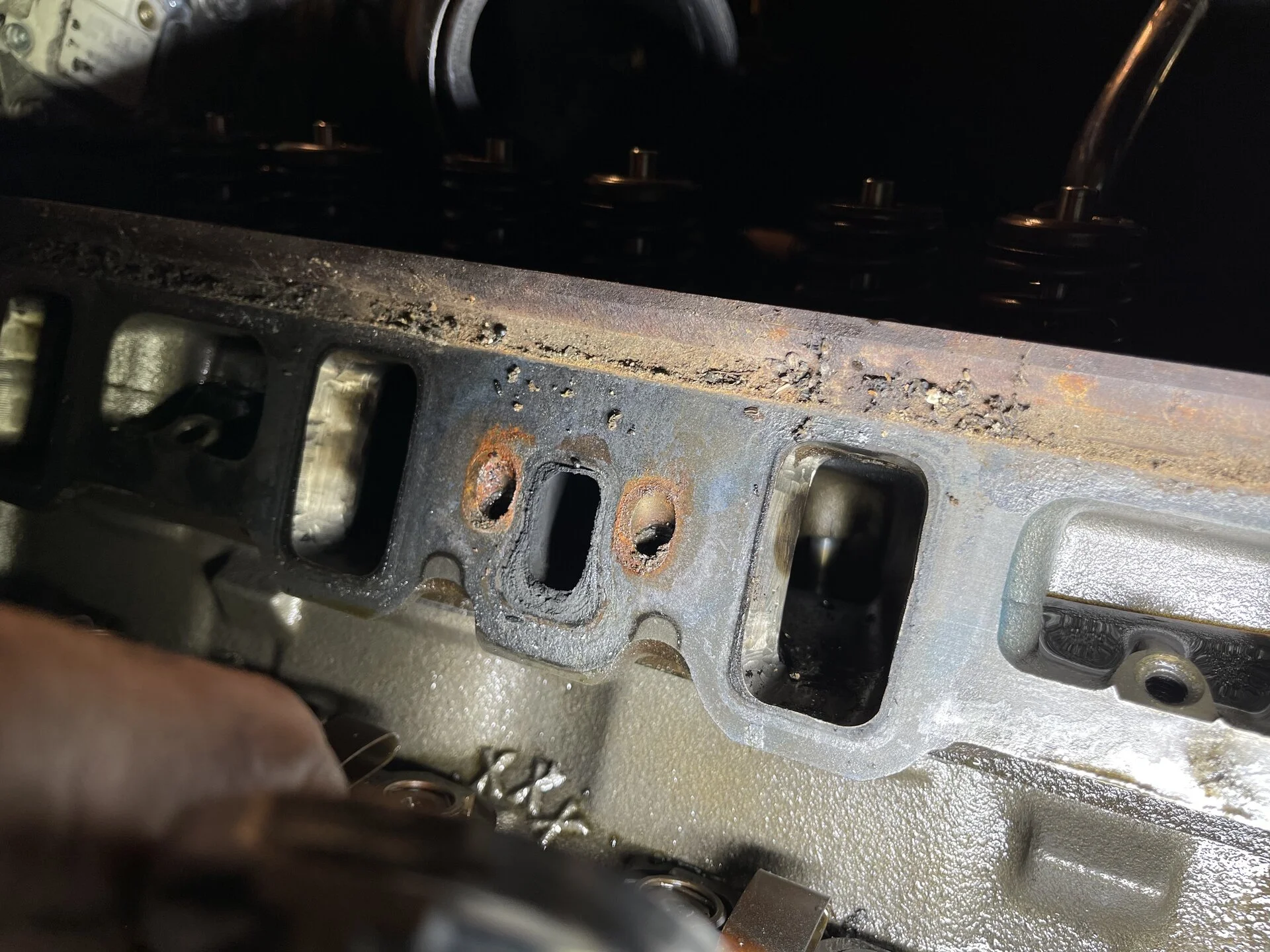

Looking down the intake runner, it appears that the valve bore is cracked, which I assume is why it’s not closing all the way (see picture, have to look closely).
The rest of the pushrods just had a slight bow but not perfectly straight as they should be. Roller lifters show signs of wear, but I’m not sure what is normal and what is beyond repair honestly (this is the first engine I’ve torn down on my own). I haven’t yet pulled the cam and heads, but I’m going to do that tonight to check for cam lobe wear and if my pistons are still good. The engine still spins pretty freely by hand, so Im hoping the rotating assembly is still good.
