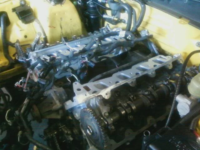

I have a (1999 Stang, V8) (after 3 years with no problems)Stock heads where messed up by Cyl#3 .. I REPLACED heads for semi-new(1,200$ 1 year ago) Before putting heads back, Mechanic ADDED some special HELICOILS that where installed before final installation so that it will have more thread and it will avoid getting another spark plug blown. After installation (1 year later 10/12/2013 ) Cyl# 5 decided to break, I sent it to the shop for Helicoil job... :cautious:, Today 12/3/2013 Cyl#3 is misfiring, i turn the car on, and i can feel the low compression, i use my OBD2 machine and Cyl#3 is back again after so long..
