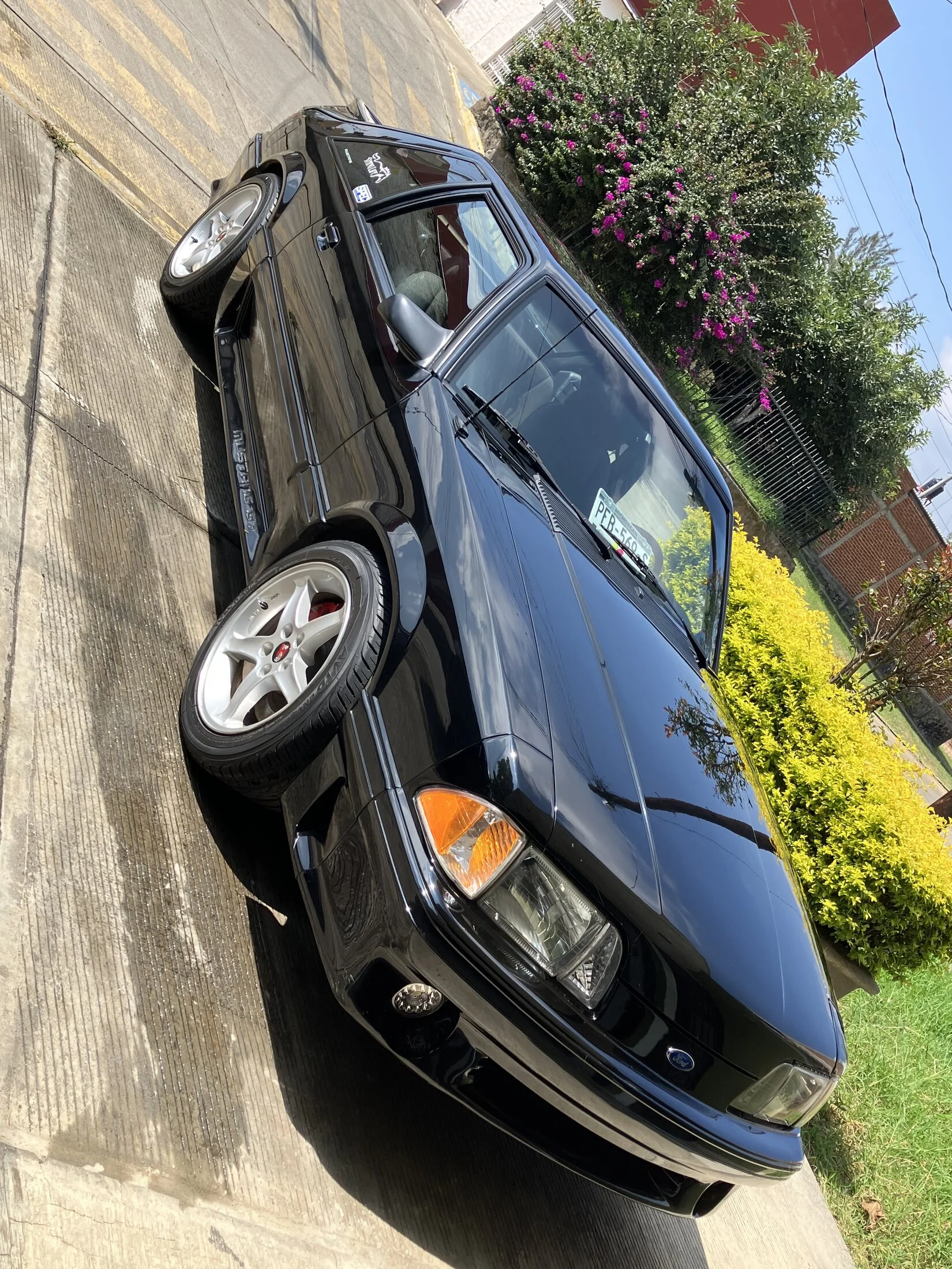

Oh, and post a pic of the car so we can see how aero clean it is.

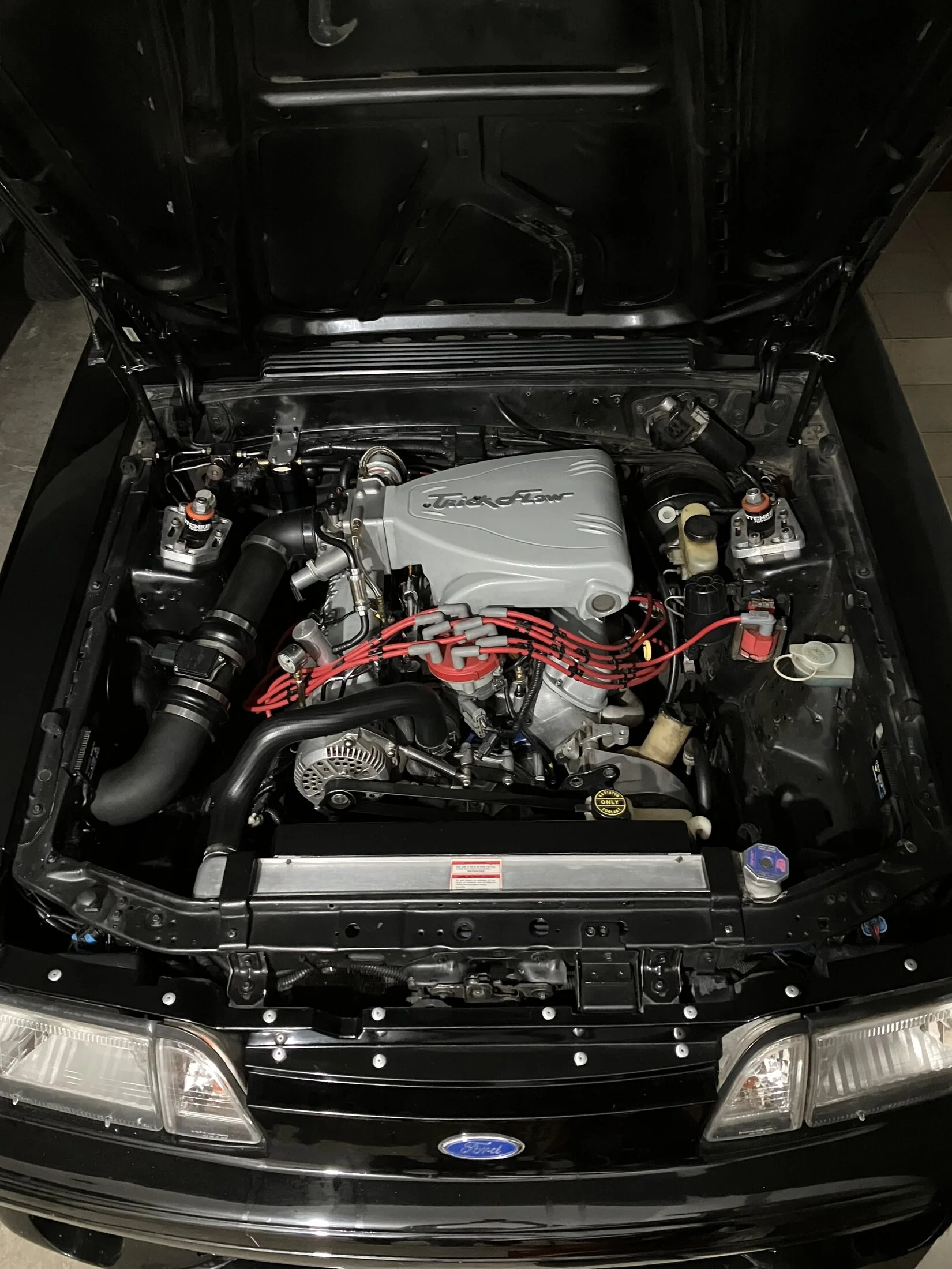

Absolutely, the car is free no dragging brakes and it can be easily moved/rolled with one hand
None of this adds up.

Out of curiosity, would you describe your fuel system from tank to injector?
