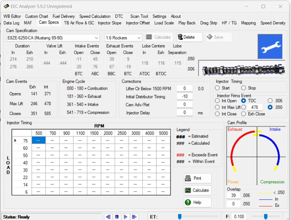

Heres what I learned about the A9L computer and that its out of its territory with anything but its recommended alternator as the extra amps and power increases injector duty cycle..
Most think that when going bigger a larger fuelpump is also needed and that the stock fuel relays and wiring is sub par for the new combo...
When you do that the extra lph flow increases the amount of fuel the fuelinjector sprays at the same duty cycle then the closed loop adaptives go haywire tring to make sense....

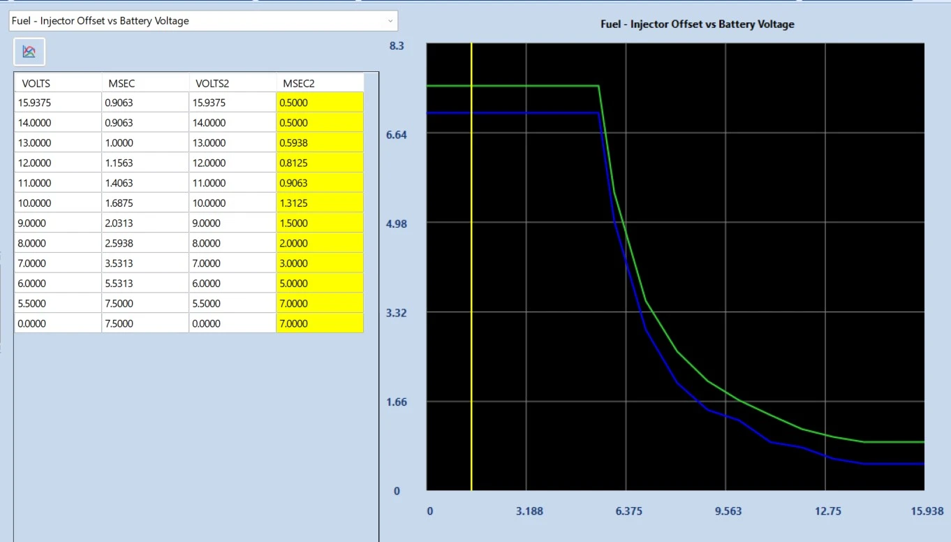

I have a 170amp alternator and a 255lph pump and I had to do some heavy duty changes to the injector pulsewidth ..

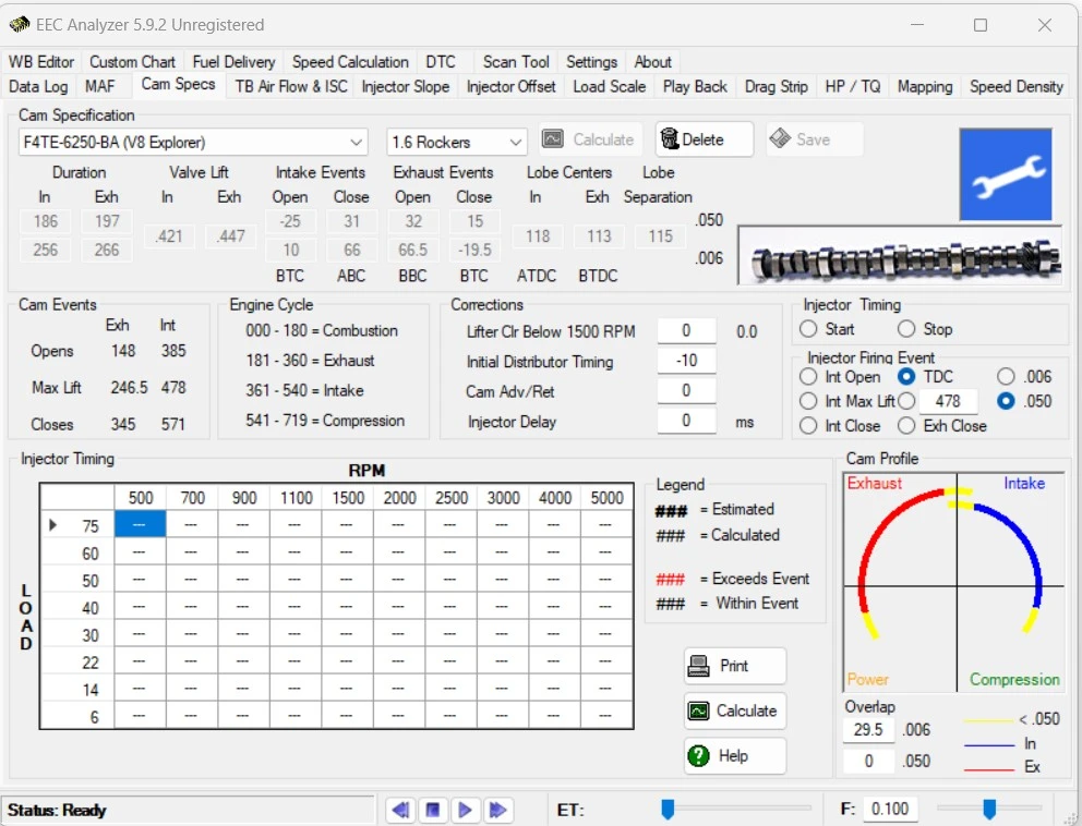

When you change camshafts theres this lil thing called valve overlap and valve timing events for opening and closing...I have a 351w w/ roller camshaft thqat also came stock in the explorers too and the overlap isnt as extreme as a mustang camshft so I had to change my injector timing events to 380...

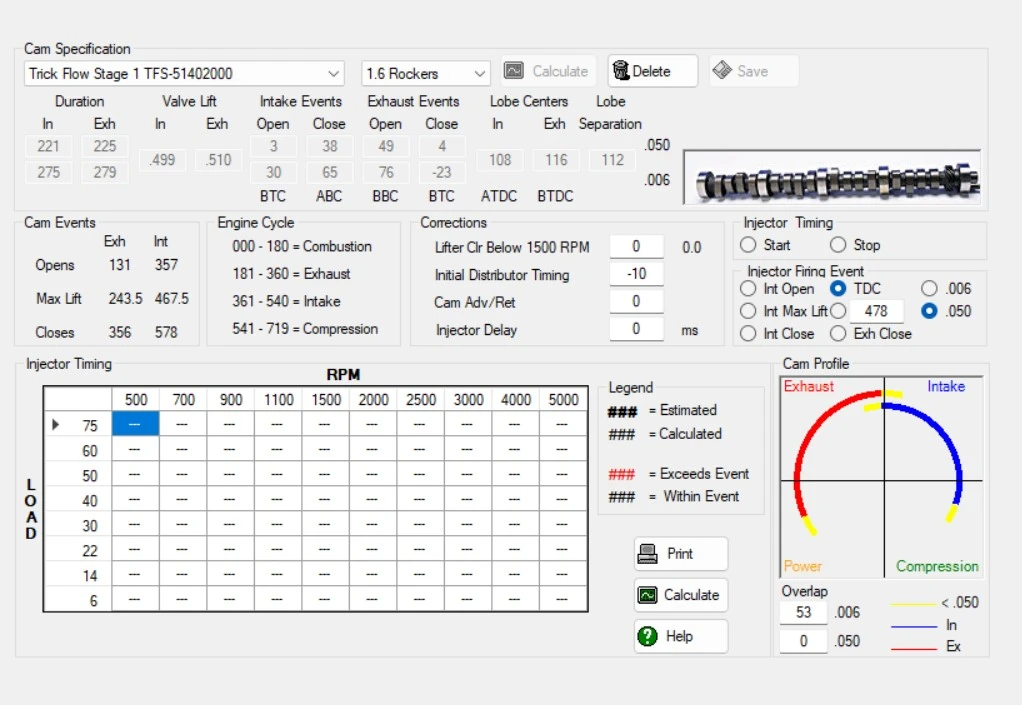

The A9L is set to spray the injectors at a certain degees given the camshaft design specs...... which at idle is 352 degrees..
When you look at the TFS stage 1 camshaft the valve timing must be changed or youll get a constant wet intake manifold due to fuel puddling and reversion when pulled up from active cylinders...

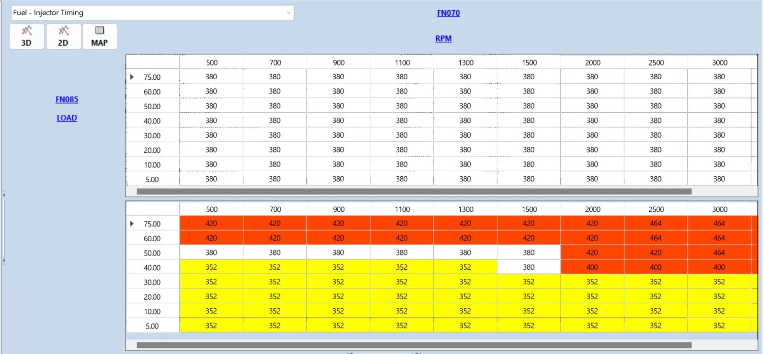

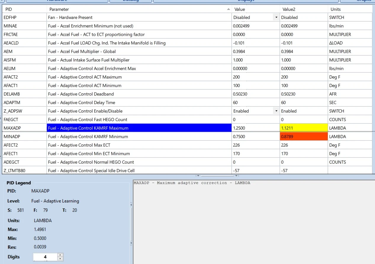

The only way youll be able to get what you have to adjust better is to get a chip because the adaptives can only adjust up to 12% + and - and the setup you have maxes the adaptives ability to help out totally...
I have mine set to 24% but can go as high as 47%............
Left side is my value and the right is a stock A9L

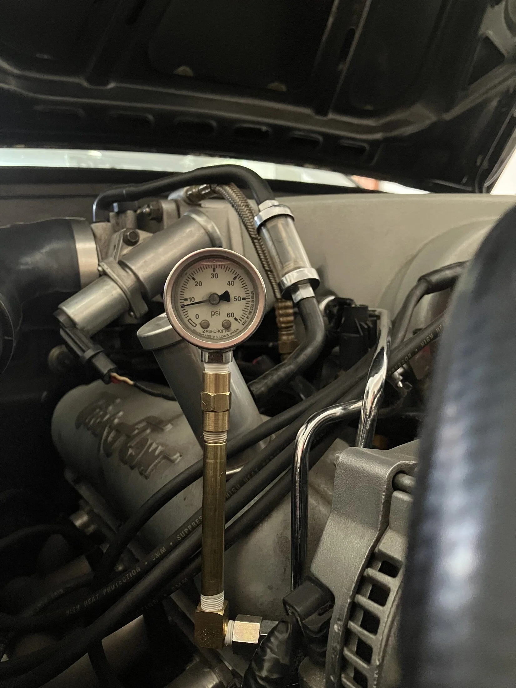

Right now I’m returning from a test drive after I adjusted the fuel pressure with my Kirban fuel pressure regulator to 30 psi with the vacuum ON, drove it hard not redlining it but hard and it ran really good with no pinging. There was no check engine for possible lean condition.
At the bottom is the FUEL PRESSURE GAUGE I’m using which correlates with my fuel pressure gauge tool. The reading on the gauge is not the actual pressure, it is just residual pressure after shutoff .
Any ideas or comments?

Like I mentioned I dropped the fuel pressure to 30 psi and took off. Very strong did no noticed any lack of fuel, no hesitation , no buckling, no lack of power, and no check engine indicating a lean condition. So how low in the fuel pressure can go before the ECU reacting to a lean condition with an error code????

Also, you should be removing the vacuum line and plugging it when setting the fuel pressure at idle.
