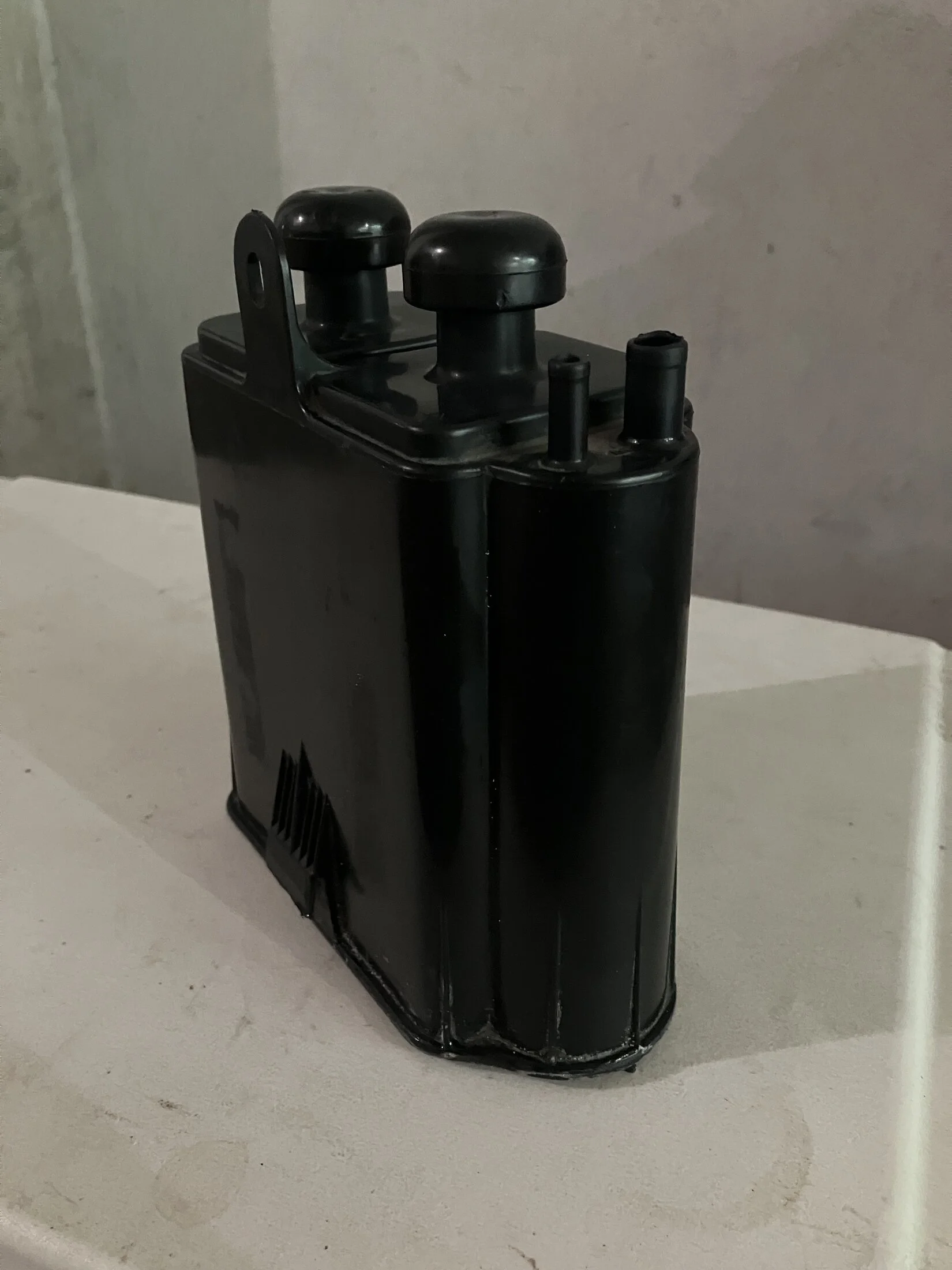

rednotch said:
If your canister is soaked in fuel your over filling the tank or you have a constant strong vacuum on it sucking fuel from a valve stuck open. Once there soaked its replacement time. Has the car ever been hard to fill with an auto shut off pump and you having to hold the gas Pump handle so it doesnt trigger and shut off early?
Haven't looked at a fox body canister in years or think I ever opened one up, but most of them that vent to atmosphere will be a one way valve or another selonid controlling the vent. We got them all the time working when I was in dealerships, mostly because once it's jacked they can't fill thier tanks with out the auto trigger nozzle shutting off from pressure build up, either plugged with fuel, or failed valves. Your going to need someone with a bin dump for the ecu to see programming for the purge on fox body stuff. Those system are way dumber then modern day obd2 so most people ignored or bypassed the systems by plugging lines or removing it all together. I only run them to deal with fumes and use newer model ones mounted by the tank.
I don’t over-fuel the tank and never had a hard time re-fueling. The charcoal canister is soaked because no vapors are withdrawn from it and all I smell from the two venting ports is raw fuel instead of filtered air thru the charcoal pellets.
Like I said during my test no ground signal was sent by the ECU AND I know the wire is good from the purge valve to the ECU 60 pin connector.
Believe it or not I opened and reactivated the charcoal pellets and sealed it back no more fuel smell at the venting ports, but I don’t want to install it until I see the purge solenoid valve opening and closing normally.
Here is my freshly rebuilt charcoal canister
Reactions: limp and General karthief

Your only getting raw fuel in the canister one of two ways, its not going to condense vapors into a liquid, it can only absorb so much, that's why they are vented. You said soaked, so I assume you meant liquid gas. Those old canisters are vented to atmosphere without a solenoid like newer systems, just the engine side has one to control flow into the engine. It never triggering an automatic pump shut off tells you the vents where never blocked, the two capped ports in the middle are the vents. If you had raw wet fuel in the canister you had vacuum pulling it from the tank, or enough pressure build up in the tank to force fuel into the line. The system in a fox body is as basic as it gets. I'd try the same test with an incandescent test light over led, but pick up the ground directly off pin 31 to eliminate any wiringing issues. There is no bilateral testing on the eec iv so without fords procedures or a bin file dump your probably not going to find info on when it should trigger, only test I could think of that you could see if its working and you know for sure it is triggered is during a eec self test.
Well I cracked open the charcoal canister and pulled all the pellets and my hand where oily and smelling pure raw fuel, some of the pellets fall onto a styrofoam platter and it go melted thru. I understand the whole sequence of how the canister handles the vapors.
What was very strange to me was that the purge solenoid valve never opened during the test and there is no issues with the wires to the purge valve. I checked both of them with my DVM and there is a 0.5 ohms of resistance. This not opening condition might be the reason of why the charcoal canister is overly saturated because the purge valve aparently is not evacuating the stored fuel vapors.
Like my description of my test says I used an LED test light and also my DVM and never noticed the purge valve being actuated by the ECU. That is my A9L, I have an altertate ECU that I might try, it is an A9P. I don't know what else to do...
About your last paragraph, so do you think the purge valve could be actuated while running a KOER test, based on the premise that all sensors and actuators are tested during this test??? Didn't think about that possibility and I will definitely try that.
Thanks man
