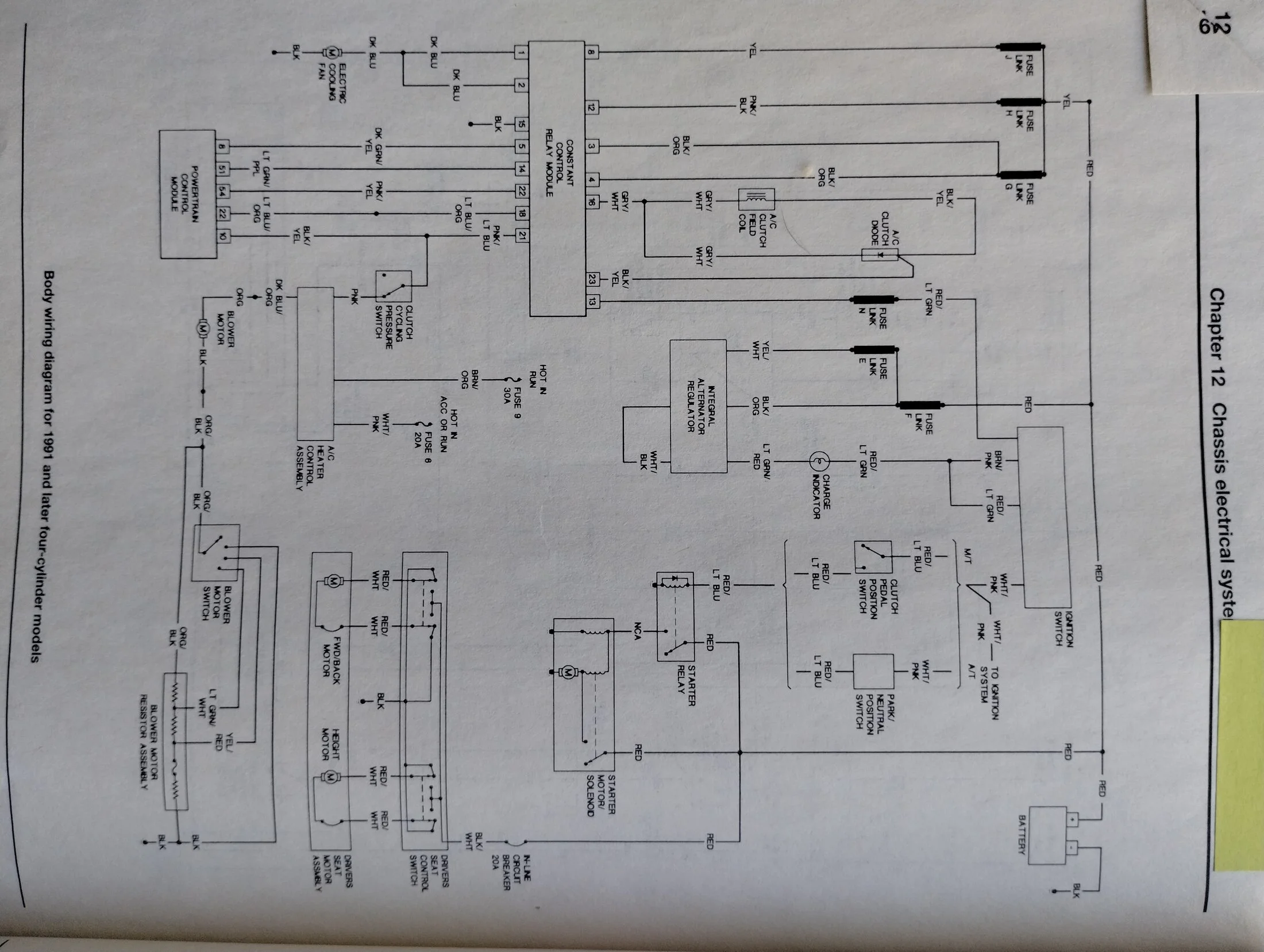

Likely won't help much, I looked, it covers V8 cars not L4 soooooo, back to looking, I have not found the thread on the Ron Frances wiring issues, got side tracked yesterday so back to looking.

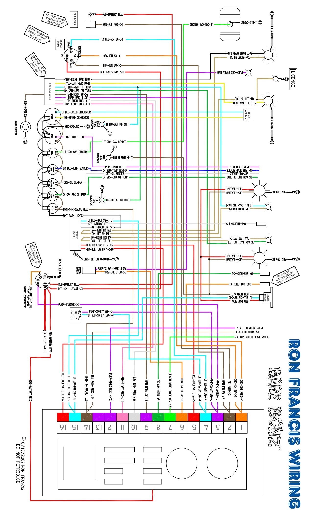

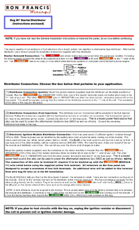

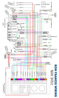

Here are the applicable diagrams and instructions

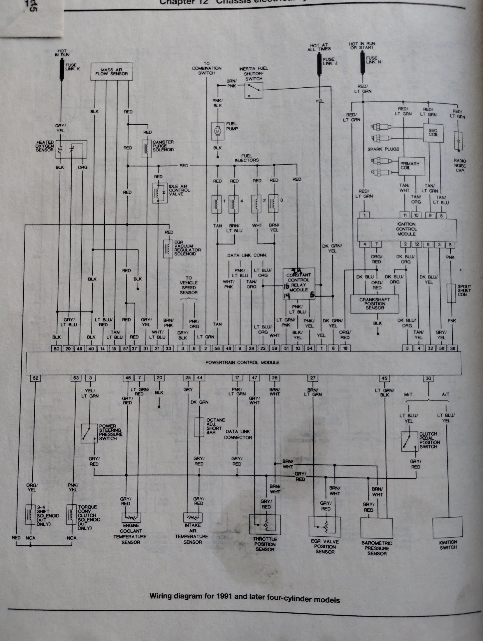

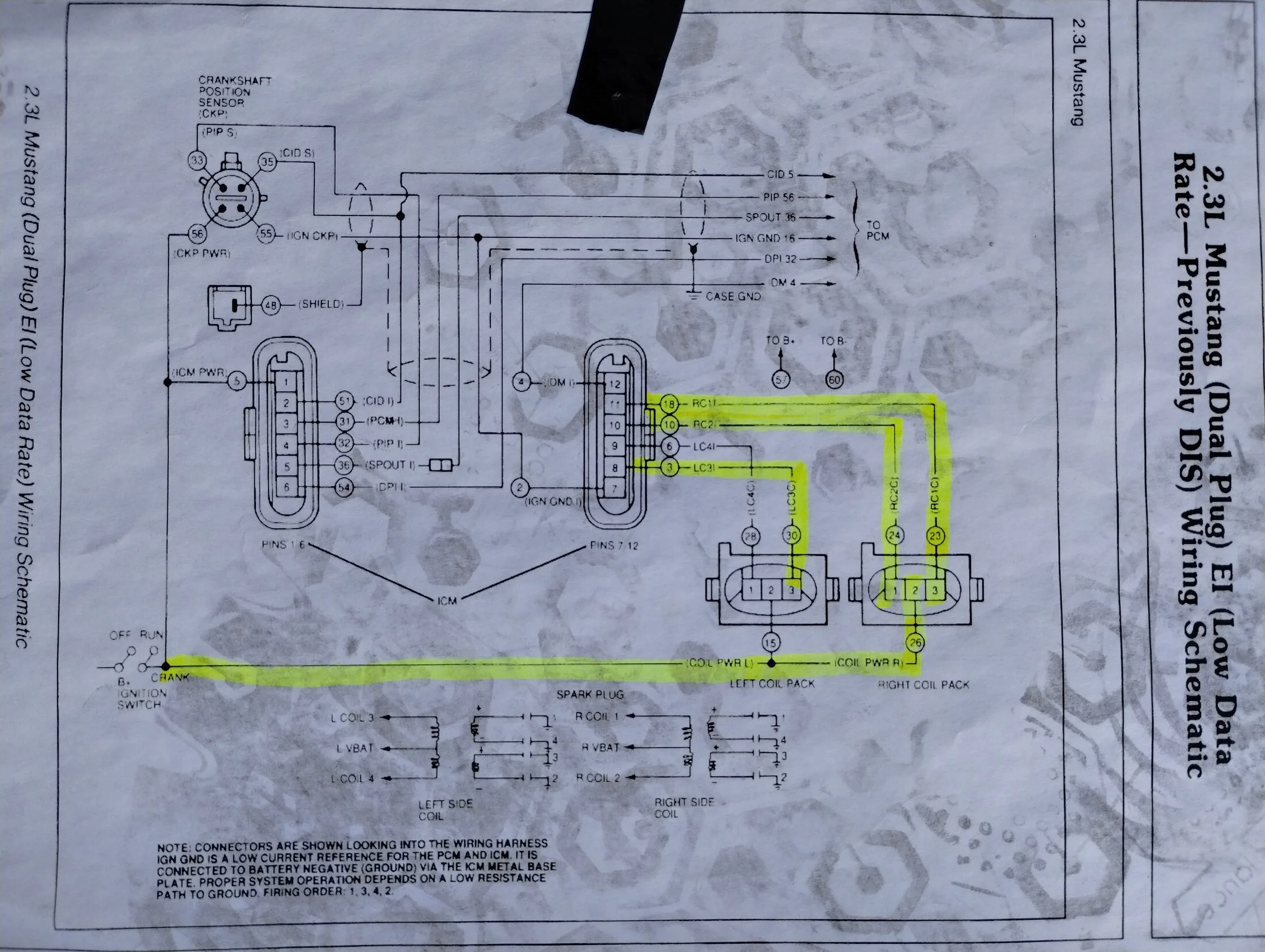

Okay, so you got a bare bonz kit and not one for the fuel injection. I do not know if they make one for the four cylinder injection but I would have been more prone to try and make the V8 injection harness work with the 4 cylinder than this.
You are going to need the Ford wiring diagrams for the 1993 4 cylinder to marry these two together and get this working. Am I correct in assuming you do not have them?

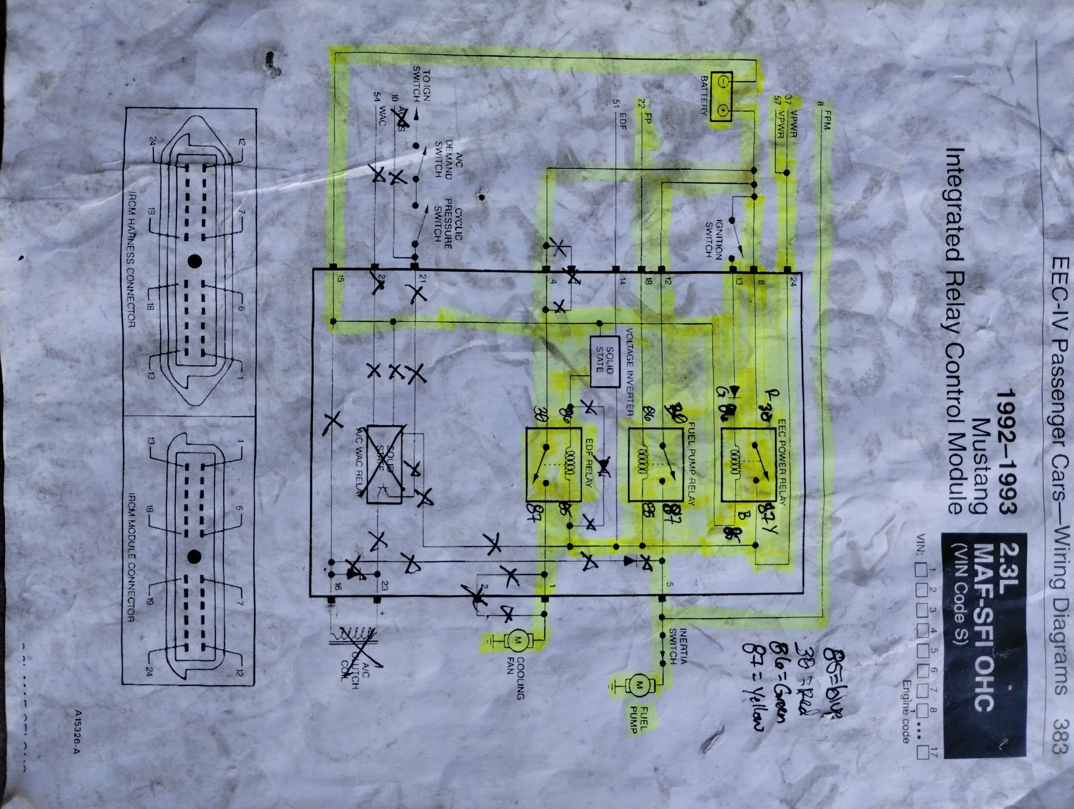

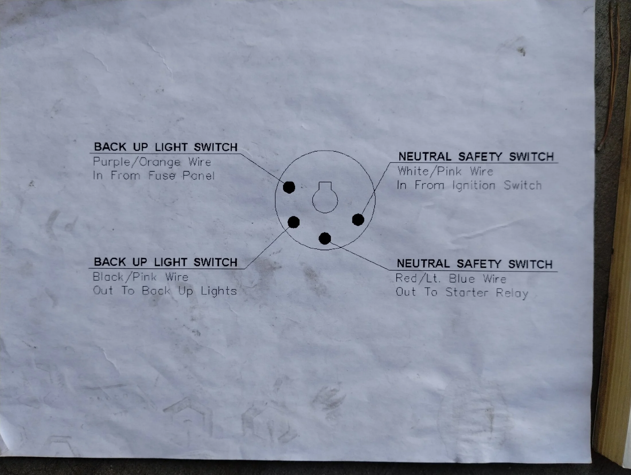

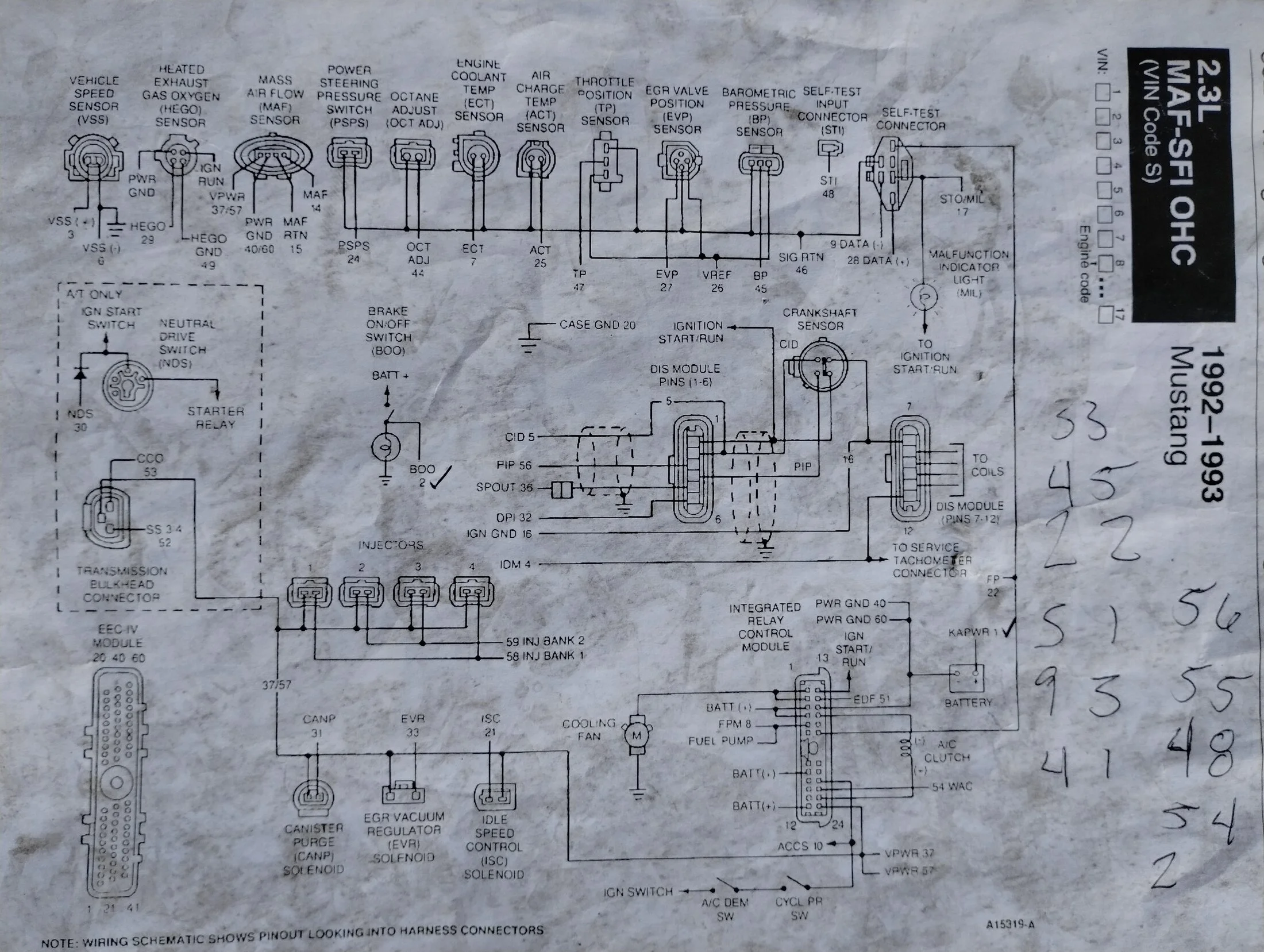

Here are the rest

I double checked on the rf site, they had options for fuel injected no distributor bare bonz which was what I thought I had got. Otherwise it would've been a kit for the 2.3 turbo which I don't have
