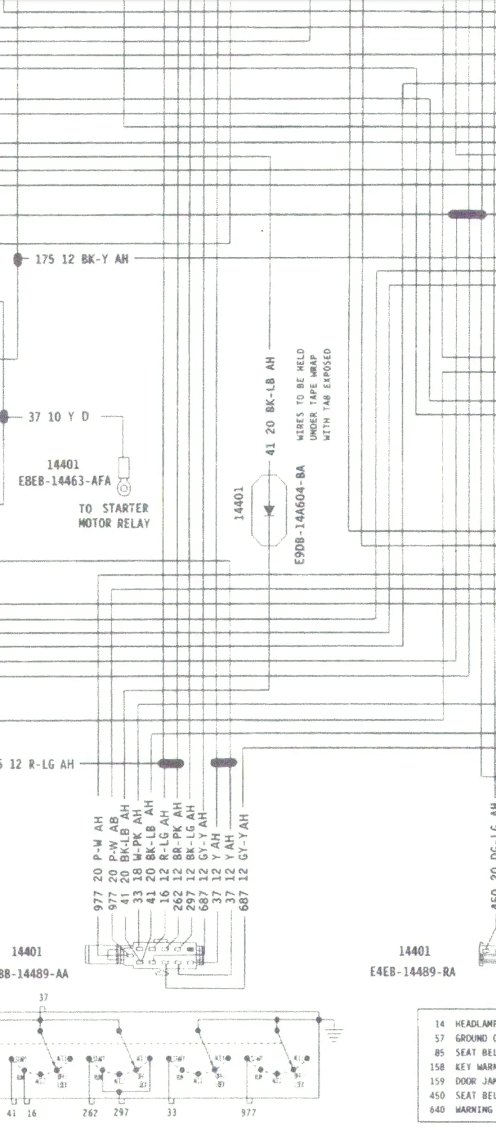

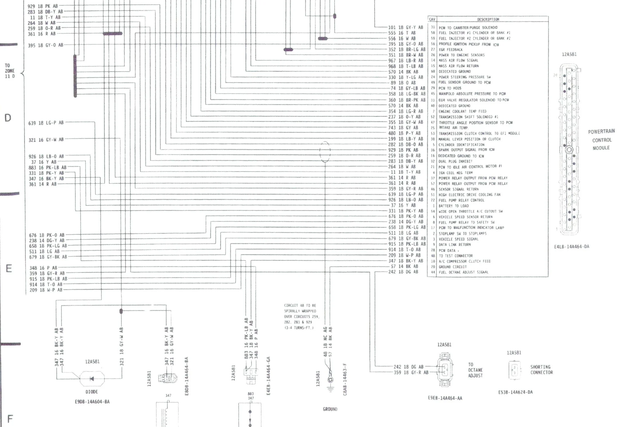

Got the diagrams printed. Lol you weren't kidding, even on 11x17 I'm still breaking out my magnifying glass. Going to start checking everything. Don't see this going quickly so it'll probably be at least a few days before I finish. I will let you guys know what I find!

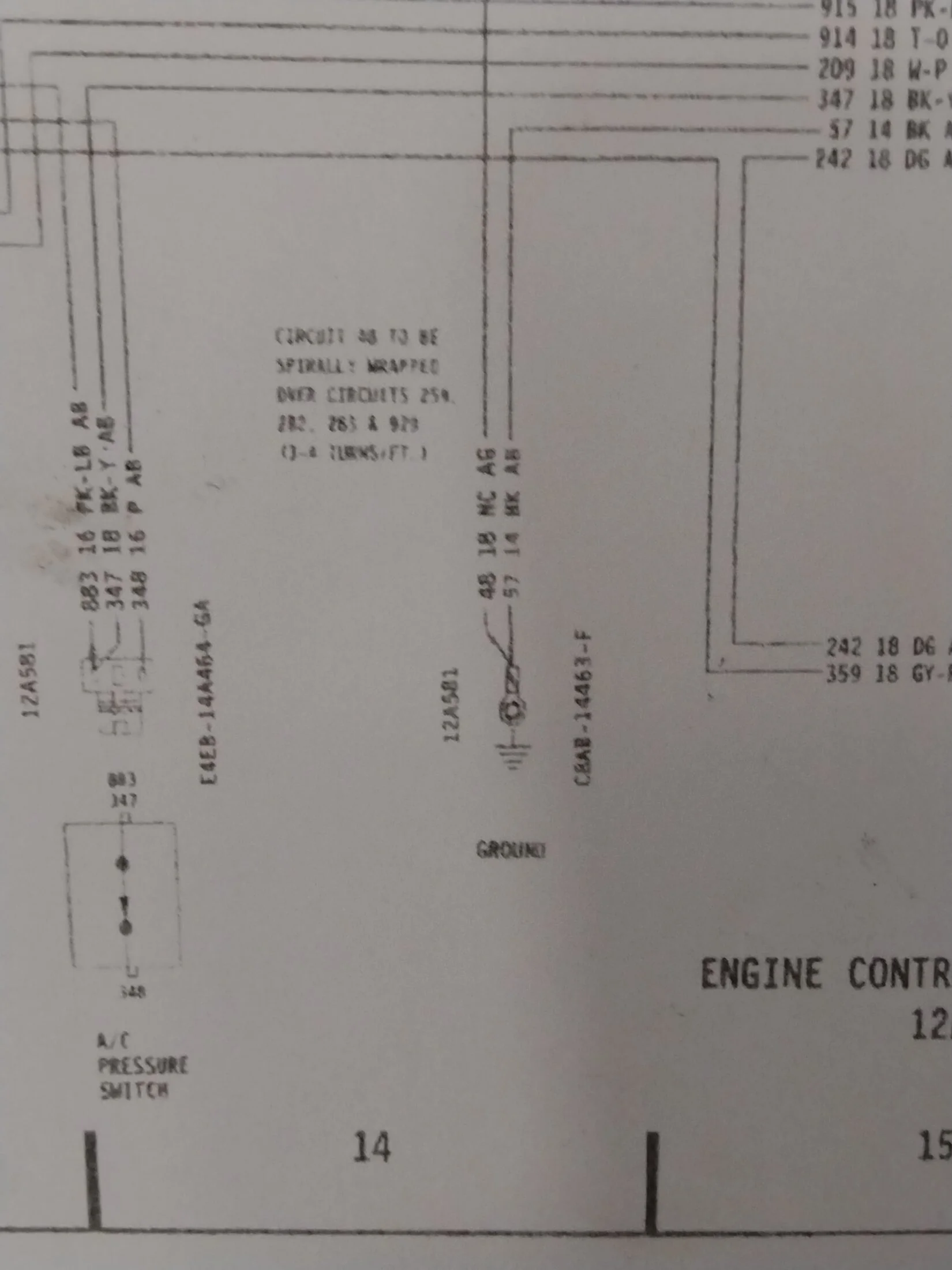

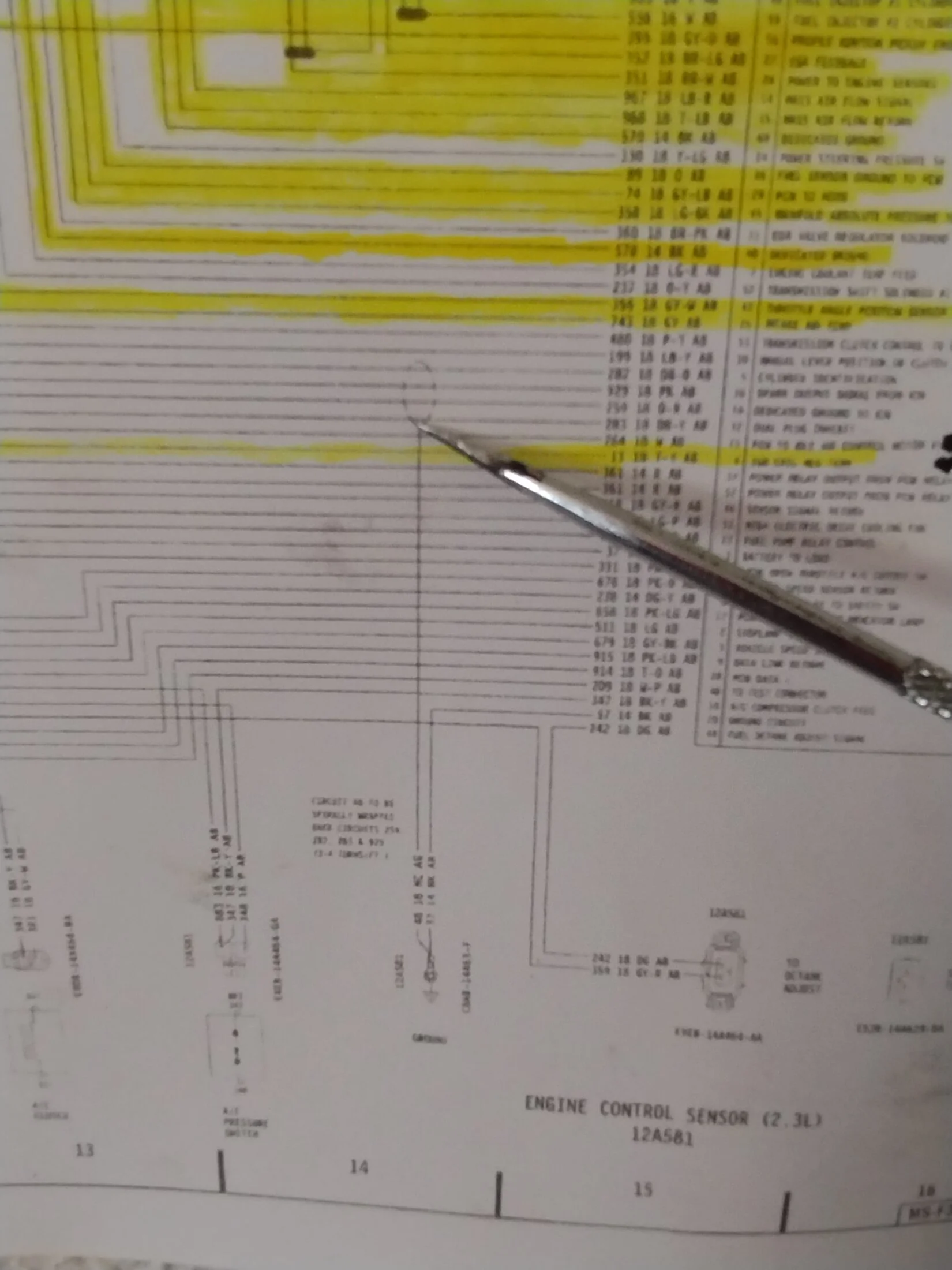

Not sure what I'm supposed to do here. Anyone care to explain? What does the circle around the wires connecting to ground do? Am I just supposed to wrap bare ground wire around them? And how much/what gauge? Otherwise I've found a couple errors on the ignition connector and an error on the manufacturer diagram (lol) but nothing that's "eureka" worthy

The dotted circle indicates a grounded shield or shields around each or the combined bundle of the encircled wires.
Often, these wires are grounded through the metal backshells of a particular connector. This portion may not apply in an automotive application though. :chin
I can't see in the image where the diagram goes. It usually goes to ground. Sometimes through a diode and then to ground.
Reactions: joystang
It connects to the same ground point as ecc pin 20, don't see any diode on the diagram

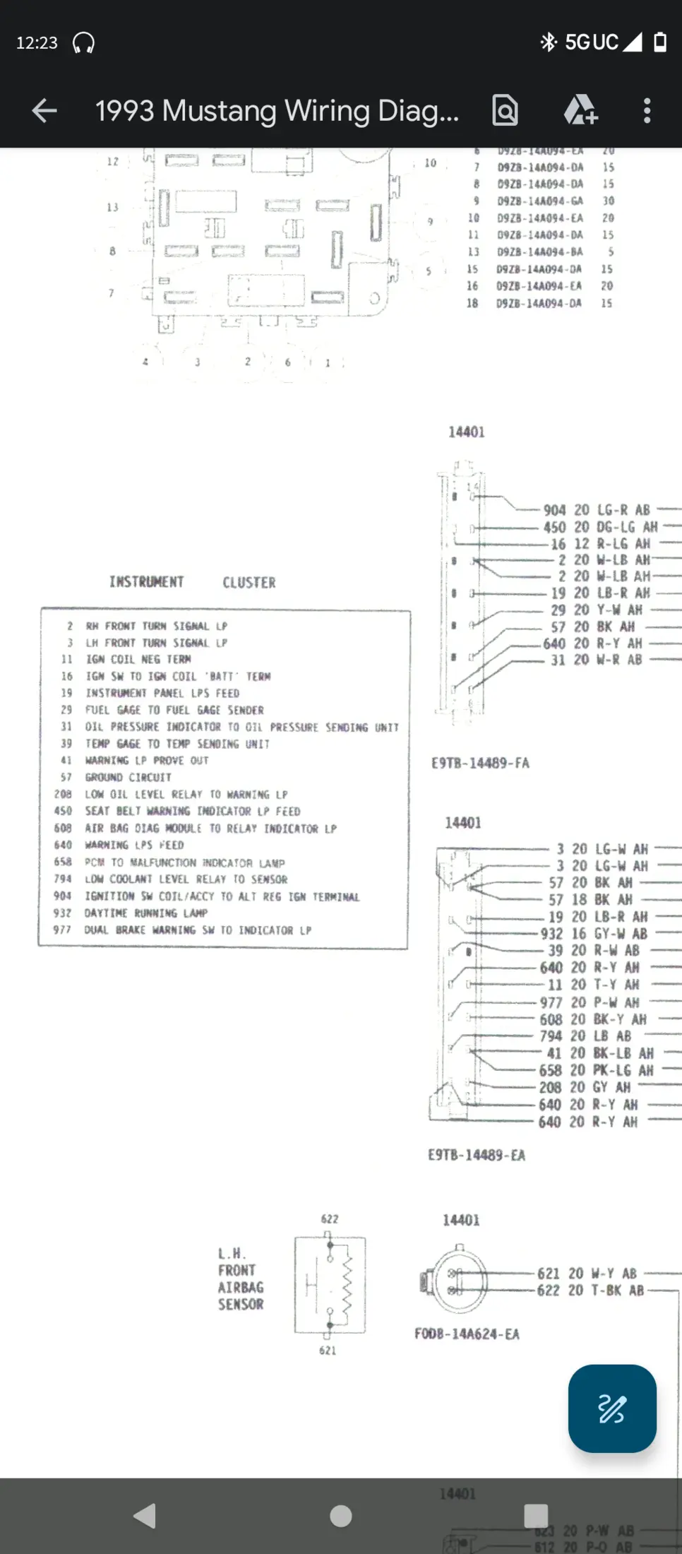

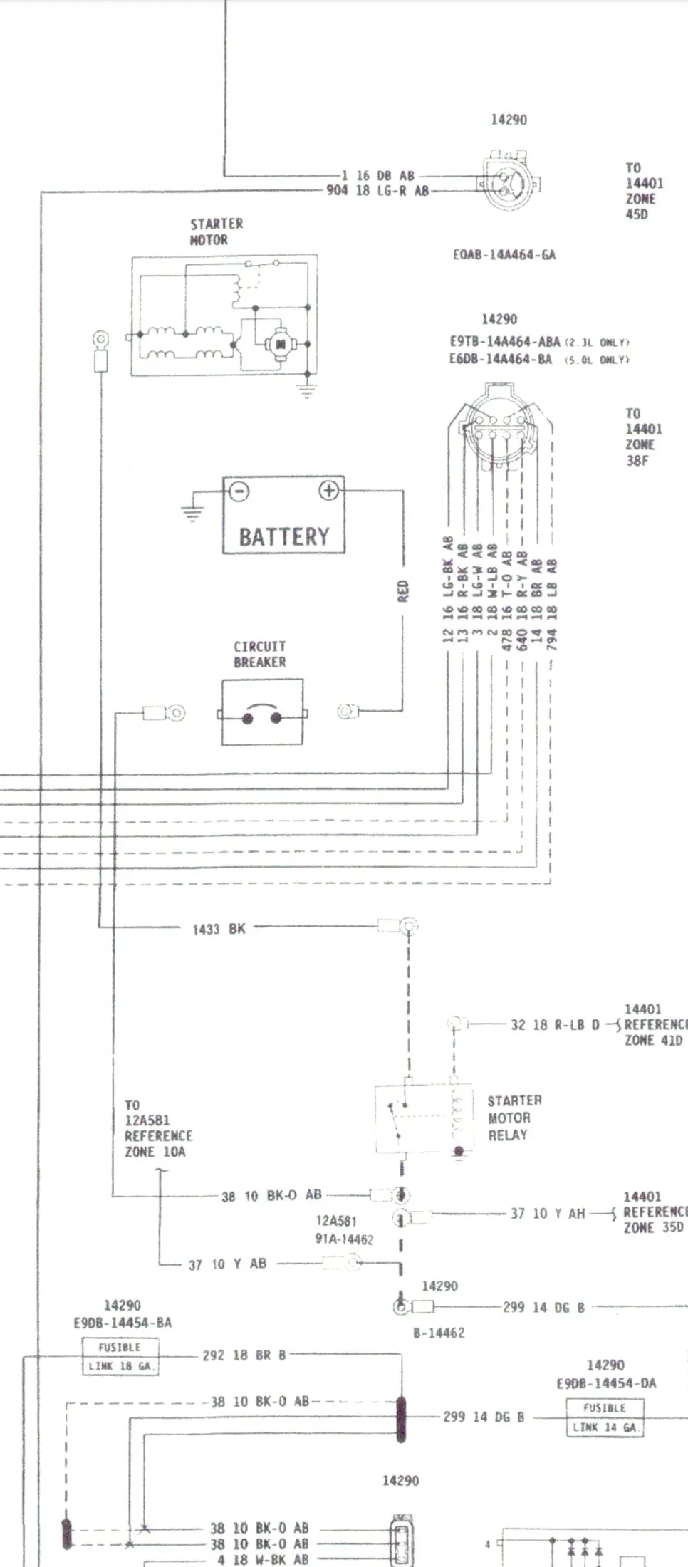

Anyone know the part number for the circuit breaker and the amperage for the diode in the pictures? I tried looking up both the numbers for the diode and got nothing and there is nothing to lookup on the circuit breaker. Diode is for #41 on the instrument panel (warning LP prove out)
