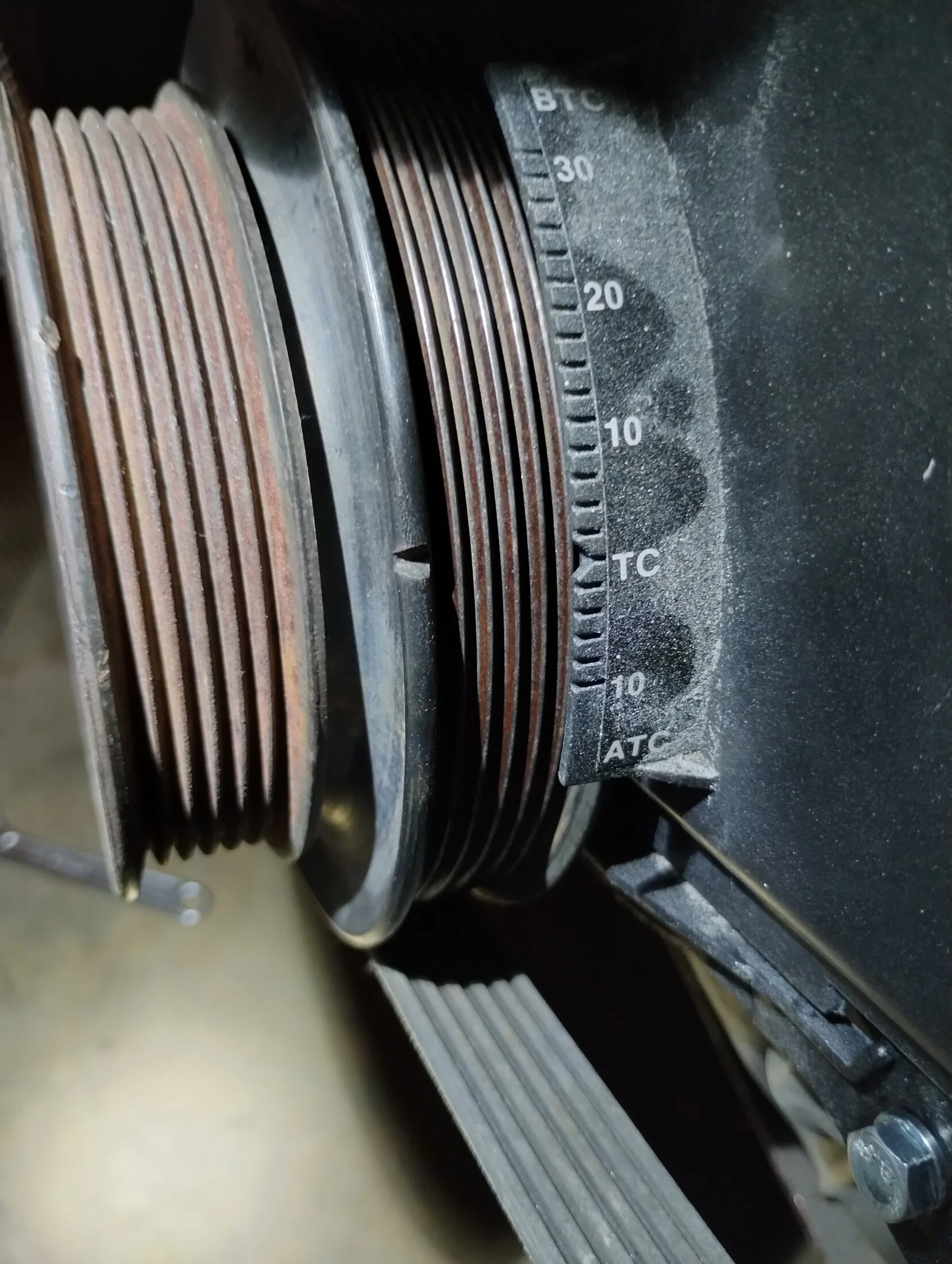

Timing is spot on, all injectors are getting signals, all plugs are firing.

This is weird for a 2.3. The reverse lights should not come on when pushing the shifter up in park. Are you 100% sure your timing isn't 180° out. Air, spark, compression, and fuel is all it should take. Even if injectors weren't firing it should light off with a hit of starter fluid.

I'm 99.9% sure the timing is not 180° (no distributor, not sure how it could be set 180°) but I will check it again tonight after work.

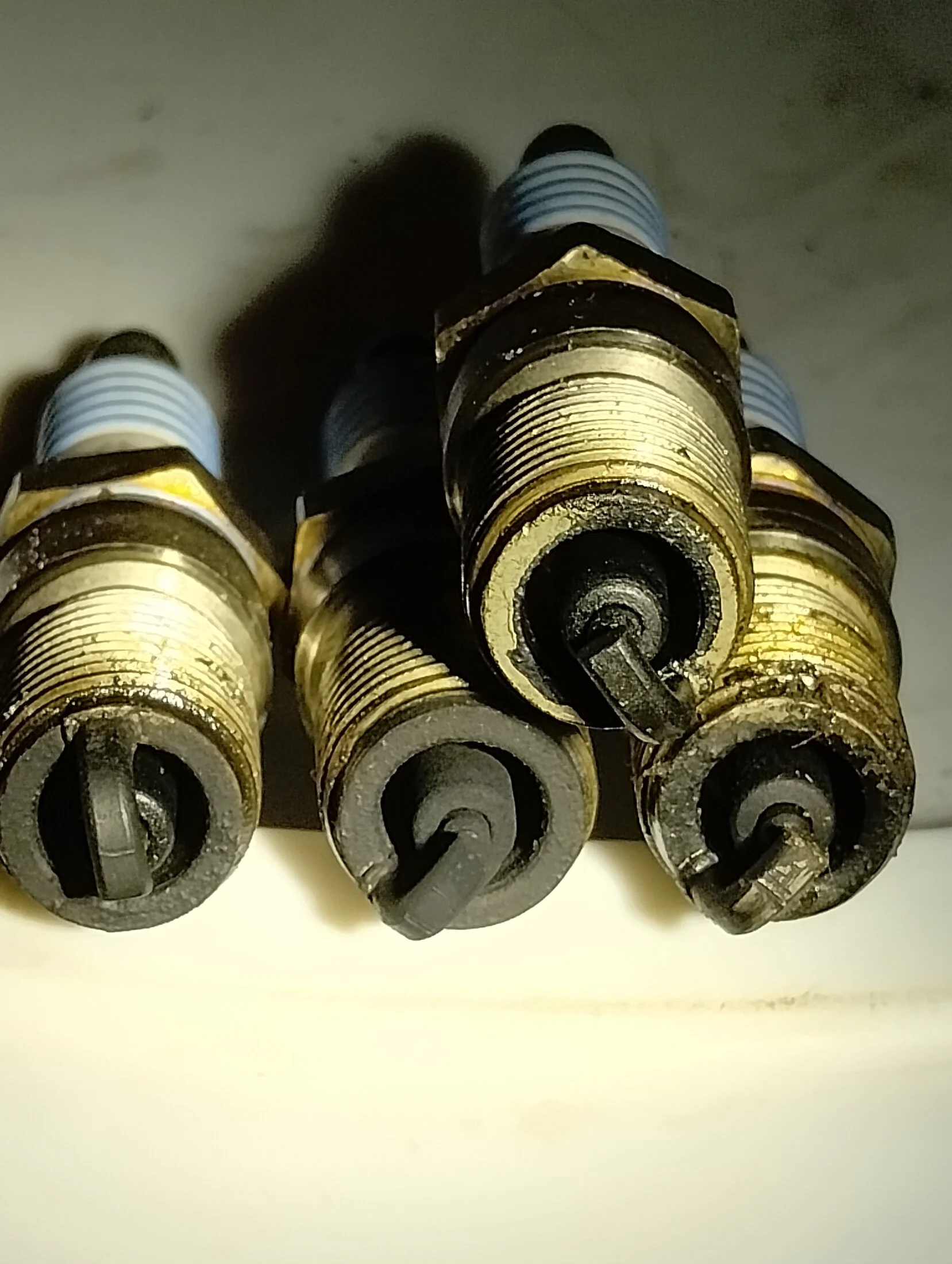

What color is the spark? Are the plugs black and dry or clean but wet?

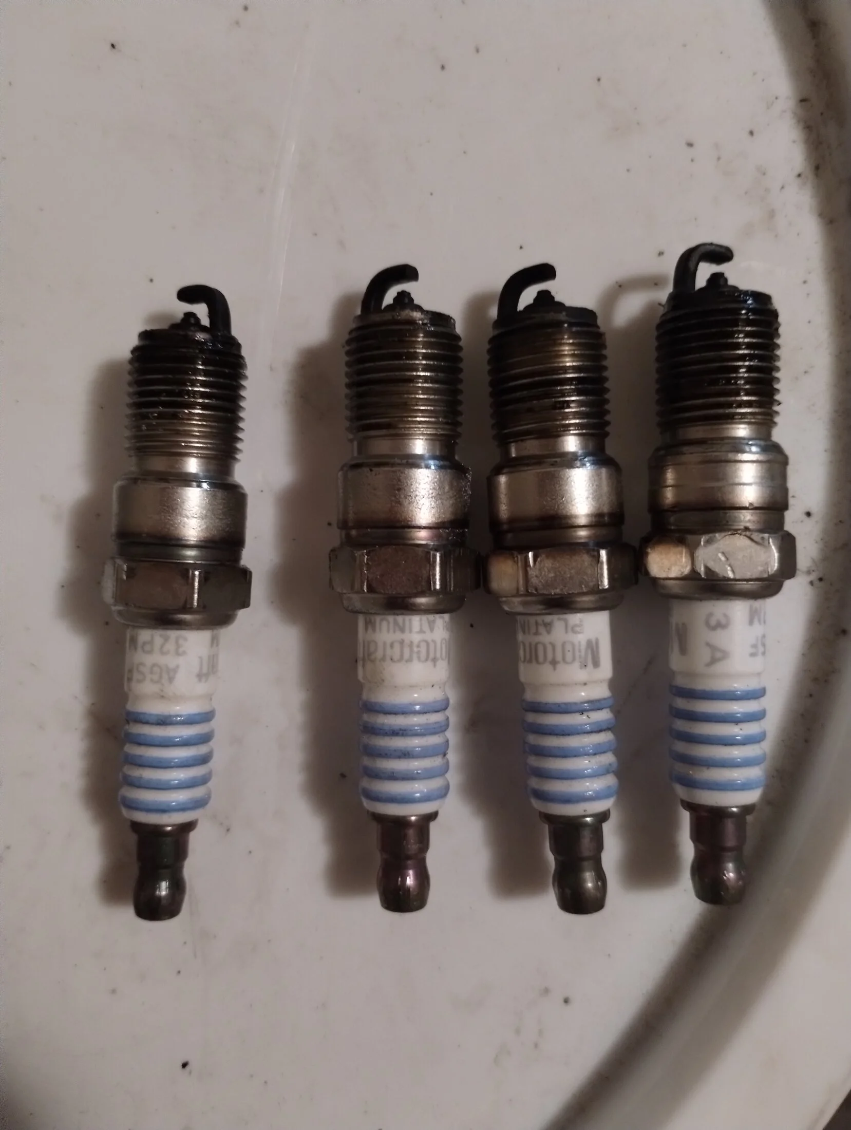

I'll try and get a picture of the spark tester going off when I get home. I've never seen the tester have a blue spark but it is good sized and bright orange. When I pulled the plugs they were black, I didn't touch them to see if they were dry or wet, I just wiped the exhaust side clean. I will check the intake side to see if they're wet or not.

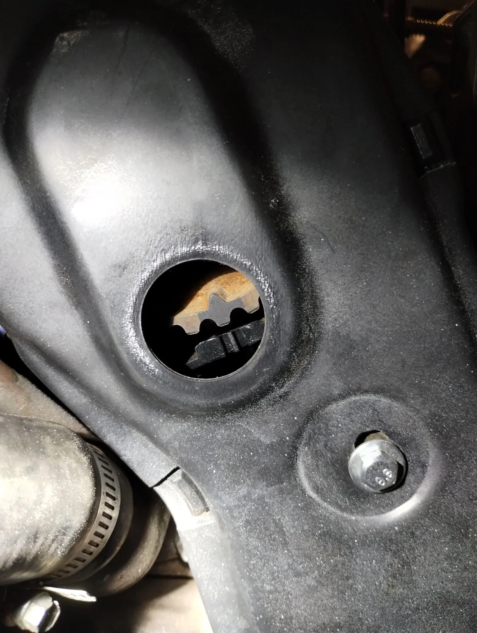

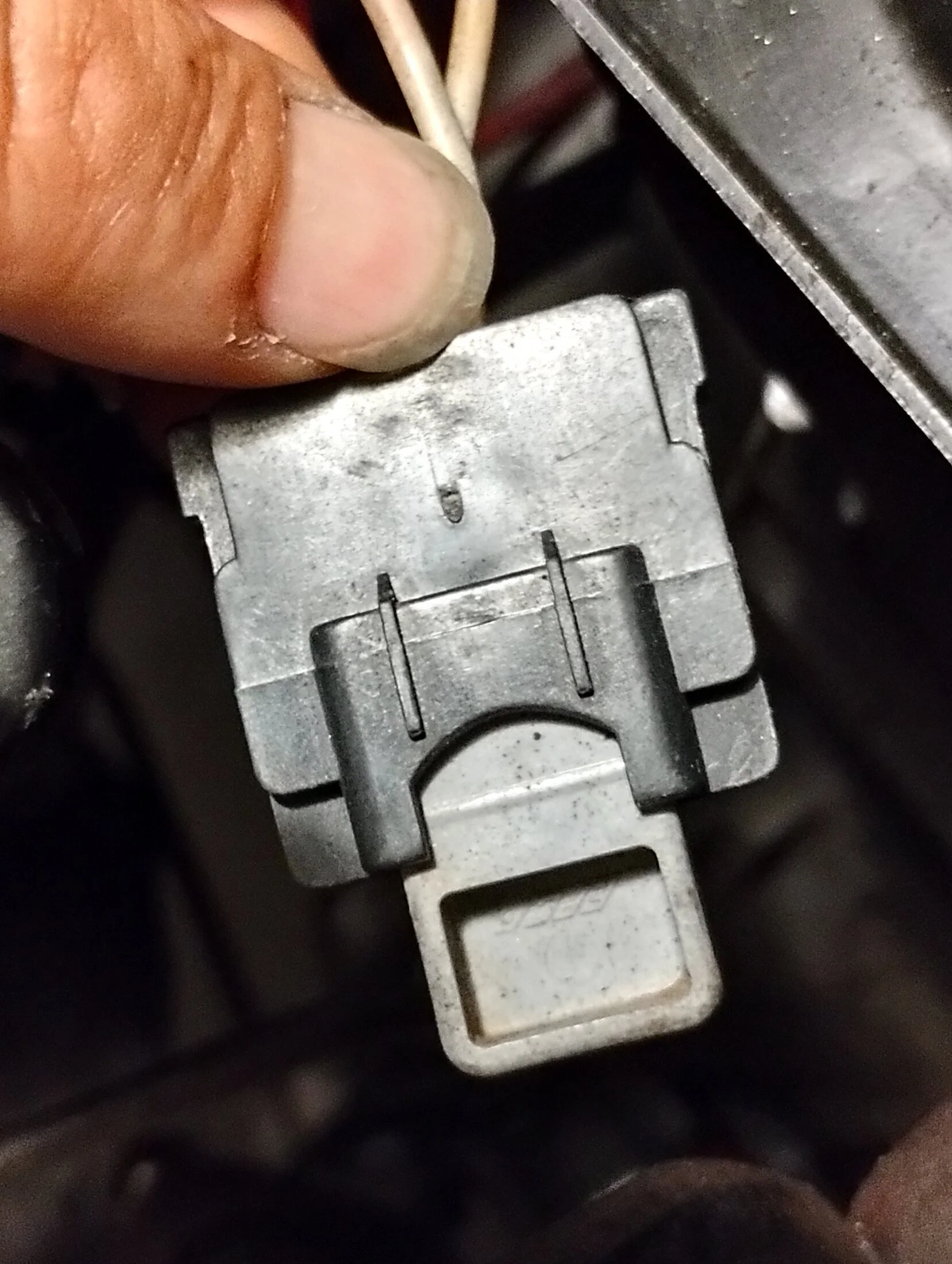

Alright here are pics of the intake spark plugs (the one on top of the other 3 is cleaner because I rubbed it) and what I believe is the spout.

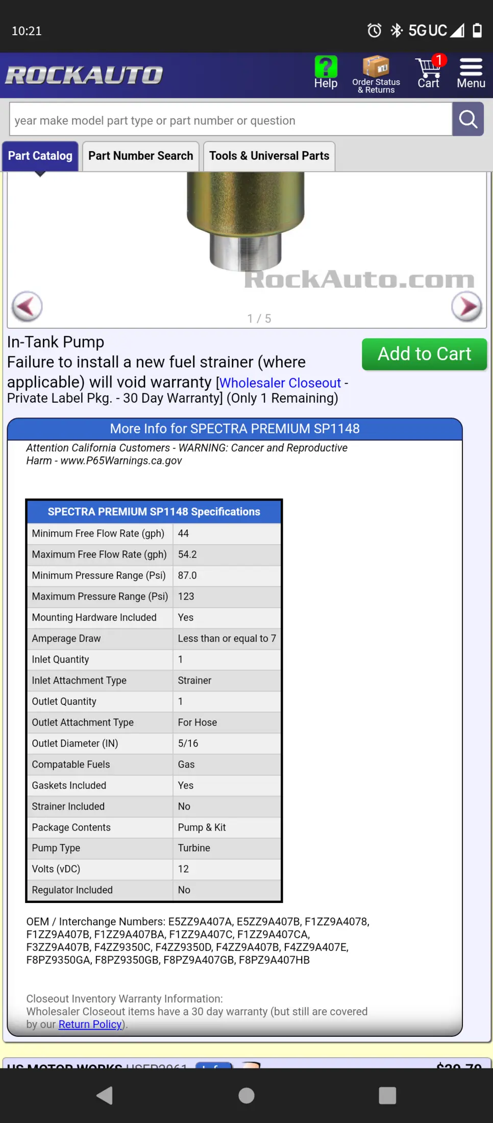

Lmao so I think we have uncovered the problem! After testing, doubting the functionality of the tester, typing up a good length post here ending with my current pumps specs when it smacked me like a pissed off ex... I had not payed attention to the pressure when I bought the Edelbrock 38gph universal pump because I was focused on the gph/lph. Pump operates at 4-7psi :doh:. Lol guess that's what I get for being human. Now that that mistake has been uncovered, any suggestions on a pump? It needs to be external (current tank won't take a internal one). I have the mustang stock fuel filter, injectors and rail installed.

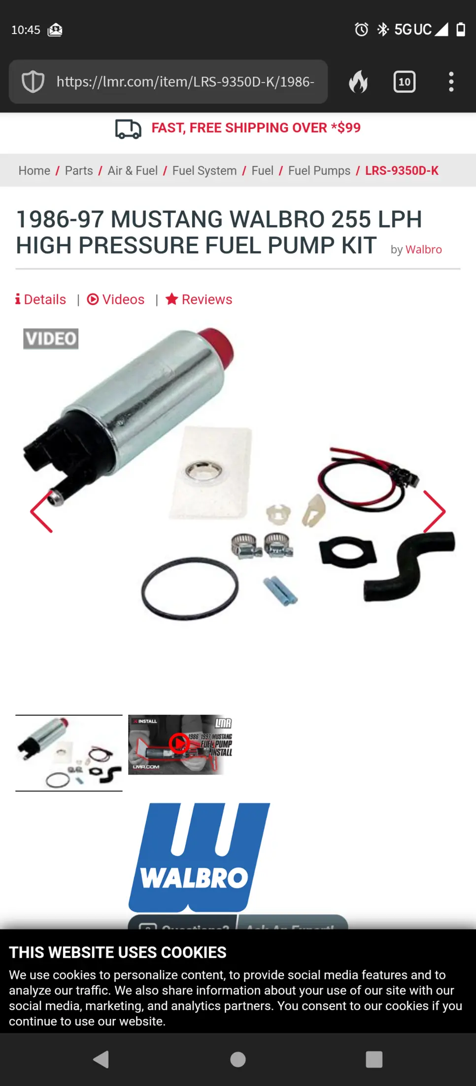

So far I have not been able to locate definitive specs for the OEM fuel pump. I think this is the part number F1ZZ-9A407-CA, but no one lists flow rate or psi. Went on Rock Auto and found one I think is correct or at least close.

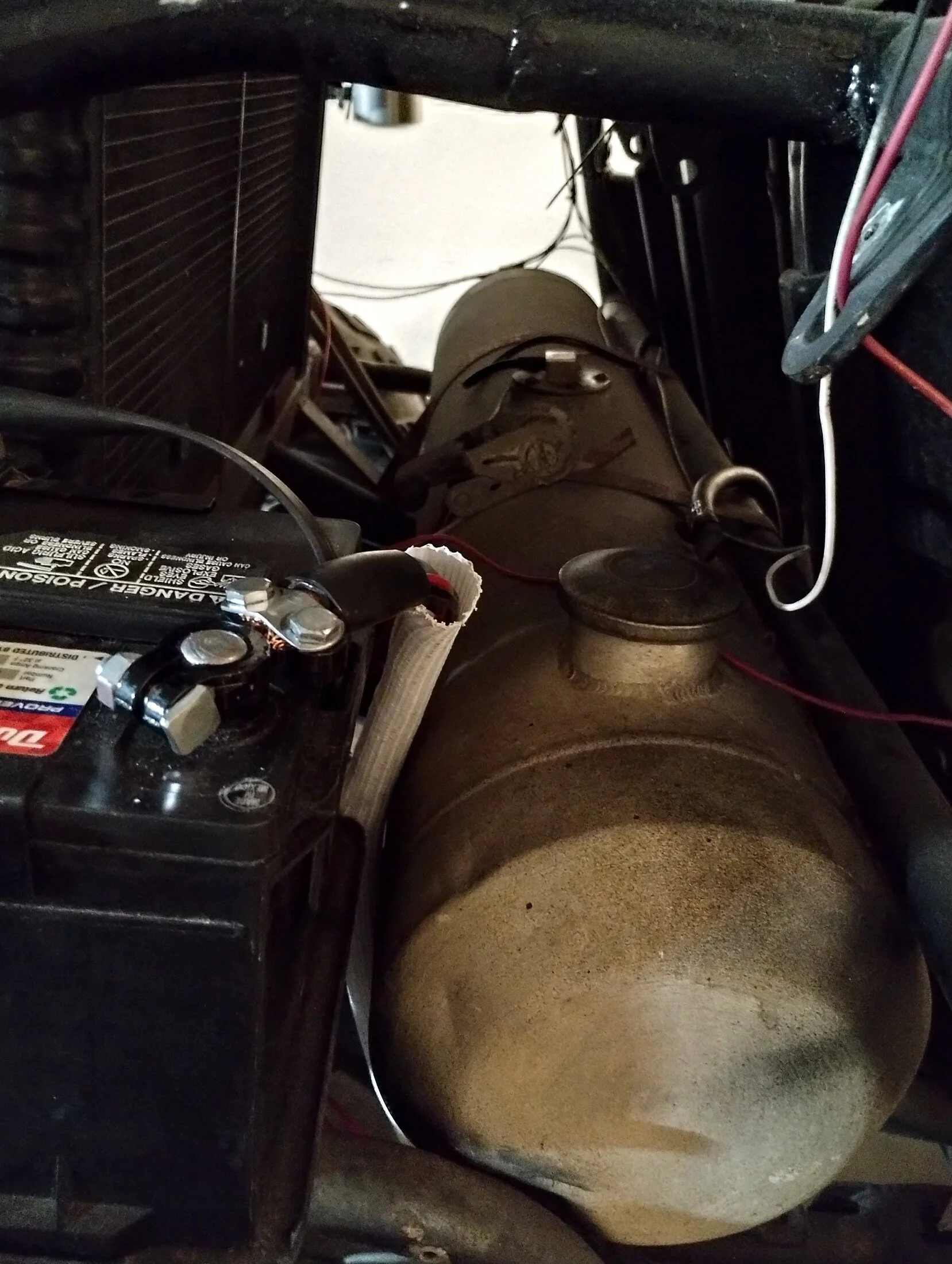

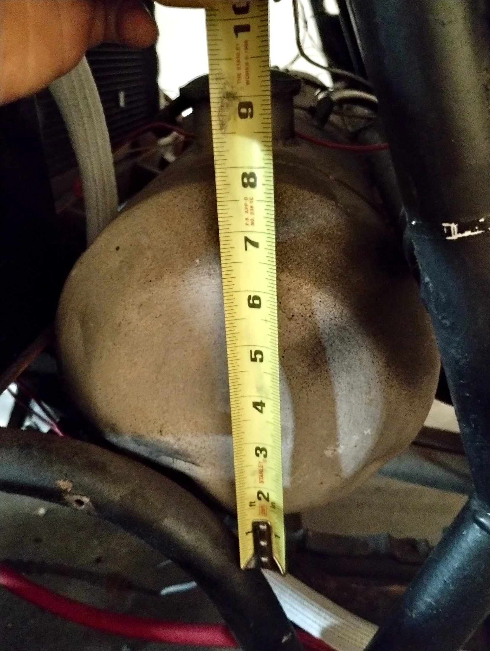

Unless I'm looking at the wrong pump or it can be mounted externally, that won't work with my current tank. The tank I have is too small to fit an internal fuel pump. I will go take some pictures of my tank and post them in a little bit.
