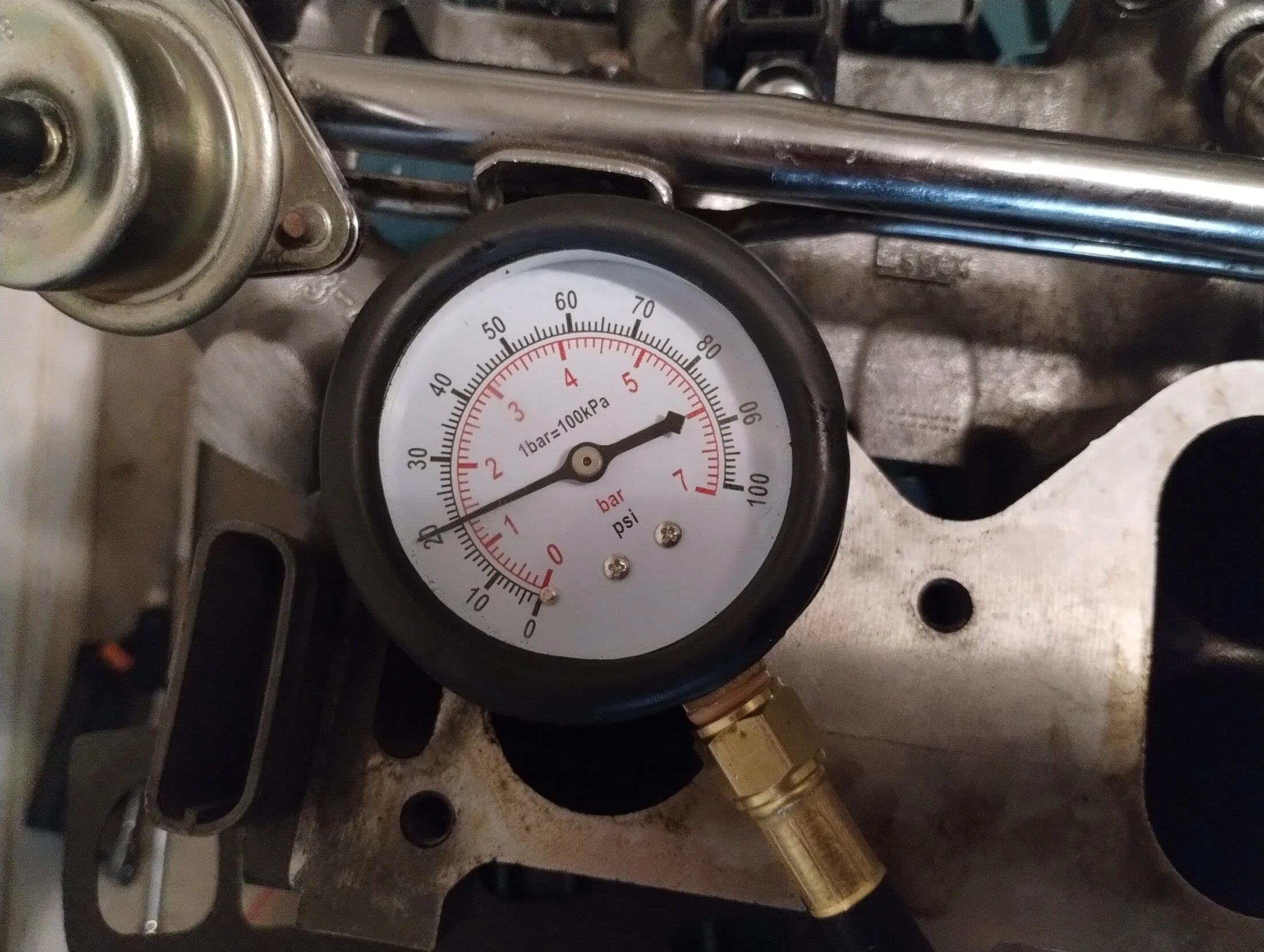

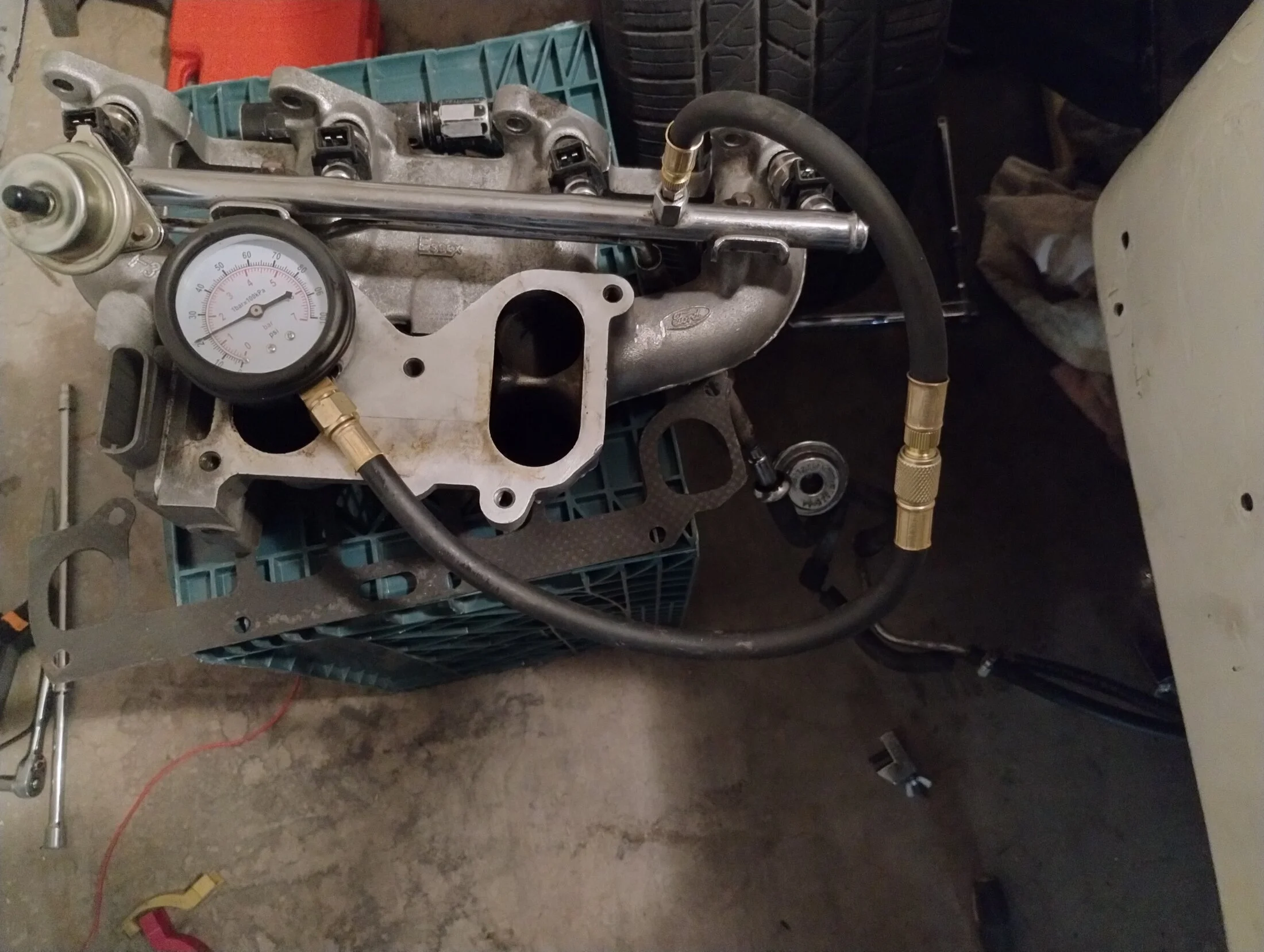

Removed intake and fuel rail to check if any of the injectors were leaking when I hit a snag. I couldn't get the fuel pressure above 20psi (fp regulator issue?). I included pics of the setup and the reading on the gauge. It's still set up so I can take additional pics if the one I included is :poo:lol.
Tested the spray of all the injectors @ 20psi for about 2 seconds, none of them registered a drop in pressure on the gauge even without re-pressurizing the line in between sprays (is that weird, I think it is...). Not sure what the spray pattern is supposed to look like but they looked uniform from what I could see. No leaks from any of the injectors after closing @ 20psi.

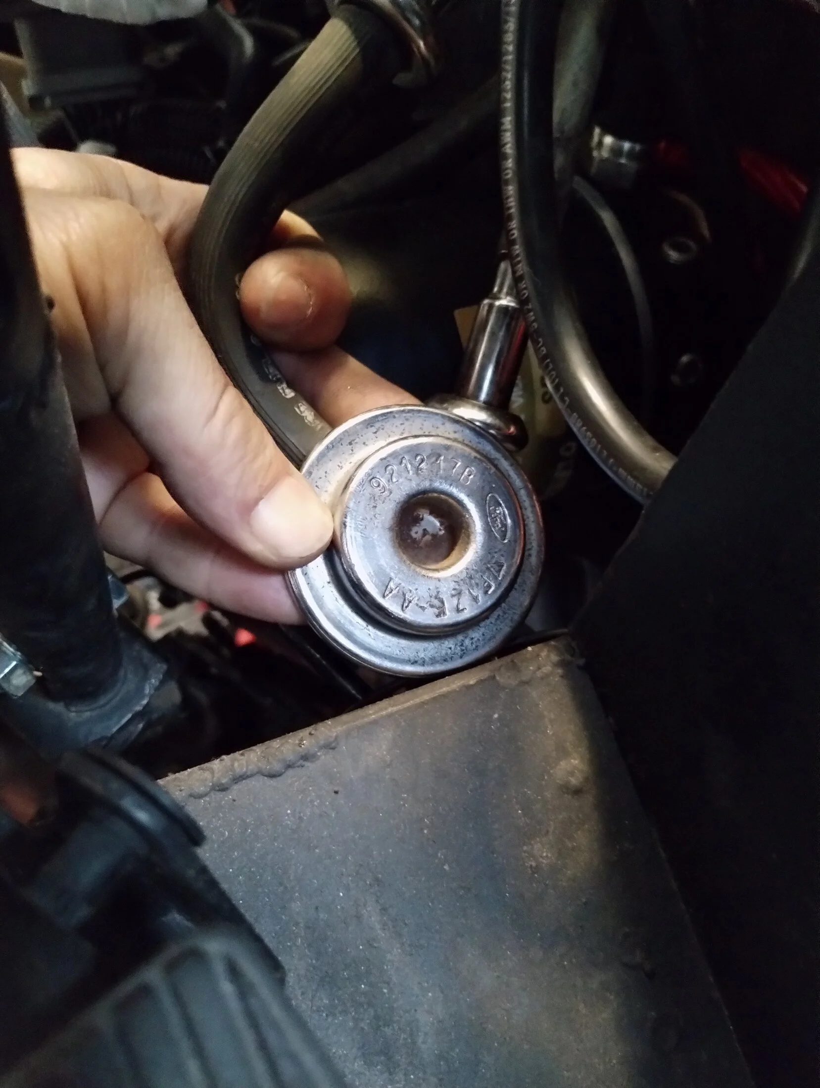

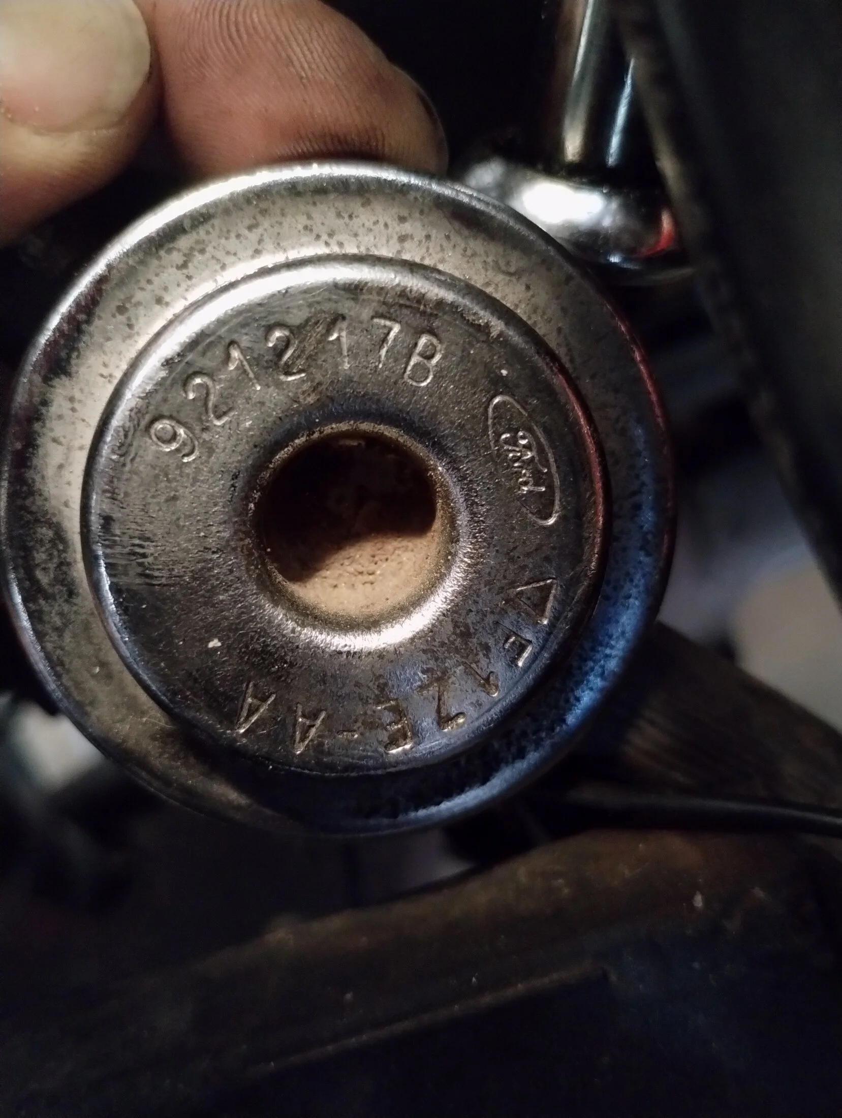

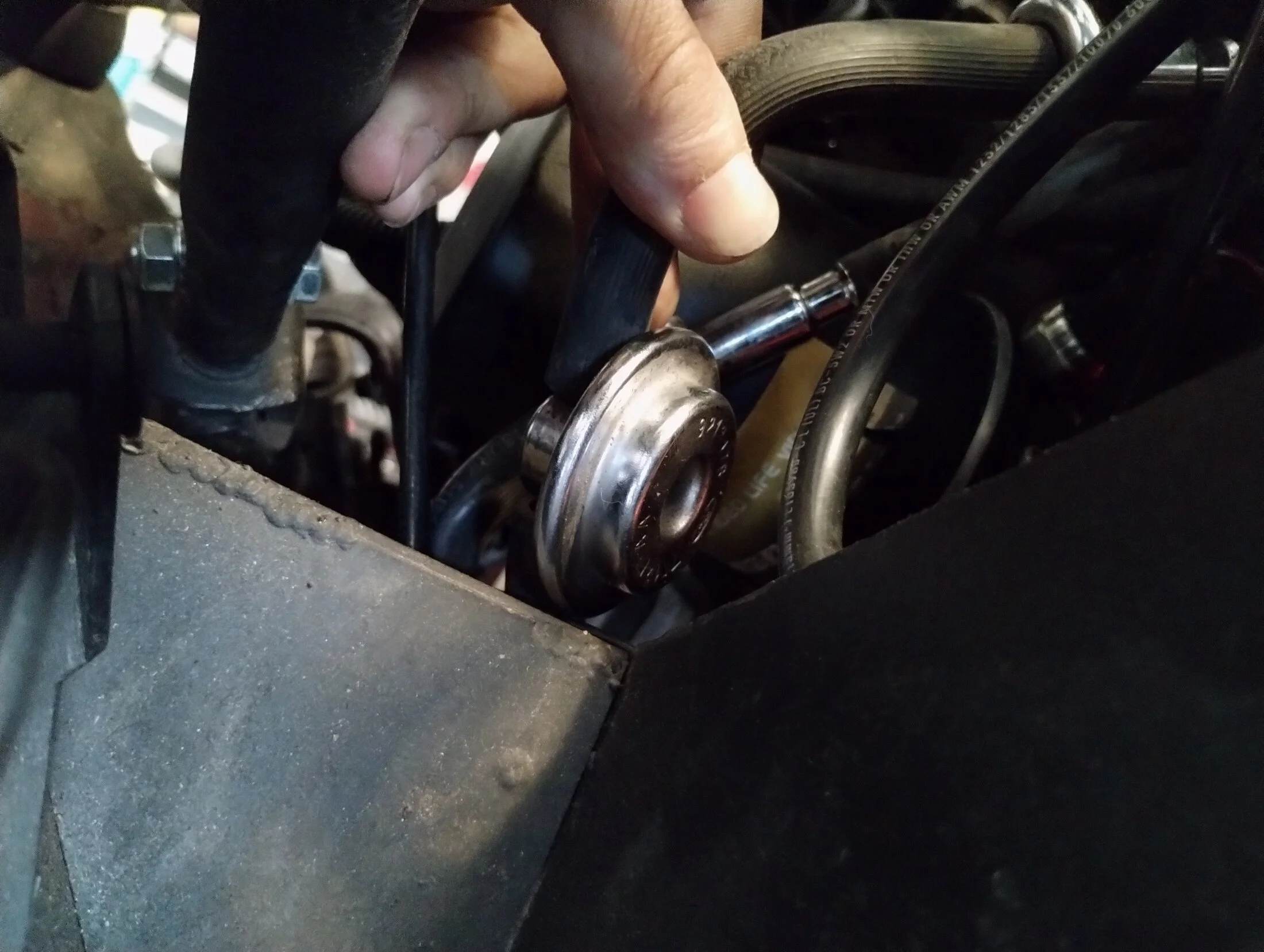

There's a silver diaphragm looking part on the inbound fuel line, could that be interfering with fuel pressure? Gotta look up what it is lol no idea what it is. I attached pics of the part in question. Fuel rail and lines are clear.

Looked up the part it seems to be a dampener for excess noise while the fuel pump is running? Does that sound correct?
I'm not sure that would cause an issue but I'm going to go and see if I can clean it out or try bypassing it and see if the pressure readings match without it.
