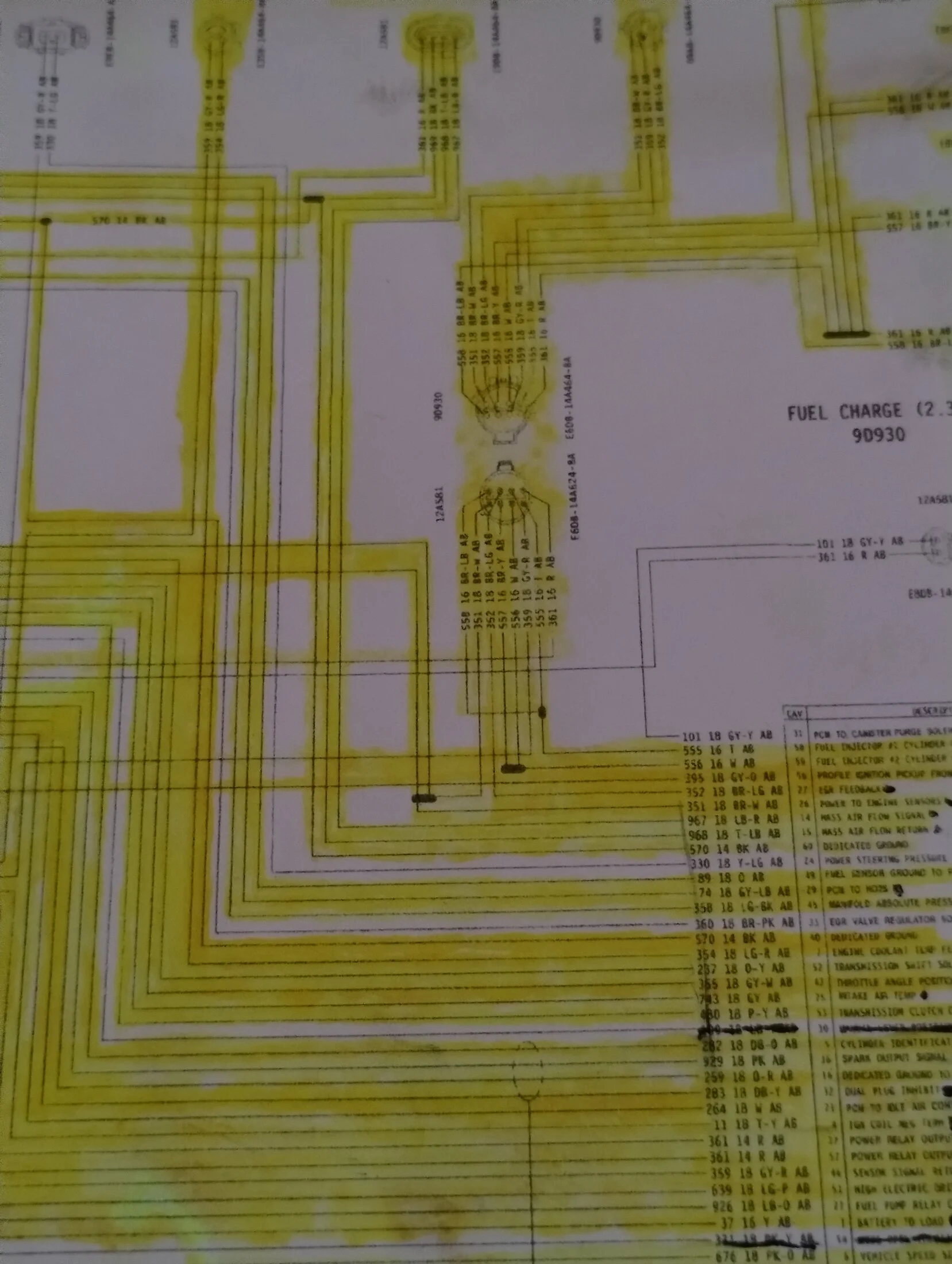

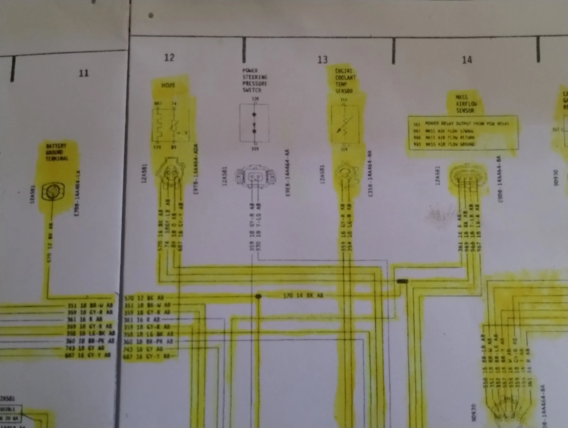

Checked the wiring diagrams from ford:
#40/#60/maf/ho2s all connect together and go to the battery - terminal (tried to get the best pic I could of it)
Heading back to the garage in a few to reroute the - batt cable and add the bell housing to frame

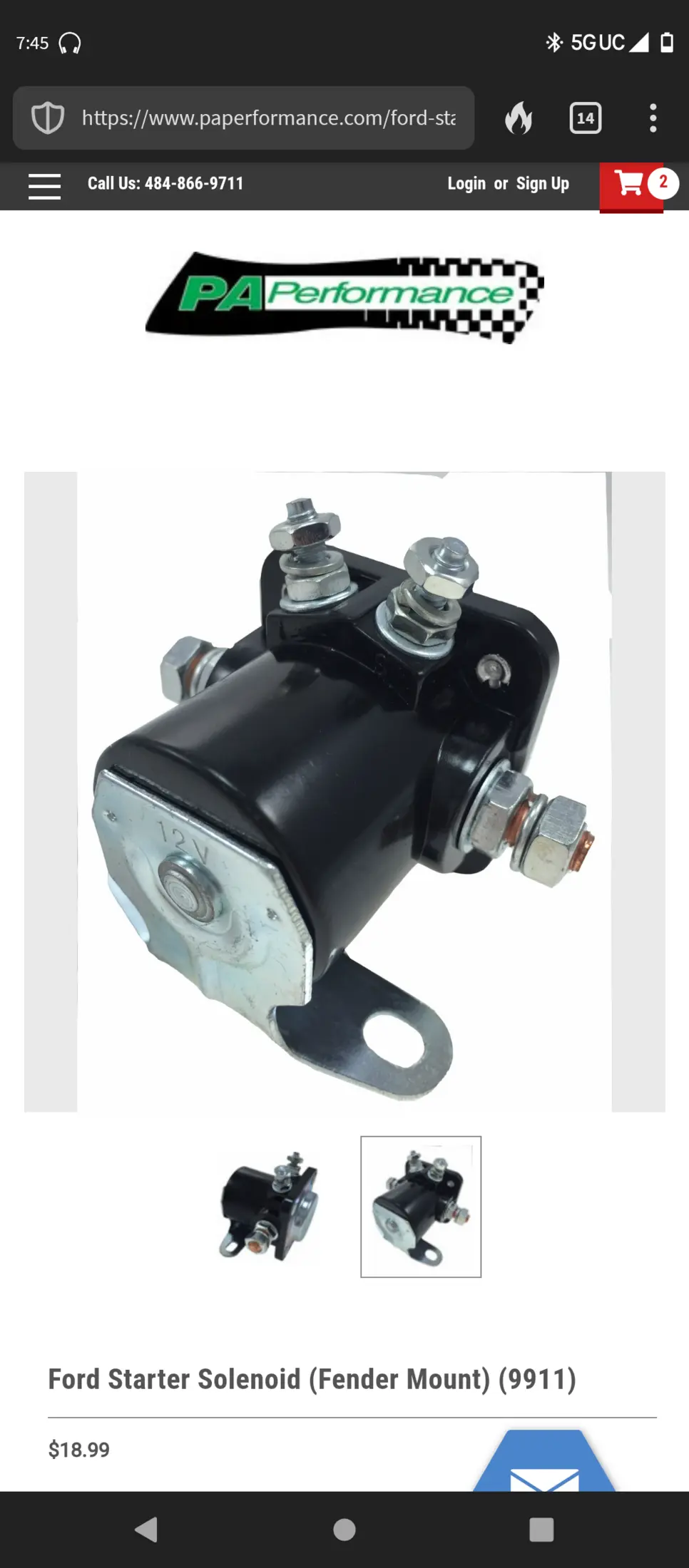

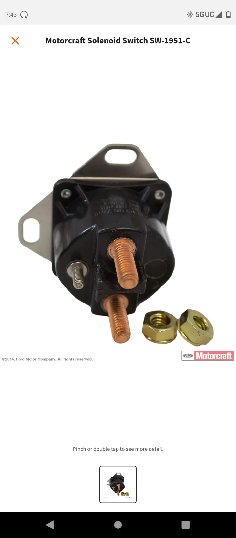

So I was checking out the link you posted and paperformance.com, I noticed they offer a different style fender mounted starter solenoid than what is currently on my vehicle. Mine has the posts coming out of the top of the solenoid while these are out of the side. Do I need to change mine to this style or does it not matter as long as the solenoid works?

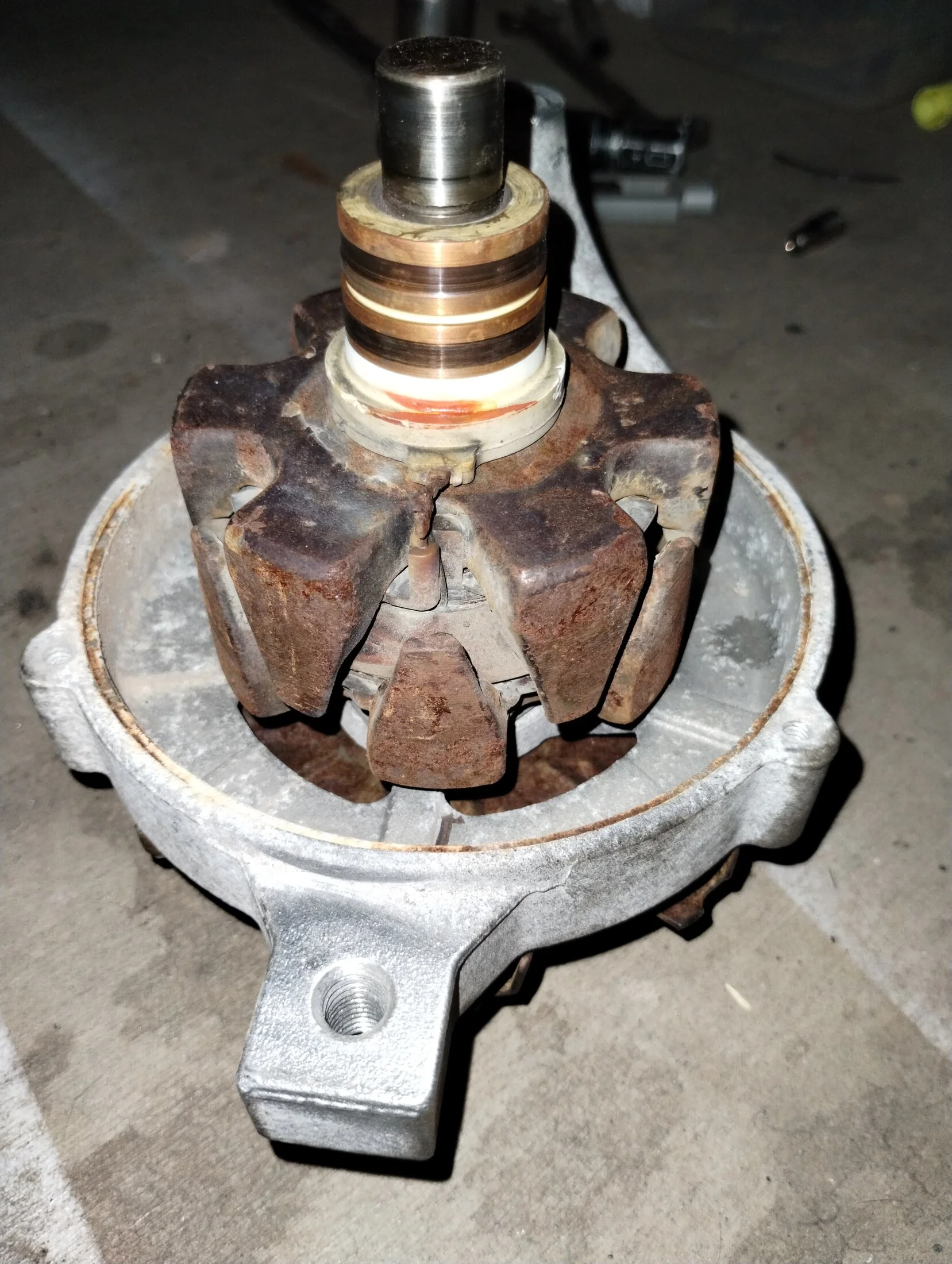

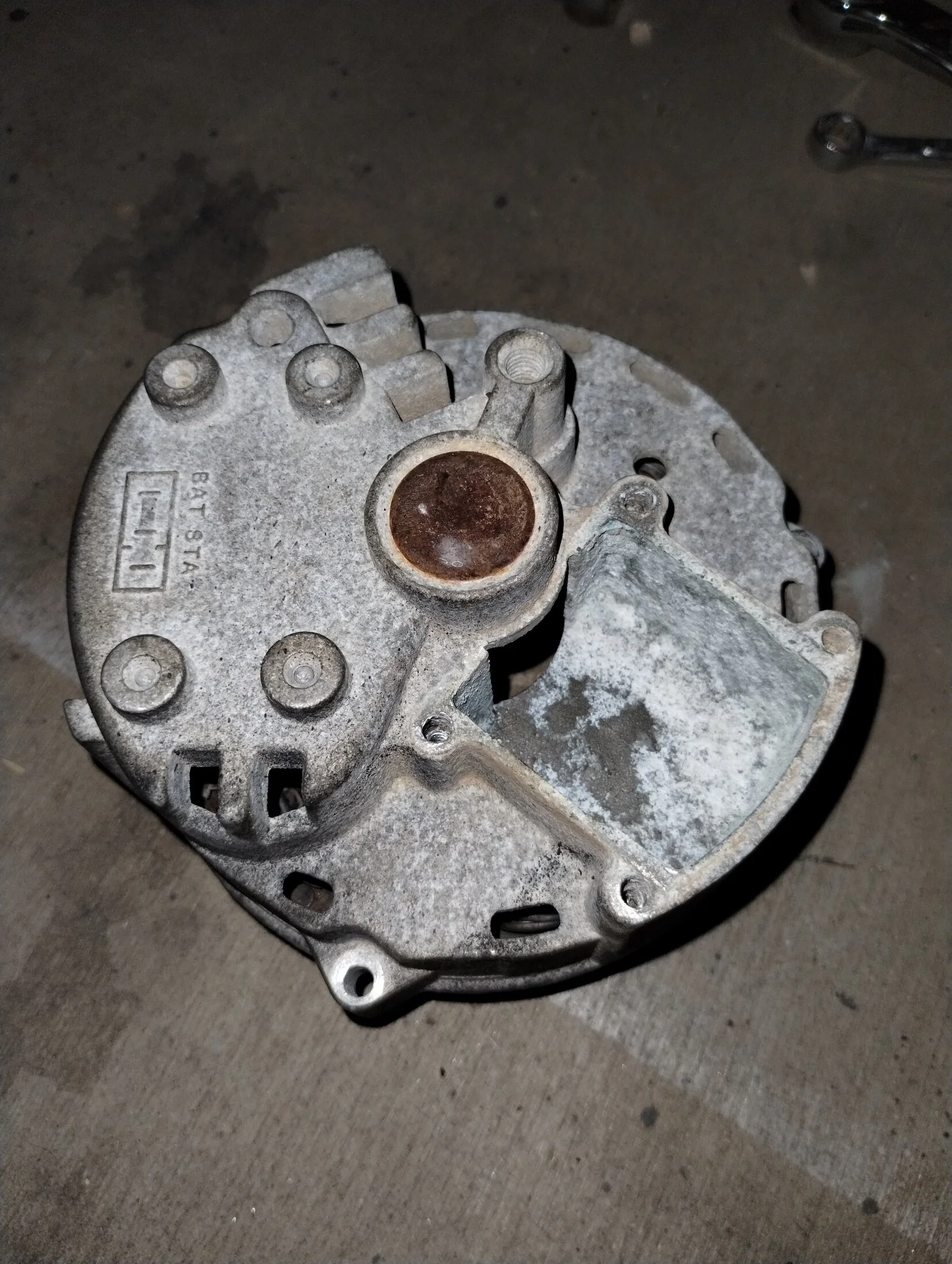

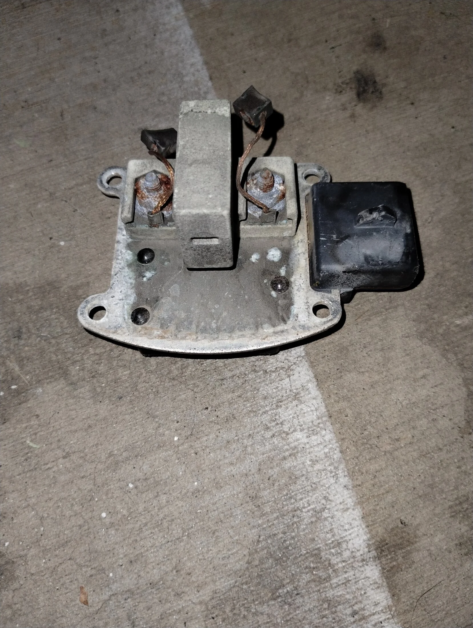

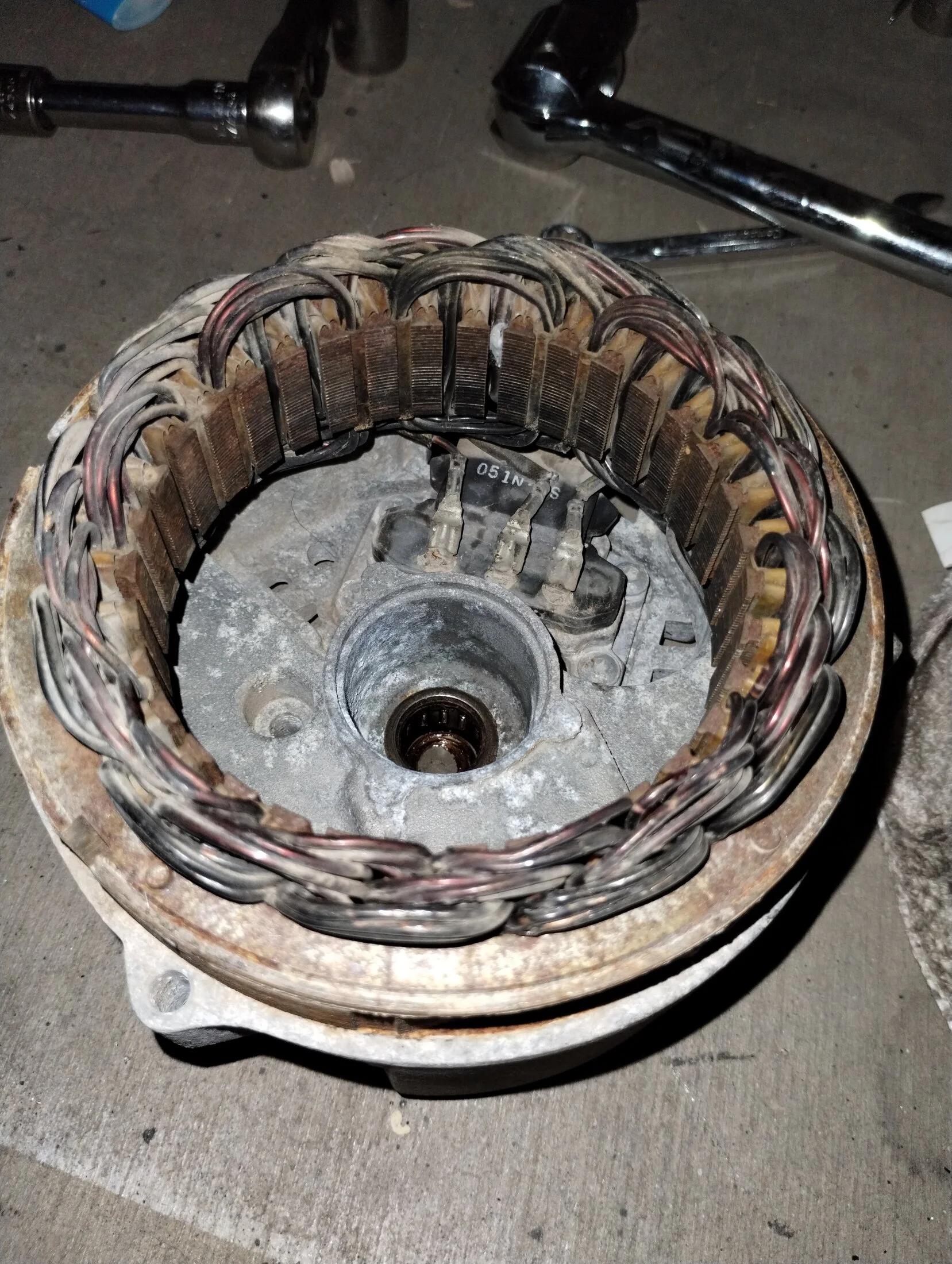

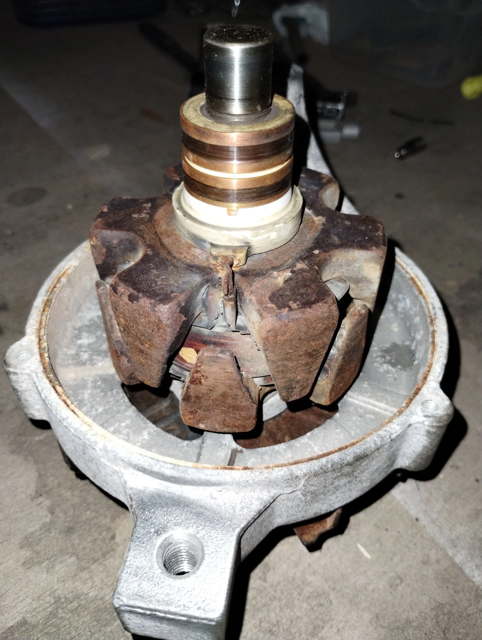

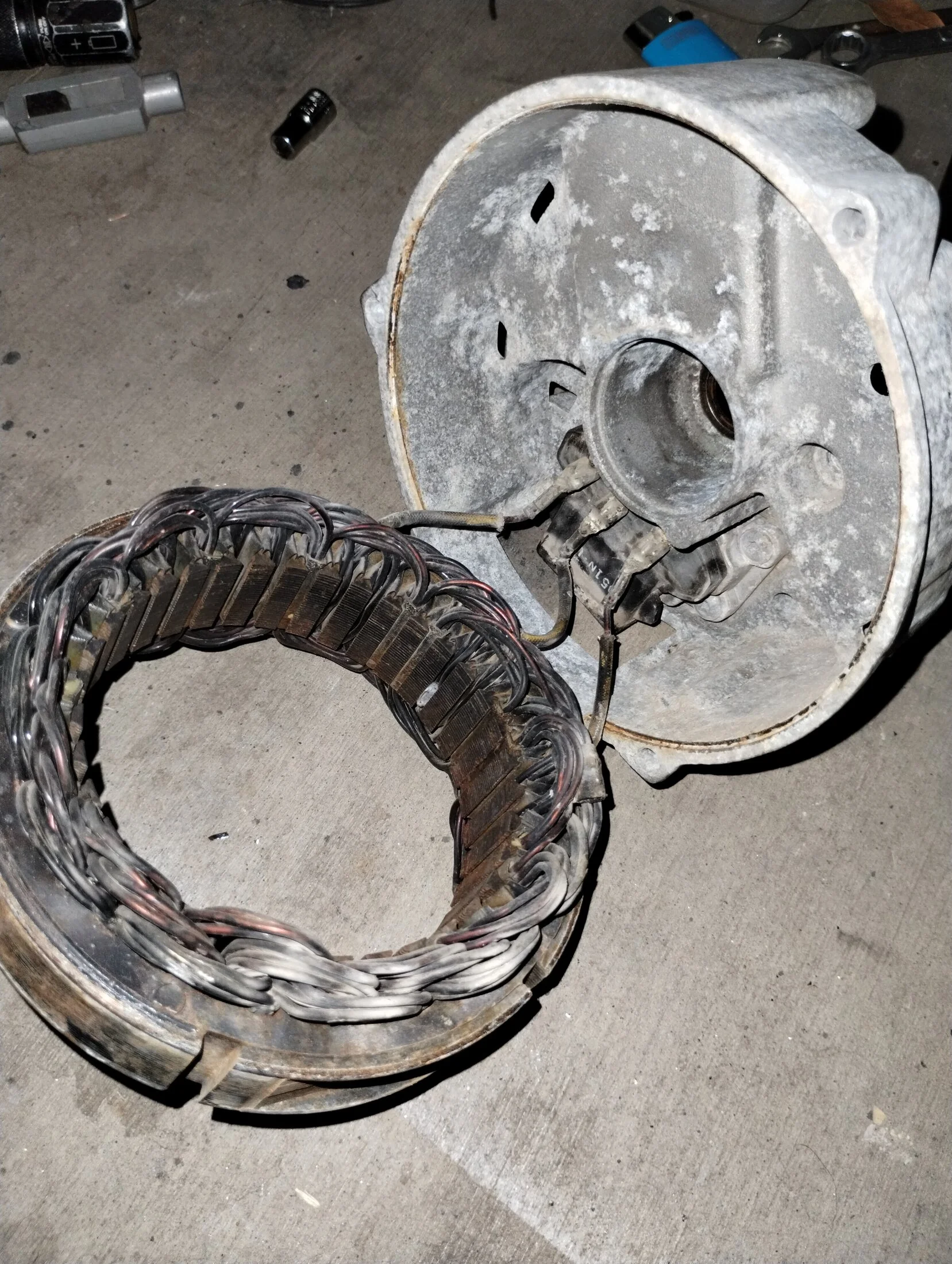

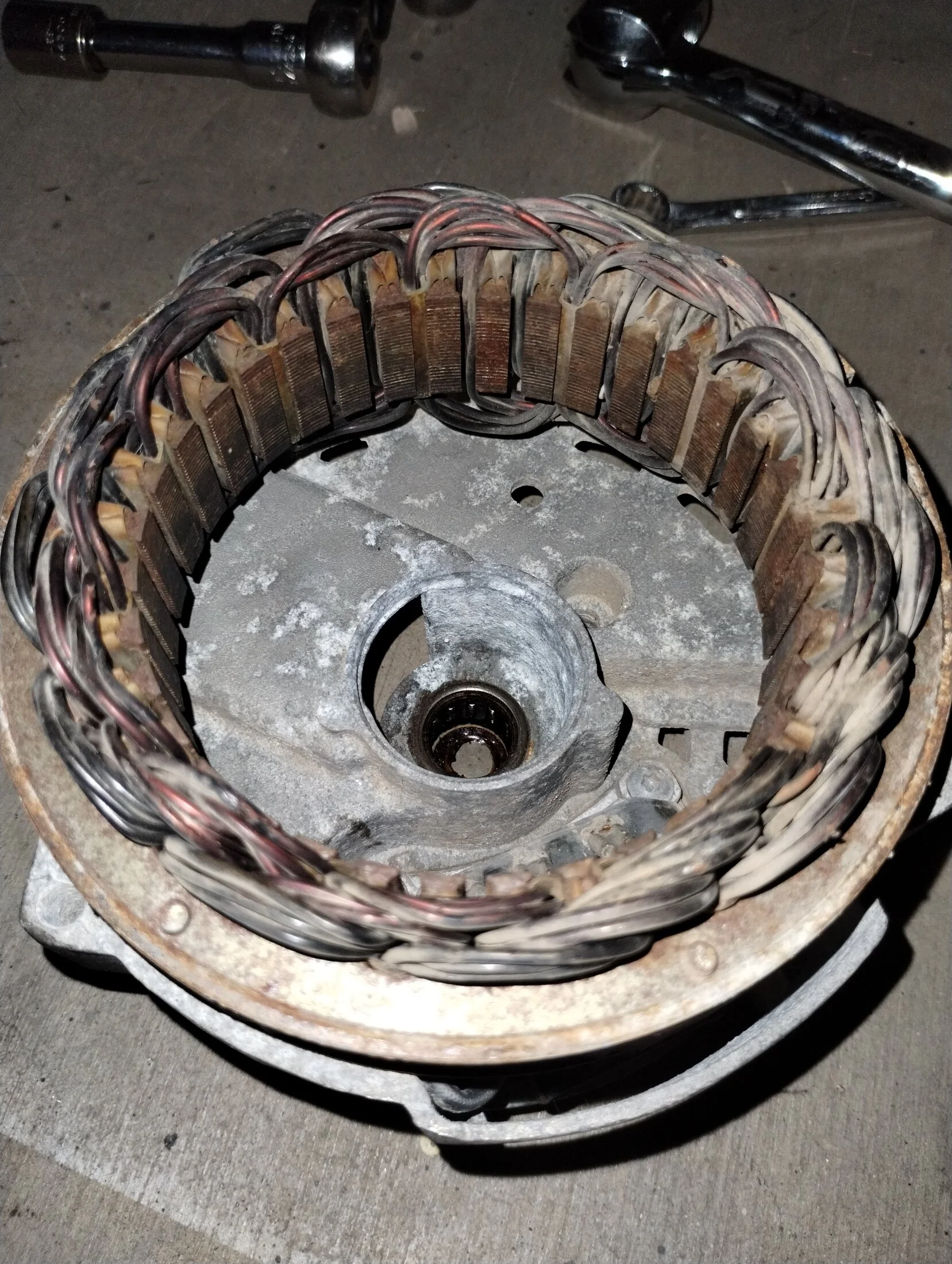

Got the new alternator coming, it should be here Wednesday. Needed something to do and wanted to figure out what was clunking in the old alternator, so I took it apart. Didn't find anything loose or moving irregular, just a few leaves lol. Definitely has seen better days and glad I'm replacing it. Couldn't figure out how to get the factory incandescent bulb to work in my dash without looking completely bizarre, but I found a small incandescent bulb and a 500ohm resistor. They should be here Thursday so I'm going to try it with the led first and if it's not working I'll try switching it over.

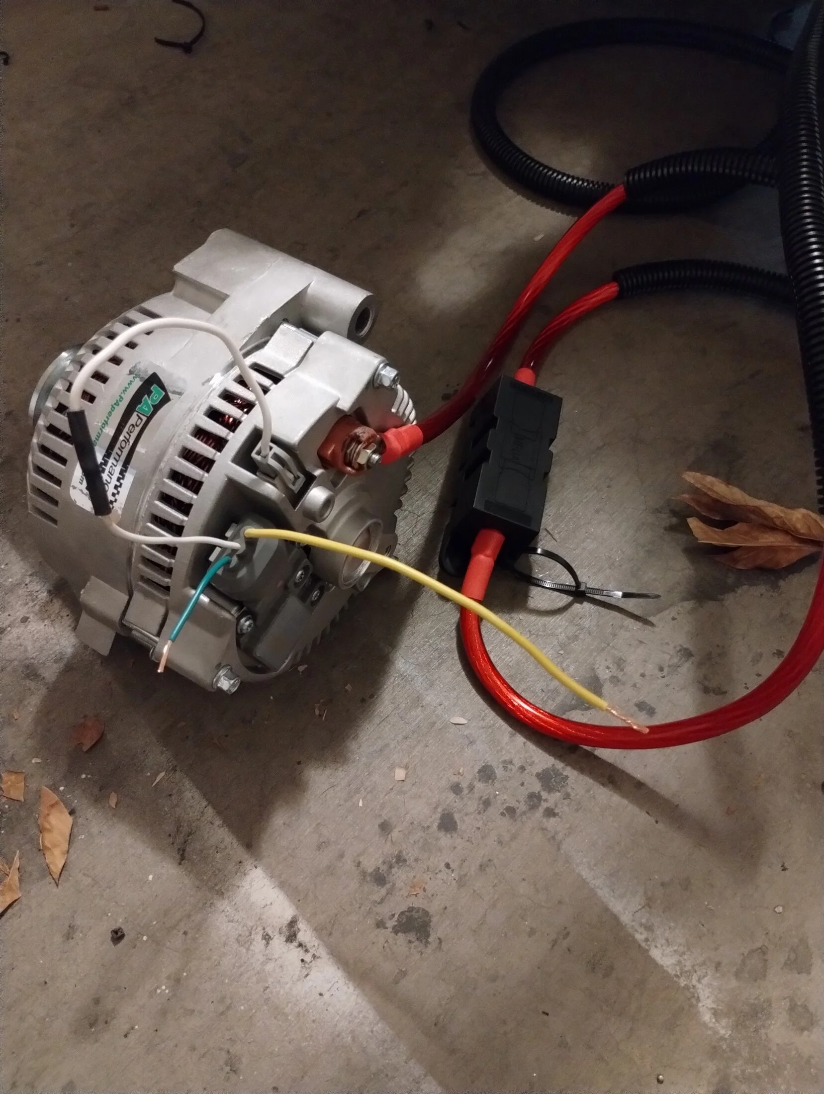

Alternator arrived a day late but better than never. Definitely going to have to grind to get it to fit, won't be able to get to that till this weekend probably. Started working on the wiring, just want to confirm I'm understanding the write up correctly. The yellow wire in the picture goes to the battery terminal on the fender starter relay as well as the big red one with the fuse, the green is the one to the battery light and needs the 500 ohm resistor, and the white to the single square connector? Thanks!
