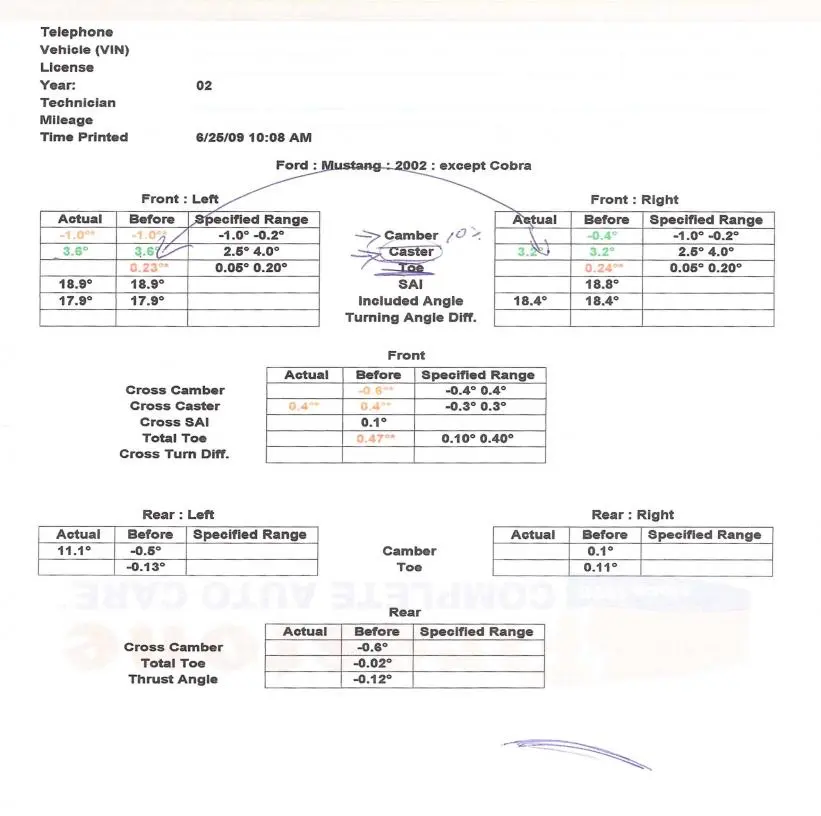

2. My car pulls to the right slightly. I changed my tires about two months ago and that did not fix the problem. I had the 2002 GT aligned right after my tire change. Please see attach file for Alignment readings. Do these numbers look normal?
The toe and camber numbers look a little off. Is the steering wheel straight when you drive in a straight line on level ground?

Question 2: The steering wheel seems a bit turning to the right. If I had to quantify it, I would say it seems to turn towards the right by .25 of an inch.
When I drive on flat road, it pulls to the right slightly.
When I drive on the freeway, the pull is more noticeable.
My tires are inflated to 31.5psi on all 4. Pressures are measured weekly.

If you've got a condition where the wheel is slightly to the right when going straight ahead, you've got an alignment issue (I know..."duh...") So:
- check the tie rod ends (inner and outer) for ball-joint wear
- check the lower ball joints for wear
- check the wheel bearings for looseness
- check for brake drag on that wheel
- check the steering rack bushings
- check the lower control arm and bushings
- check the K-member
Has the car ever hit a curb or been in an accident such that the frame was tweaked? Visually, is the right front wheel centered in the wheel well as the left-side? Or is there a difference between the two?
