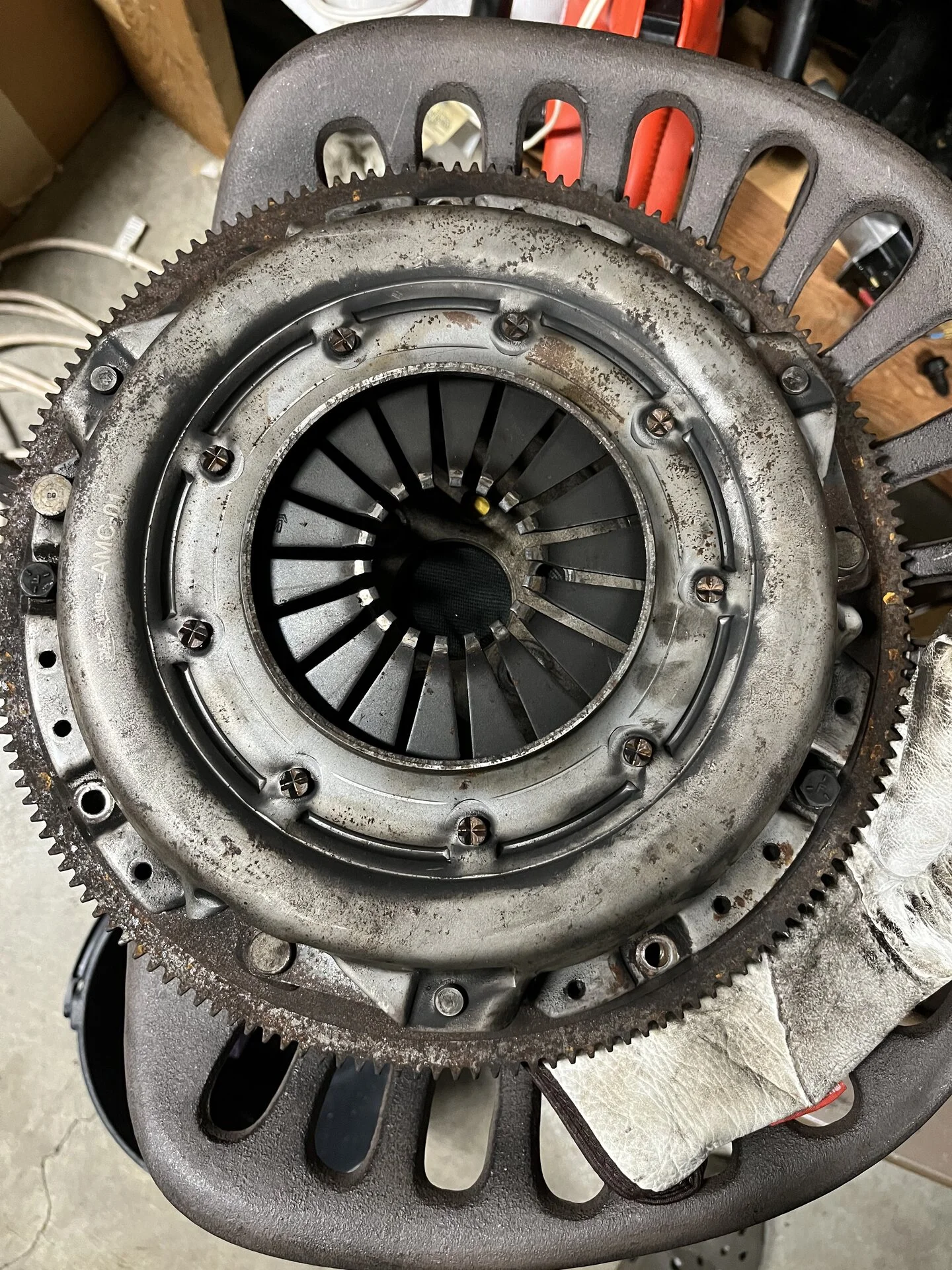

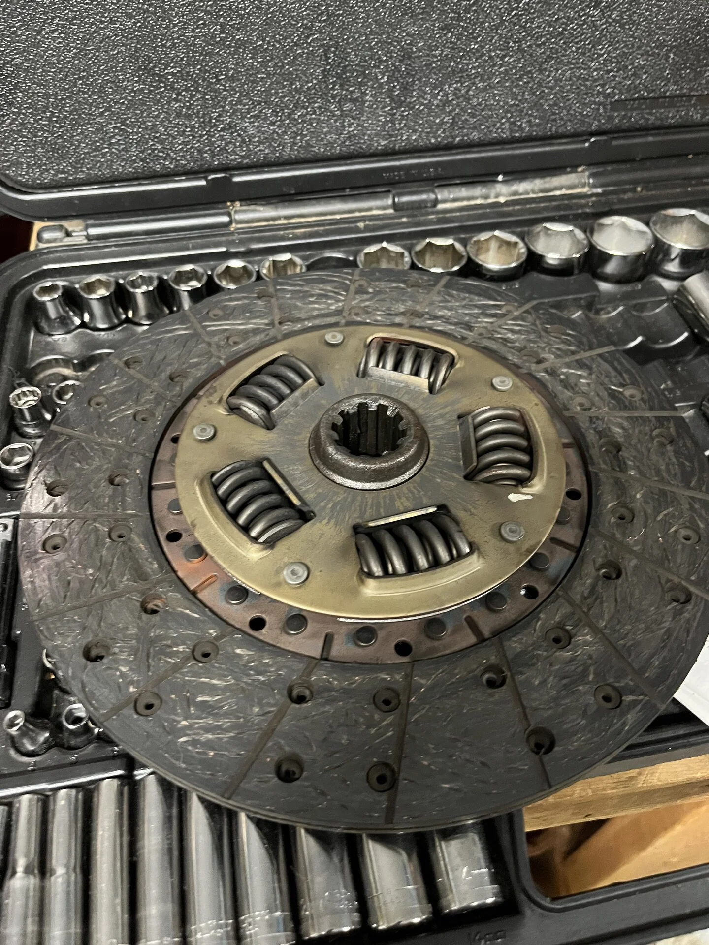

Took my flywheel/clutch assembly apart. Figured out I have a Valeo clutch and pressure plate. I can't see anything wrong with it. Is my flywheel supposed to have locating pins in it? Mine does not. Doesn't look like the pressure plate even has holes for pins? Interesting. Is there anything concerning here?

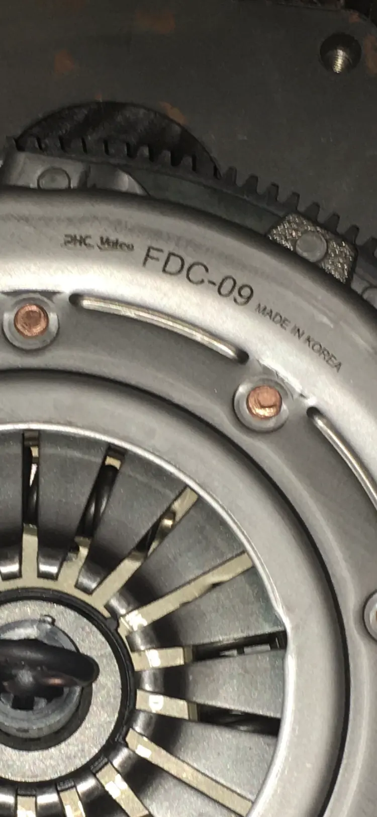

Your Valeo part number says AMC 01. I'm used to seeing the Valeo part # FDC 09. The alignment pins being missing could be your issue. They are different sizes depending on brand of flywheel. You also need to take a picture of the back side of the flywheel. It could be the incorrect balance for your engine.
Interesting. I will run the engine with just the flywheel and see if the vibration is still there. Back of the flywheel appears to be 50oz. Weight is too large to be 28. I can post a picture tomorrow. Part #E1ZR if I remember correctly.
