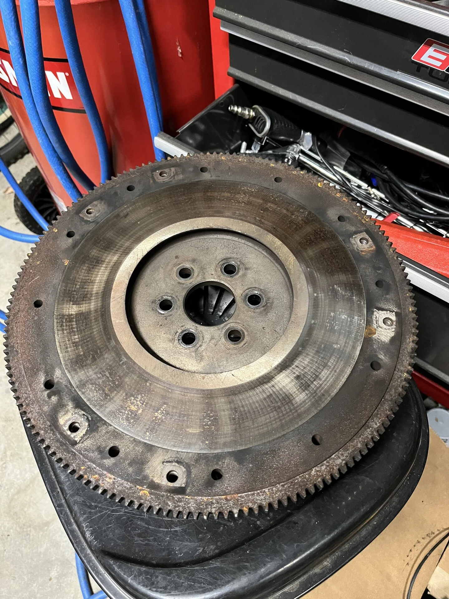

Most of the flywheels I have seen have them in them. I just looked at a number on rockauto and all the pics I saw had them. None of the listings said they had them, just see them in the pics.
Picked up the clutch kit from O'Reillys. The $125 special :D. Now I just need the pins... No Ford dealer has them within an hour or two from me. Would it be worth just buying a whole new flywheel with pins preinstalled? How does my original flywheel look?
It looks like it got plenty of heat and abuse. The flywheel needs surfaced if you want the new clutch not to chatter and last longer.
