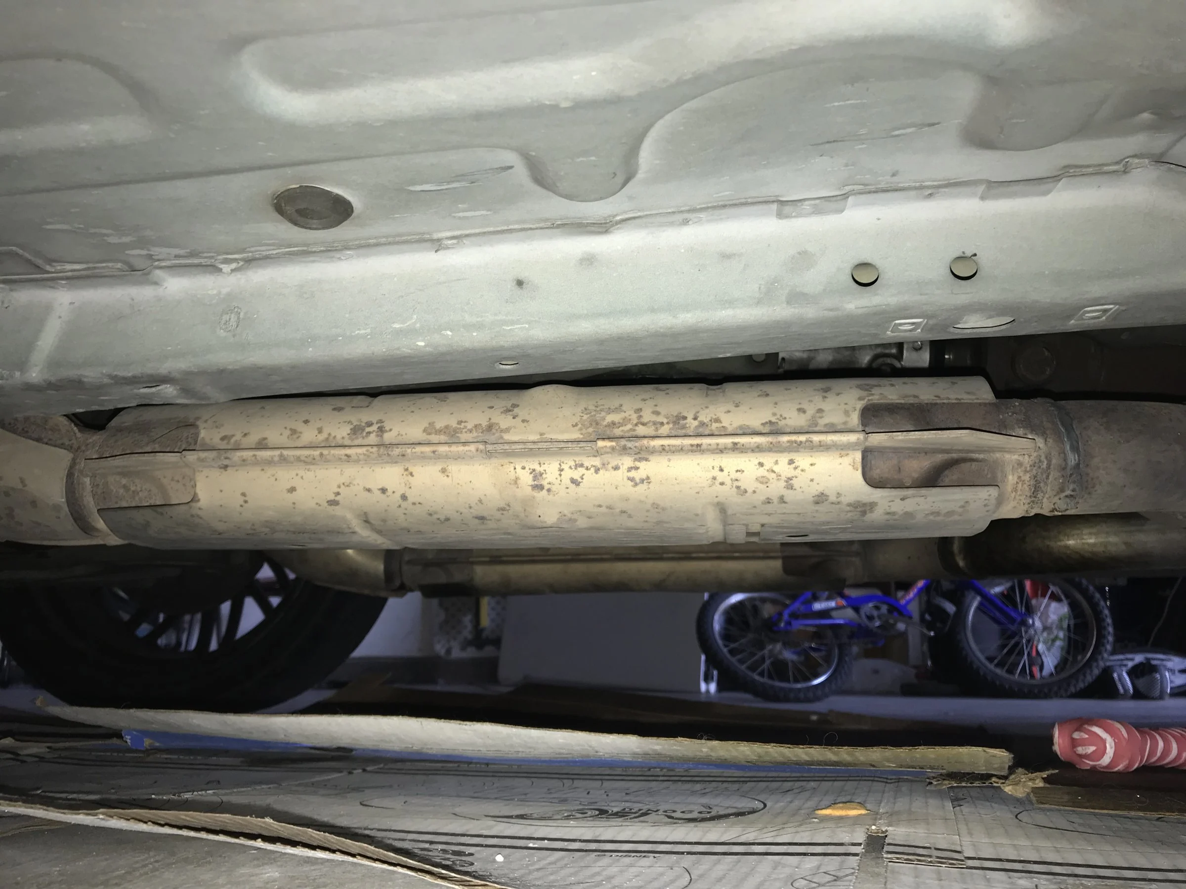

With the picture I provided, can anyone tell me if that is a catalytic converter, or a muffler??

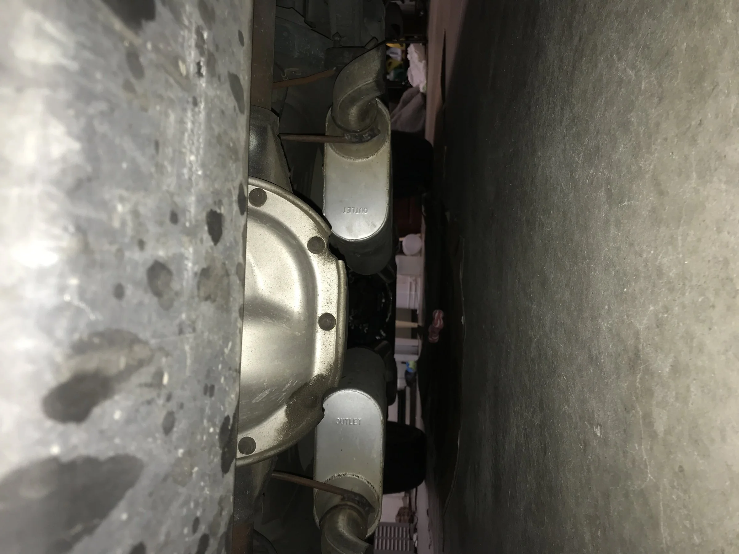

It actually has an exhaust setup from the cats back, that I didn’t put in, but came with the car when I bought it. Welded Thrush Exhaust. How I plan to do this would be to keep the cats( Keep the cats so that I still pass emissions testing), just cut off the Thrush Mufflers welded on and continue the exhaust all the way to the rear bumper. Keep in mind the mufflers are right at rear axle. One last thing is the exhaust right now actually a true dual.

Yes, that is what I mean but I just need this portion because my mustang has a dual exhaust that someone put in it. Also I included what my exhaust setup is as of right now.

I do not have a Y-pipe to this dual setup. True dual from the headers back

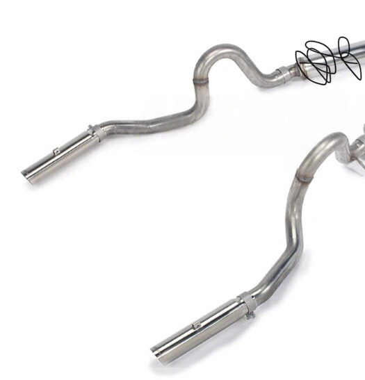

Ok... This is as close as I could get you.
It would still need to be taken to a muffler shop, adjusted, then welded into place in order to fit properly:
https://lmr.com/item/LRS-5212PR/86-97-Mustang-LX-Stainless-Steel-Tailpipes
My suggestion would be to hold off purchasing until you find your "guy" to do the cutting and welding. Then show him this and talk about the approach. It fits on SN cars so it should fit with some adjustments.
