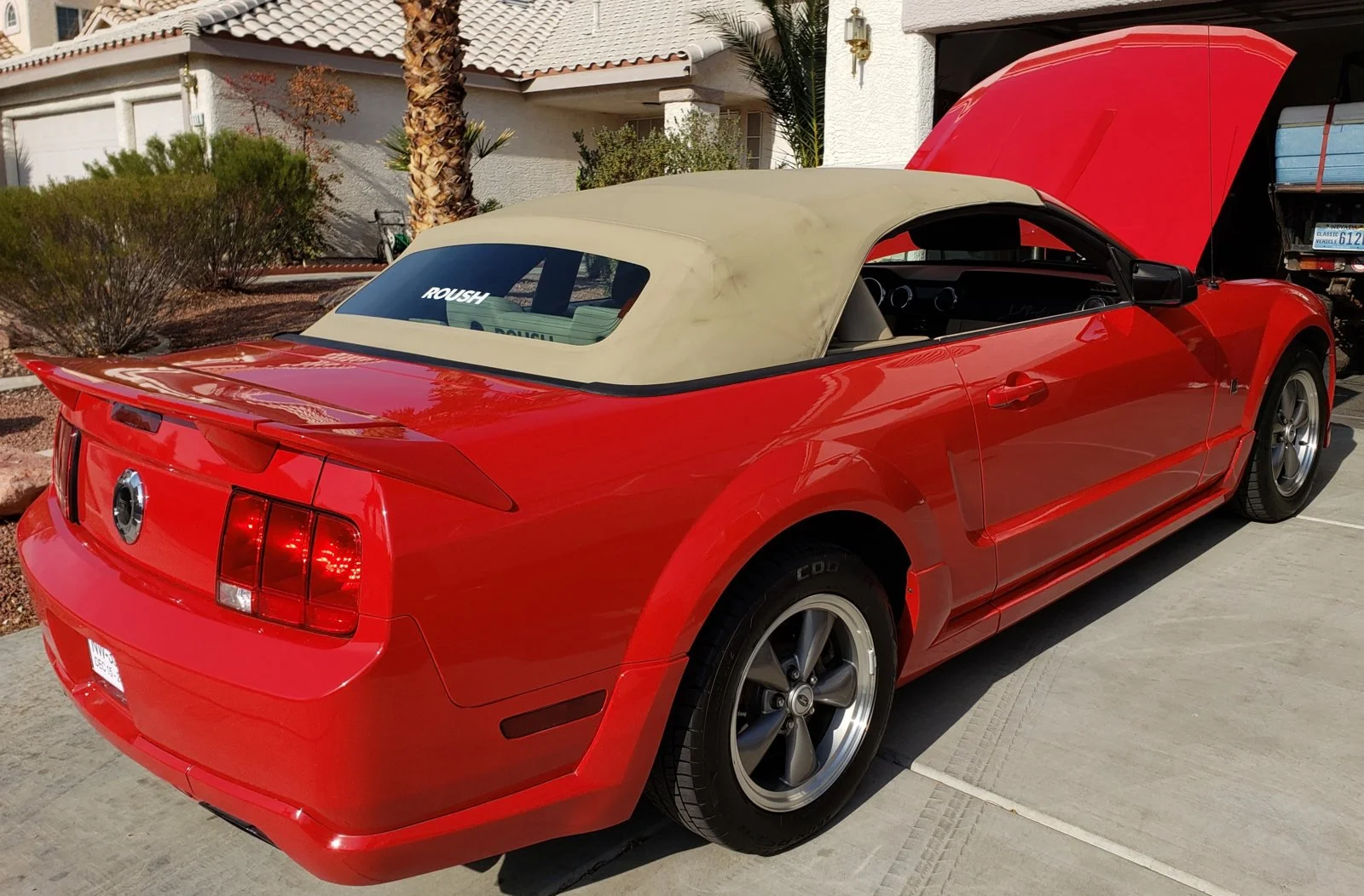

My wife and I just bought a 2005 Convertible Roush 4.6L and I am looking to replace the stock wheels and tires. They are currently 17" Wheels with 235/55R17 tires. I am thinking I want to stay with the same total diameter. I would like to go with 18 or 19 inch wheels and a tire that would yield the same height as stock. I was also thinking I could go a little wider in the back, so I am looking for information on how wide I can go without issues and what size tire with a 18" or 19" wheel.

I have 18 inch wheels on my car (also an 05 Roush), and I run 295’s in the rear without issue. Widest I’ve run was a 305, and even that didn’t have an issue. However, my car is a street car and isn’t making “spin the earth off it’s axis” power, not to mention cost, so I stepped down to a smaller tire.
The speedo - if you bump from a 17 to an 18 inch wheel, the speedo will be off a bit, but not by a significant amount. So, it’s not like the speedo will say 60 mph, and you are actually doing 70, for example. That, and you can buy a handheld tuner (SCT is a good brand) and use it to recalibrate your speedo if it means that much to you.
