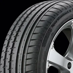

I bought Continental ContiSport Contact II's from the Rack for my Cobra; for my SHO I went with BFG G-Force TA's from Discount. I love the Conti's, zero complaints. The BFG's are acceptable for the price, but I had to try out six tires to get four round ones.
The Conti's:
