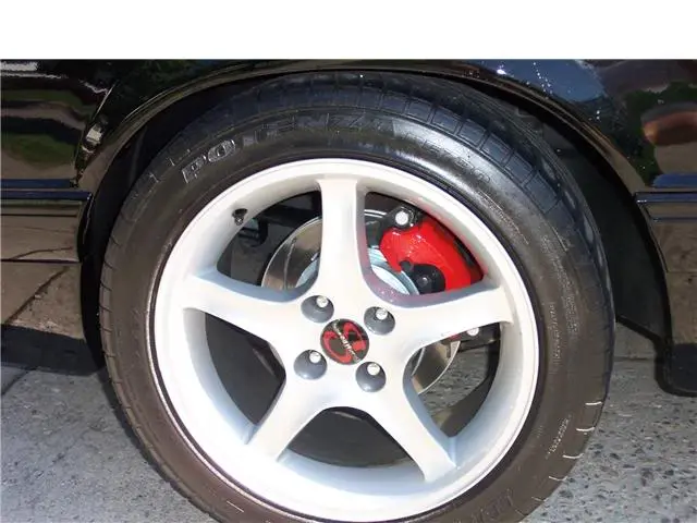

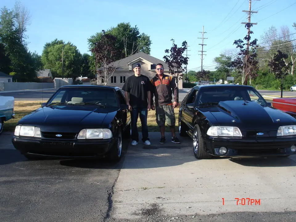

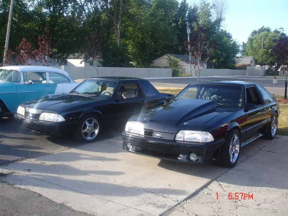

PIC
Reactions: Noobz347

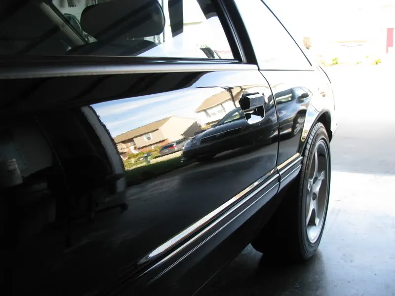

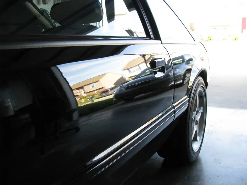

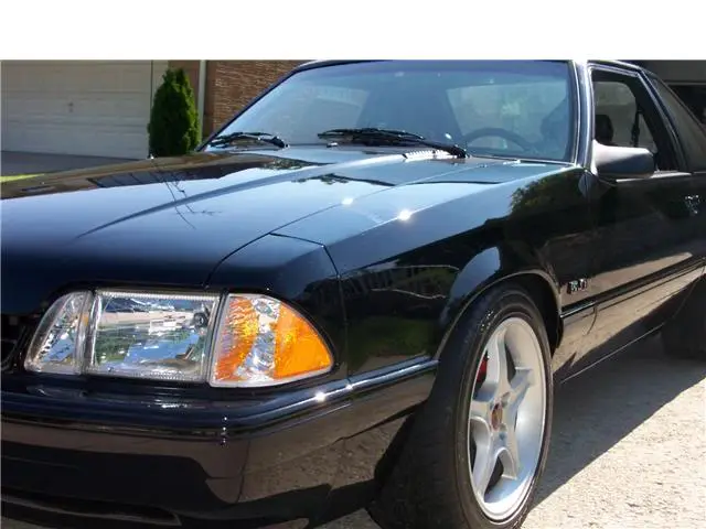

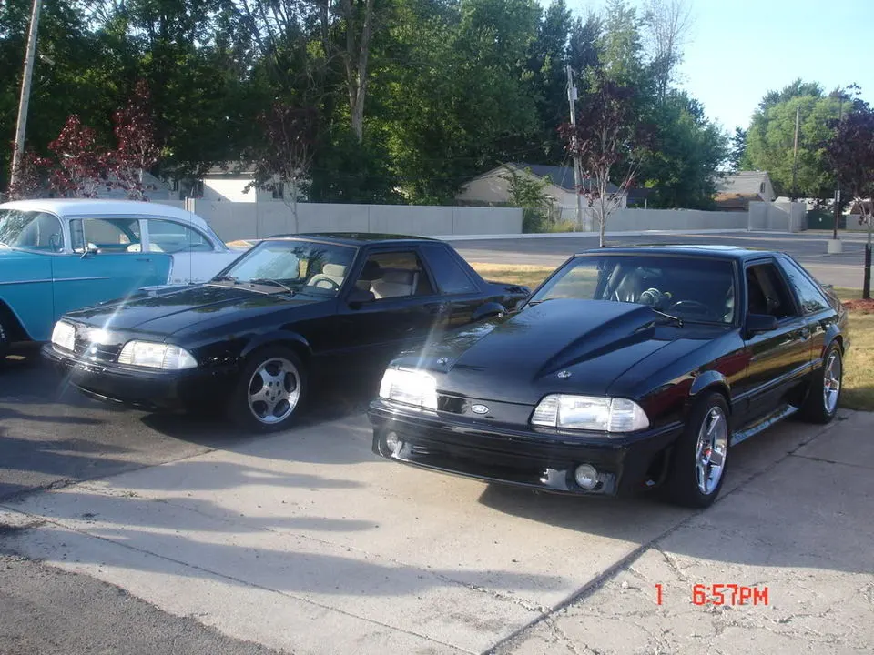

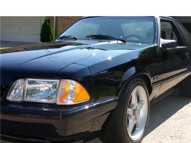

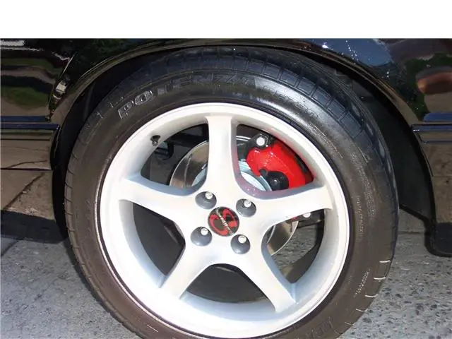

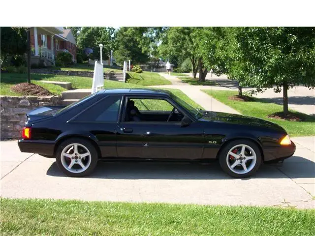

Here are some pics of mine with the 245/45's. I'm running HR Race springs.
Reactions: Noobz347
Are those wheels 9" wide? If so, those 245's don't look bad at all. They don't even look like 245's. That rim guard is nice too. The 245's we mounted on those 17X9's on his car, were stretched like crazy. Goodyear Eagle ZR45's...we just took them back off and mounted the 275's.
Yup, 9 inch wheels. 17x9's. I'm pretty sure they're 245's....lemme double check and make sure I'm not getting myself mixed up! :D
Bridgestone Potenza's.....245/45.
I'm pretty sure the wheels are 9"....could be mistaken I guess. :shrug:
