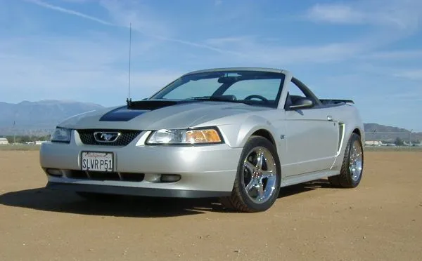

Here's my old car with 275/35's front and 285/35's rear mounted on 18x9's.

I have exactly what you're looking into. I have 18x9.5" Y2K Cobra Rs with 275/35R18 Nitto NT 555s. :)
Check the link in my signature for quite a few. I'll post a few on here as well. I was also worried that it would look like they're sticking out in the front. With the car up in the air (or stock height), they will. But if you're lowered and you have about 1 degree of negative camber it looks perfect. Although my car has always been a hair lower on the driver's side, so the passenger front wheel does look like it's out a little more. At a stop, mine do not rub at all. But if you hit a driveway at an angle and cut the wheel really sharp the car will lean to one side and THEN they'll barely rub. I have no regrets with this wheel/tire combo. I wanted wider tires in the back originally, but I'm glad I didn't do that. The car looks balanced.
The brand of tire you buy has a huge impact on how they'll look though. That's why I got the Nitto's because they fit well on the rim.
In the picture with the wheel cut, remember that there's a little more that the steering can turn in that picture when there's actually a driver in the car holding it at full lock.
