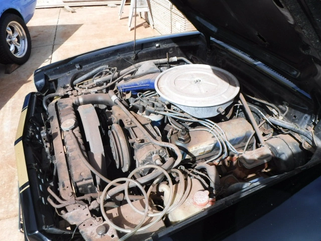

My first question... The motor looks to be the original 123000 mile 302 and unopened, it runs crappy and barely passes a compression test. The problem is I can't set the timing reliably. Under the timing light it seems to flop back and forth about 6 degrees in each direction. Is this just a stretched chain or could it be something else?

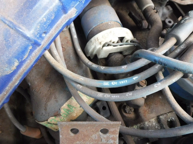

Looks like date coded wires. Could these be the original plug wires to this car?
No wonder it runs so :poo:ty. Bet they all test dead. This engine is gonna need a new everything before its done.
Yeah, you might wanna replace those wires! lol I'd say it'd be a safe bet to replace the cap, rotor and plugs while you're at it!
As for the timing jumping back and forth, just a few questions. Where is it idling at? The vacuum advance was unplugged? How is the idle? Choppy, surging, smooth? And judging from the date code on the plug wires, how are the vacuum lines? A vacuum leak can give you a choppy idle, I found that out a long time ago! My car sounded like it had a cam in it for a while (before I did anything to it!)..... ;)
Compression problems are a little more in depth to take care of most of the time, but how did they test - were they they fairly even in all cylinders?

Insepct your harmonic balancer, if the rubber is cracked and worn, the outer ring can slip over it, which could also look like jumping timing.
Perhaps it also helps to re-check top dead center. To check it there are tools that screw into place where the spark plug sits.

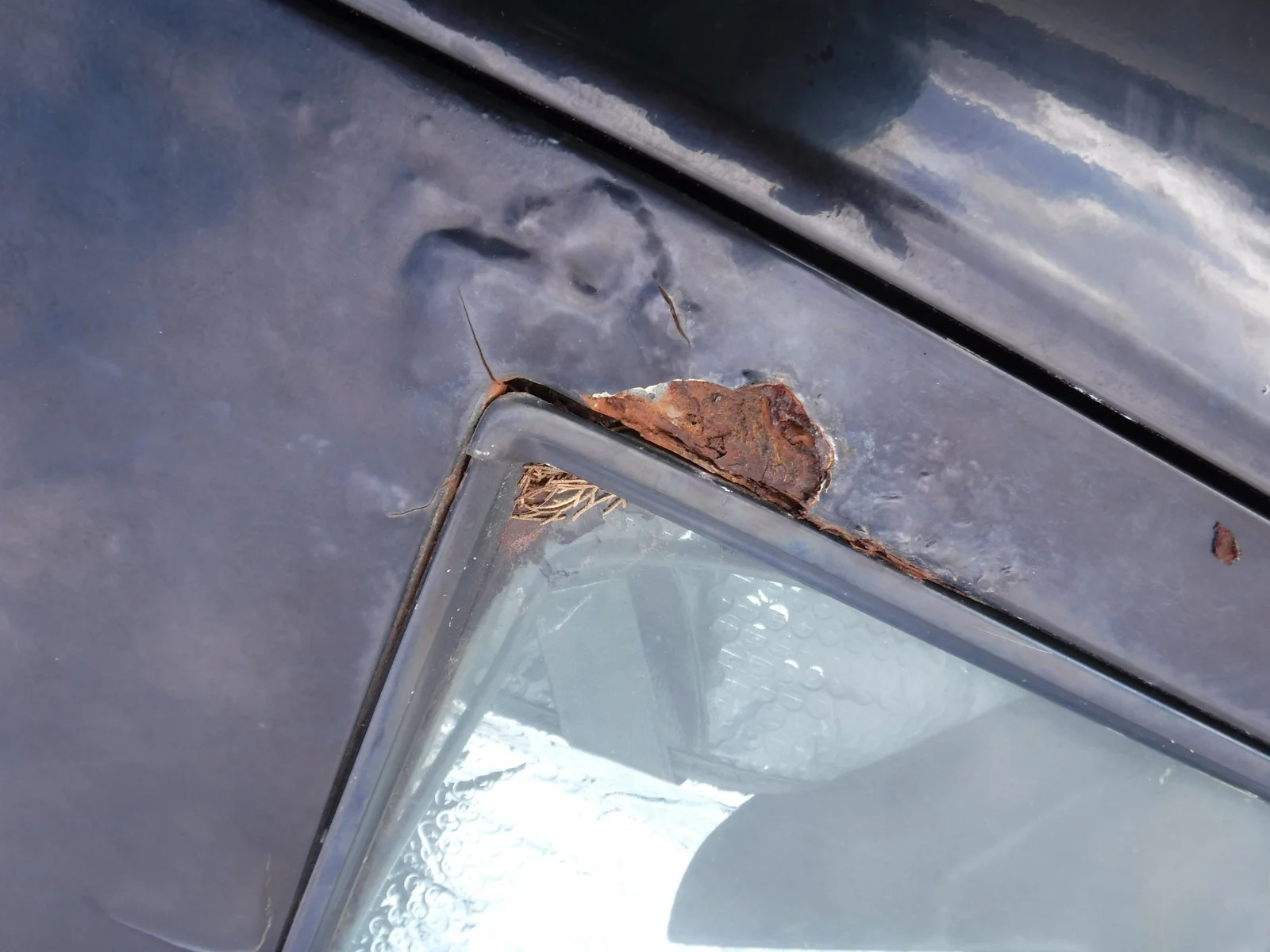

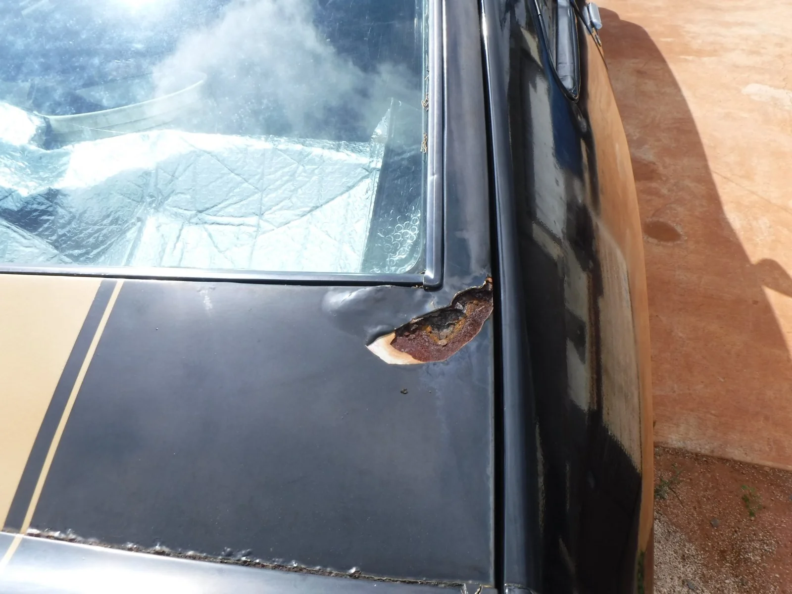

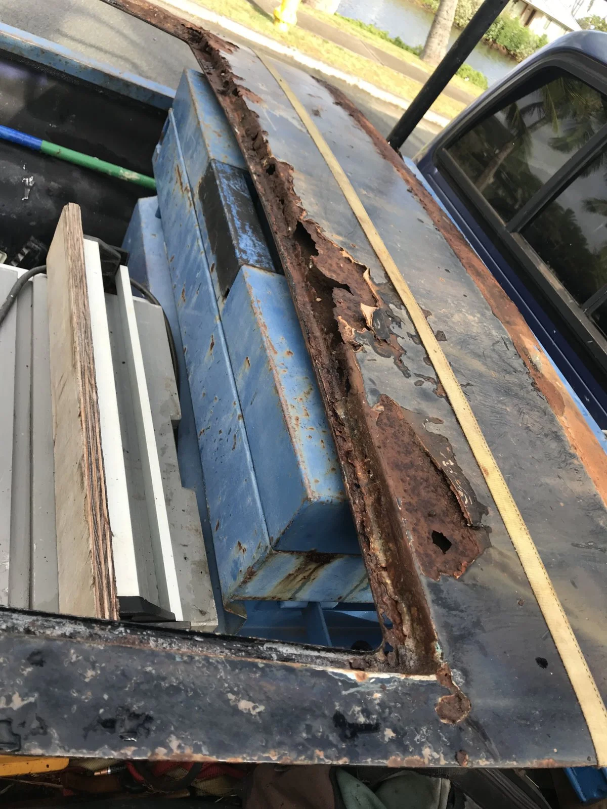

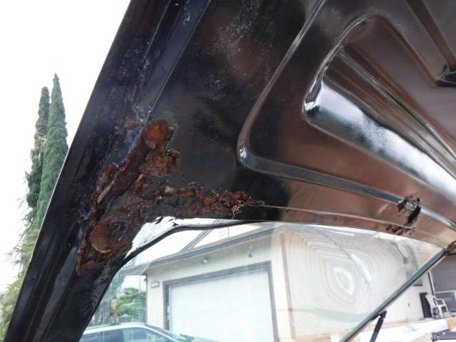

This is the used deck lid I found and placed on car 7 to 8 yrs ago it was better than the one on it by a long ways.
But the spoiler was pop riveted on to it and it was still rusty in the window corners. Now after sitting for so long if you push on the spoiler to shut, it wants to fold in half.

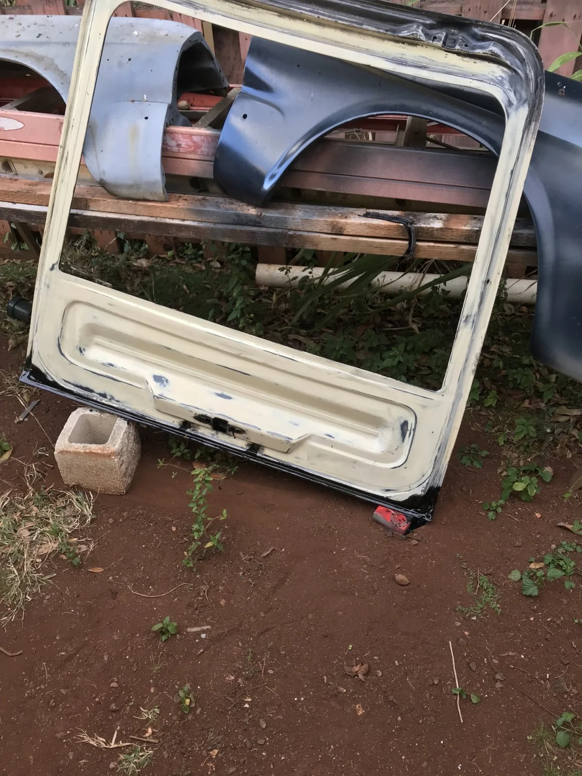

And here it is, no glass, no spoiler, but the correct mid 76 part number
In this picture I just dumped a quart of Por15 inside and turned it all around to coat inside. Then I spent a lot of rags cleaning it all off the out side.
You can see it leaking a puddle by the red block

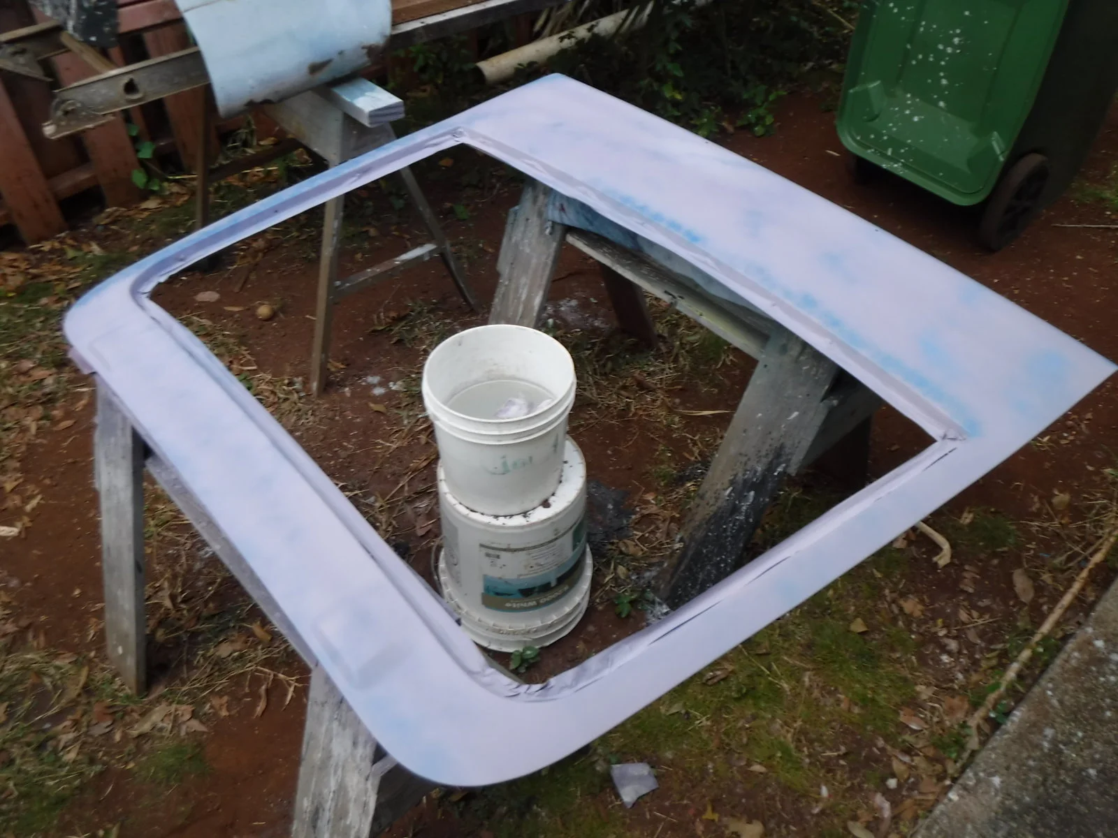

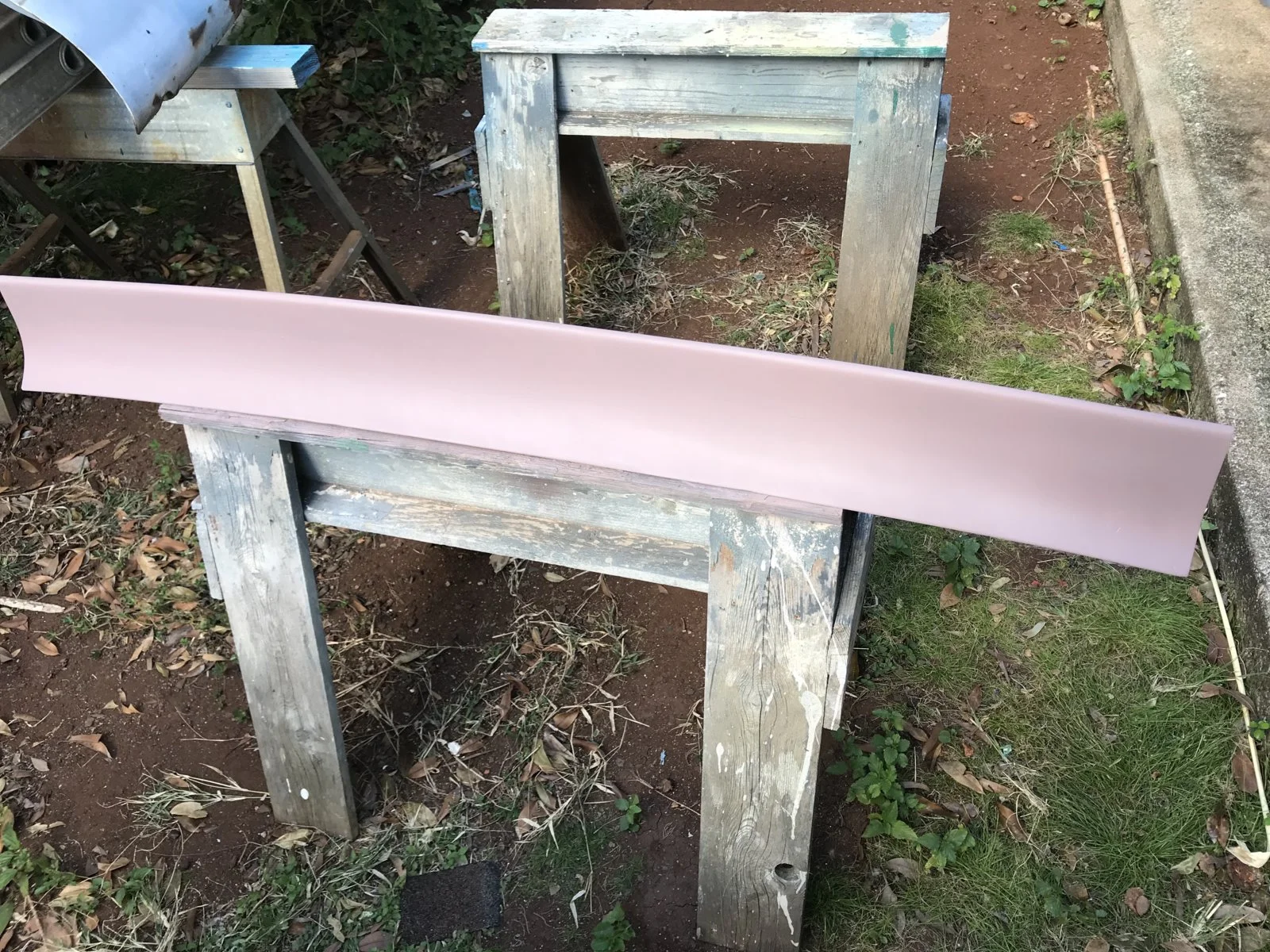

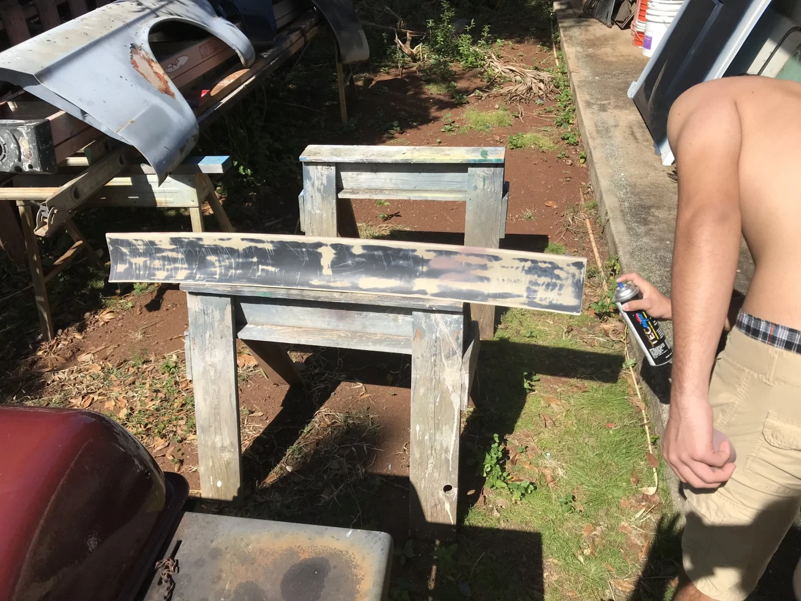

So we took the spoiler off the original deck lid and heres my kid spray bombing some urethane flex primer on it.
Father Son Project ~ Whoo Hoo!
I'm teaching him to paint on cars. We sanded and primed the deck lid.

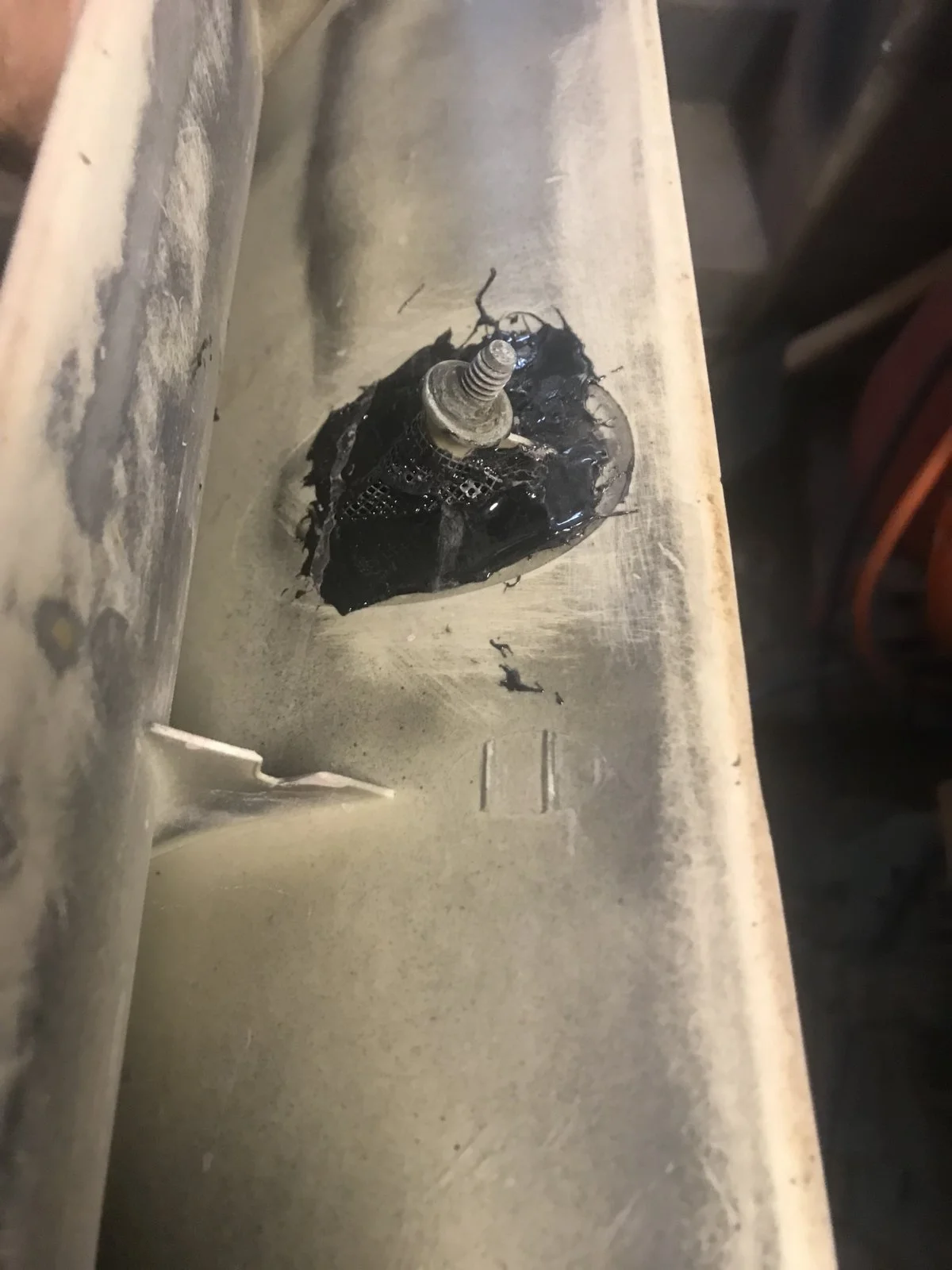

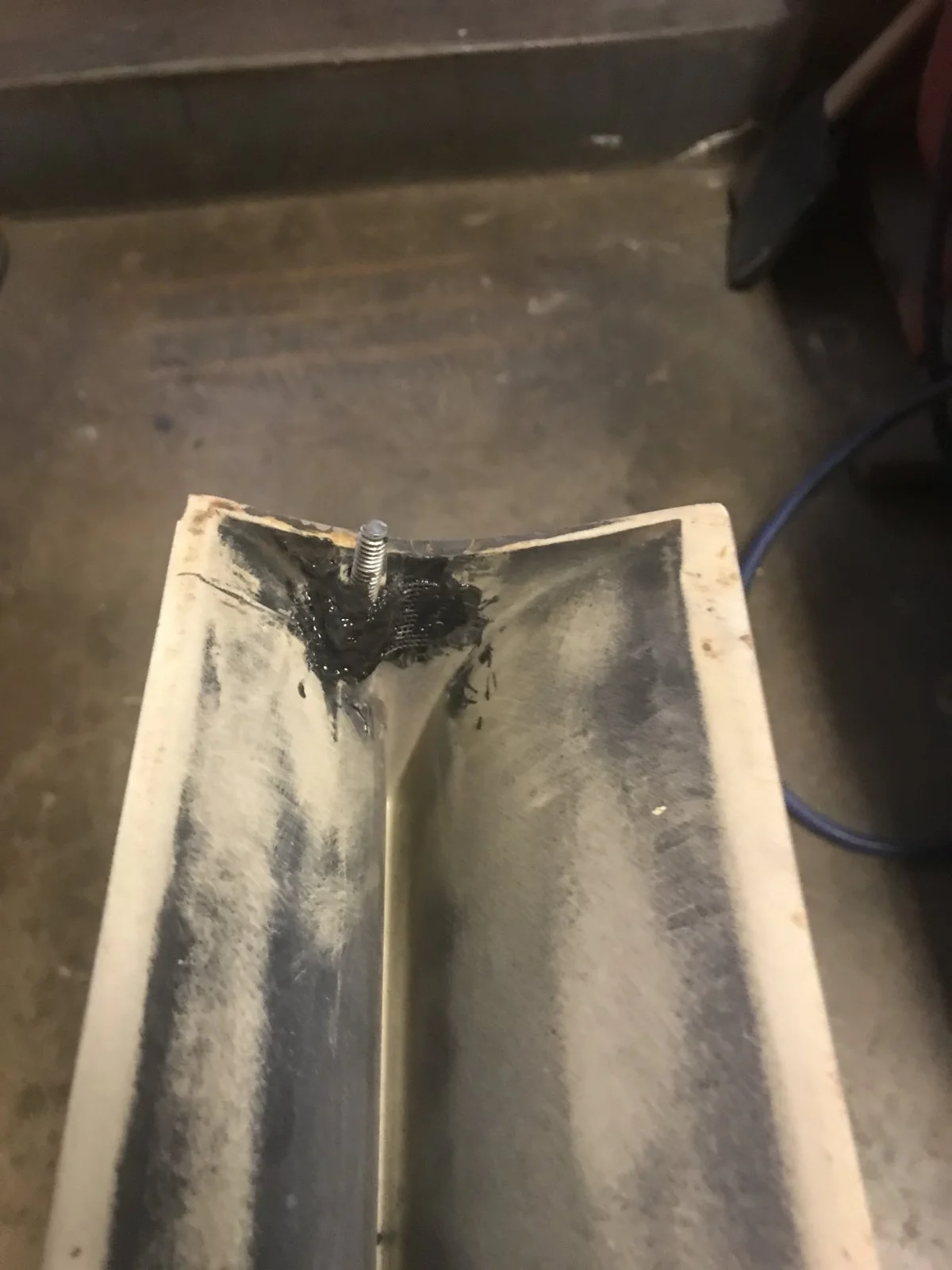

Had to rebuild 1/2 the spoiler mounting studs and drill the deck lid.
Used a urethane repair kit and cut off some stainless bolts to do it.

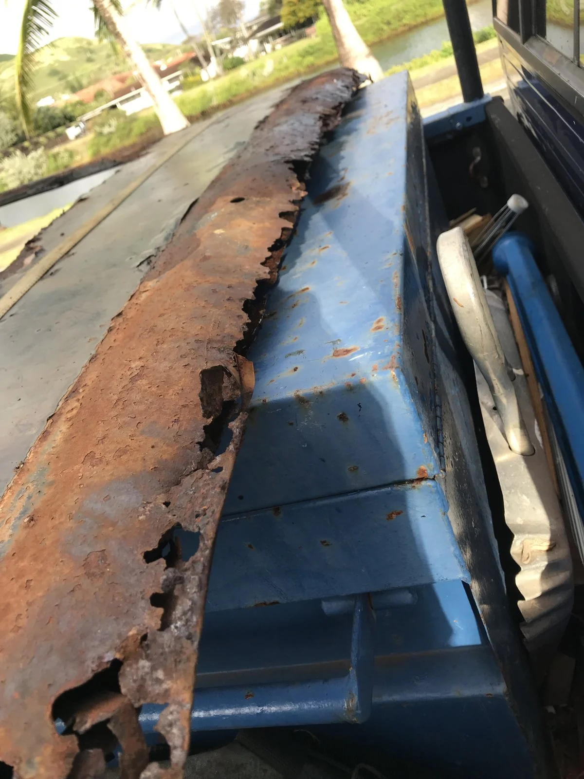

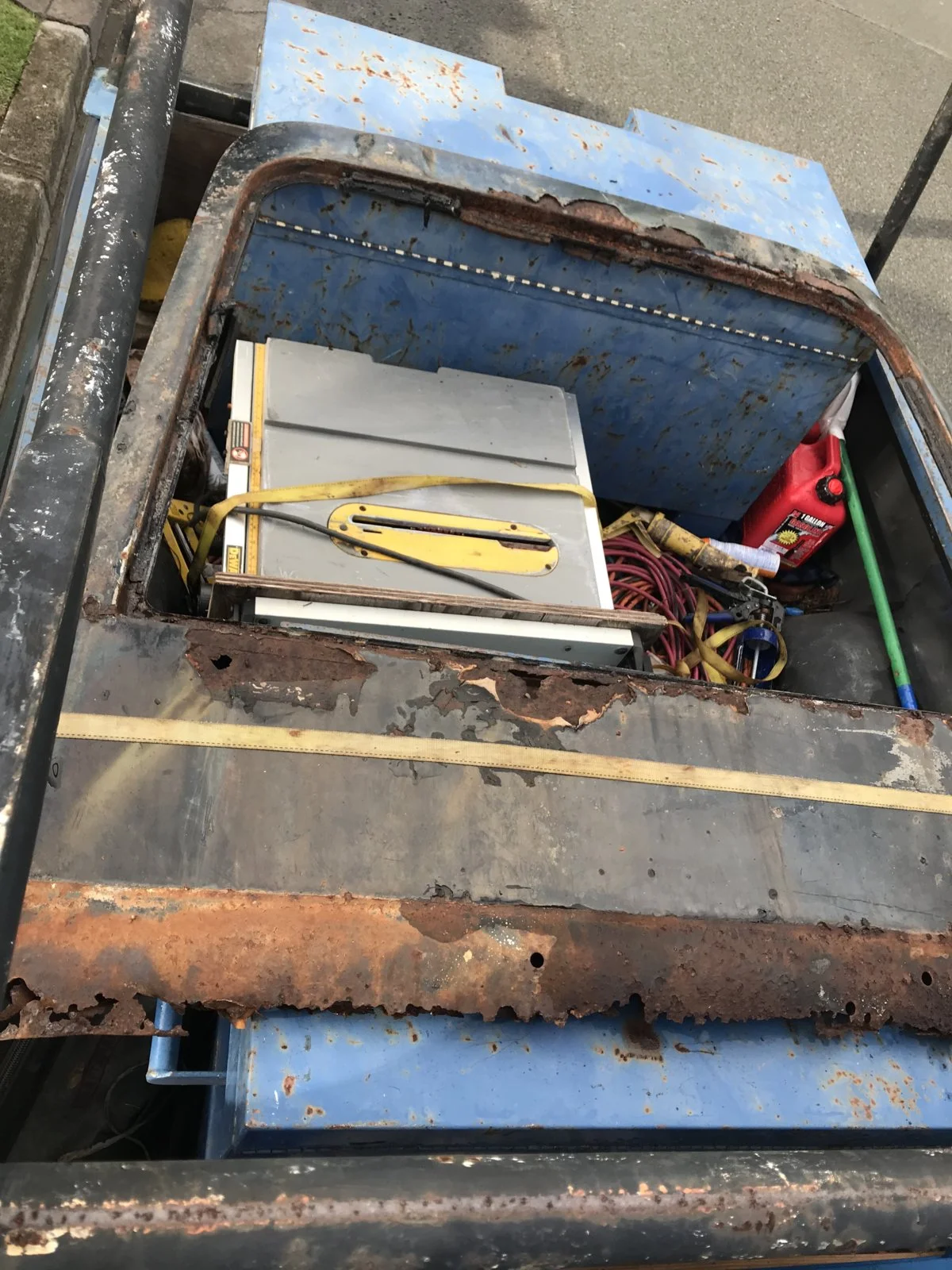

Heres the original deck lid. Its a horror story, but we saved the original tinted glass and spoiler to this car.
Its been a good week for the Cobra2
  • Wow
Reactions: 7991LXnSHO
Holy crap was that deck lid parked near the ocean or IN the ocean lol...
Original Hawaii Car.
You should of seen the bumpers ~ split lengthwise and erupted. This cars condition (rough but almost all there) was why the price was so right 8 yrs ago. The big rust hole actually made it easier to pull the window out. Used a guitar string.
