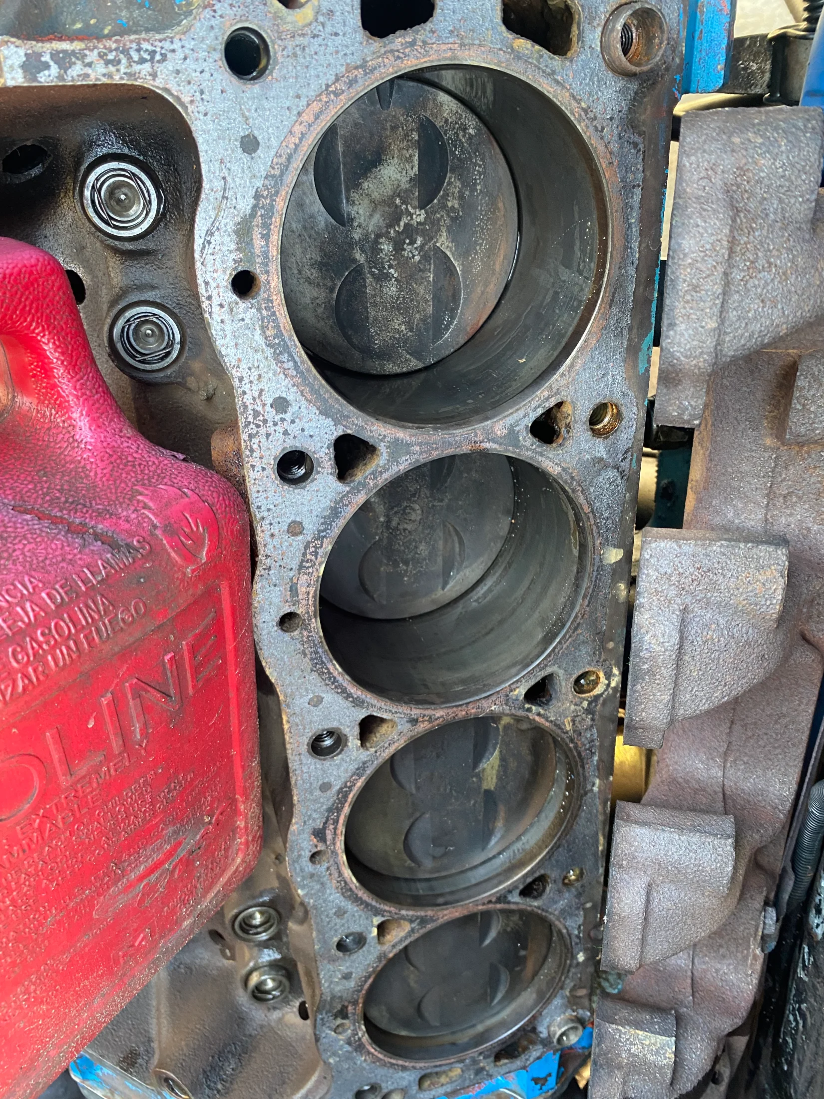

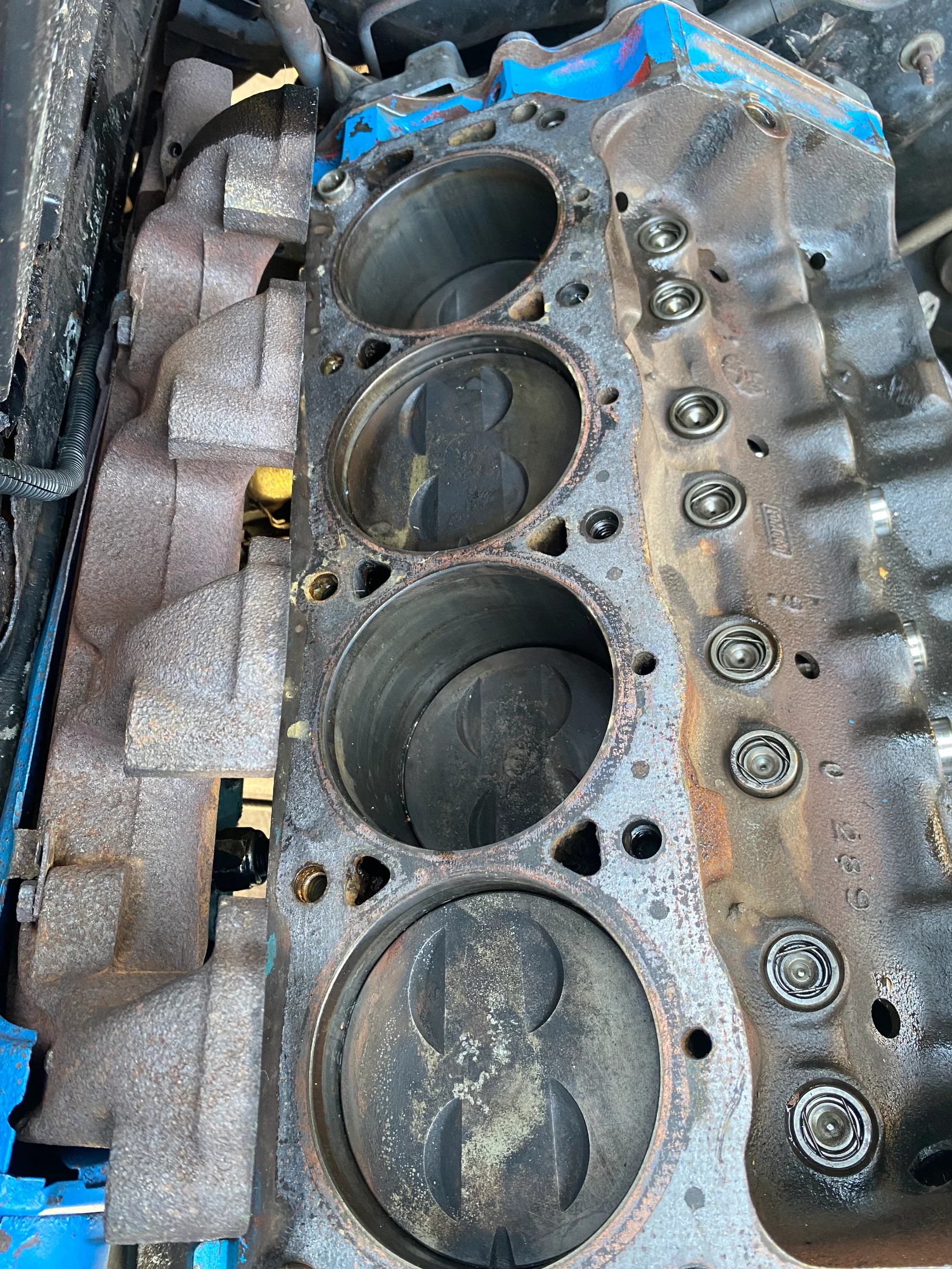

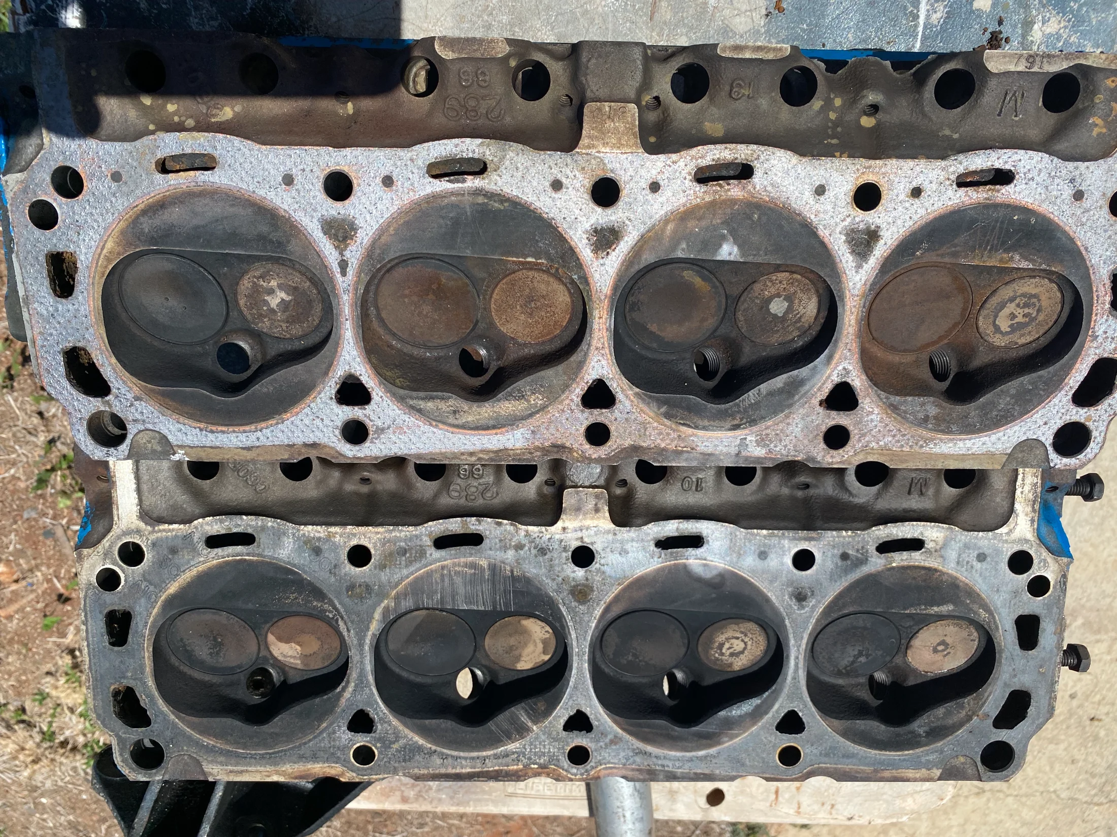

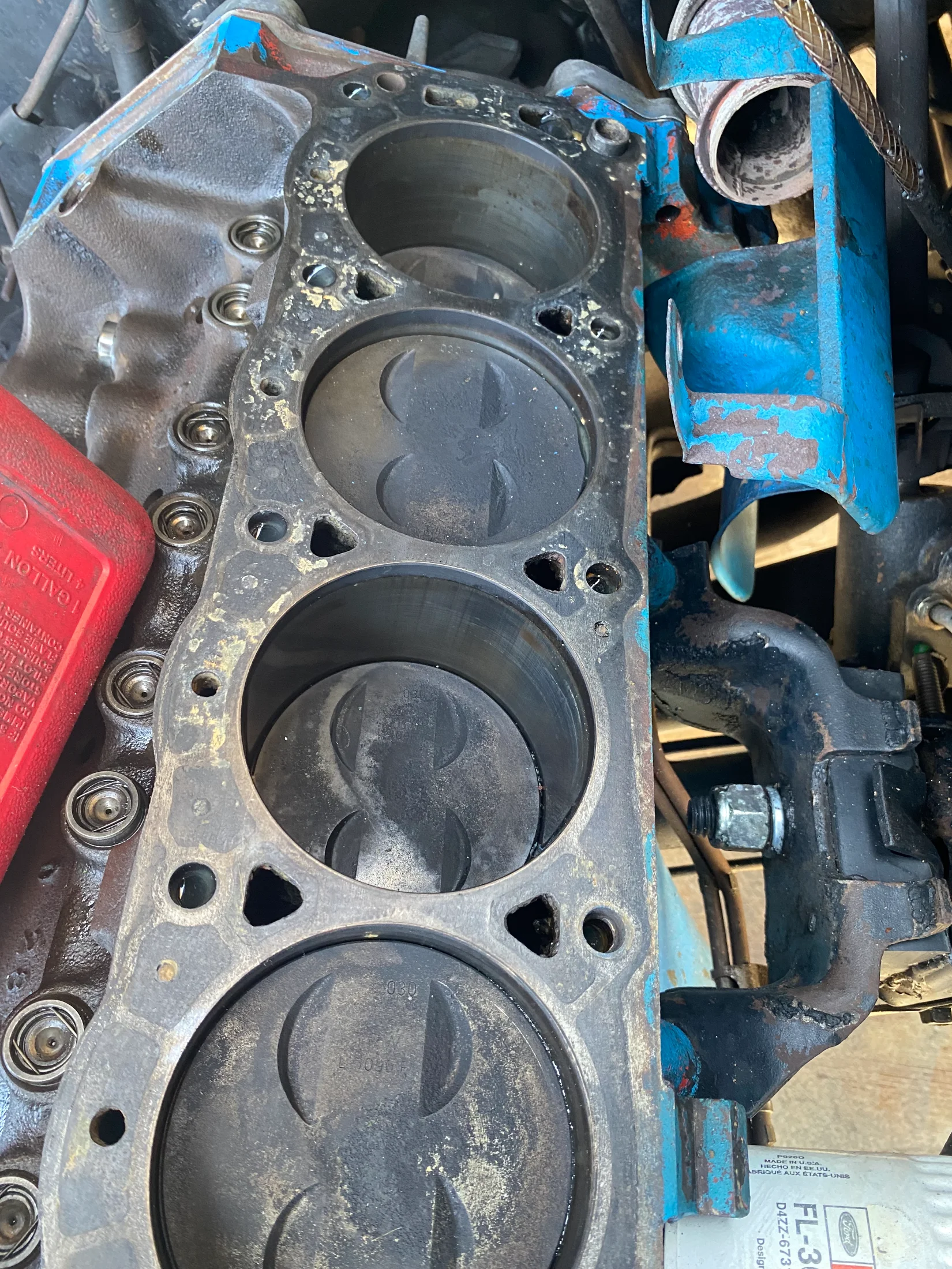

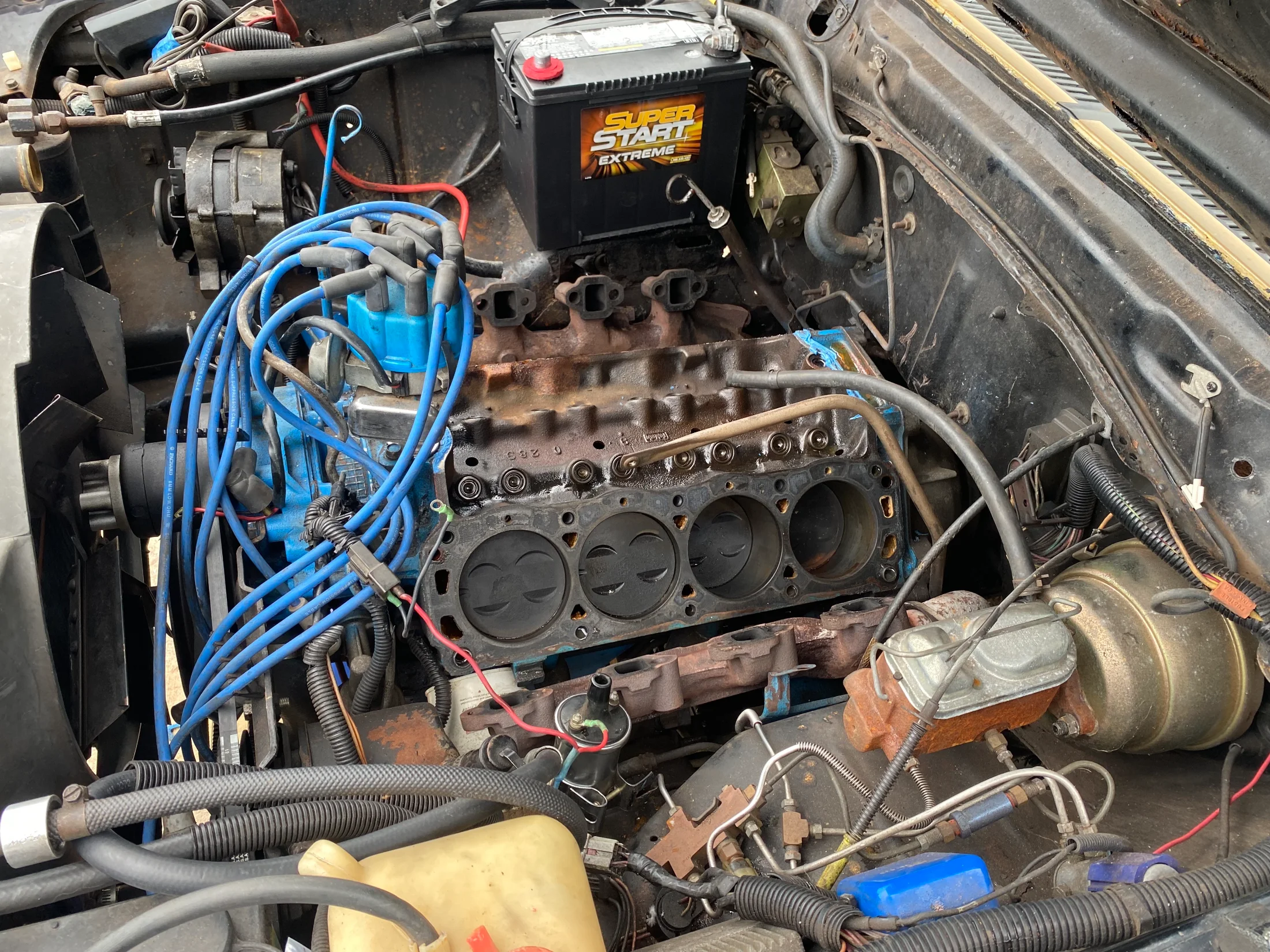

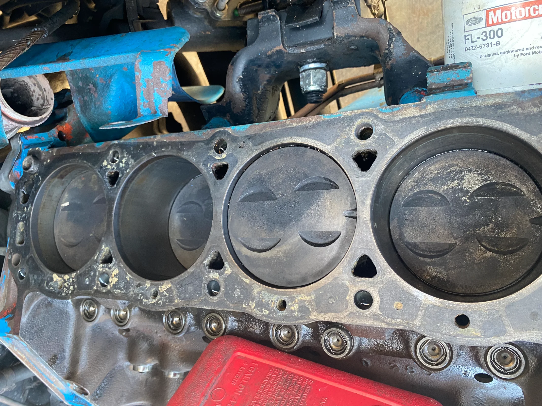

Took plugs out and turned over, no water came out this time

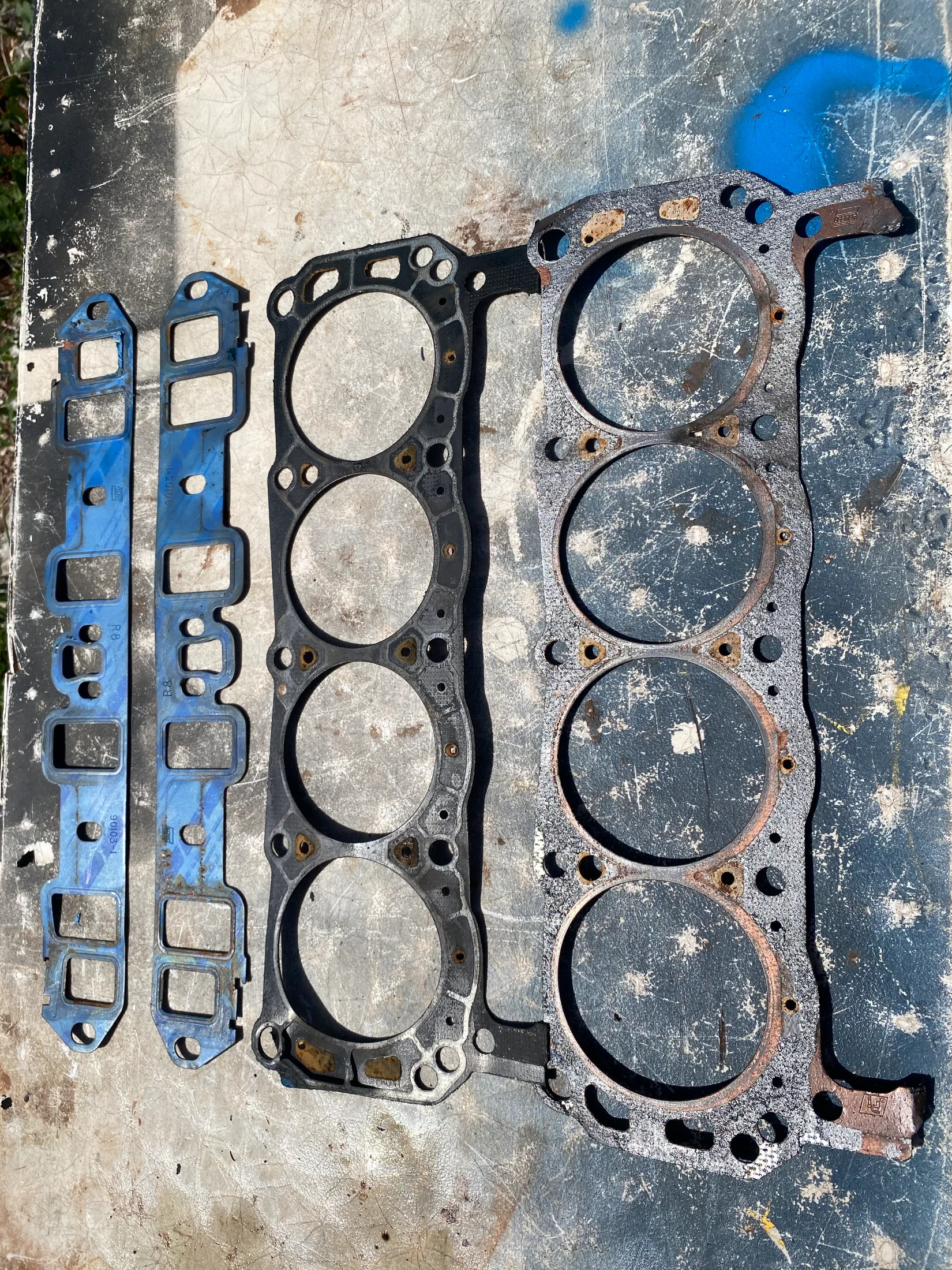

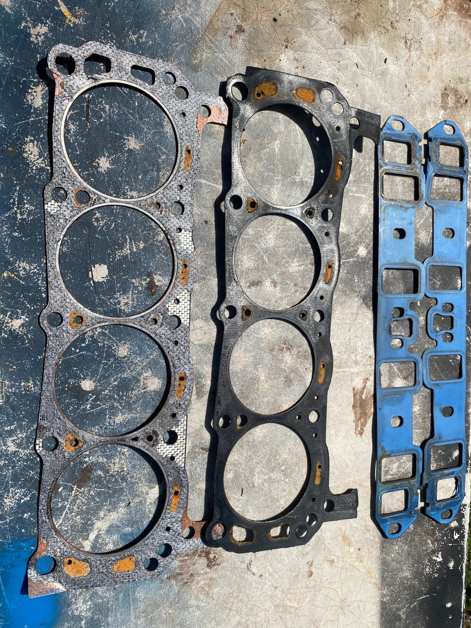

Pulled the heads off, both this time, Not seeing anything definitive.
After much much staring at the head gasket, Maybe it was leaking compression between 5 and 6.
Drivers side head gasket was all stuck down good except the thin spot between 5 and 6.
Then it rained. Always happy to see the Flat tops in this '2V' engine. No ring ridge, none.
Guess I'm buying a dye kit.
Post close up photos
Hard to do good photos of cylinders
But after much staring at the close ups and
Whats that!?! go inspect and nothing
Still went to all auto parts stores by me looking for a dye in the crack test kit.
Only one is willing to order it if I pay excessive blackmail type taxes fees + shipping.

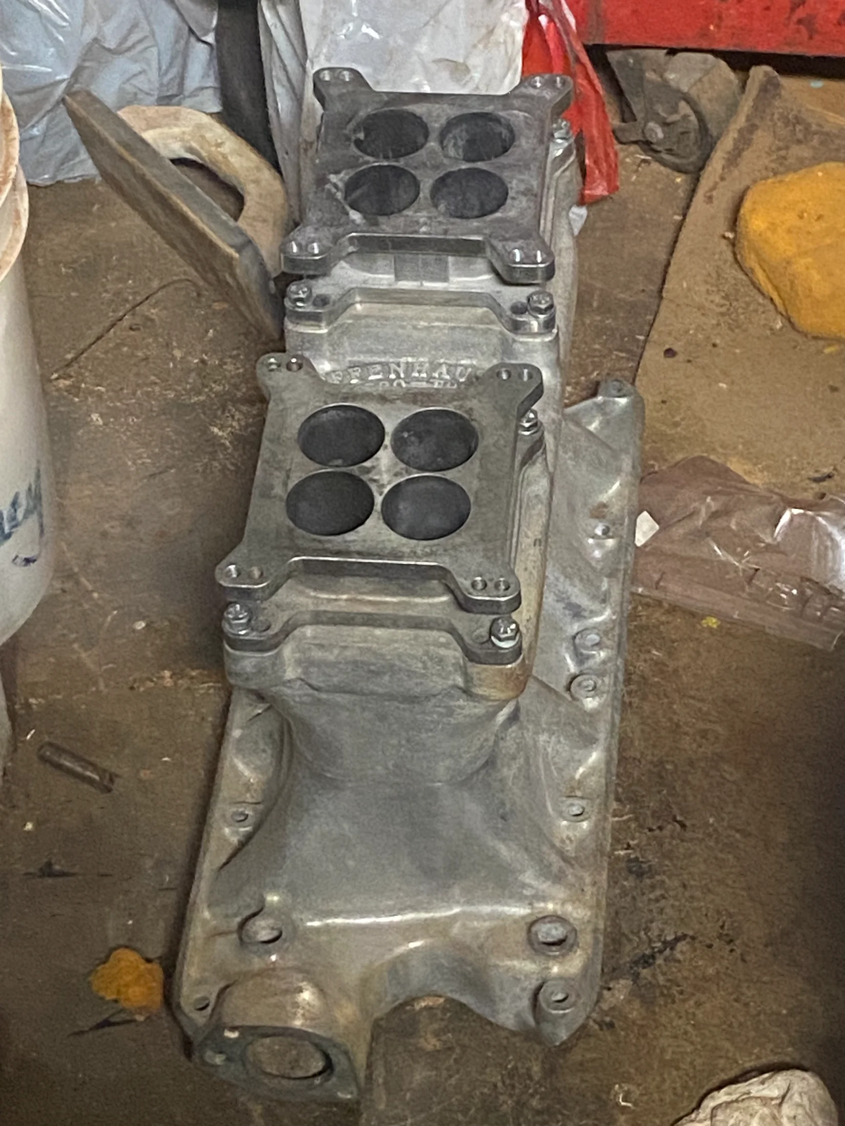

Offy 360 degree 2x4v 289 Tunnel Ram!
Coming soon to a Mustang or Hot Rod near you.
