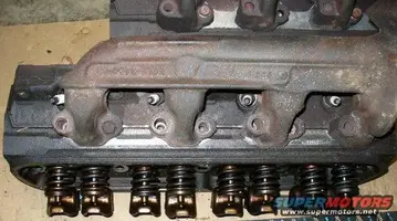

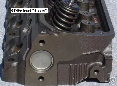

Now being in Hawaii I'm not sure what your available options are, but a good upgrade would be a 5.0 from an Explorer if you can get your hands on one. But be aware that they are most likely a different balance than the old 302 in the II. I don't know for fact that this is the case, but it stands to reason that they're a 50oz vs a 28oz engine, so in any case you'll need to take some stuff to a machine shop. If it were me, I'd try for the Explorer engine and rebalance the flex plate/flywheel and go from there. Also, if you're not aware, the later Explorers use a GT40P head which has a different spark plug angle than any other small Ford, so you have to watch out for that as well. Easy identification between the P heads and the earlier GT40 style heads used on earlier 5.0 Explorers is that the "P" heads have 4 bars cast into the end of the head whereas the earlier GT40 style heads have 3 bars cast. If you need more info on what to look for go to the Fox forums and do a search on Explorer head and engine swaps. It used to be (and probably still is?) a pretty popular option. While you may run into some of the same problems with an Explorer engine, almost everything in them is an upgrade over the old 70s iron....

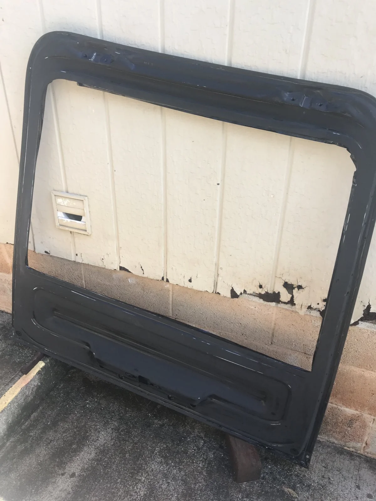

I spent most my budget on that deck lid and a new front window which is on order (6 to 8 weeks 450$ installed).

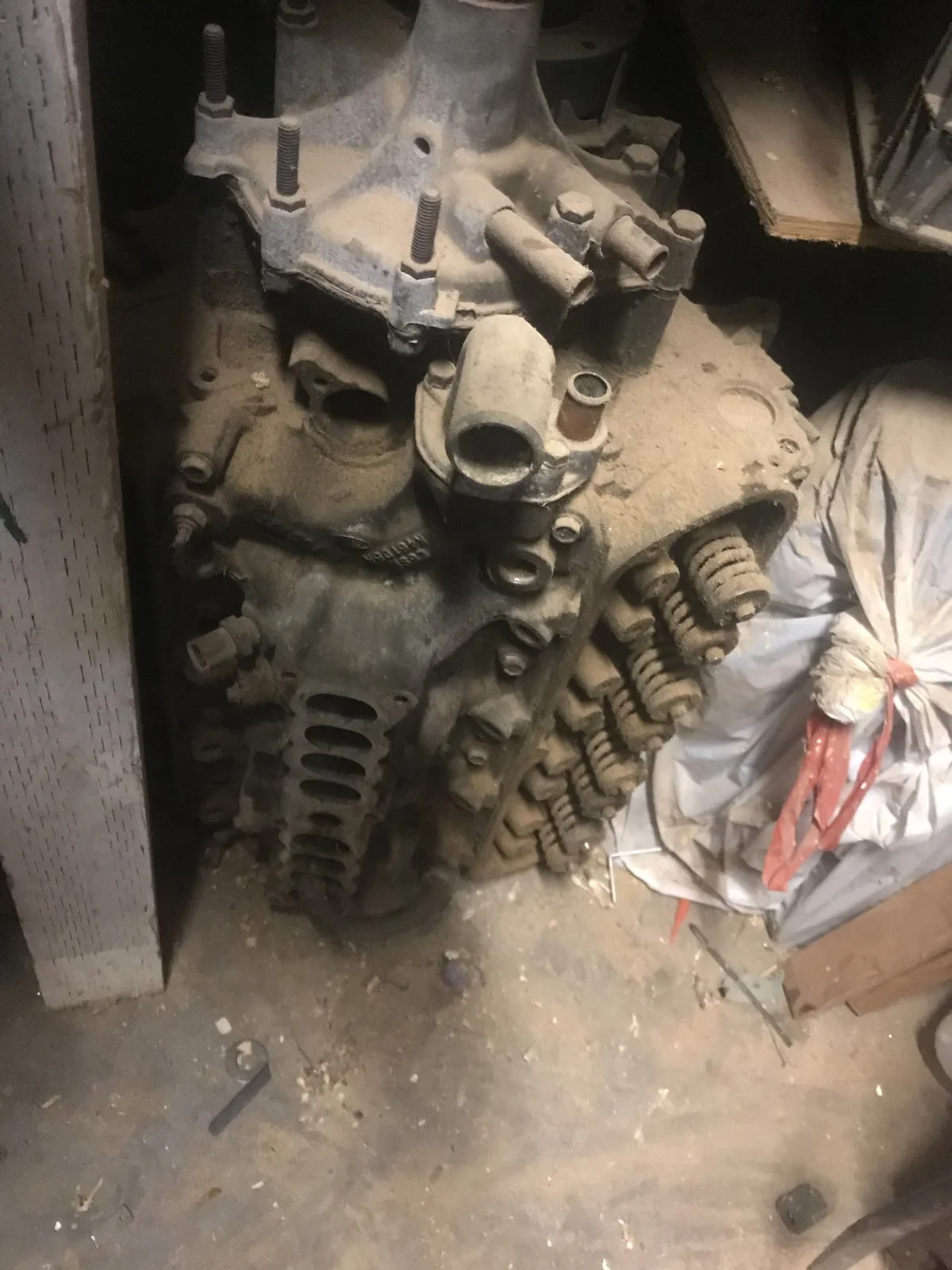

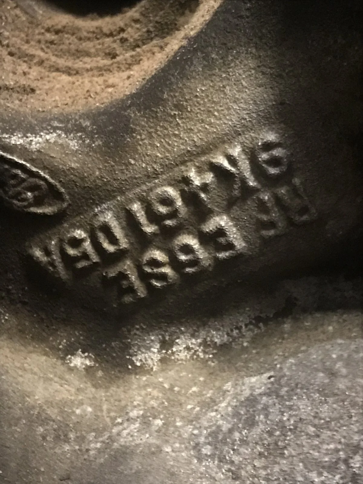

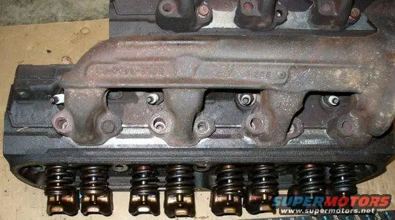

I'm thinking this one, Looks like 'E6SE' on manifold. 1986 Thunderbird ? I bought a pallet with two engines, k member and a T5 on it. The kid selling it had just wrecked his fox but his engine was still in it. This is what he was going to build so its an unknown to me. I thought he said it was a van engine at the time. Cant find casting#on starter side.

And yes, that is exactly what I'm talking about! If you were to use an Explorer engine, the only thing you'd really need to have done is rebalance the reciprocating assembly to match whatever you were to use for a flywheel/flex plate or vice-versa. So, if you were to use the original II bell housing, the flywheel/flex plate would need to be rebalanced to match the balancer and crank. If you chose to use everything from the Explorer, you'd need to use the larger bell housing which presents it's own problems with installation, mainly on the exhaust side of it all. Other than that, it's a pretty easy swap from what I can recall of it. Just install a carbureted intake and swap the distributor with one that would work for what you're using (could be factory, could be aftermarket?) and you're golden. As far as the engines you already have, the same principal applies as long as they're good engines. The manifold in that picture looks like the lower manifold of the 5.0 HO. If it's stock and truly from an 86 T-bird or Mustang, it's most likely a 50oz imbalance engine, therefore you'll need to go through the above process with it as well. If you chose to go with the T5 and all the associated goodies as well, then the engine balance probably won't be a factor given you use the same flywheel and bell that come with it all. Then all you're looking at is essentially a T5 swap which has been documented in various posting and sites on the internets. Again, your exhaust is where you'll run into a slight snag - not impossible, but not a "just bolt on some headers and go" type swap. Speaking from experience though, it's definitely worth it as long as it's all good stuff. :)

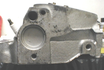

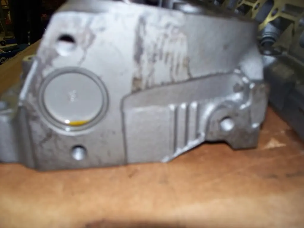

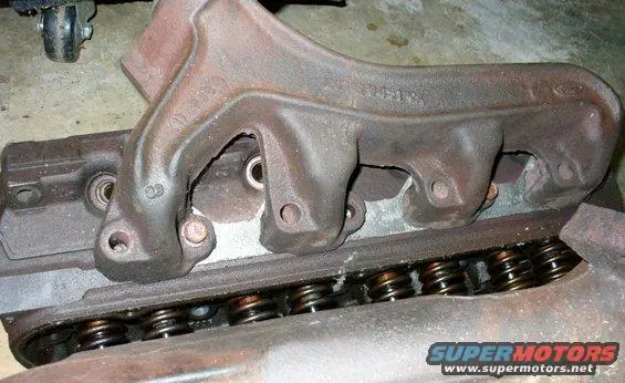

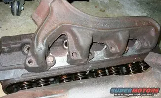

Here you can find some info about my build. I'm using a 2000 explorer engine (but with T5). Lilcbra has written everything important. One more thing about the GT40P heads (its very diffciult to get the GT40 heads): the spark plug is diffrent. I test fitted different headers/shortys, but they either don't fit the car or the spark plugs. At the moment i'm thinking of putting in my old 289 exhaust manifolds (they should be very similar as the MII exhaust manifolds). Performance wise they aren't realy good, but they fit with a little bit of grinding and i'm getting the car running...
Here is a thread about were the 289 manifolds need to be grinded.

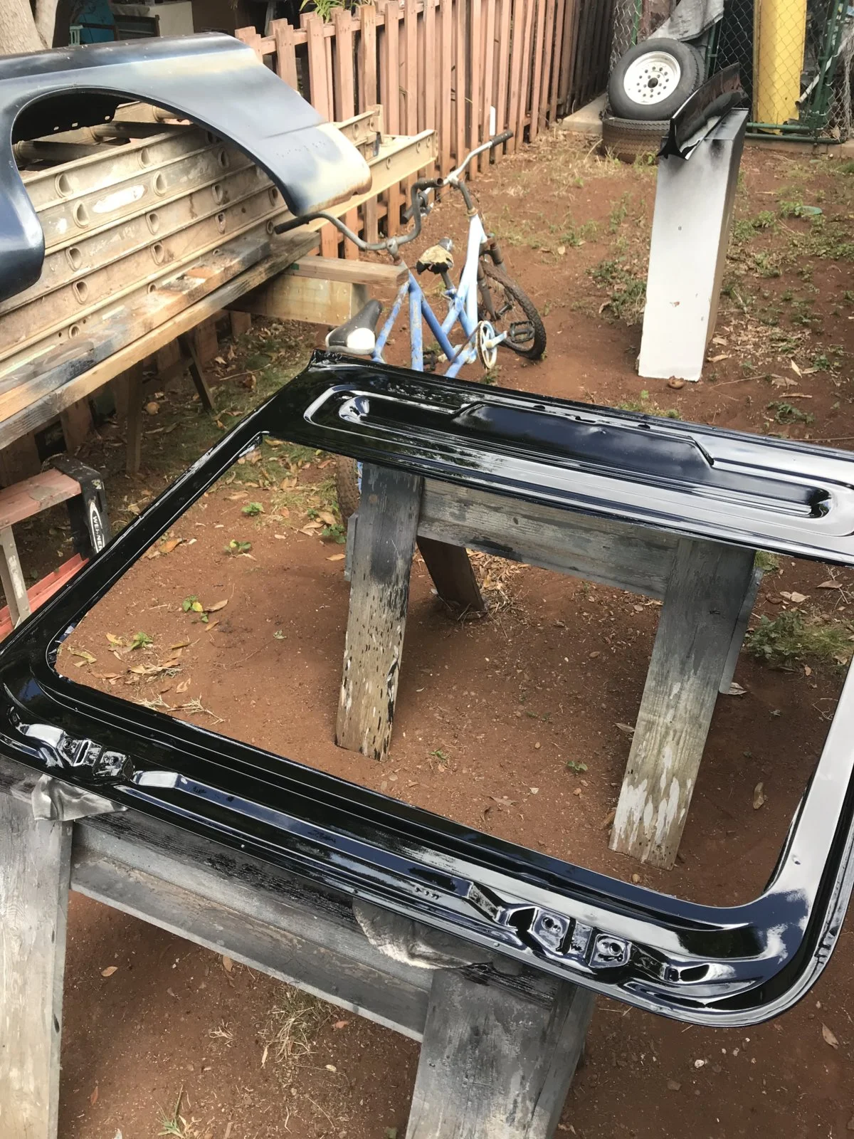

Ahhh...shorts and t-shirt weather...I can't wait.
Sending good weather thoughts your way.

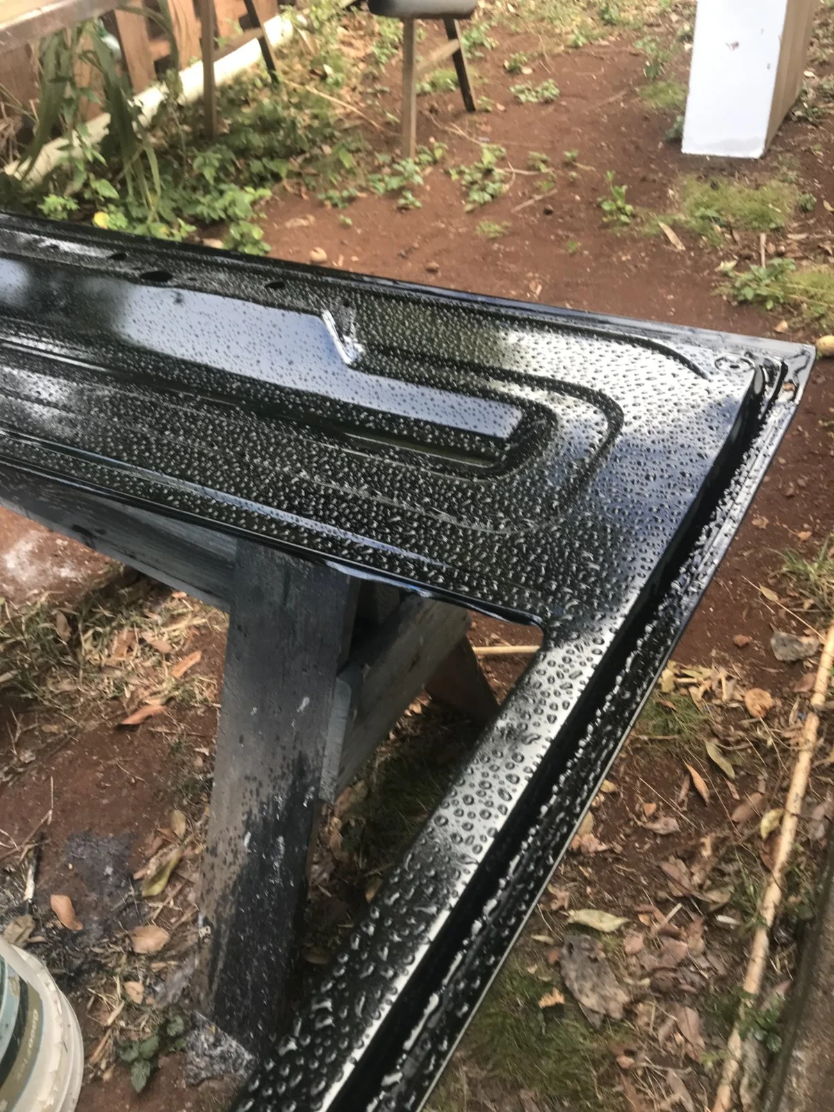

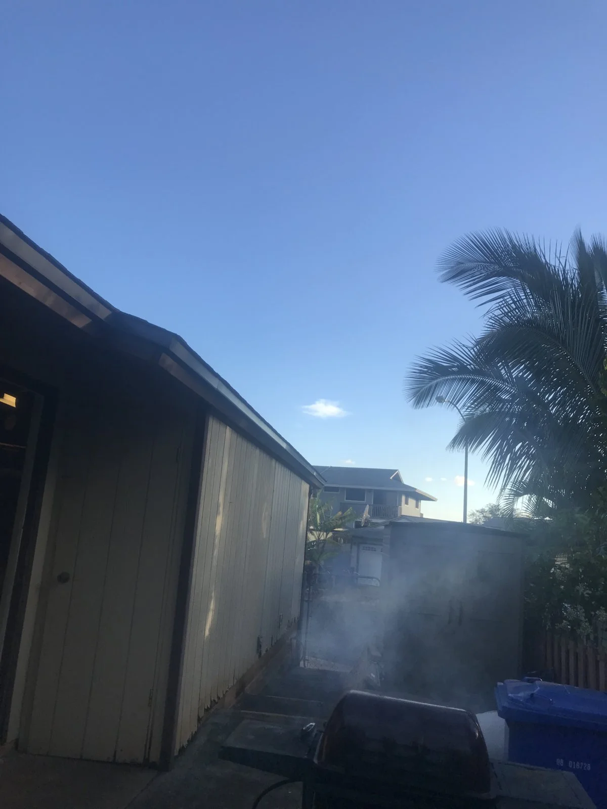

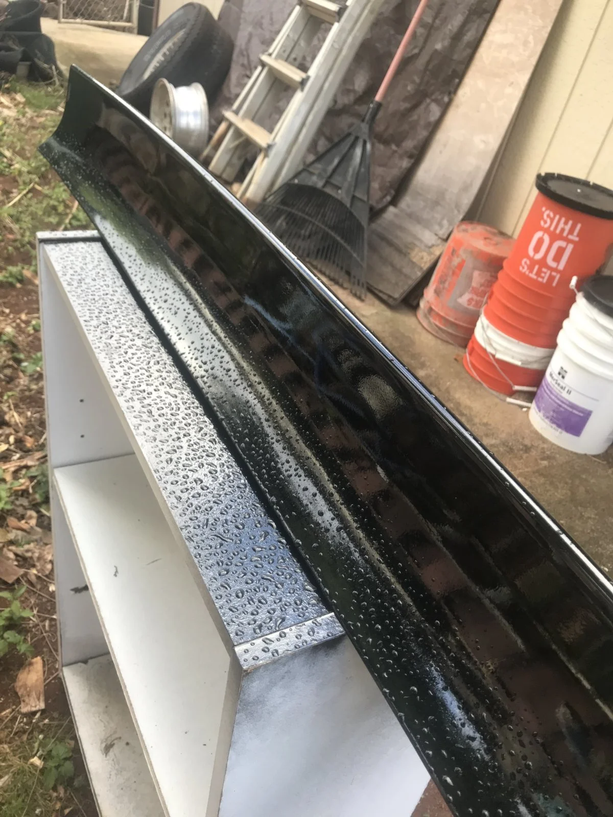

Was all happy and started cooking salmon on bbq for dinner and then it rained from a blue sky.
Was mad so i took picture of the sky
only lasted 10 seconds. Notice the ground is still dry
Going to have to scuff and shoot it again now,
oh well into each life a little rain must fall.

Are you sure it was rain or was it a neighbor playing a bad prank with a hose? lol
Looked good until the water hit, good job to the boy!! :)

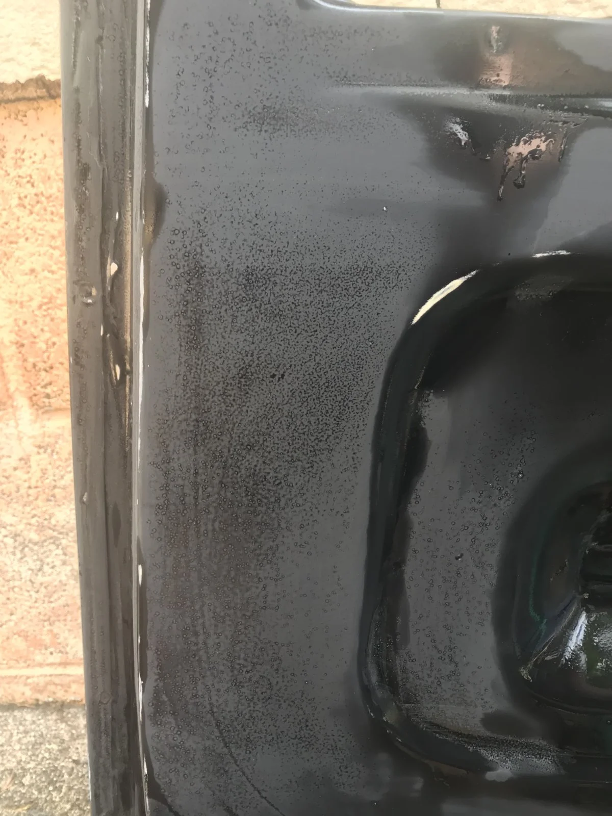

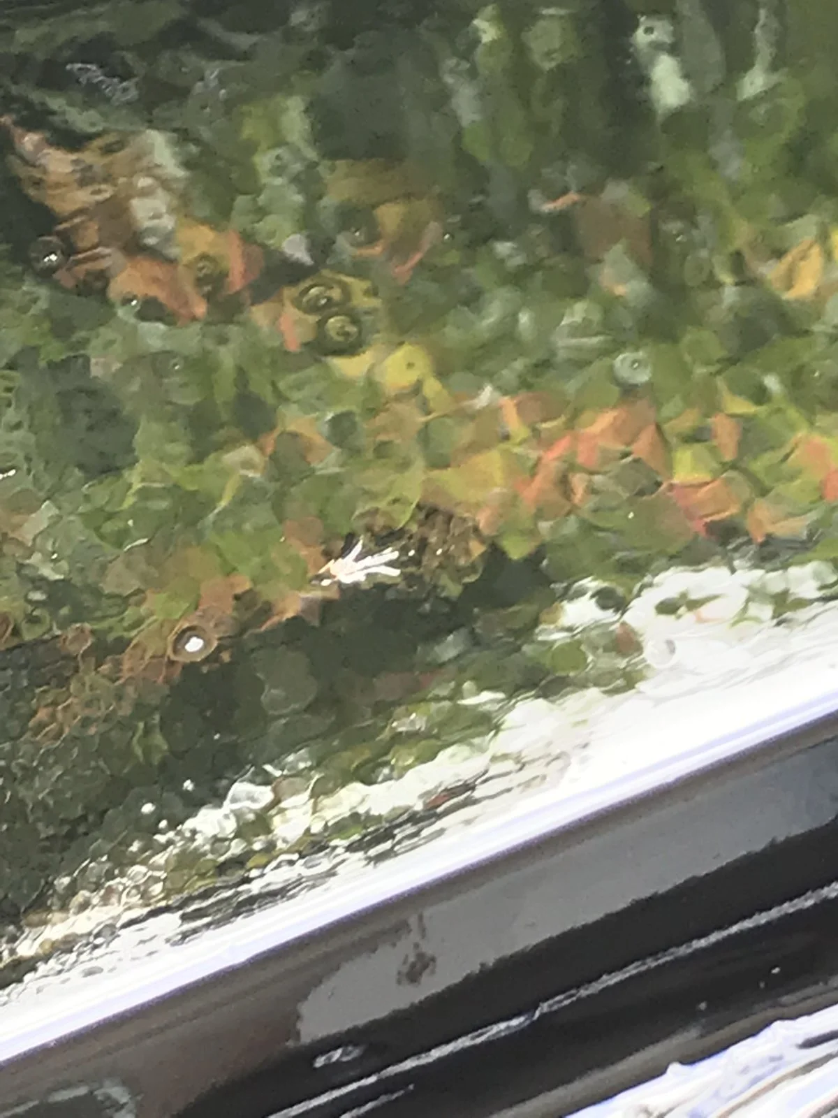

Got after it with the 400 grit. You can see the texture the rain left that I'm sanding off. Alligatorskin.
Still a ways to go.
Hard not to burn thru the corners
A couple more nooks and crannies and it will be done,
Then it got painted again.
But painting outside has drawbacks. A bug flew over, fainted, and crashed, and burned.
I think he made the crater!?!
It'll still be good enough for back yard style.
Bug is my copilot.

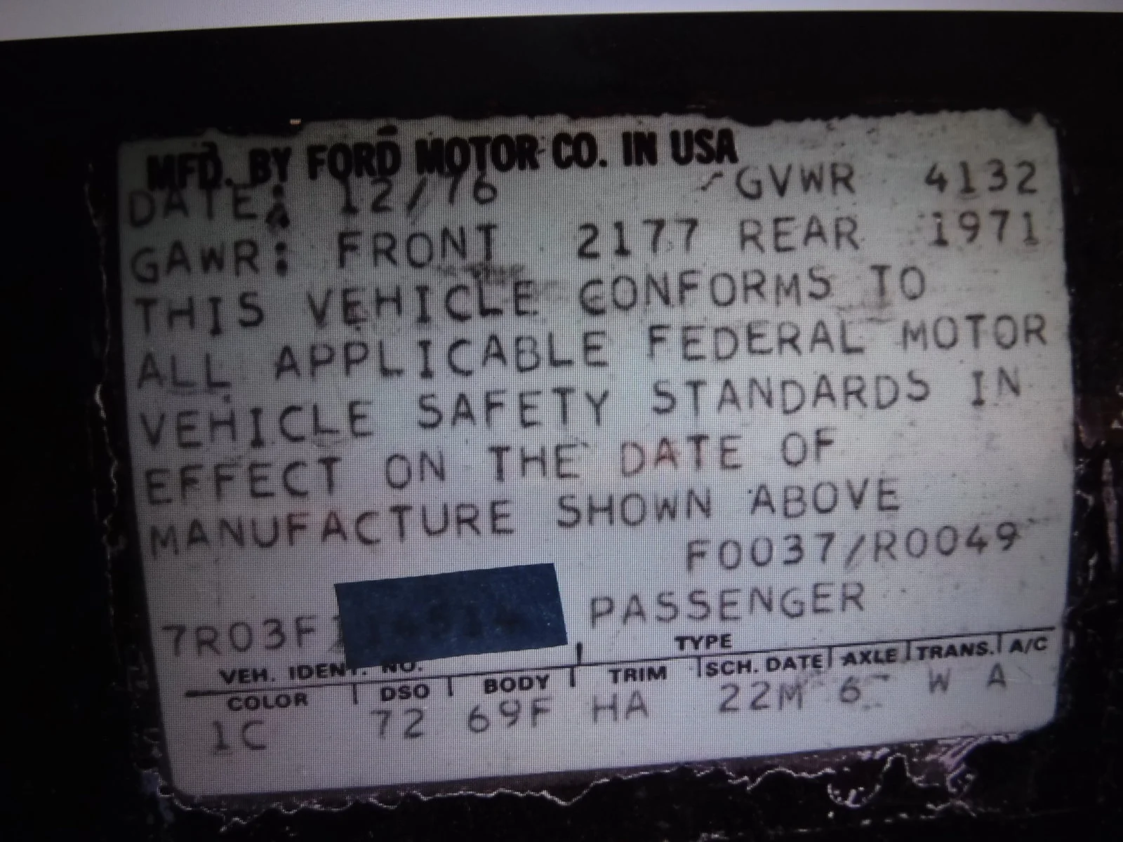

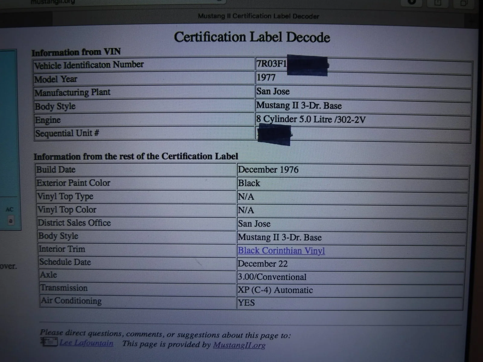

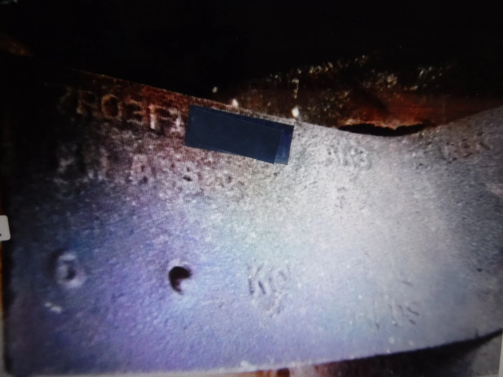

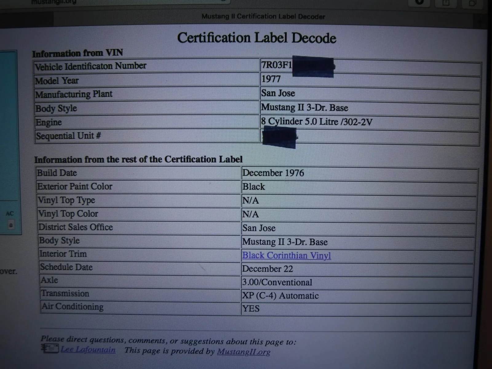

Was curious if real Cobra II or not, I thought CB on tag would be correct.
I guess "KC" on buck tag means yes? How else can you tell?
With build date of Dec76 it aint no King Cobra.
Sorry for crummy image, Hard to take this shot.
