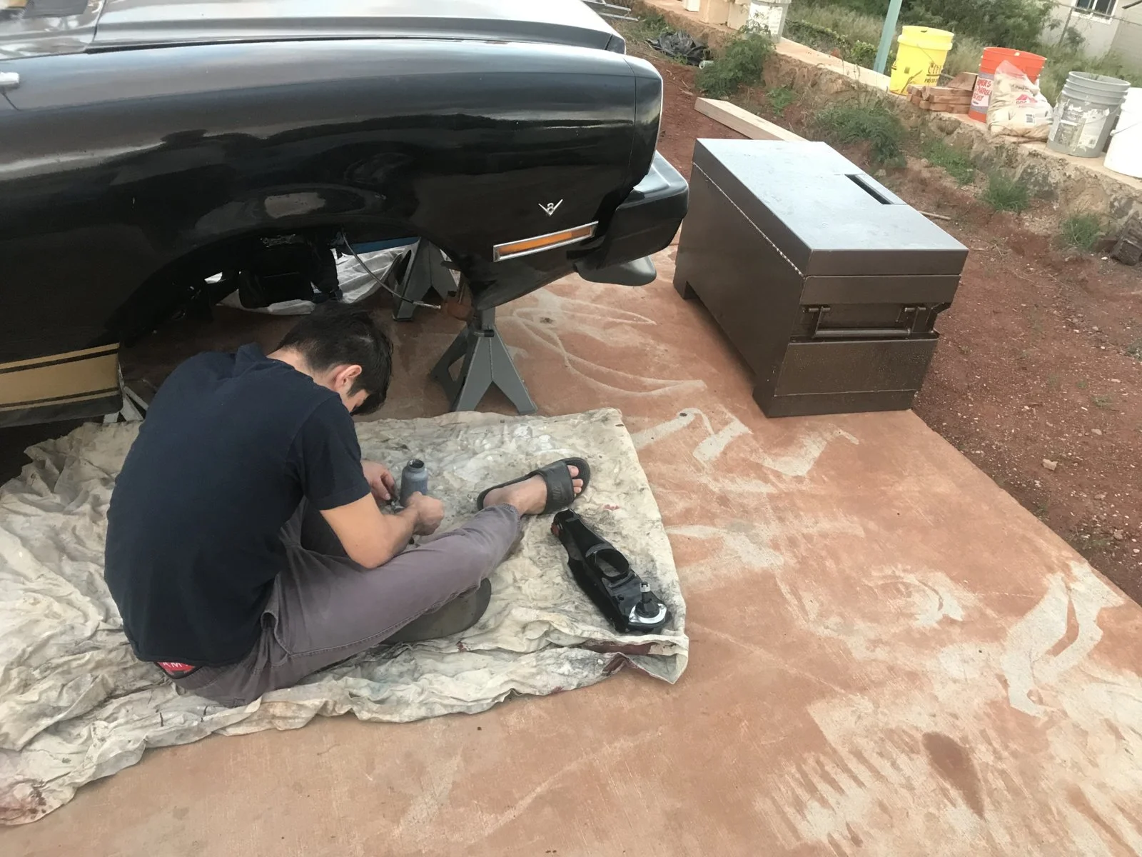

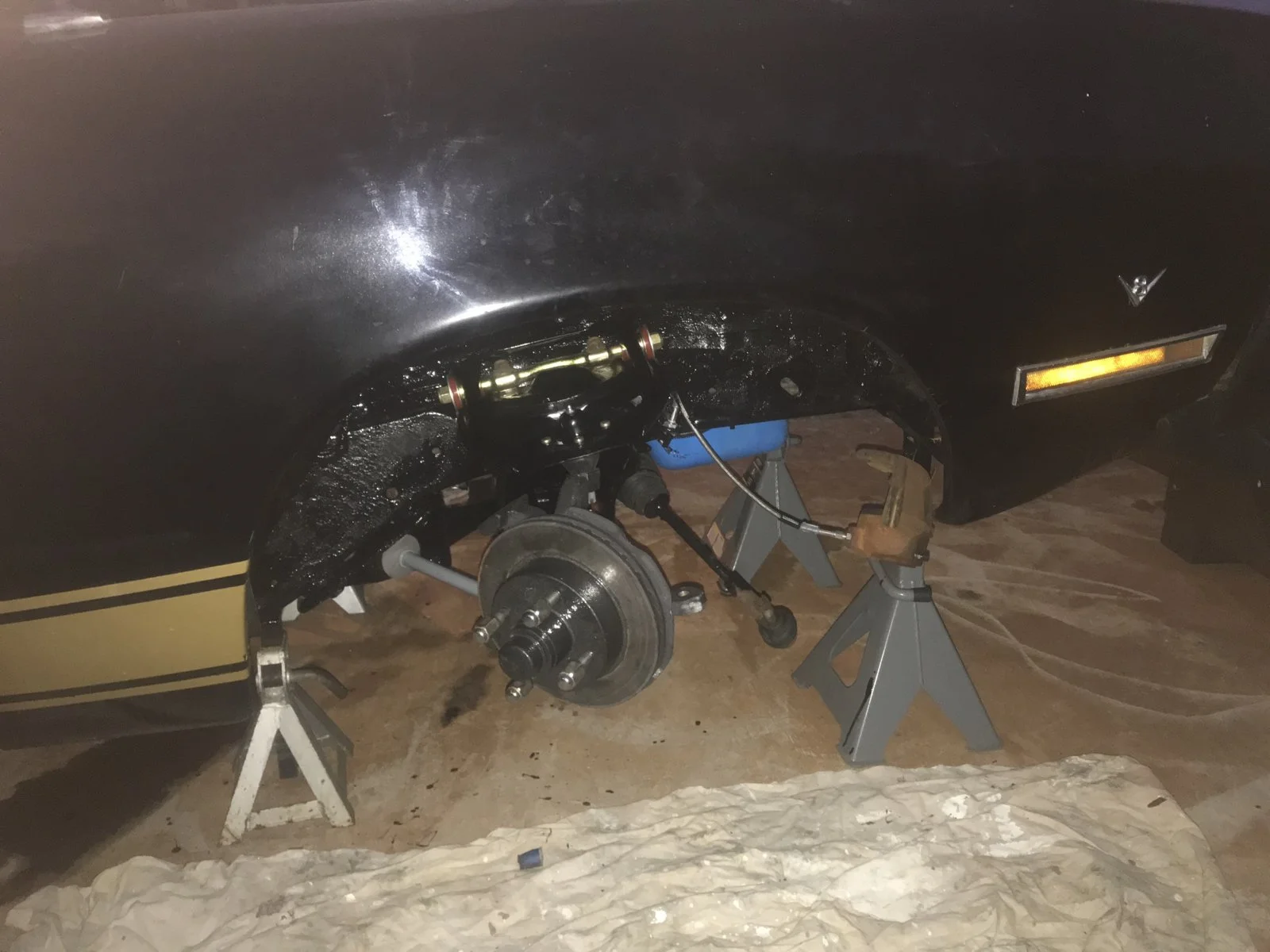

The moment son and i can get together is always as sun goes down it seems.

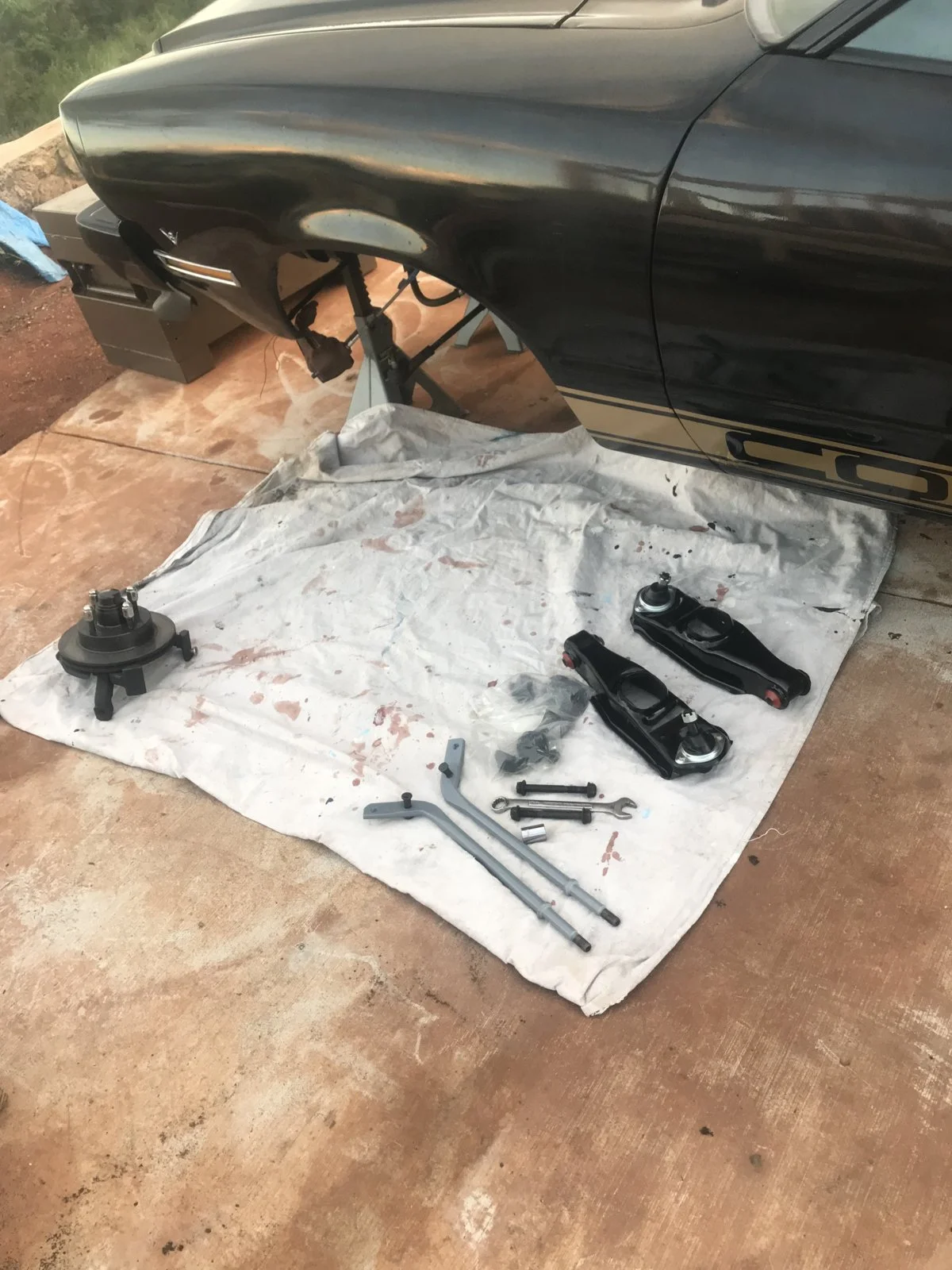

Its a start, we still got to clean and install springs, sway-bar, tie rods, and rack mounts.
Thinking repack them new bearings again too.
We cleaned and worked on painting the rotors and spindles as well.
Thinking about a caliper paint kit. Gold? Maybe Black? what you think?
Progress!

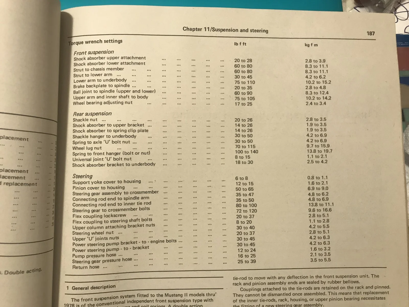

Mocked up and almost ready for some locktite and torquing.
Looks like wheel bearing torque setting is wrong in book.
:):D:p;):cool::rolleyes::):D:p;):cool::rolleyes::)

Hey, the torque for the wheel bearing nut, is only valid if you loosen the nut 1/4 turn after you torqued it. This the official installation procedure from Ford (should be discribed in your manual).
If you want torque without loosening the nut, 100 in-lbs should be the right value.
Reactions: 2Blue2

I did the front bearings the way the book said. Are you saying the book is wrong? I remember thinking it was odd at the time.

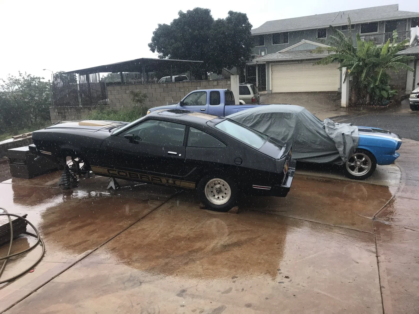

You can see the raindrops raining on my parade. :( :confused:
High winds blowing cover off blue one.:eek:
