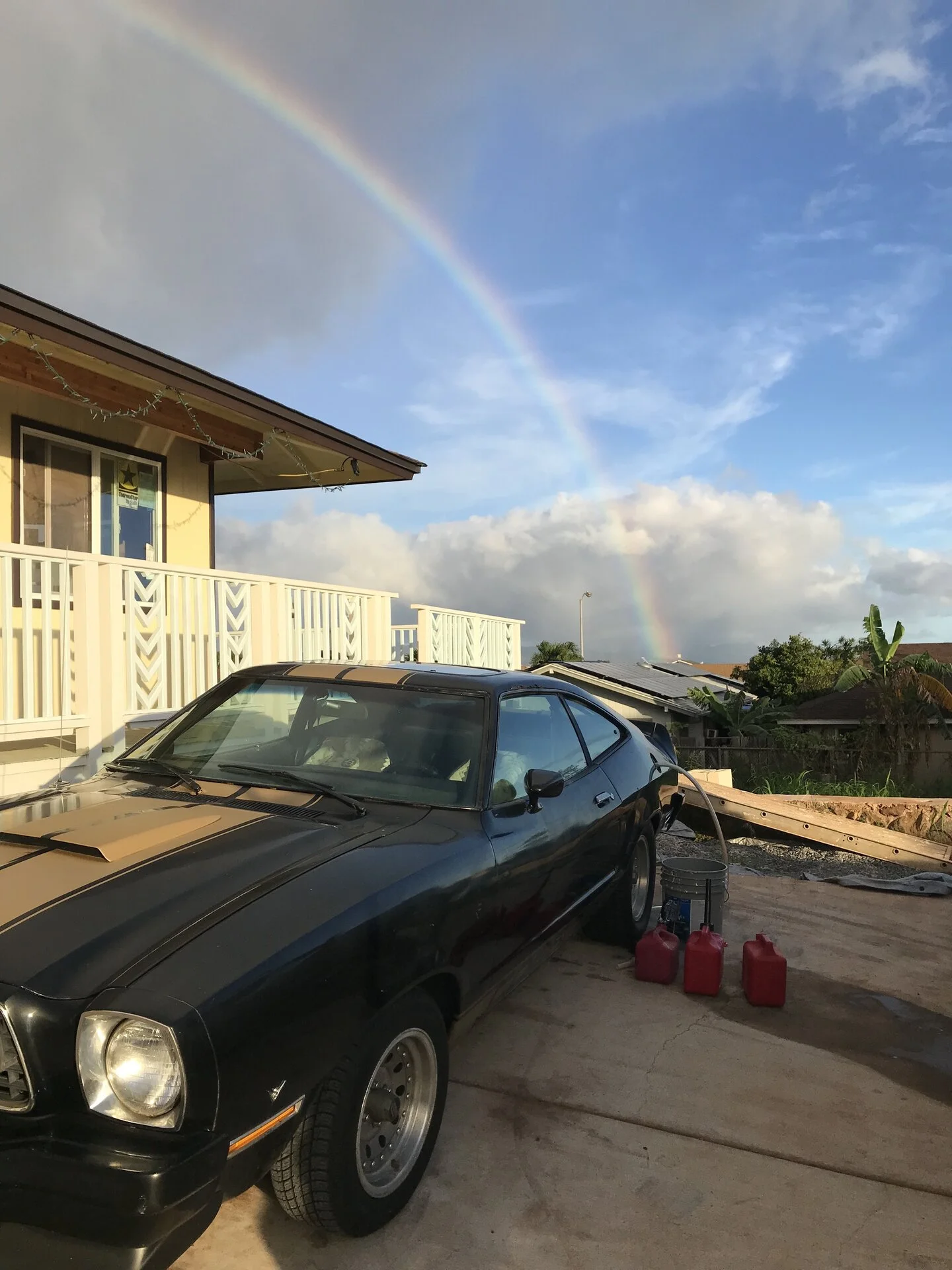

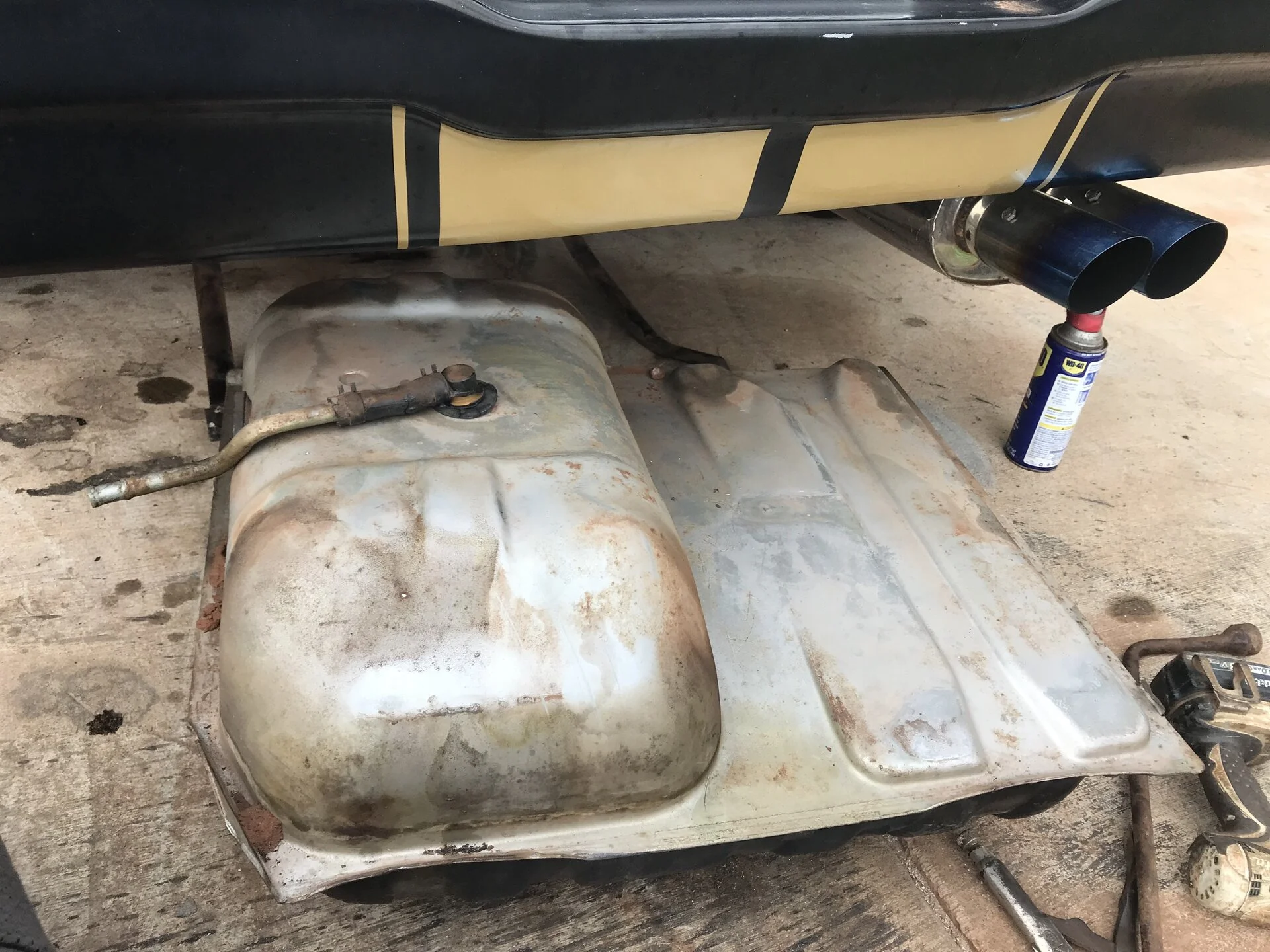

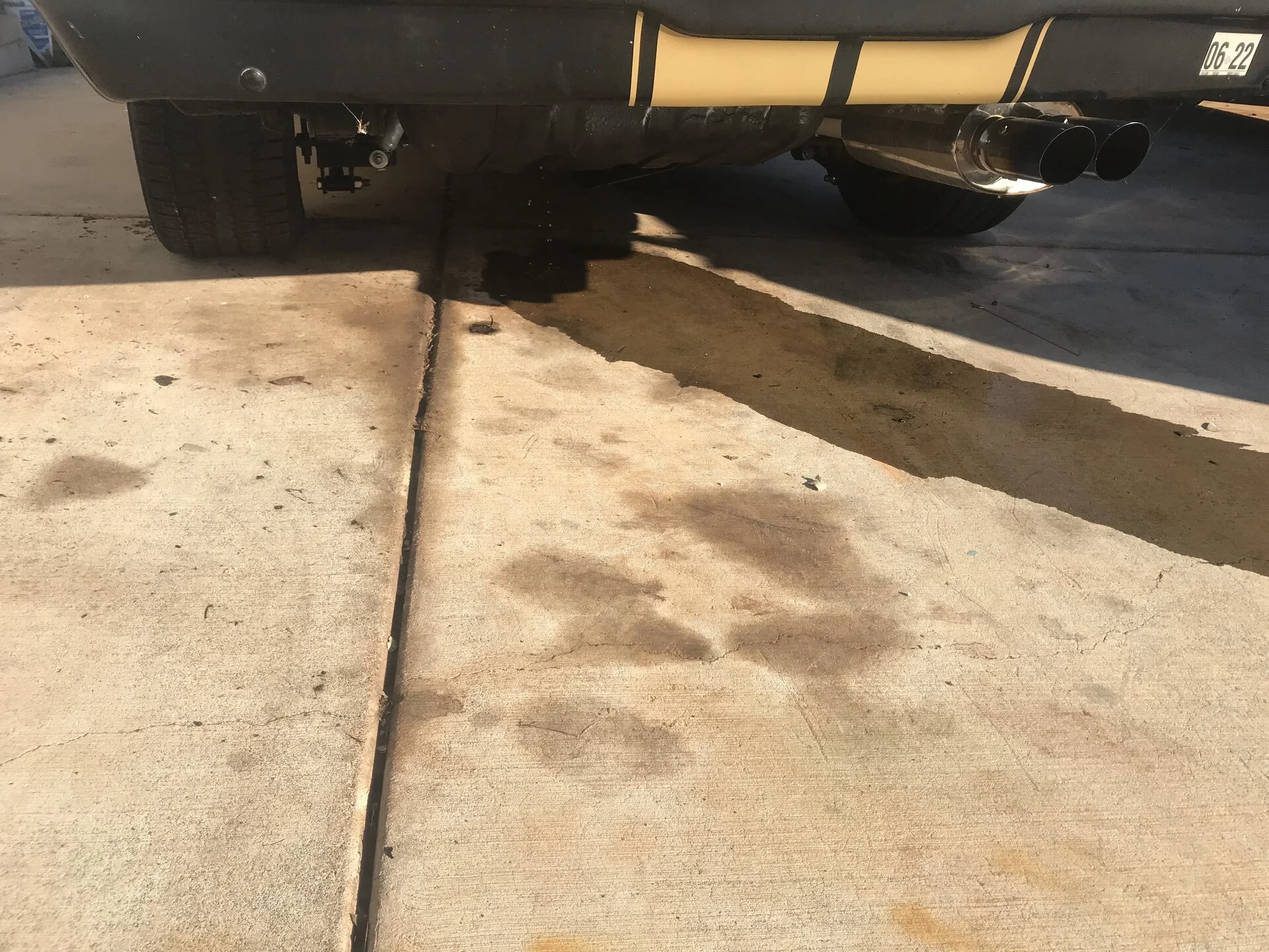

Went to gas station to fill her up and she leaked a gallon and a half on the ground at the top off.
So with the Christmas rainbow shining through the sky,
I syphoned her dry. I was trying not to make a mess.

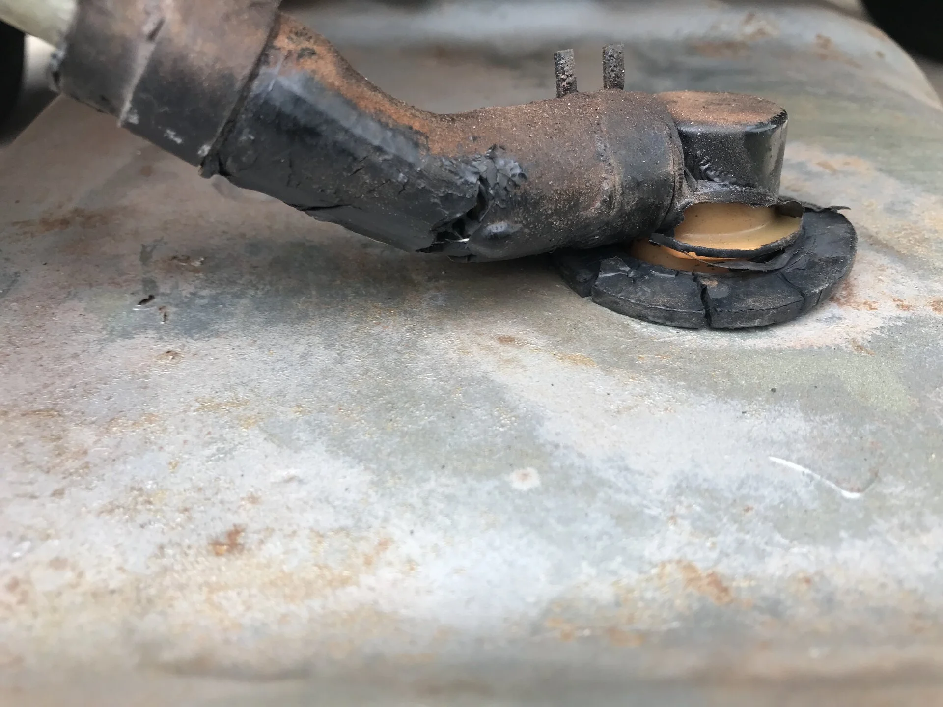

The point of contention...
Olivethefet
I will own your nuts! LOL
5 Year Member
May 17, 2018
2,596
1,790
143
Enterprise AL
Dec 26, 2021
#807
  • Dec 26, 2021
  • #807
You should probably fix that. Just sayin
Reactions: Enzio

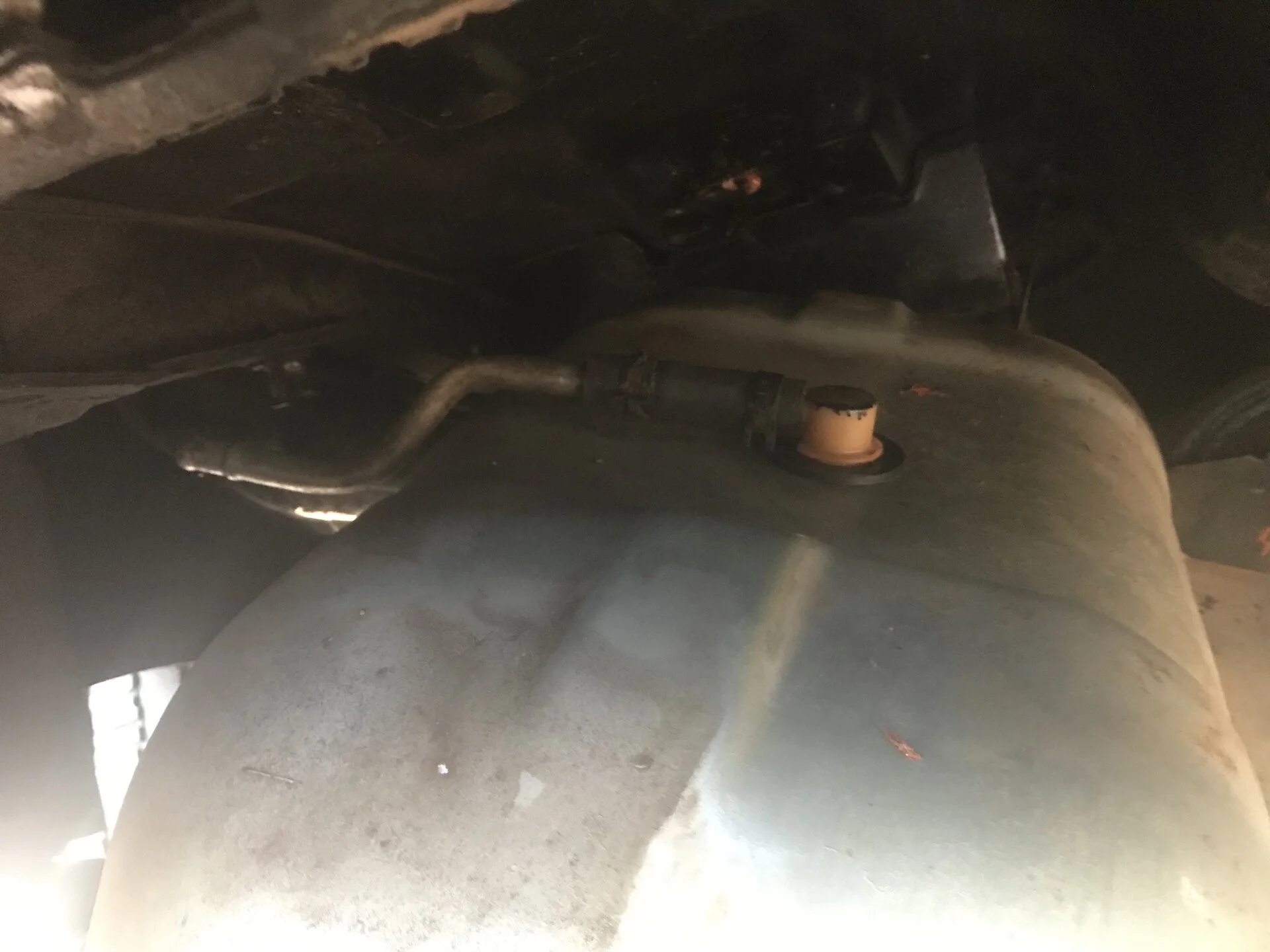

Who stocks that tank vent?
2Blue2
will be trying this sex one when I can find it
Mod Dude
Mar 5, 2019
4,436
2,903
163
Oahu
Dec 26, 2021
#809
  • Dec 26, 2021
  • #809
Looks like SSC.
Reactions: Enzio
extra_stout
5 Year Member
Aug 27, 2018
831
953
113
Germany
Dec 27, 2021
#810
  • Dec 27, 2021
  • #810

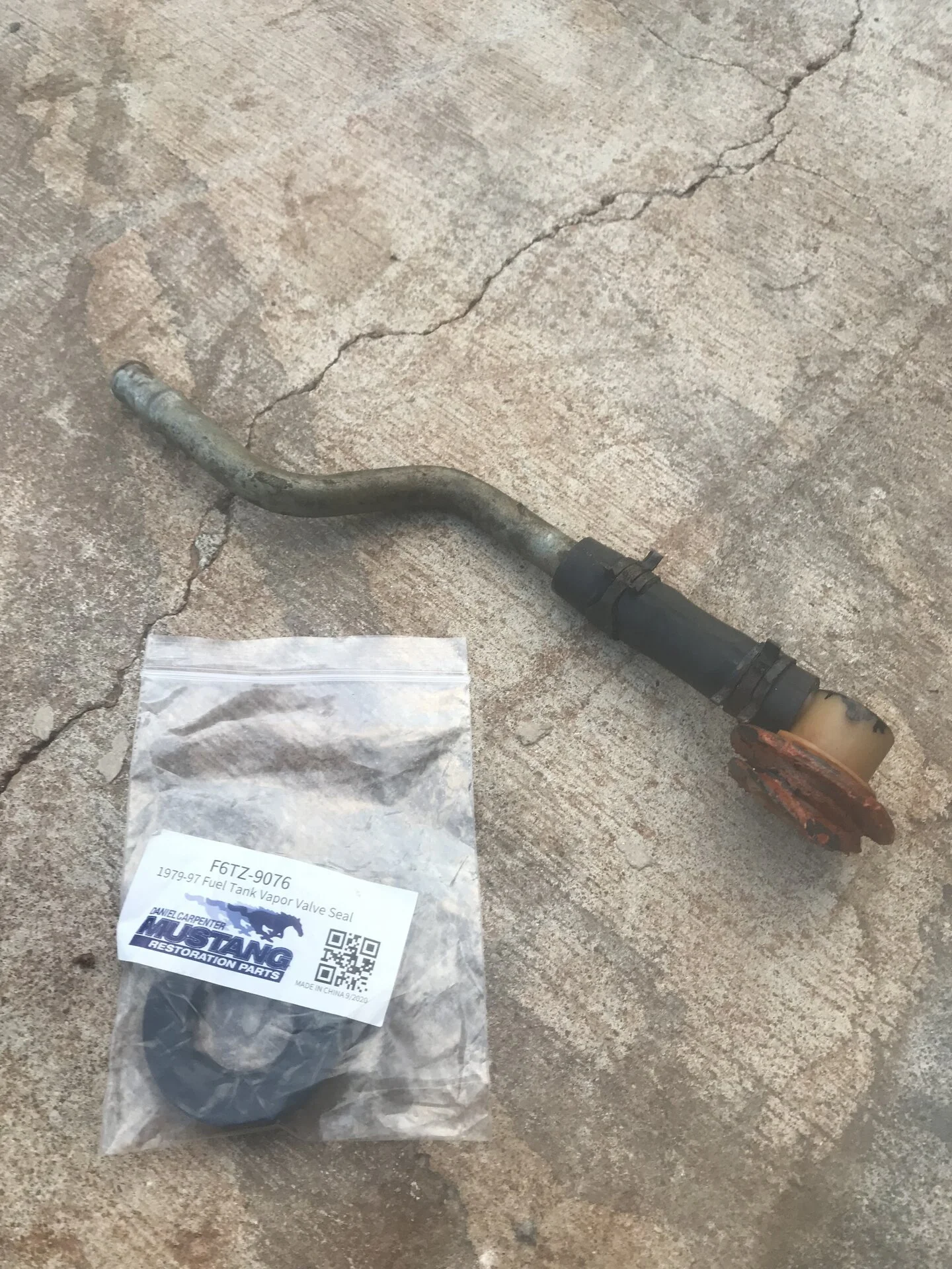

VW T3 Transporter parts fit also. I used following part numbers:
Grommet: n90100501
Vent with roll-over-valve: 251201311b
My vent-plastic-90deg-elbow-thing was without roll-over valve, so I was happy to have a upgrade for half the price the mustang vent costs:
https://www.ebay.com/itm/253474216585
They also have the grommet: https://www.ebay.com/itm/263766015386
Reactions: Enzio and manicmechanic007
So Awesome
Thank you
grommet is ordered...
extra_stout said:
so I was happy
I was so happy2
Reactions: extra_stout

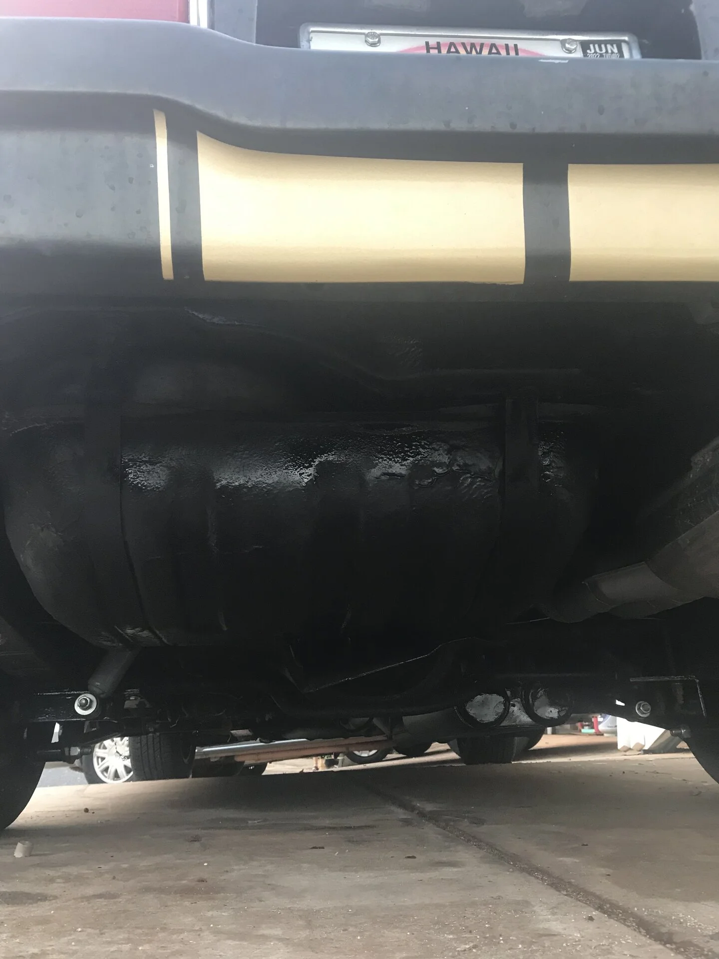

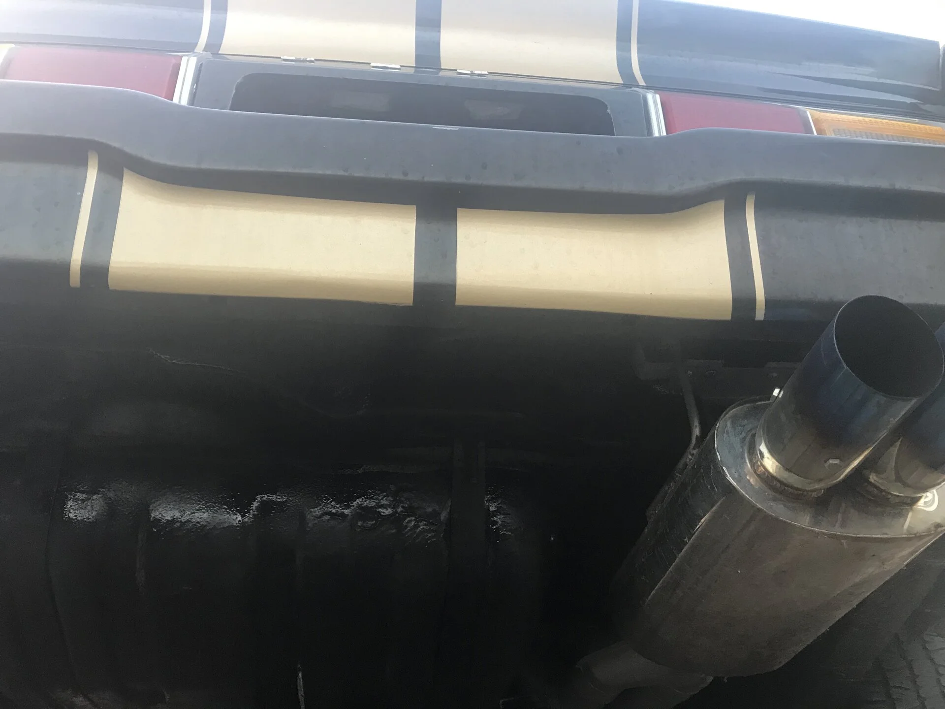

What size was the vent nipple?
The stock roll over vent nipple was 5/8 on mine. Said for '79 but fit fine. 1 inch vent hole in grommet.
Cleaned off the copper silicone. Vent plug thing inside went up and down easily when I shook it.
Put back together and rattled canned er new black so can't see anything under there.
Fixt now!
Just got to get enough gas in er belly to get to the gas station now...
I do not remember. But I used either 6 or 8mm hose on the vent. Was your vent hollow (without check ball or float)? My 74 was without check ball or float. This is why I upgraded (even if i do not like VW).
The grommet fitted fine. Description of grommet says:
inner diameter 48 mm
outer diameter 23 mm
Fuel systems works without any issues. I do not have pressure or vacuum when opening the gas cap.
Reactions: 2Blue2

Not that you are planning to roll it over but I would use a newer valve with a check ball or whatever works
I would like to see you use chev parts before vw
That's how you fix old chevs (you put ford parts on them)
Reactions: 2Blue2
Old stock check valve seemed to function fine but everything I touch on this car needs replacing it seems.
