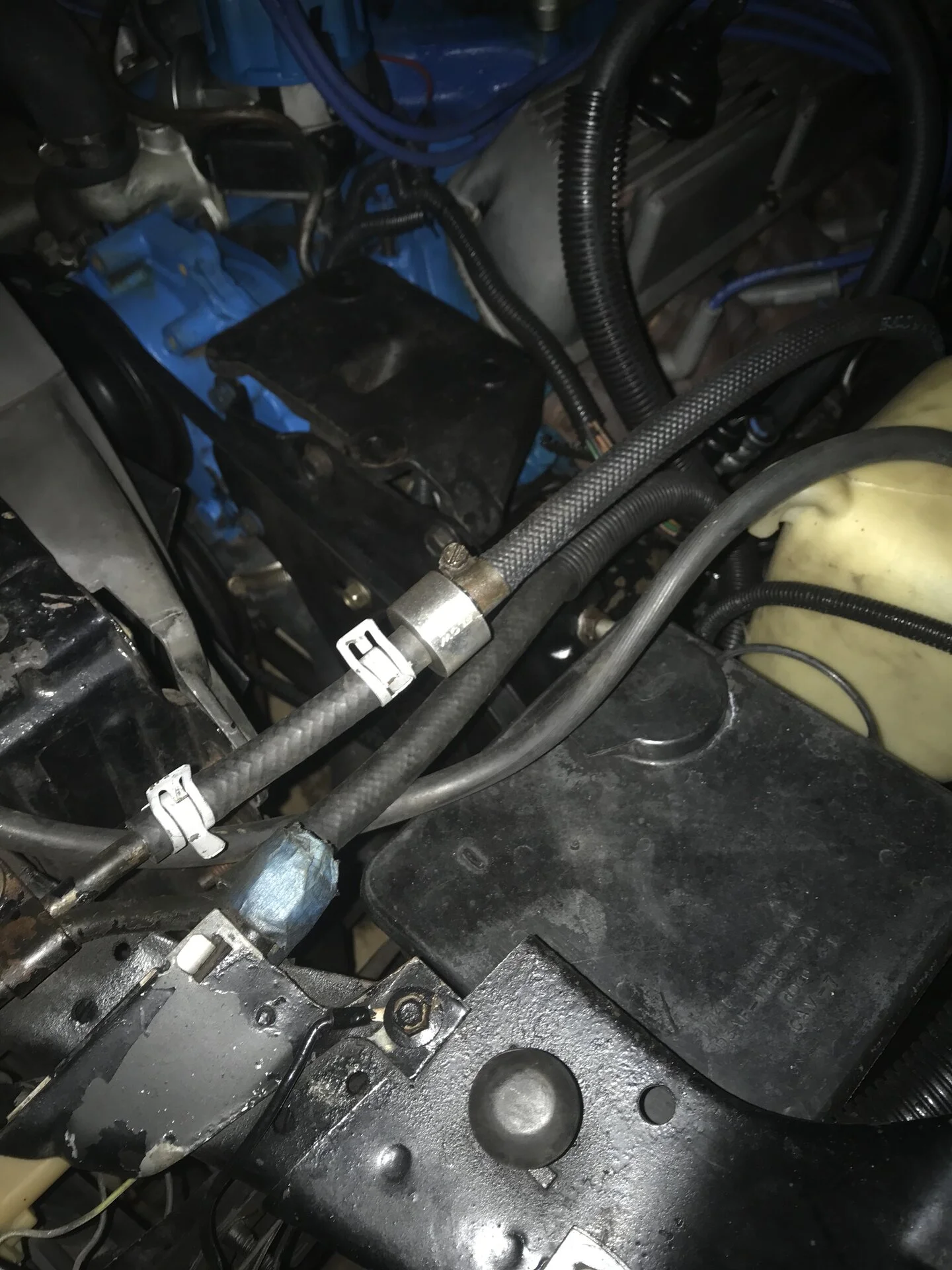

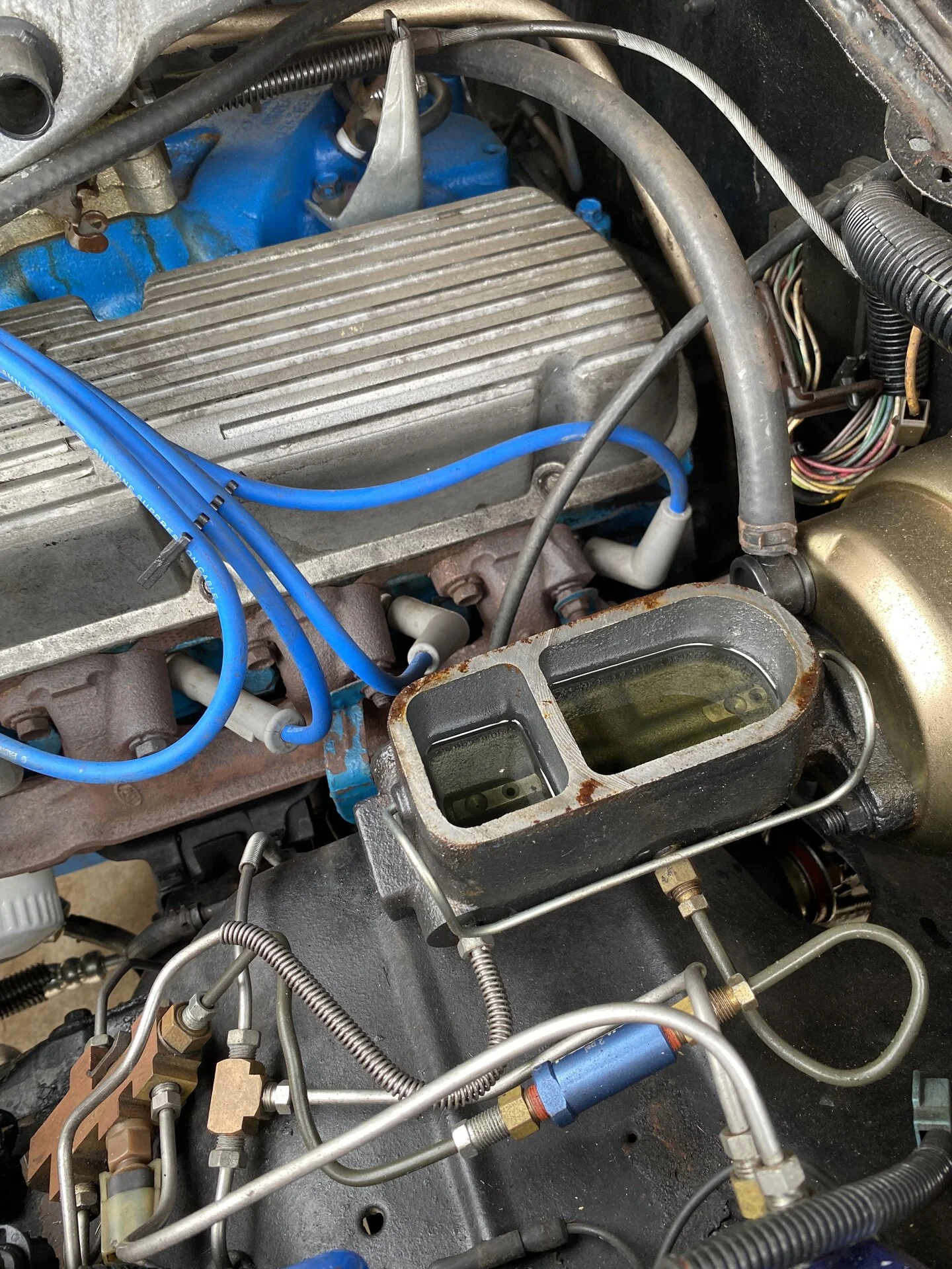

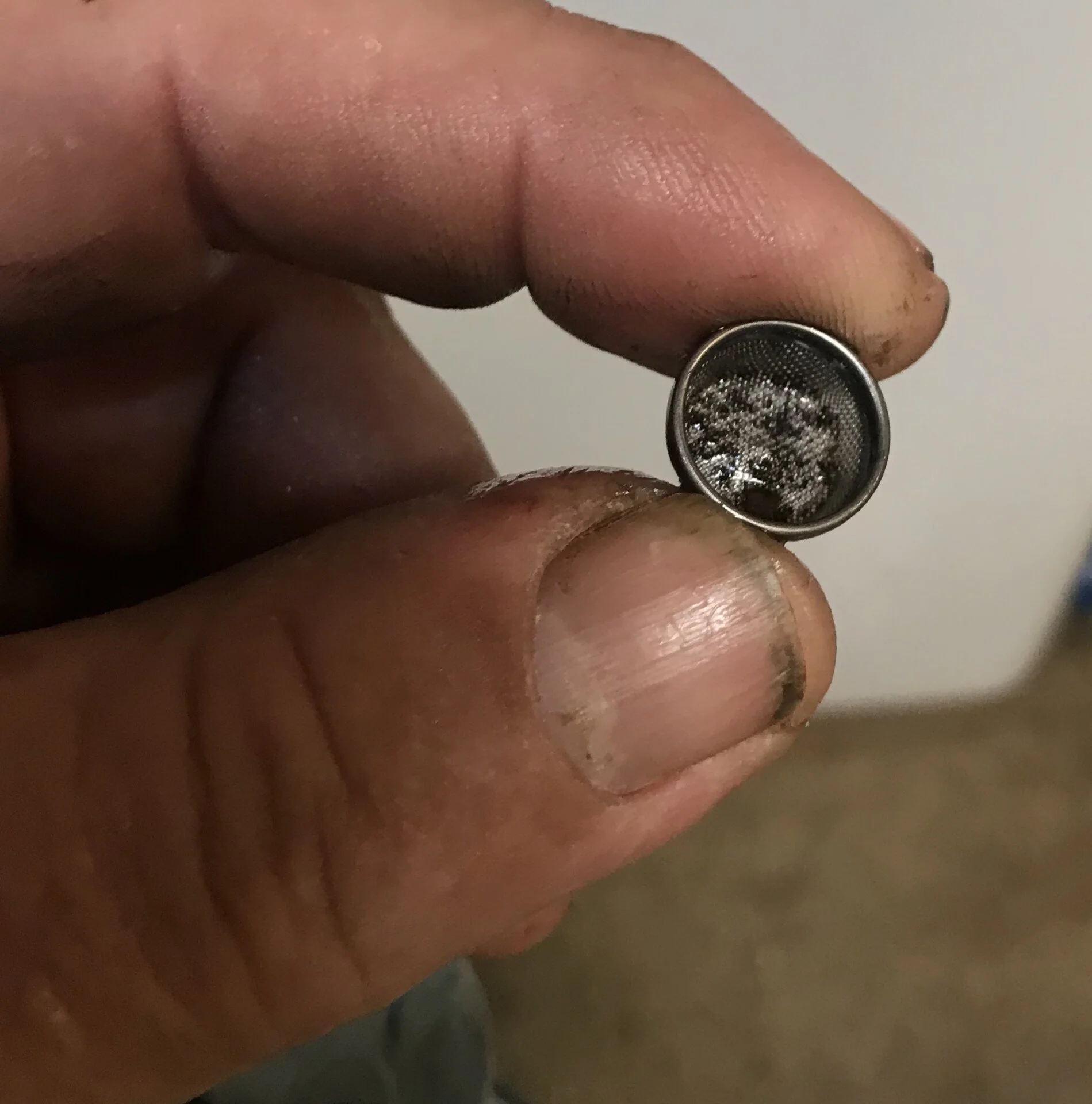

Yes an the only original part left is the fluid cooler which I flushed twice. Once with each pump.Wasn't that new and/or rebuilt recently? Seems to be a lot of metal.

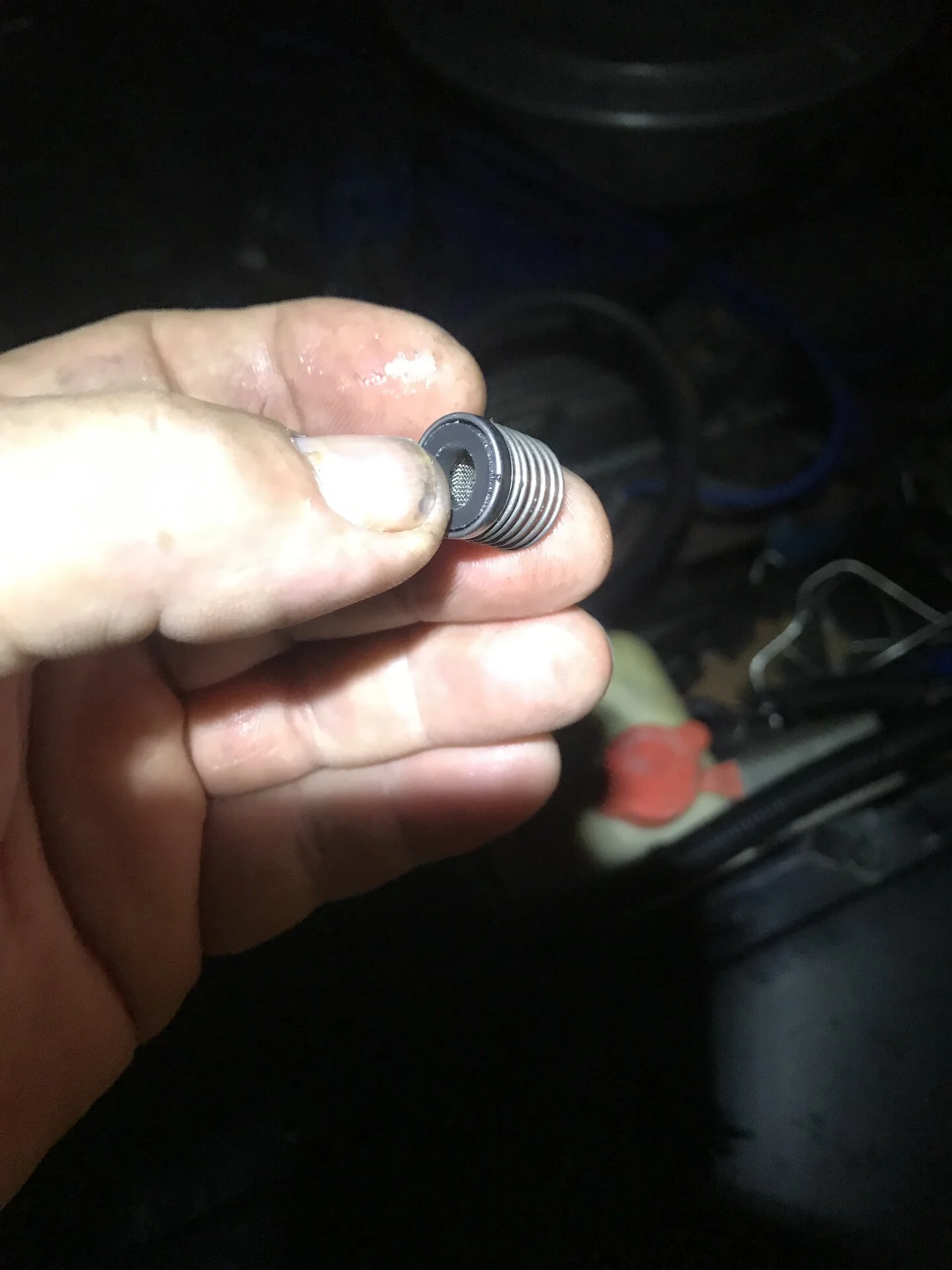

There is a bulletin to throw out that little one way valve
If worried install a power steering filter in a return line

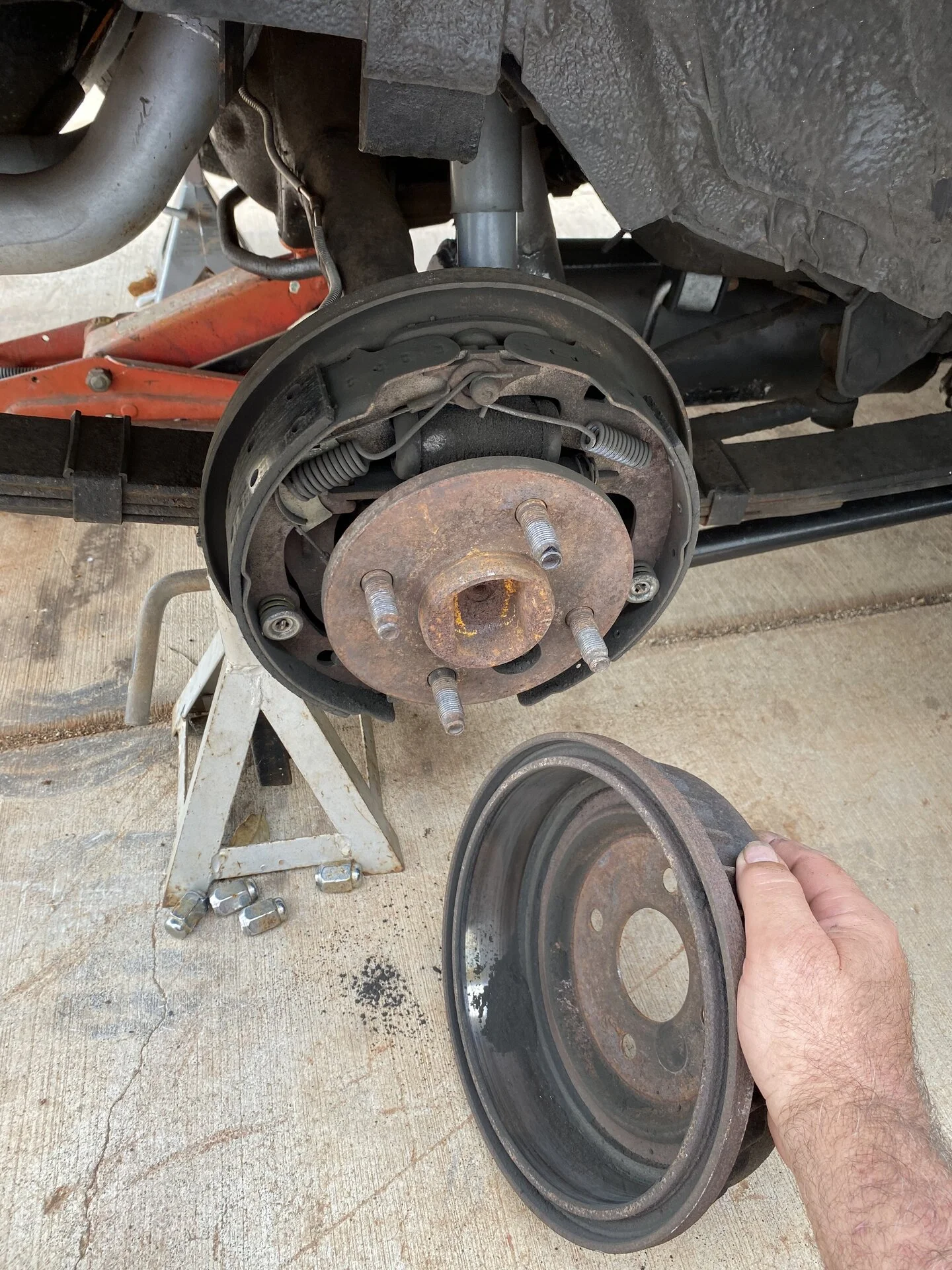

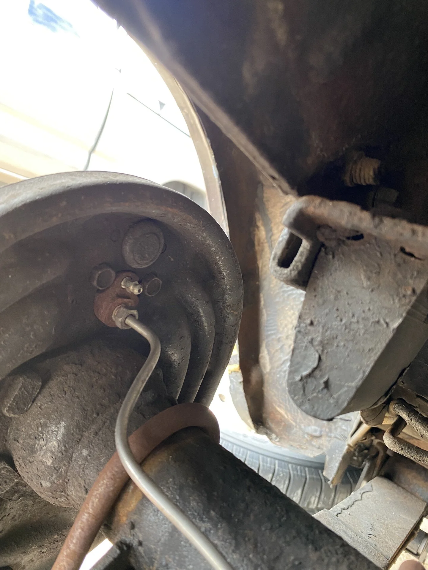

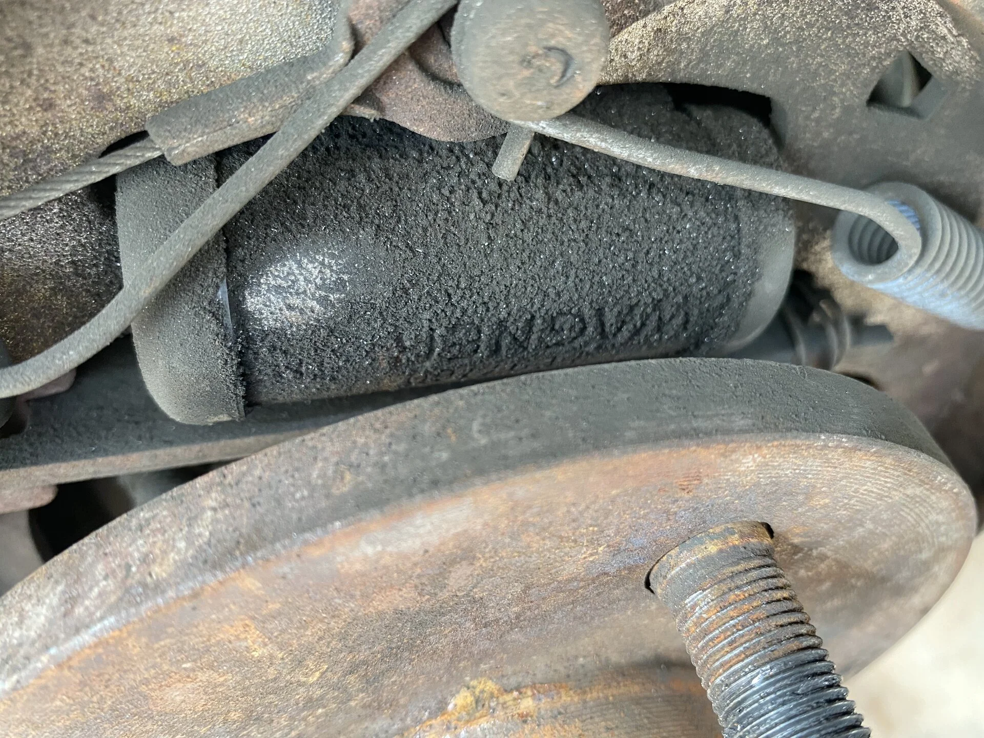

Fluid is in the brake booster
I agree with 007. If you cannot find fluid anywhere else pull the master cylinder and check behind it for fluid.
