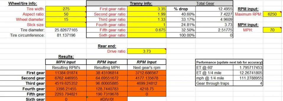

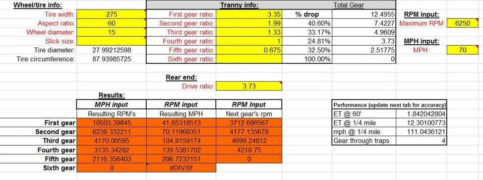

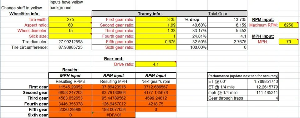

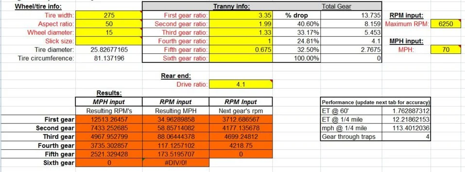

Years ago, I built an excel 1/4 mile estimator that has a gear/tire/transmission calculator integrated and I've fired it back up for you! Hope it helps. It was actually nice to use it again and refine it with some newer skills.
275/50/15 with a T5 and 3.73s
275/60/15 with a T5 and 3.73s
275/50/15 with a T5 and 4.10s
275/60/15 with a T5 and 4.10s
