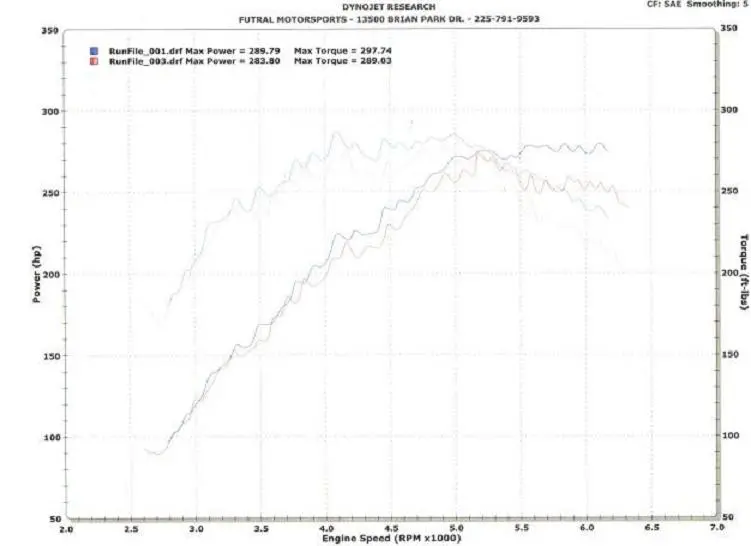

Well I guess Ill chime in.
I have NO intake mods.. not even so much as a CAI(yet). I have ported heads and stage 2 cams and full exhaust. My dyno wasnt what I was hoping for,.. but with the stock airbox I guess 290 to the wheels through 4.10's isnt that shabby. looking at my dyno there is a fuel managment problem or the PCM is pulling timing. we didnt have time to get into it and it isnt my daily driver so it wasnt a huge issue. I will send the car back to him when I leave to go to vegas for a week on april 12th and he'll spend some time finding the gremlin. that should help me get close to the 300 mark, and then I am hoping with the TB/Plenum and cold air I can get it close to 315. I am actually happy considering that with only 290 and a tuning problem I still managed a 13.0 in a vert with crappy 60' times spinning hard. the dyno is just a tool after all and the track is where the truth lies. anyway here is my dyno.. any input on the surging issue?

On a side note.. after this is finished and we get the bugs ironed out.. I will be headed towards my power adder and out of the N/A club. I am going to pull the engine back out, put in some blower cams, 28cc pistons and Kenne Bell the crap out of it :D
