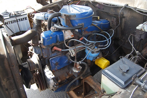

I had a '83 F250 with the 300 six cylinder in it. This was at the same time i had my 5.0. This is the only reason im replying to your post. Ive had both. Trust me when i say, each engine was in the right vehicle. Putting the 300 in a fox body, for a high performance application, is just backwards. Yes, you have more torque. From 1000 to 3000 rpm. From there on, a stock 5.0 HO shows no mercy, let alone a modified one, or a 4.6.
Ive gotten into plenty of arguments over the same basic topic on ford-trucks.com. Heres some actual scientific data i used to prove my opinion.
I used the rear wheel dyno pull off of one of the guys on ford-trucks.com with a later-model fuelie 300 versus my own 5.0s dyno graph. I then compensated (20% for his auto, 15% for my T5) the difference in driveline loss to get an estimated flywheel output. The outcome is that 2800 rpm is the magic number. Below that, the 300 is above. good for towing, not sports cars. Above 2800, the 302 just walks away. And thats a stock 5.0 fox with full exhaust. This same car is neck and neck with my brother 2000 mustang GT from any speed. It dynoed 207 rwhp and 276 rwtq.
Stick with the 5.0.
Also, I dont believe the 300 is lighter than a 5.0. Its a big motor, and its all iron. The intake is iron (a 5.0 is aluminum). Its old school.
Espeically when you consider the aluminum heads, blocks, etc that you can get for a 5.0, its no contest in terms of weight.
Also, consider that the 300 has almost no aftermarket support whatsoever, compared to the 5.0.
Lets also not forget that the fox was actually designed to carry a V8, not that big ol I6.
Dont get me wrong, my 300 was great for its purpose. But itll never be a high performance motor. As you can see from my linked pictures, the 300 only out-torqued my 5.0 by 15 ft-lb. My 5.0 out-powered that 300 by SIXTY-FIVE hp...This is the result of having two more intake and two more exhaust valves. More air in = more power.
