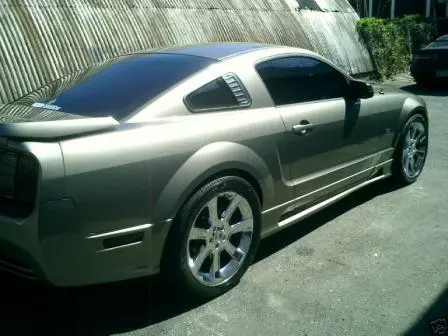

Is anyone running 315's on the rear? I saw this Saleen on eBay with 20x10 rear wheels and 315/35R20 rubber. I was wondering if they are too big and would have rubbing issues. I haven't received a response yet from the seller on eBay, but I doubt he will tell me if they rubbed anyways.
Here's a pic.

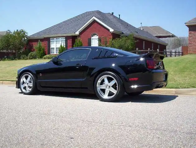

They will fit and they will not rub. You can even drop the car 1.25" and they will not rub. You can use the Steeda sport springs to accomplish that drop and run a small spring cushion under the spring (1/4" thick). That will put it right at a 1.25" drop and they will not rub. You can EVEN run a 10.5" wheel and the 315/35/20 with that drop and stock shocks and it will not rub. If you put the eibach drop on it yoou better be ready to run some adjustable shocks out back to stiffen it up and be ready for a crappy ride.......

Actually the stock tire is 27.2" and a 315/35/20 is 28.7...exactly 1.5" taller 3/4" on the ground and 3/4" in the wheel well.....
What tire size are you calling stock? On the Saleen in the picture and the Saleen I have, with the wheel and tire upgrade, the rear tire size is 275/40R20. Using the web site you provided the two tires, 275/40R20 and 315/35R20, are both 28.7". So there would be no need for a recalibration. My only worry was if the tire would rub because of the width.
But I guess you answered my question if you are running them with no rubbing. Nice car by the way!
