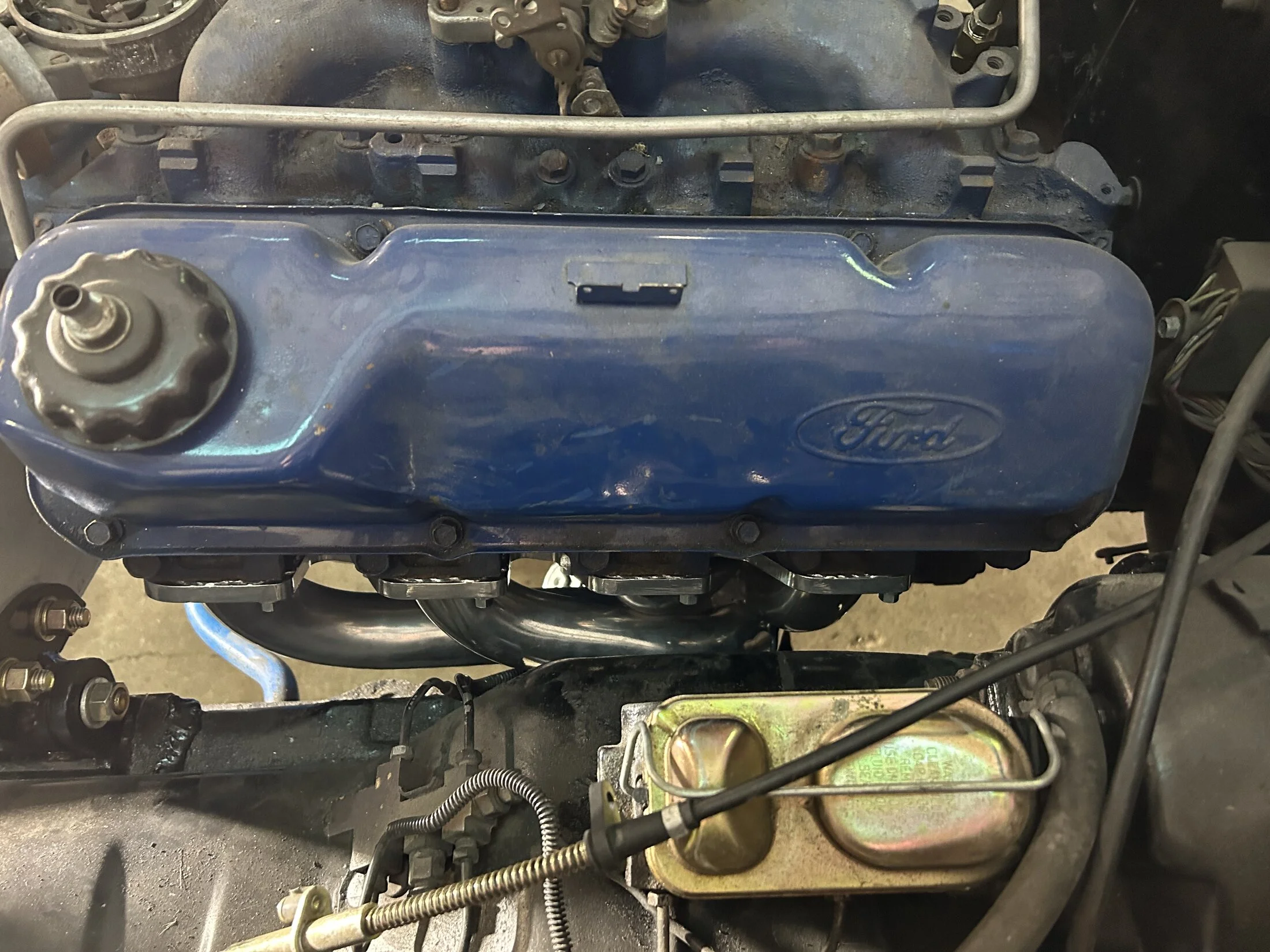

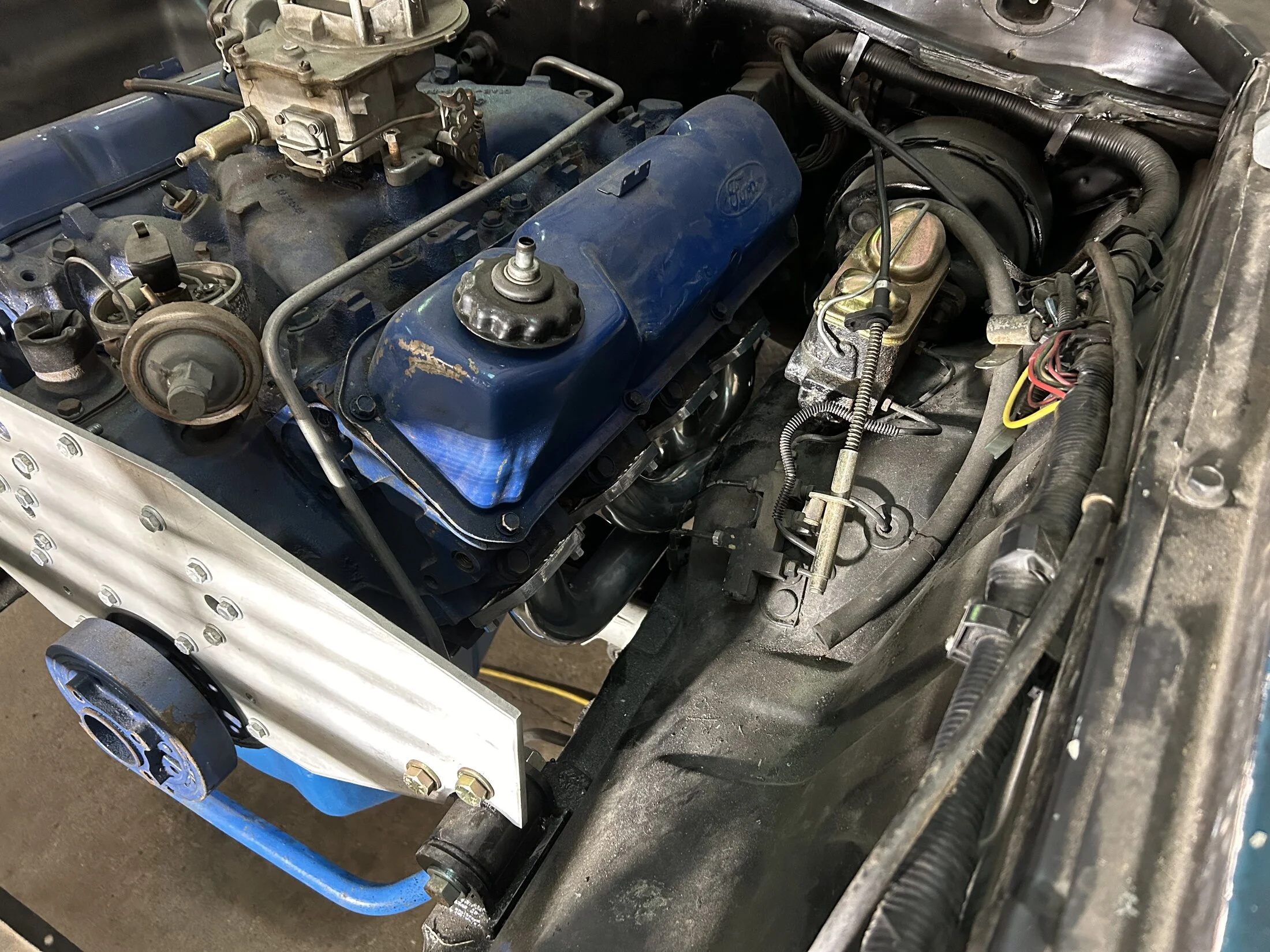

Finally got my headers. They are Sanderson FC4 ceramic coated. These things fought me every step of the way. If anyone is reading this thread for information to do this swap. These are not the headers to use. I had to modify a lot of things. Including sectioning part of the passenger side frame rail. But they are in.

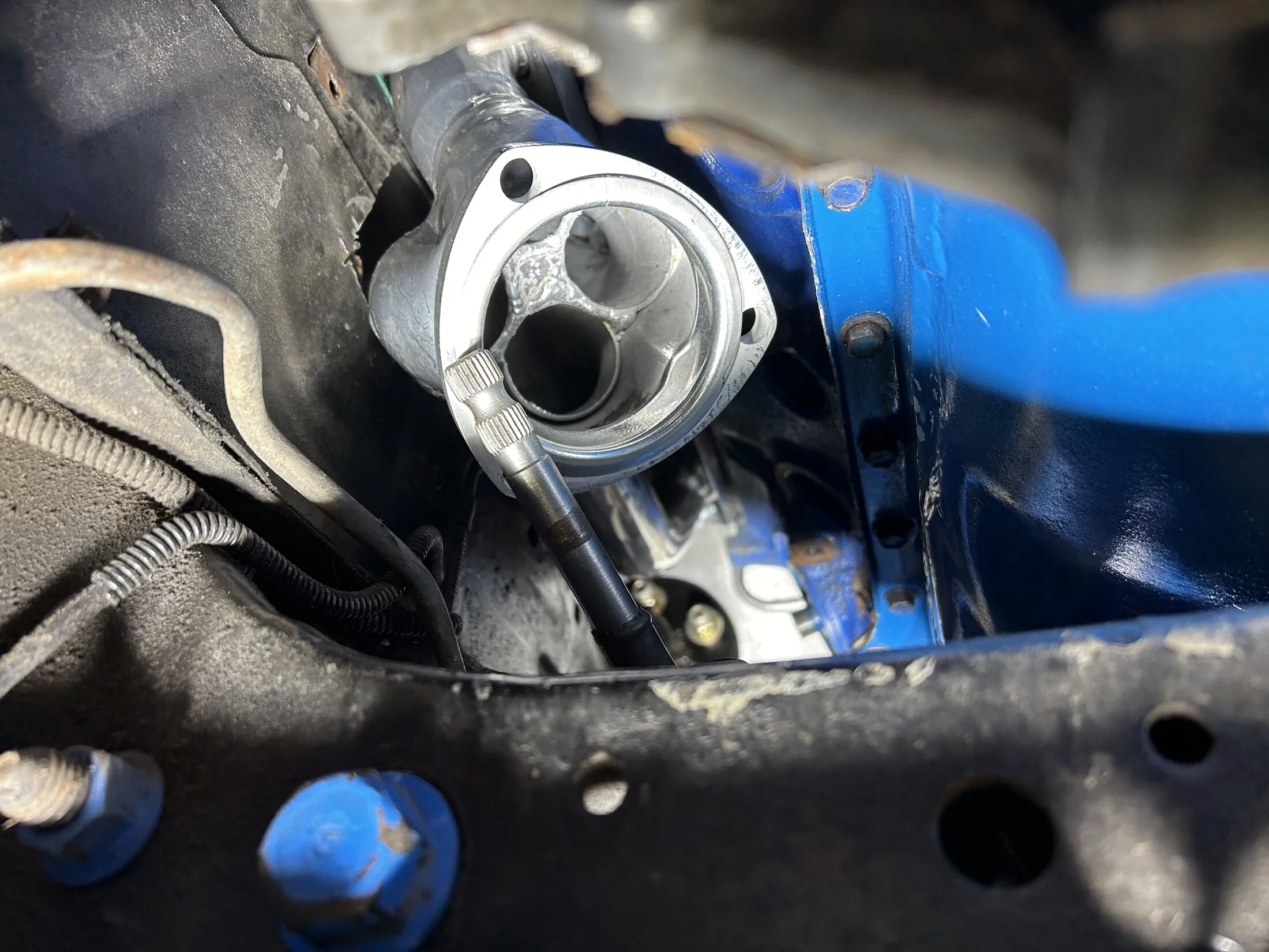

But I do still have one hurdle to overcome.
The steering shaft interferes with the drivers side. I am trying to come up with a solution.
As you can see in the below photo. I have about an inch of interference. I hope someone on here may have a suggestion.
78 Mach1
Advanced Member
Feb 17, 2022
287
408
73
German Valley, Illinois
Mar 27, 2024
#252
  • Mar 27, 2024
  • #252
If I can rotate the steering rack towards the firewall. This changes the shaft angle just enough to clear the header. I tested this theory and works perfectly. I’m just not sure of the practicality of this option in actual practice.
Another option would be if there is a steering rack that has the shaft in a slightly different location. One inch farther towards the drivers side would do it. Or if there is a rack that the shaft comes out at a different angle. Slightly more down or slightly more towards drivers side would clear.
The irony to this is, me moving the engine 1 1/4” towards the drivers side to center it, created this problem. So here we are. Things are snowballing quickly.

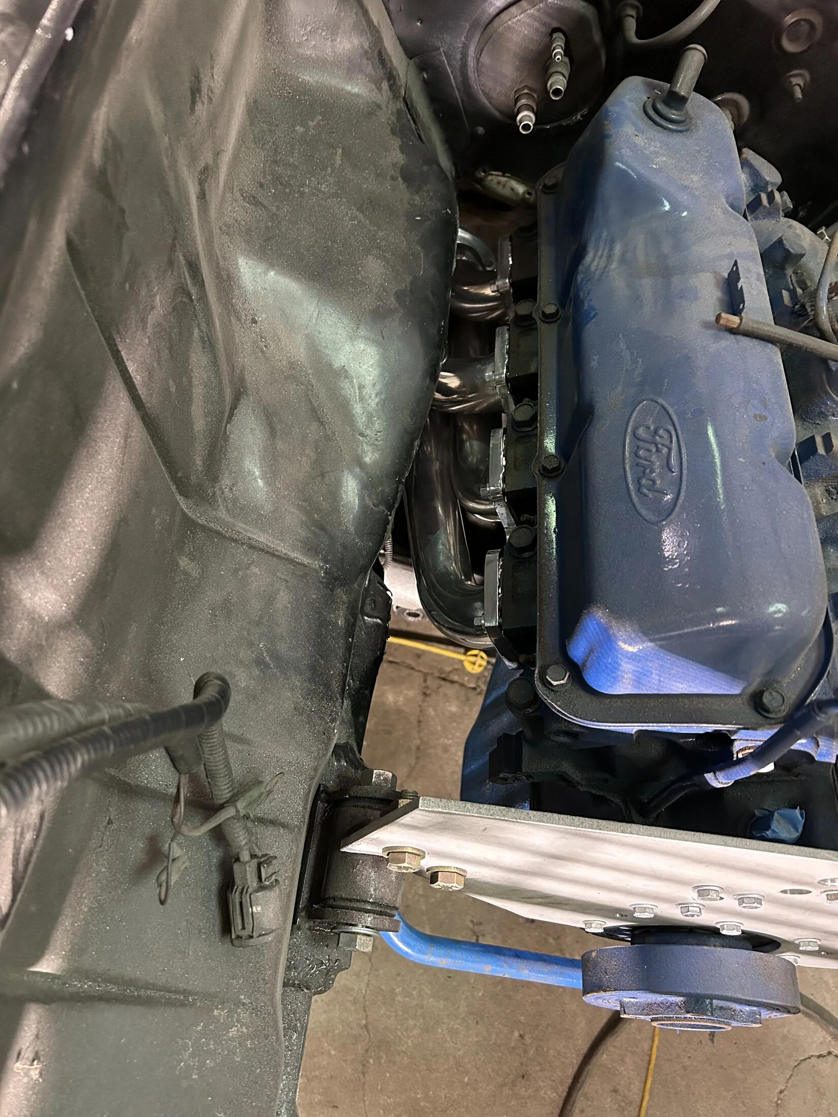

Also, I forgot to mention, after sectioning the passenger side frame rail, the factory upper A arm is ridiculously close to the header. I’m concerned this will be too restrictive to front end alignments. After doing some research I have come to the conclusion tubular upper A arms will solve this issue. I’ve got them on order.
Exhaust is a big problem on this cars... even with a 302 over axle pipes in 2.5 inch are barley possible.
Anyway, here some thoughts:
I installed a fox steering rack (https://www.rockauto.com/en/moreinfo.php?pk=30774&cc=1140297&jsn=10552) and it looks to me, that the steering shaft is much shorter than yours. I also used a borgeson u-joint with a double DD end and a splined end that fits the fox steering rack. I than cut and grind the OEM steering shaft down to the double DD. The Fox steering rack is much lighter (alu housing) and has a quick ratio, which feels great with a low pressure pump (around 70-75 bar). I will post some pictures if i find them in short time in my build thread.
Beside that: could you move the engine back this 1 1/4'' regarding passenger side exhaust clearance?!

Looking at the picture, i think the steering input shaft ends at the same location as yours. You have a manual steering rack? than there is less steering rack housing around the steering input shaft... You could shorten the steering input shaft and weld an universal u-joint on?!
I hope you find a quick way to solve that issue.

Offset rack and pinion bushing?
https://www.speedwaymotors.com/T-Bird-Offset-Rack-Pinion-Mount-Bushings,51390.html

Yes. I’ve been looking at the offset bushing options. I think I can do a combination of several things that will yield the clearance I need. I’m considering raising the engine 1/2”. I’m also considering moving the engine 1/2” forward. Doing both of these options would give me roughly an inch of clearance between the header and shaft. Then I plan to rotate the steering rack towards the firewall. This by itself will yield the most clearance. But I am limited by how much I can rotate it. I want to rotate it the least amount necessary to prevent any extreme angles on my u joints on the steering shaft.
I already installed a second I joint when I converted from power steering to manual steering. With the second u joint in place, this should give me some options to rotate the rack and still stay within the operating angles of my steering shaft. My thought is to use offset bushings to create this angle. By clocking the front and rear offset bushing 180 degrees from each other (front down, back up) then drilling the middle out to create a smooth consistent hole, this would rotate the rack slightly back causing the rack steering shaft to move at a more downward angle. This would create the most clearance. But I obviously am limited by how much I can rotate it to not put the shaft at too extreme of an angle. I just haven’t found anywhere online where anyone else has done this. So I’m questioning if there is a reason no one has done it. Will it cause any steering issues.

I considered just moving the hole rack 1” towards the drivers side, but this would move my tie rod pivot points 1” out of sync with the control arms pivot points and potentially cause bump steer issues. I could move the rack housing and not the pivot points, by adjusting the alignment, but this would give me less cornering ability in one direction versus the other. Not ideal. So moving the hole things as a unit would be best except for changing the pivot locations. If there was away to to extend the internal shaft that one inch on passenger side and shorten 1” on drivers side, that would correct the tie rod pivot points. I’m just not sure if this is possible.
They make rack extenders that would probably get you there.
HEXRACKEX1 Helix 1 Mustang II Steering Rack Inner Tie Rod Extension - Each 12 | johnnylawmotors.com
PMID-1237123: Helix 1" rear steering rack/inner tie rod extension for power or manual steering rack & pinion unit. One extender used inside each inner tie rod t
