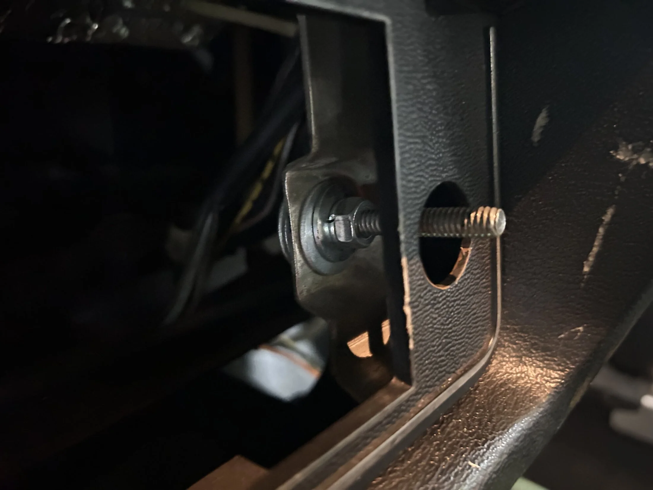

I didn’t want to drill any holes in my factory dash. So I decided to build an adapter plate and use the existing radio location for my toggle switches. I won’t be listening to music in this car anyway. The sound of the Cleveland will be music to my ears. To keep the dash completely in tact, I used two bolts as adjustable studs in the radio mounting holes.
Then fabricated a plate for the switches that bolts to those studs.
This keeps my dash completely in tact if I ever decide to put a radio back in or delete the toggle switches.

I think a pair of cap nuts would give it a more finished look, otherwise I like it!

I totally understand, I have tried not to drill any holes in the engine compartment as well. Good idea with the switch panel and if you wanted to make it less apparent, it could be painted black.
Yep. I’m looking for a nice set.
I was on the fence with that. I think the natural aluminum does match the existing fake aluminum panels. But I may paint it in the future.

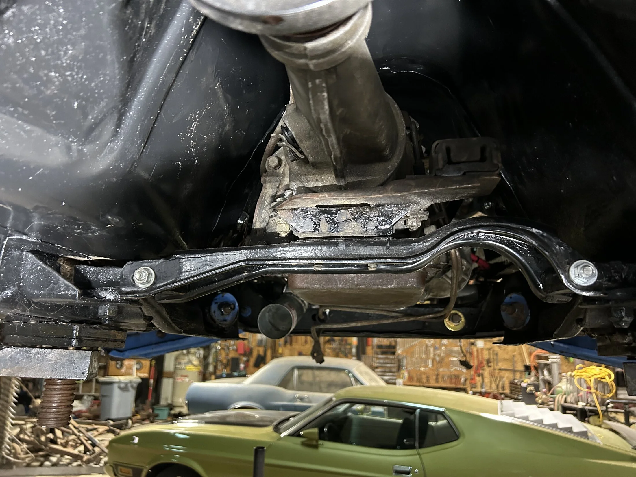

Got my front frame support bars in place. With these, I’ll have zero issues with the notched frame.

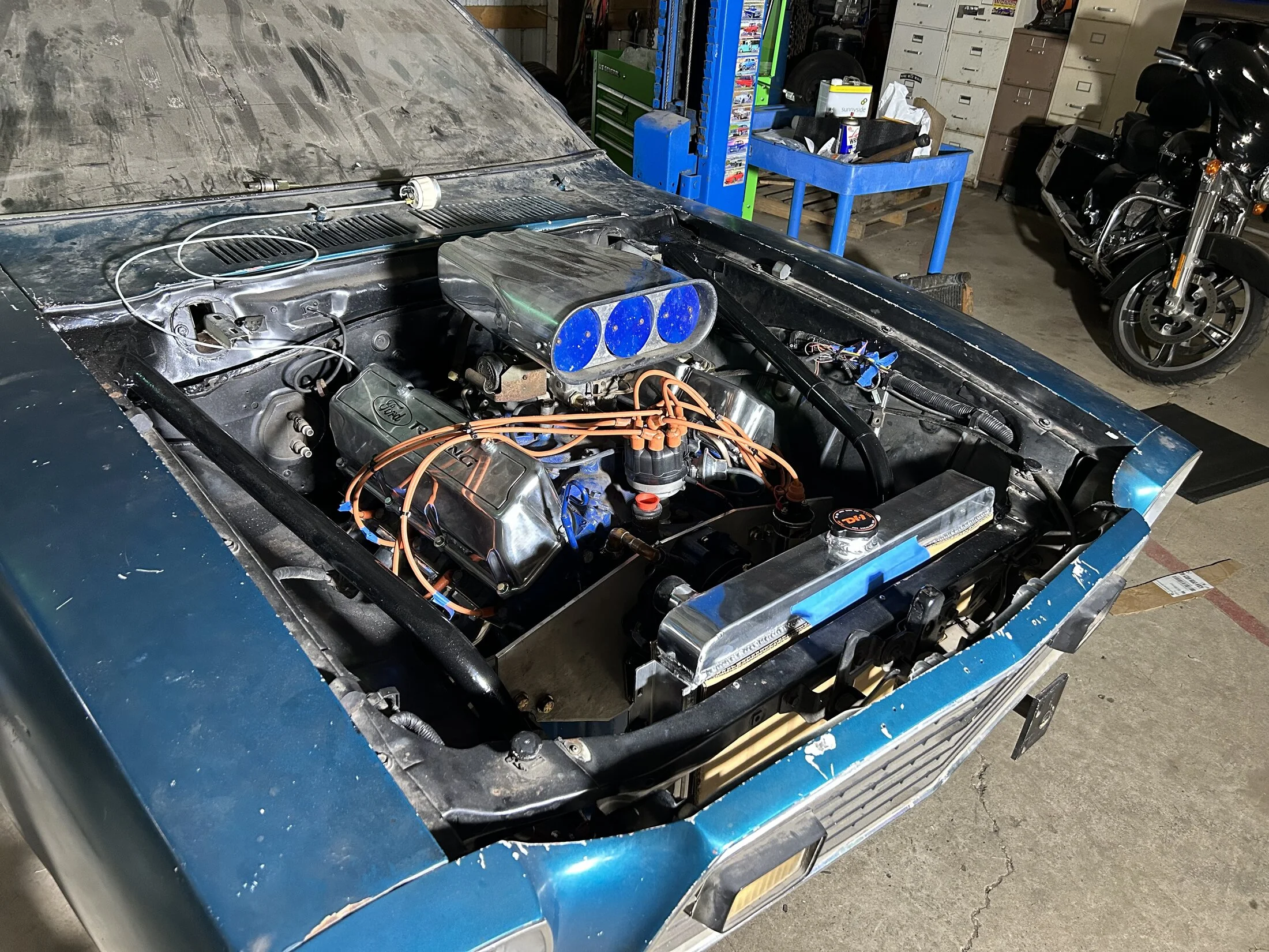

got the support bars painted and starting to get the motor buttoned up with all the peripherals. My goal is to start this motor this weekend.

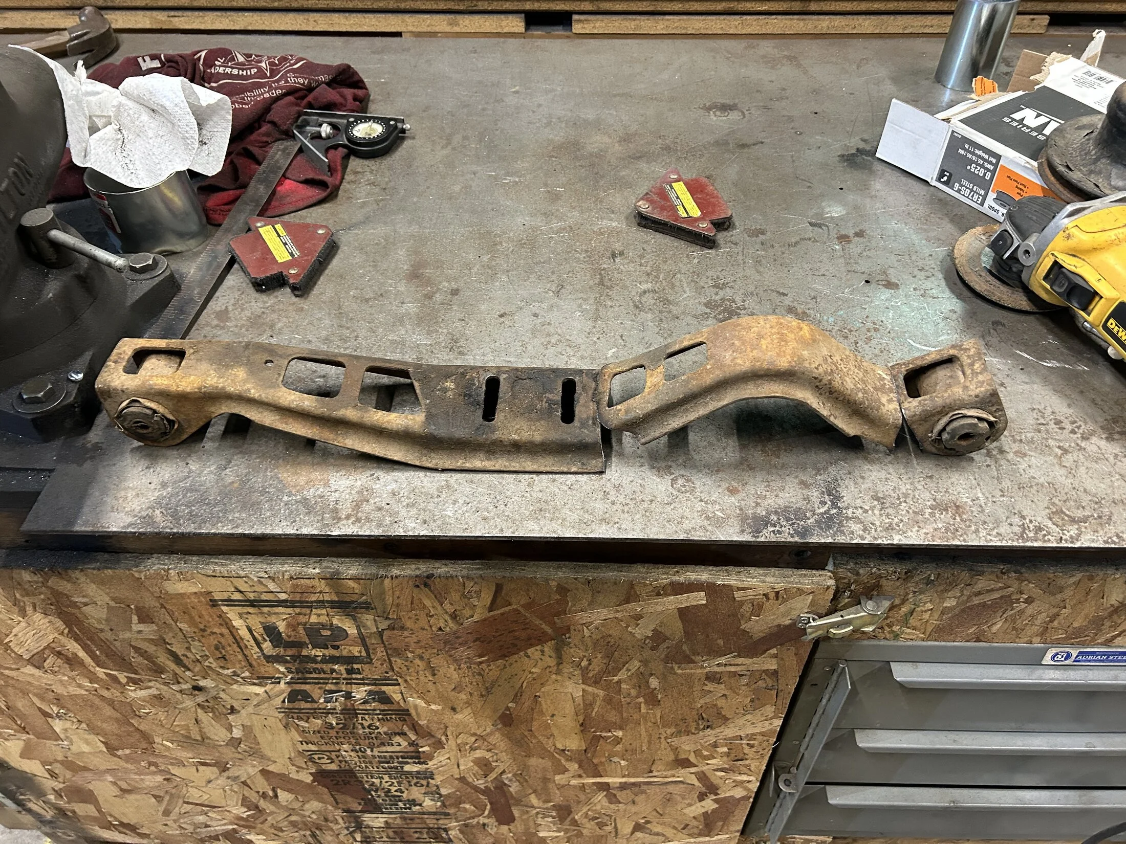

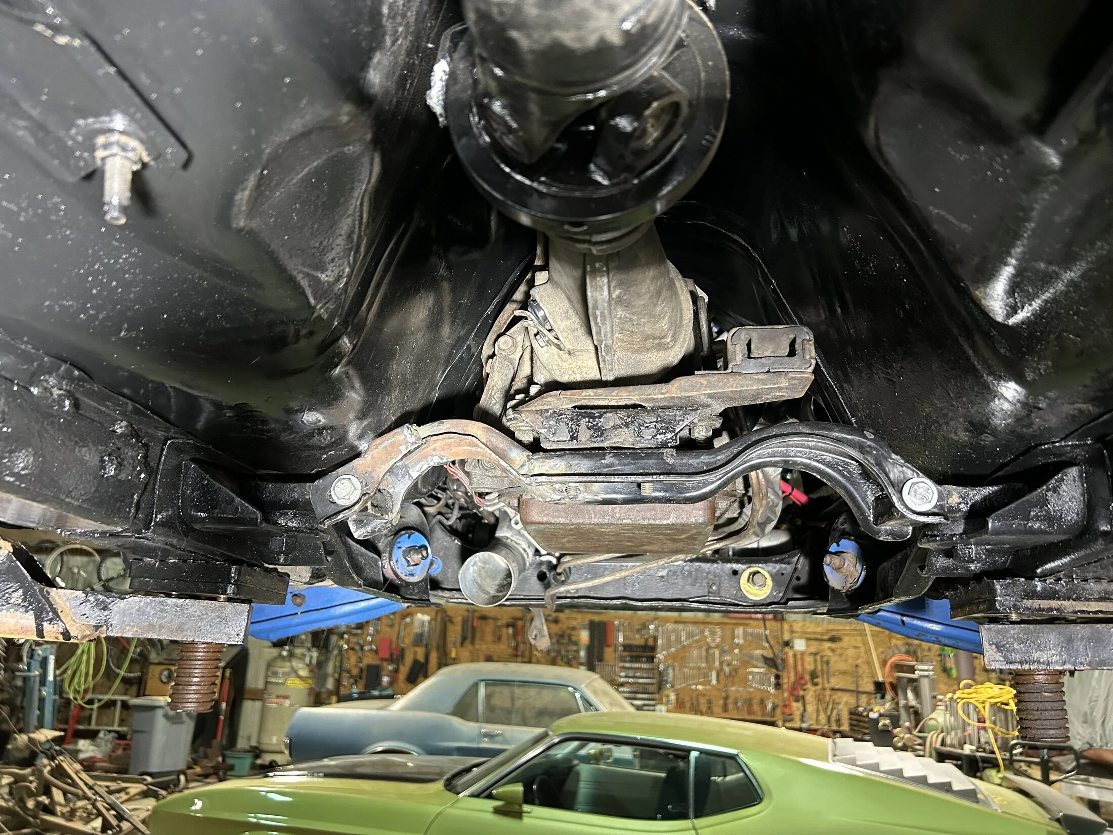

Time to run exhaust. But I need a double hump tranny mount. Couldn’t find one anywhere in my area, so I’m going to make one. Guess I should have done that when I was modifying it previously.
Here it is mostly factory.
I found an old cross member in my parts.

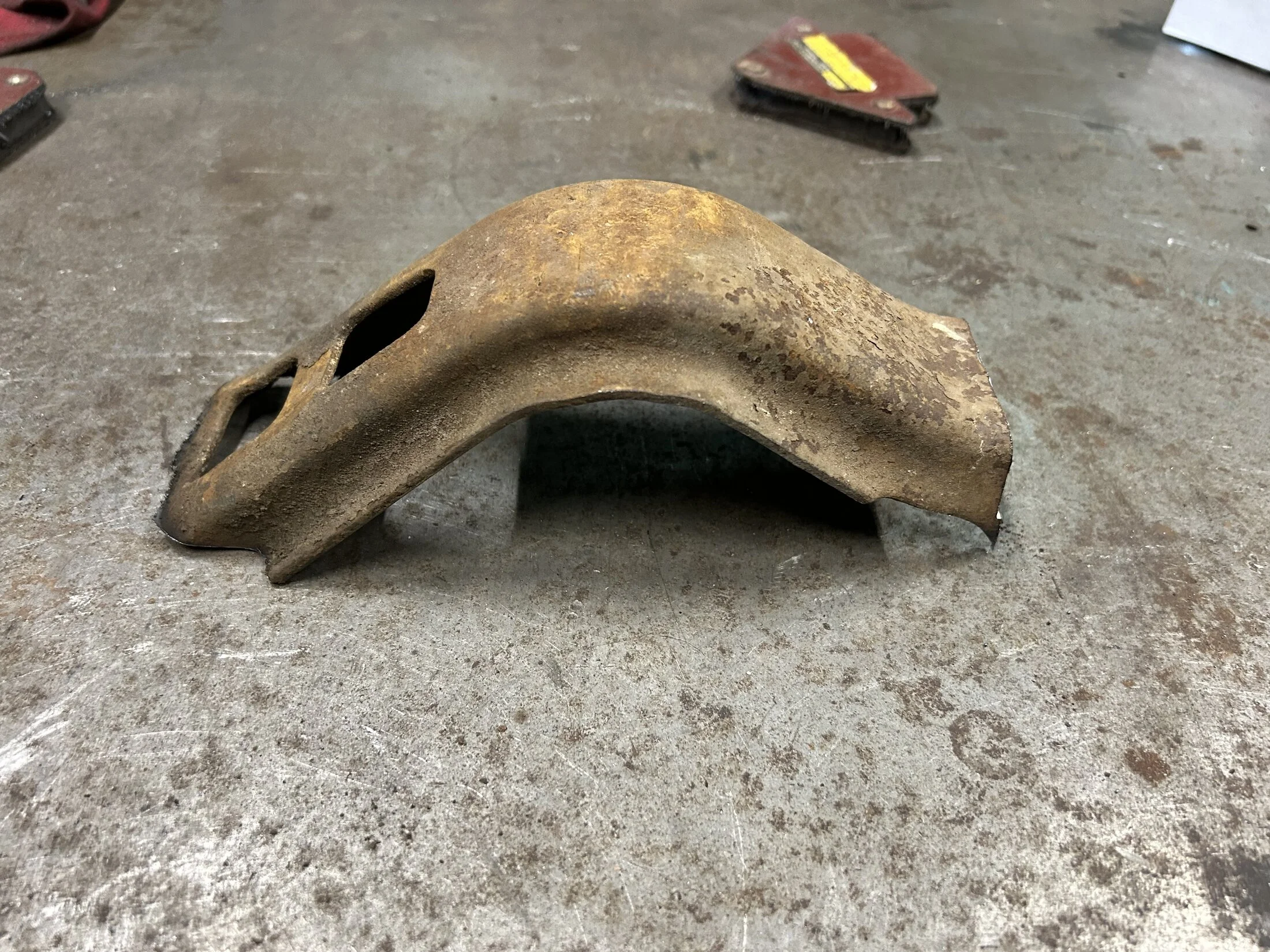

Cut out the section I needed.
Then graphed it in to me existing support.
I’ll paint it later. Today the exhaust is going in.
Love the copper pipe coming out of the water pump. Whatever works, right?

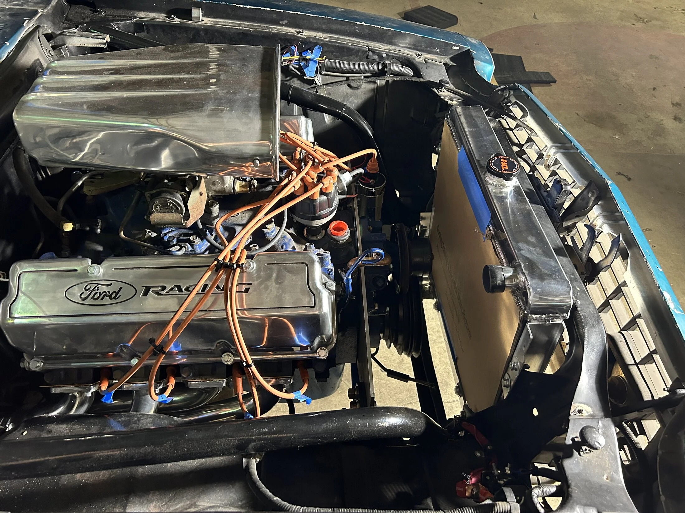

Radiator finally arrived today. Got it installed. Still need Rad hoses, tranny cooler lines, and mini alternator installed. The plan is to do those tomorrow and hopefully fire the motor.
Yep. I tried to bypass heater hoses using just rubber hose. It kept kinking. Or else I had to have it so long it looked awful. The copper was the best thing I had laying around. At first I thought it would look horrible, but I needed something to get me that much closer to starting the motor. But honestly it’s growing on me.
But yes, whatever works at this point. I’ve been waiting way too many years to drive this car down the road. So at this point, I refuse to let anything slow me down or hold me up.

Well. After a 10 hour thrash to install all new tranny cooler lines, alternator, troubleshoot a clogged fuel line, and running to O’Reilly to dig through every radiator hose they had to find something that would work, the time finally came.
I know you are going to be disappointed, but I have tried many times to upload the video. I had to cut it down to 20 seconds because I kept getting a, file is too large prompt. Then once I shortened it enough, it keeps saying I do not have an allowed extension. I assume this is because I am using an iPhone to try and upload it. If anyone can help me upload the video, I would love to share it.
