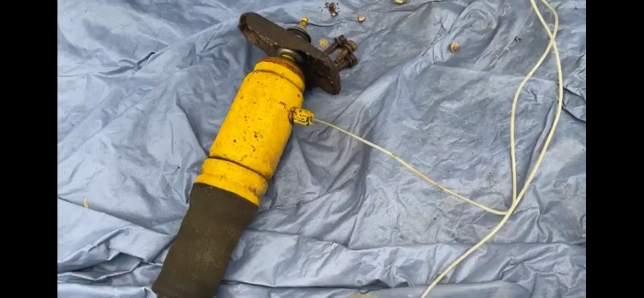

I need a set of upper rear shock mounts for a Mustang II? Anyone know where I can get a set? I somehow misplaced mine over the years. Or accidentally threw them away with the old shocks. Who knows. I found a set locally for $100. But that seemed high for such a small piece. I was hoping someone made some aftermarket. But I can’t find any. So my next option is to find someone that has a set on a parts car they wouldn’t mind letting go.

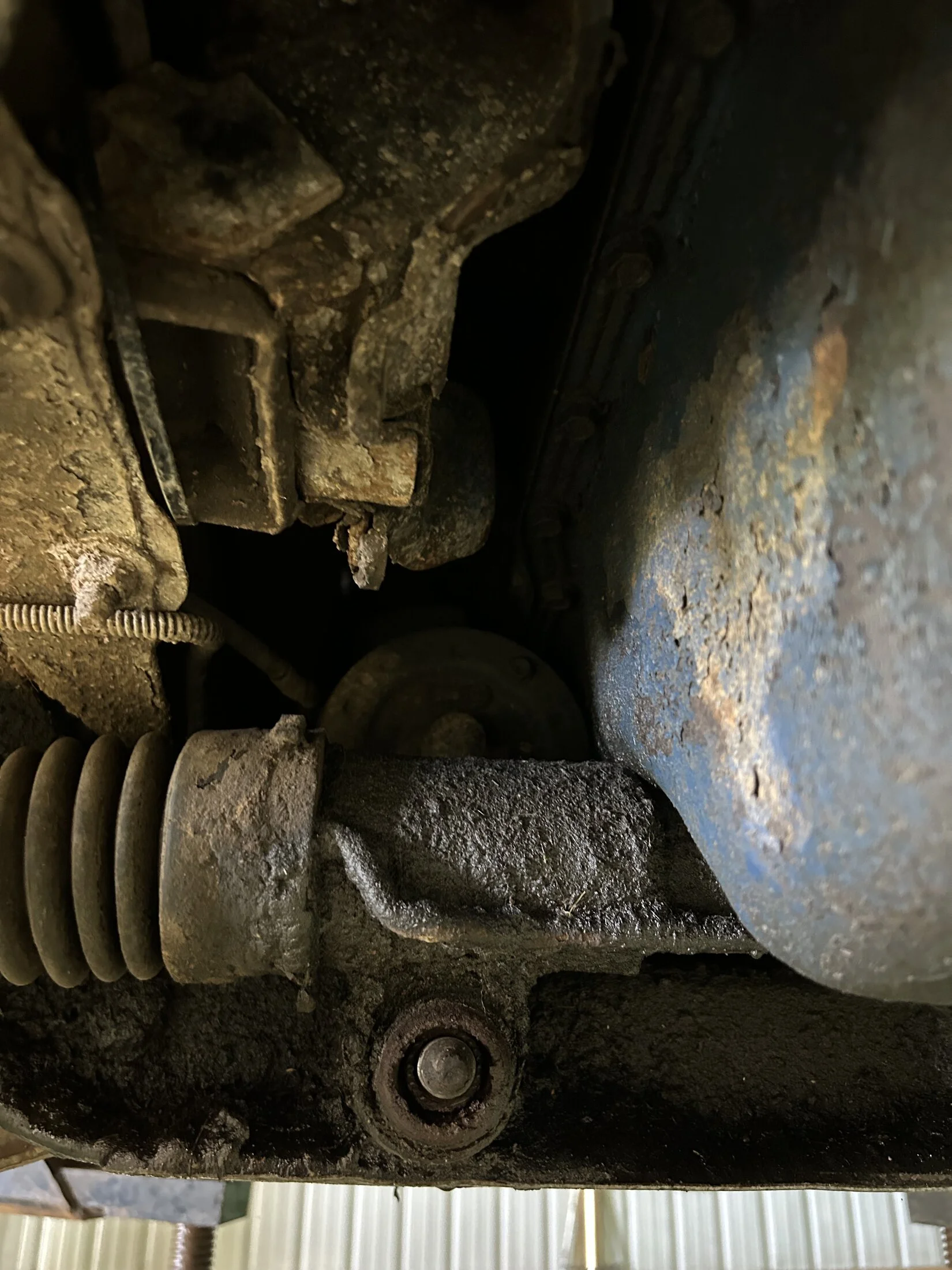

Totally off topic. But I have to give my 1976 Cobra II some love. The starter is having issues. It’s a 302 4 speed car.
I put this motor in this car, but I obviously installed the motor with the starter in place. Does anyone have any secrets to getting this starter out without raising the motor? I’m considering dropping the steering rack.
Well yes, yes I do.... ;)
It's in the tech sticky at the top of the II home page. It's really not all that bad once you get into it.
I ended buying a full set top and bottom mounting plates for the rear shocks. They also came with a good set of shocks. That worked out perfectly. I’ve been focusing the past several days dialing in the carburetor. I had a hesitation when accelerating. I put a different accelerator pump cam on both ends and that fixed the issue. I went with the orange cam which gave me a more aggressive profile to get more fuel faster. The car runs really good now. But I do believe I need to jet it up still. No real evidence other than seat of pants feel. It’s a Proform 650 street series carburetor. Currently has 73 jest in front and 74 jets in rear. I believe that is a little small for this large plenum tunnel ram. So I’ll be testing some larger ones when I get my jet kit in. What I couldn’t find anywhere is if these jets that are currently in there are the correct size for this carburetor. I’m trying to figure what it came with from the OEM. I got this carb used. So anything is possible. My belief is someone had it in a very mild small block. Because the accelerator pump cam was very small. And I believe these jets are pretty small comparatively. Does anyone have any information on what jets this carb originally would have had? Also does anyone have any experience with a good starting point in jet size for a 351 Cleveland with a large intake plenum? I know jet sizing is a trial and error thing. But I’d like a good starting point if possible.

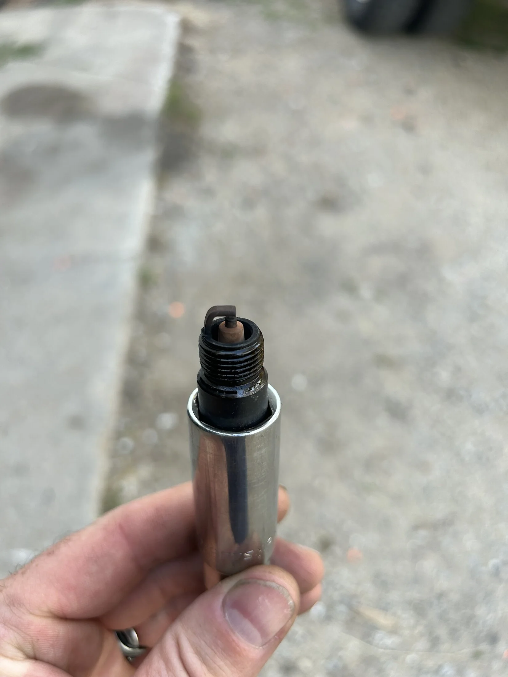

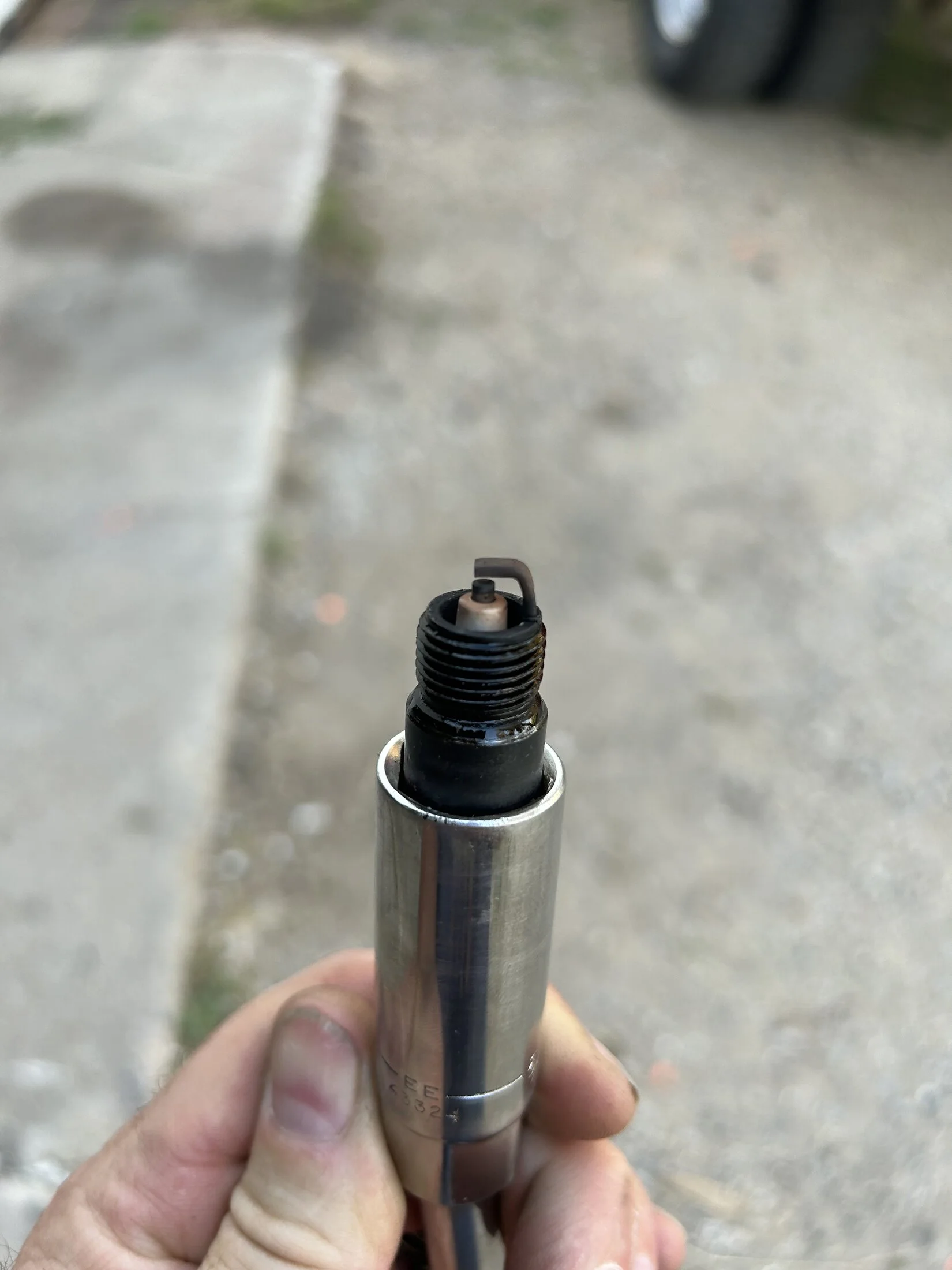

I agree. 86/93 seems really big. I currently have 73/74. I thought I was experiencing a lean issue. But the plugs show something different. They look slightly rich to me. Well, one side at least.
This is the same plug just spun 180. One side looks rich and the other looks lean. Not sure what that’s about.
