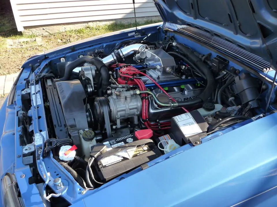

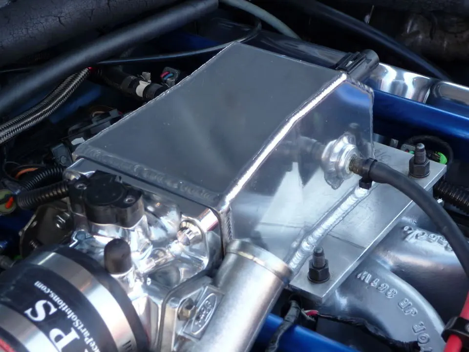

Hey guys, finally got the 351 (393) with the spider intake under the stock hood. VRISTANG. here is what it took. i got the stock 93 convertable ford motor mounts and had a upper intake fabricated 400.00. i know the price is close to getting a new hood but after looking into it it really is cheaper staying with the stock hood. the paint guy wanted 200.00 and could not gaurantee a proper match of the paint color so i figured 400.00 is better than 700.00 and i really like the stock look (sleeper). the fabricated upper probably does not flow as well as the elbow that came with the coast high spider kit but i cant tell the difference. i think the fabricated piece looks better anyway. and that xe274 cam really does pull. wow. just ask the c6 vette i smoked just outside my local 7-11. anyways the little things i had to get the 351 in the engine bay were trim the battery tray.and cut the original throttle cable bracket. all pretty easy stuff.

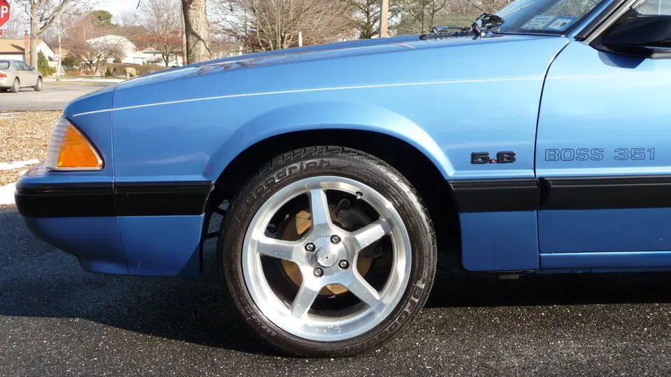

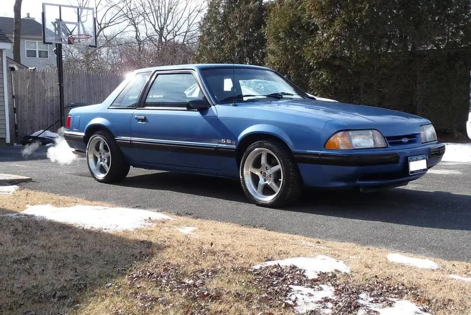

Hey guys i know this is an old thread but after 2 years i now know how to post pics. LOL. Here are some pics of the 351 under the stock hood...
