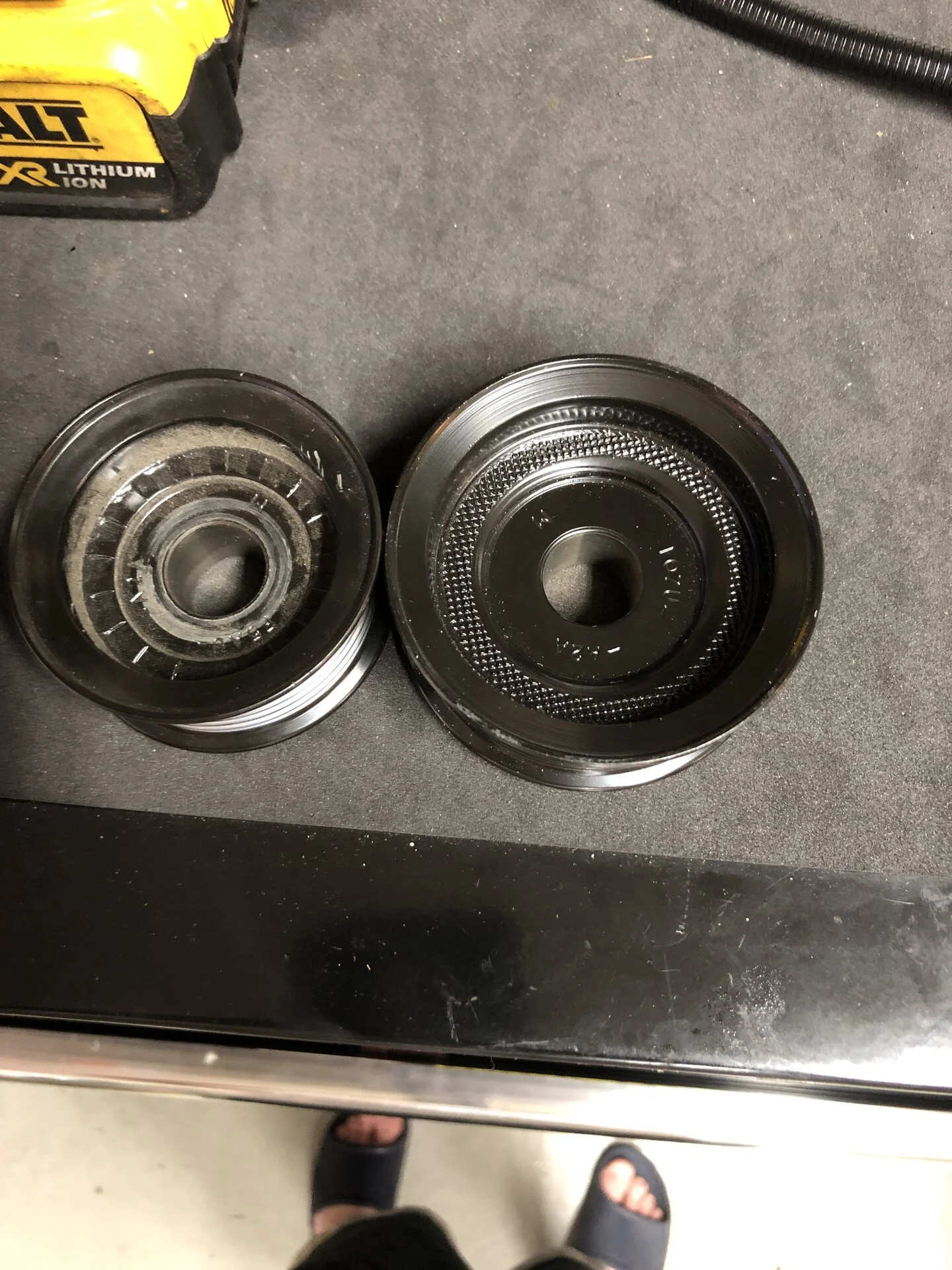

I’m not looking to go smaller . I need it to be larger . With a 6 inch crank pulley even at 2.5 it’s still spinning faster then I’d like .
I posted the calculations . For what it’s worth it’s 2.5 inches at th top of my calipers on a 3g pulley for a 96-98 v6 car . P/n - GP685
A 94-95 gt is 2 1/8 (2.13 on the calipers ) p/n -gp712
A lot of mis info out there on the size of these pulleys .What I’m giving you I have physically checked and measured myself . I even burned one up at 20k rpm the first time tried the 6 inch crank pulley I had made ( 8 inch blower ) . Which is what led me to look into what happened realizing I never accounted for the smaller alt pulley at the time .
At that time I had switchwd from a 4.75 crank drive pulley ( 6.87 blower ) to the custom asp I had made . Now I’m going back to the 6.0acc pulley to speed the water pump up but I need to take the alternator into account.
Here is the picture . These are both motorcraft pulleys

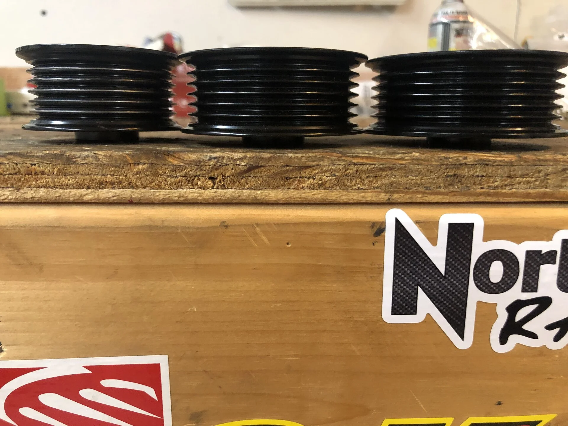

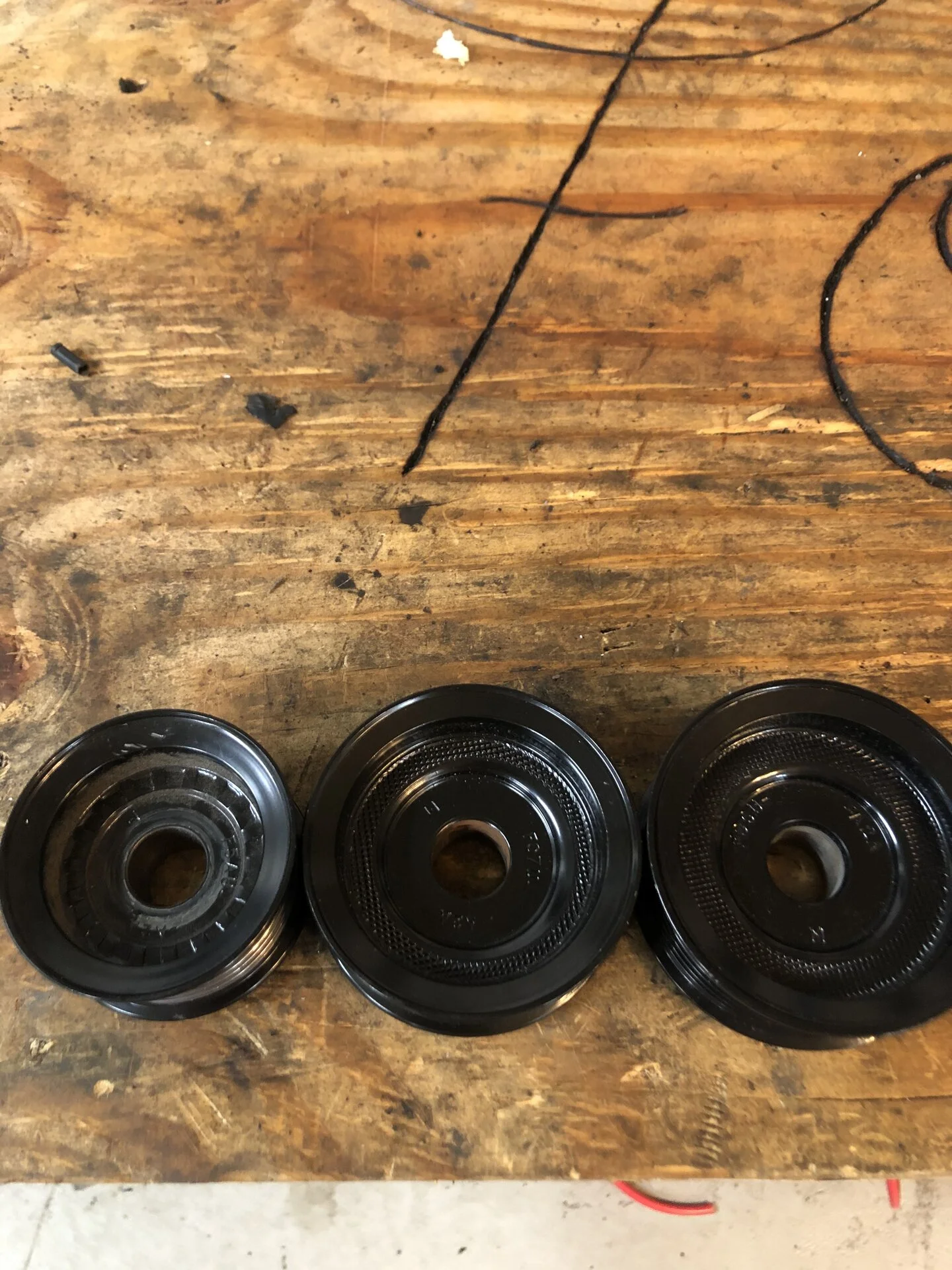

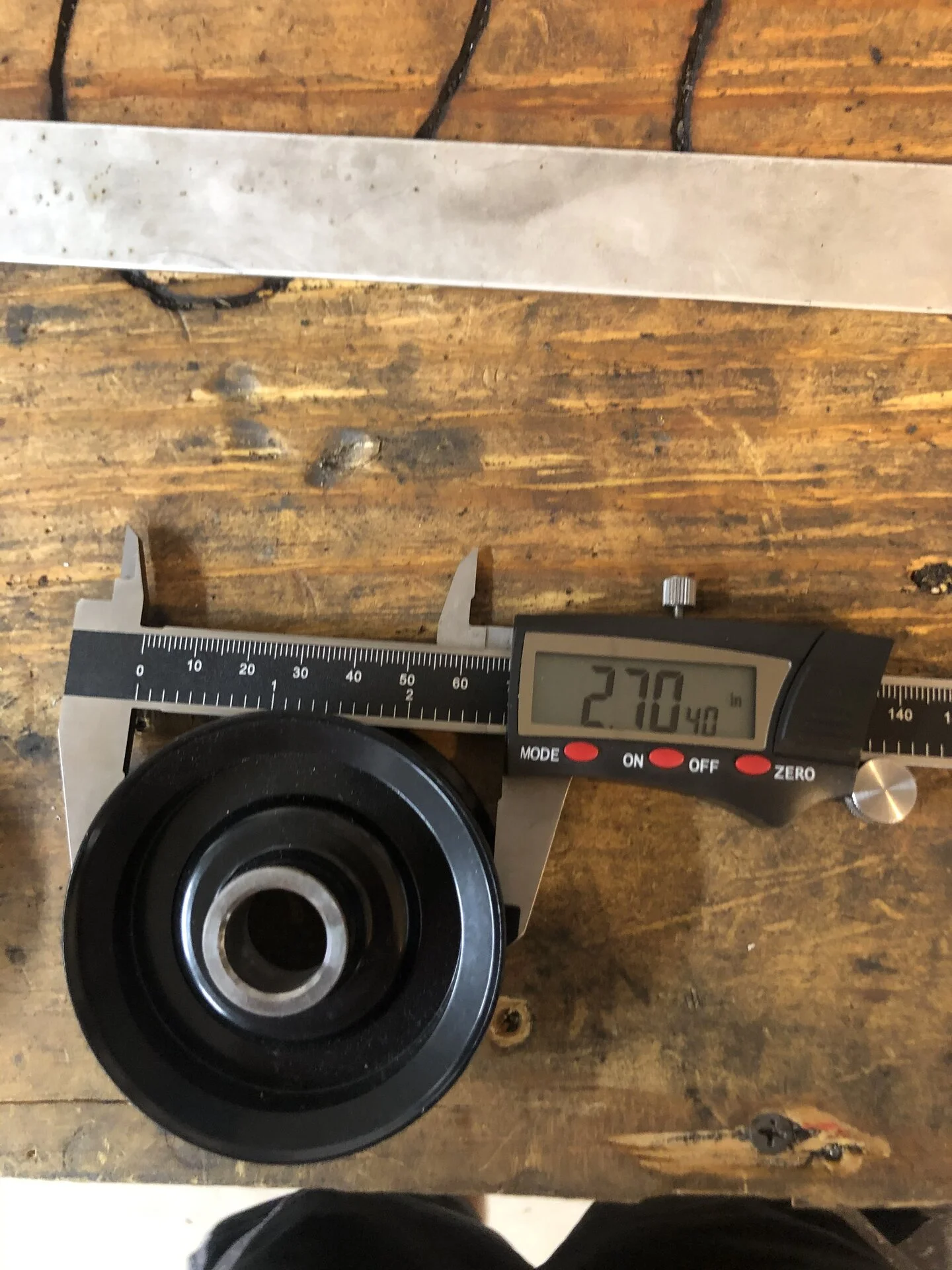

Looks like it may work . We’ll see . It’s no longer made . The part number is FOCZ-10344-C or GP-683 on the pulley itself
I got one coming from eBay for 35$.

I just tried ordering the contour one Off eBay
to see what happens , it’s worth checking yours to make sure it isn’t over spinning at your shift point .
