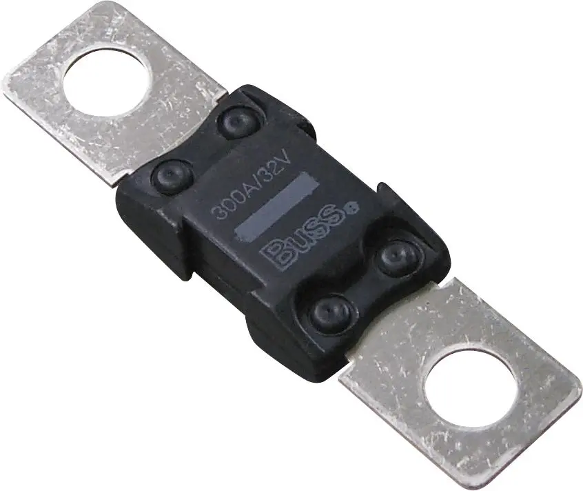

Also I have a 150 AMP wafer style fuse (see photo link mine is 150 AMP) for the alt, do you think this is too high. I have the 4 gauge power and ground wires with everything soldered and heat shinked. I did not connect the stock power wires at all. I will get some pics attached to this to let everyone see as well. Thanks in advance.

Ok so today I got everything buttoned up. Car running I am showing 14.6 volts at battery and at alternator with the stock 3G pulley. So with this information it appears as though I have plenty of voltage at idle. I think the only thing I do not have a definte answer on yet is if the 150 AMP fuse is too large. Should I step down. Thanks. BTW my SSP already has a 4 gauge ground cable from the block to the area near the solenoid, plus countless other grounding straps so I assume that I am good in the grounding.
