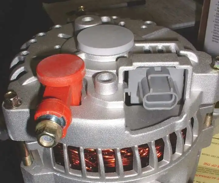

Fuel Injection Technical Library » Alternator Files
