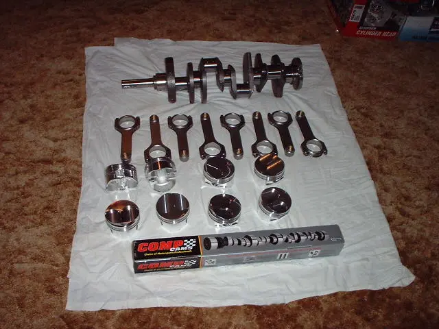

Tim: I feel your pain. I have a 390 block thats .030 now and will not bore to .060 . The shop said .040 is pushing acouple cylinders. So I ordered a Scat stroker kit to go in it at .040 . I feel like its throwing good money after bad. But if it blows it blows...lol...I also went with a solid lifter cam to keep the rpm's down. It was a roller to start with. I'm not sure how much stress is going to be on the lower end of the block? But that is what worries me more than anything else at this point. I thought about doing the 4 bolt mains. But the price of those and the machine shop work to make them fit, sonic check and bore is 2/3 of what a new 4 bolt block cost. So if it lasts maybe next year I can swap blocks out. Here's a photo of the stroker kit.
Bud

Damn that's pretty!! That's what my 308 wants to be when it grows up! :hail2: Plus a little sqeeze :p

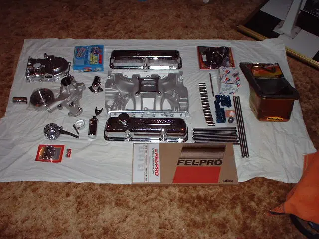

Thanks!!! But thats not the pretty stuff. This is the pretty stuff here. I figured if it dont run fast it can look good sitting still...... :D

Ok, Ok that's pretty, too. But a stock BB can look like that. Hehe,but it ain't gonna move like a stocker !! That's what gets my rocks off. :rolleyes:
What you talking bout??? It is stock. It just gonna thump hard..... :D
You should see the Ported 428 CJ heads thats going on it.....lol
