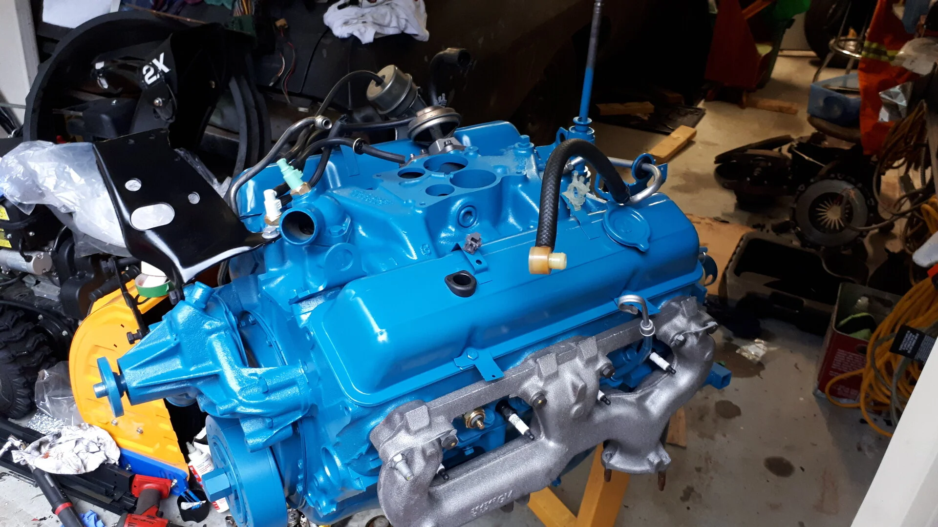

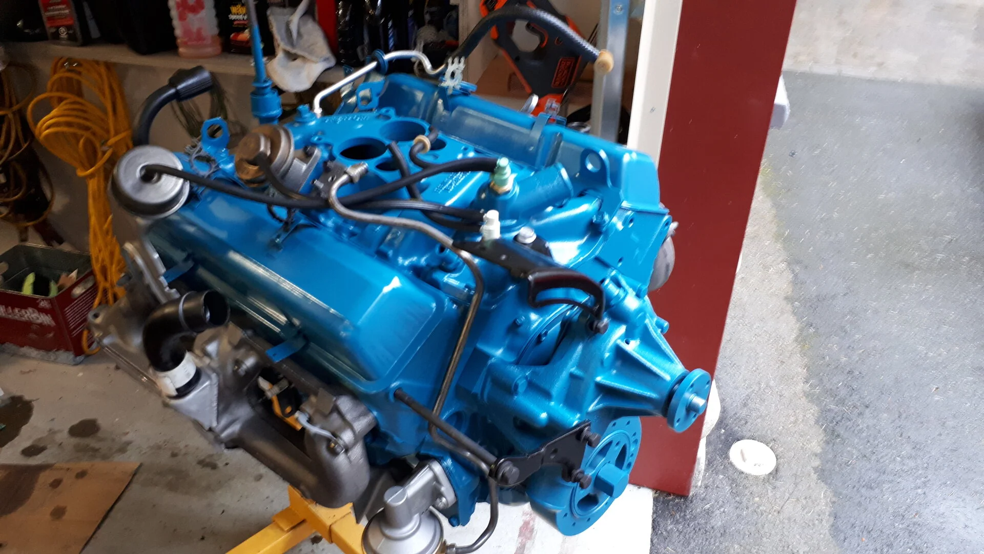

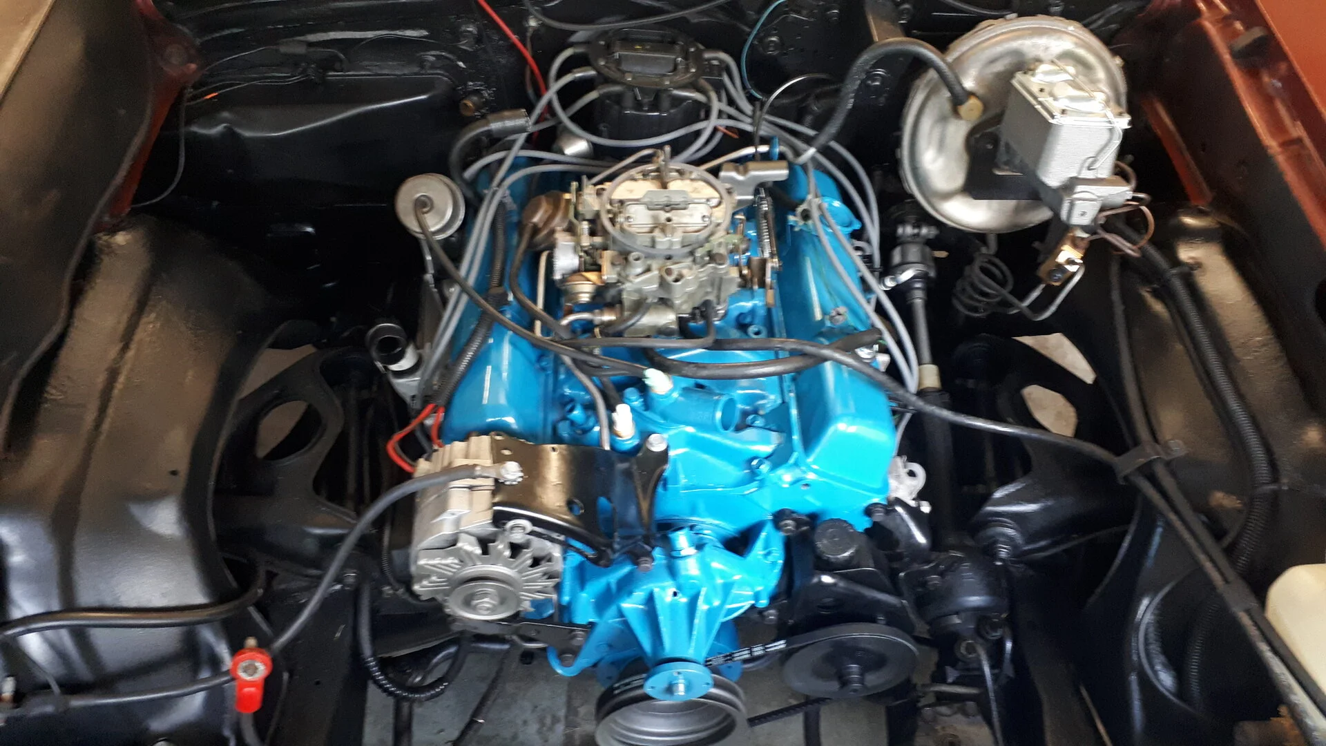

Yeah, the engine ran absolutely perfect when I took it out, so the Q-Jet was tuned well/happy.
I'm not too worried about the EGR affecting performance, it's just the engines look so much better without all the hoses, pipes, sensors and valves.

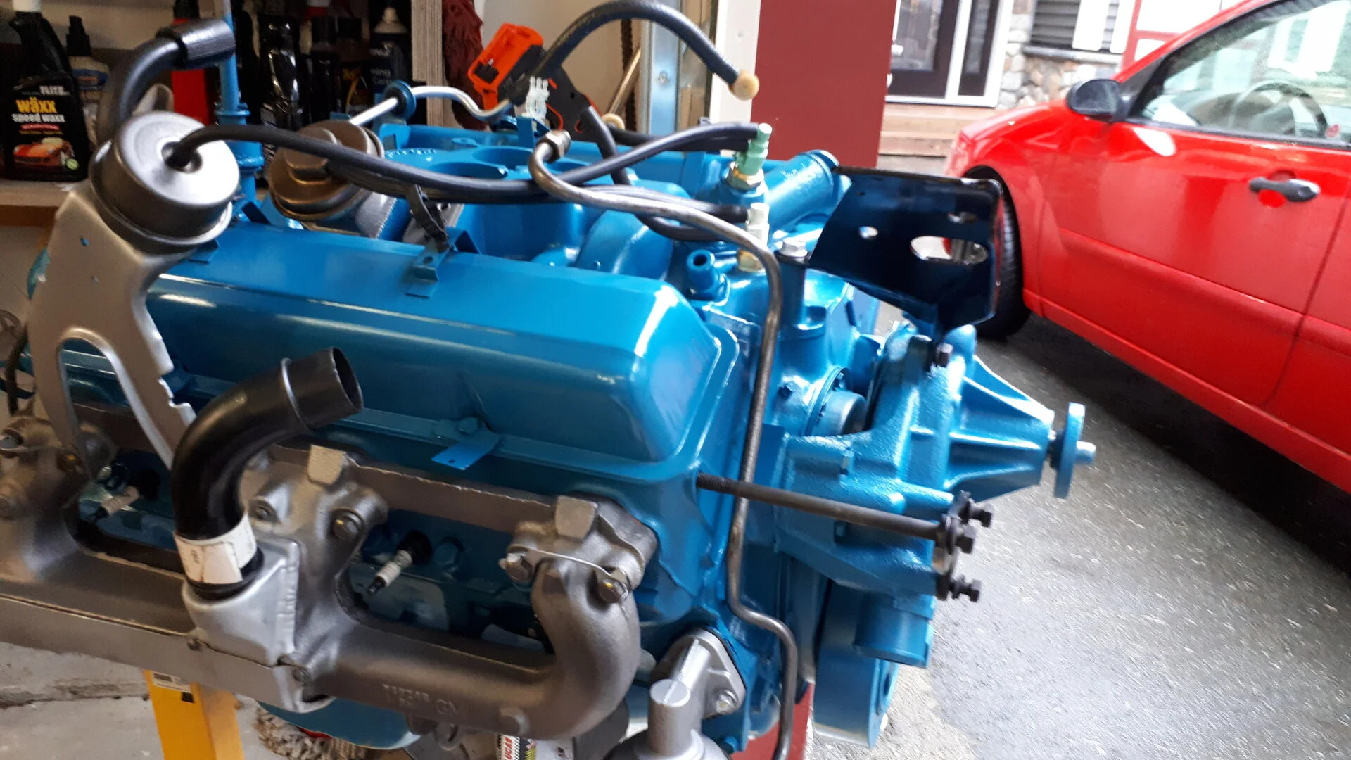

Today I replaced the hard crumbly valve seals which are a joke on SBC engines. ....Found a slightly bent pushrod so I replaced them all....
I usually have aftermarket heads and positive valve seals which are much better when you're using bronze guides. In this case I have cast iron guides and little rubber o-rings lol. hope to have some progress pics tomorrow.

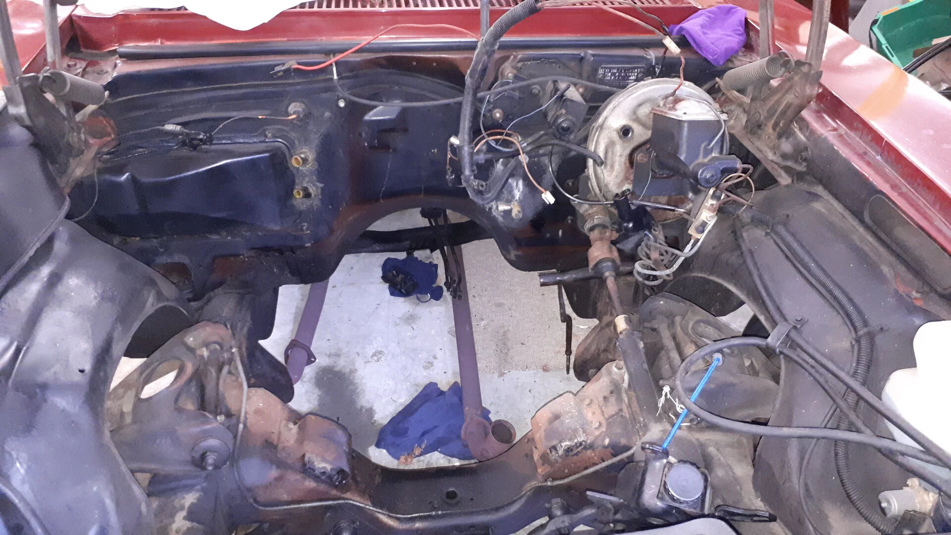

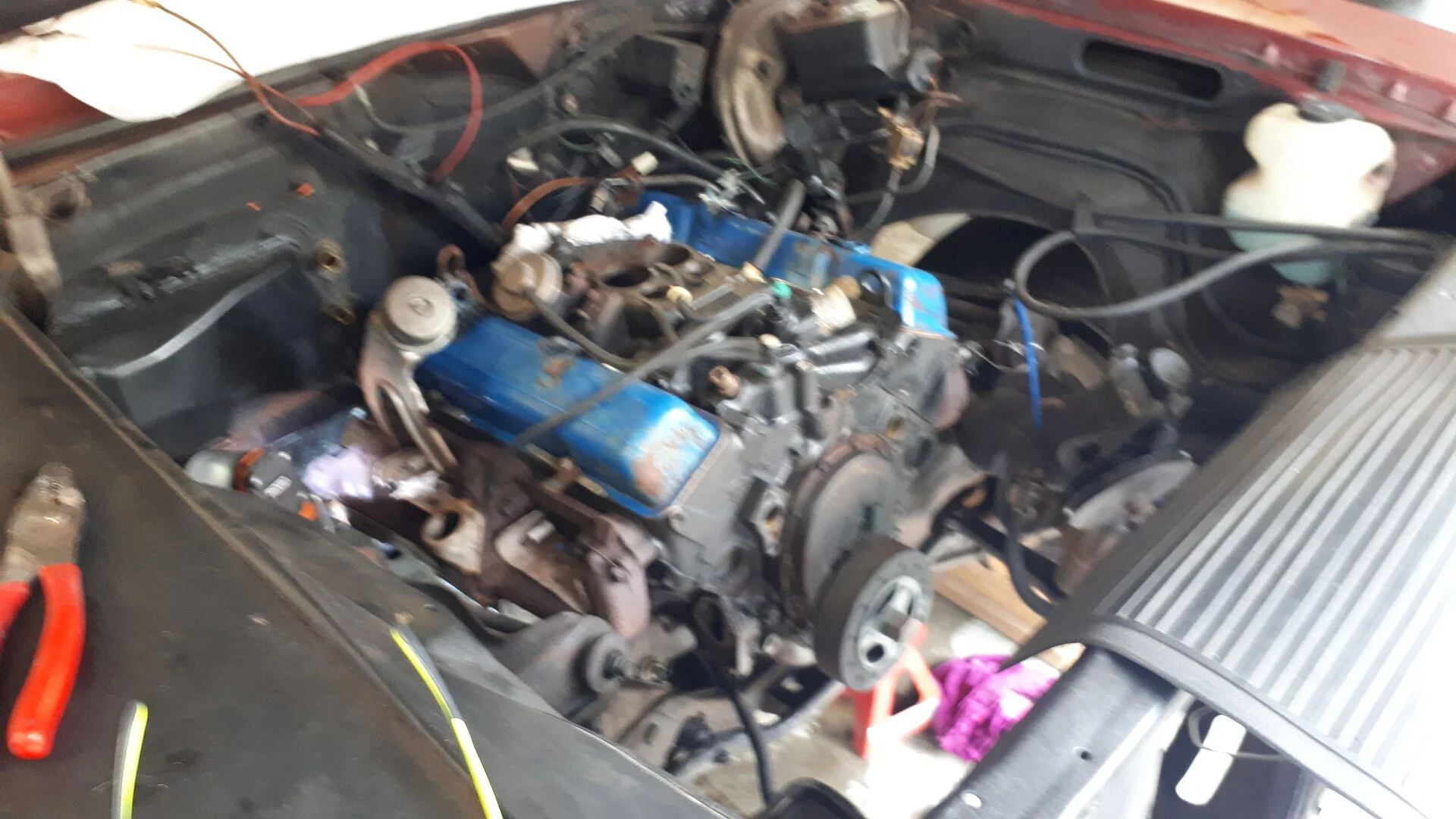

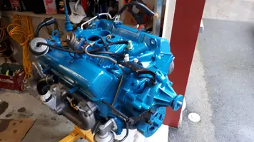

Ok here is the before pic (what I started with)

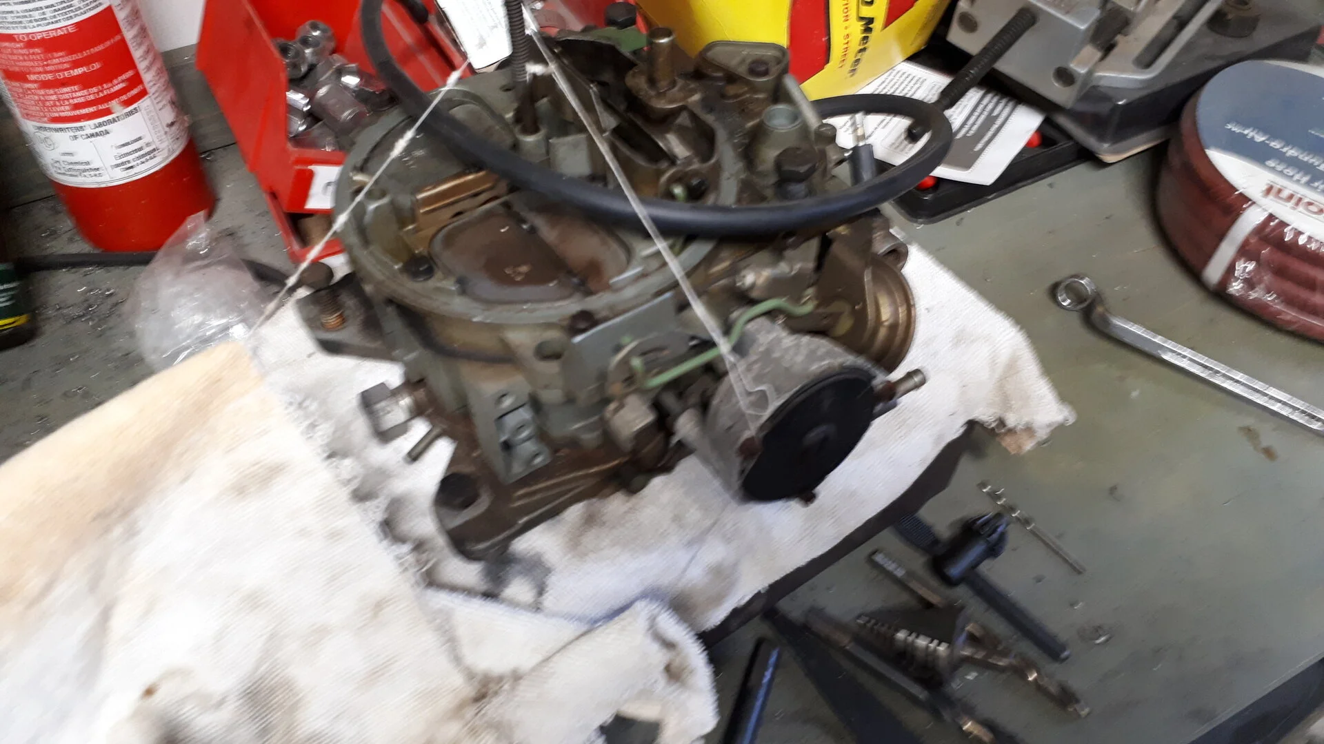

So time consuming.... have the carb to restore next.... and the engine compartment to clean and detail. Still waiting on my transmission gaskets to arrive. It takes 2 to 3 weeks to get any parts now from the U.S...

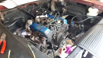

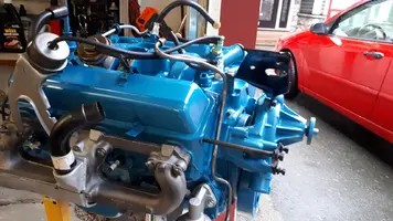

A little Mustang update in the middle of Nova job.
Ordered my electric fan and water pump controller and water pump from Davies craig, It was cheaper to get it out of Australia. So.. package arrived sort of temporarily.., we use community mailboxes here so when I get a package they are supposed to put a door tag at my house so it alerts me to pick up at post office. I don't go to the mailbox very often, maybe every two weeks so I go there and the door tag and notice card are both in the mailbox. I go down to the post office, and they say because I never picked it up in time they sent it back to Australia. Yay. So because of their screw up it costs me now another 100 bucks and two weeks to get it back.. grrr.
Also I figured out the output for the adapter aims the lower hose spout at the wrong side for the rad i have..oops...well It's not like I haven't modified anything before lol..

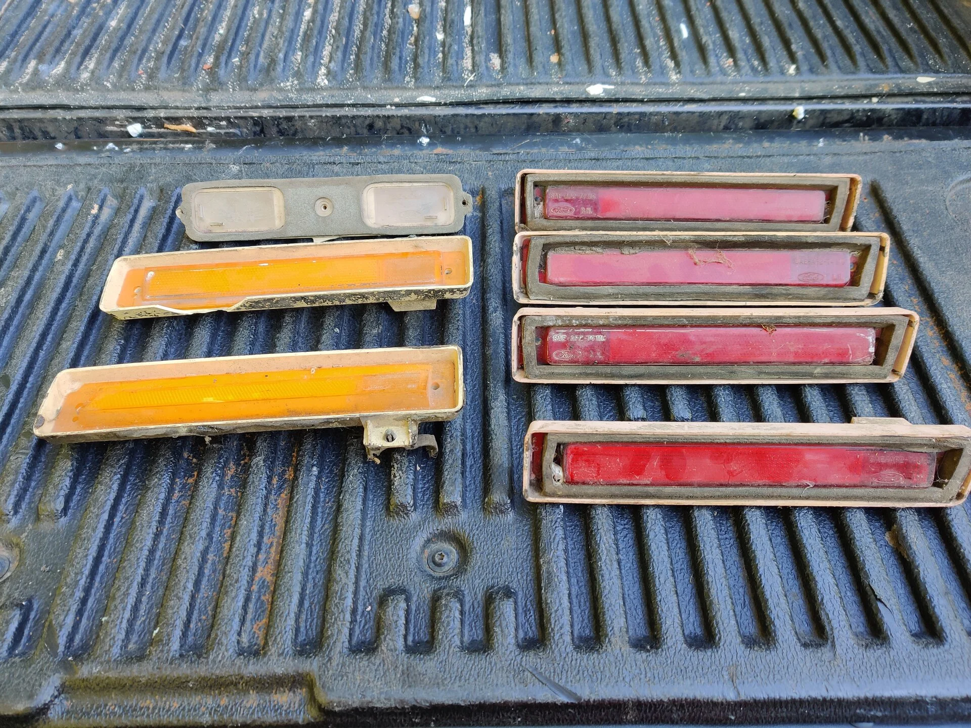

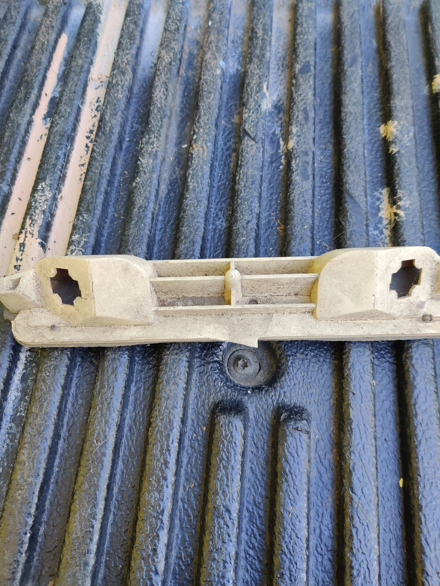

Quick question: I can't remember if it was you asking or someone else - but were you looking for marker lights a while back? I have 2 pair of rears, a pair of fronts and a license light sitting here doing nothing. The license light looks like it has a tab that's broken off, but I dunno what the tab's for anymore. :shrug:
Reactions: 2Blue2 and Enzio
Hey, there, yes I was looking for the "chrome bezels" or trims. I have the actual lamps. The chrome bezels I do not have because my car had the bulky side molding style which I deleted...
Reactions: LILCBRA
I knew someone was asking about something to do with the marker lights! Unfortunately I don't think I have the trim anywhere. I'll try to remember that you were asking if I run across any of that stuff while I'm moving everything around and clearing stuff out. Maybe I have them somewhere, I mean I didn't remember having the lenses..... :shrug:
Thanks for keeping me in mind!!!! :)
Reactions: LILCBRA
