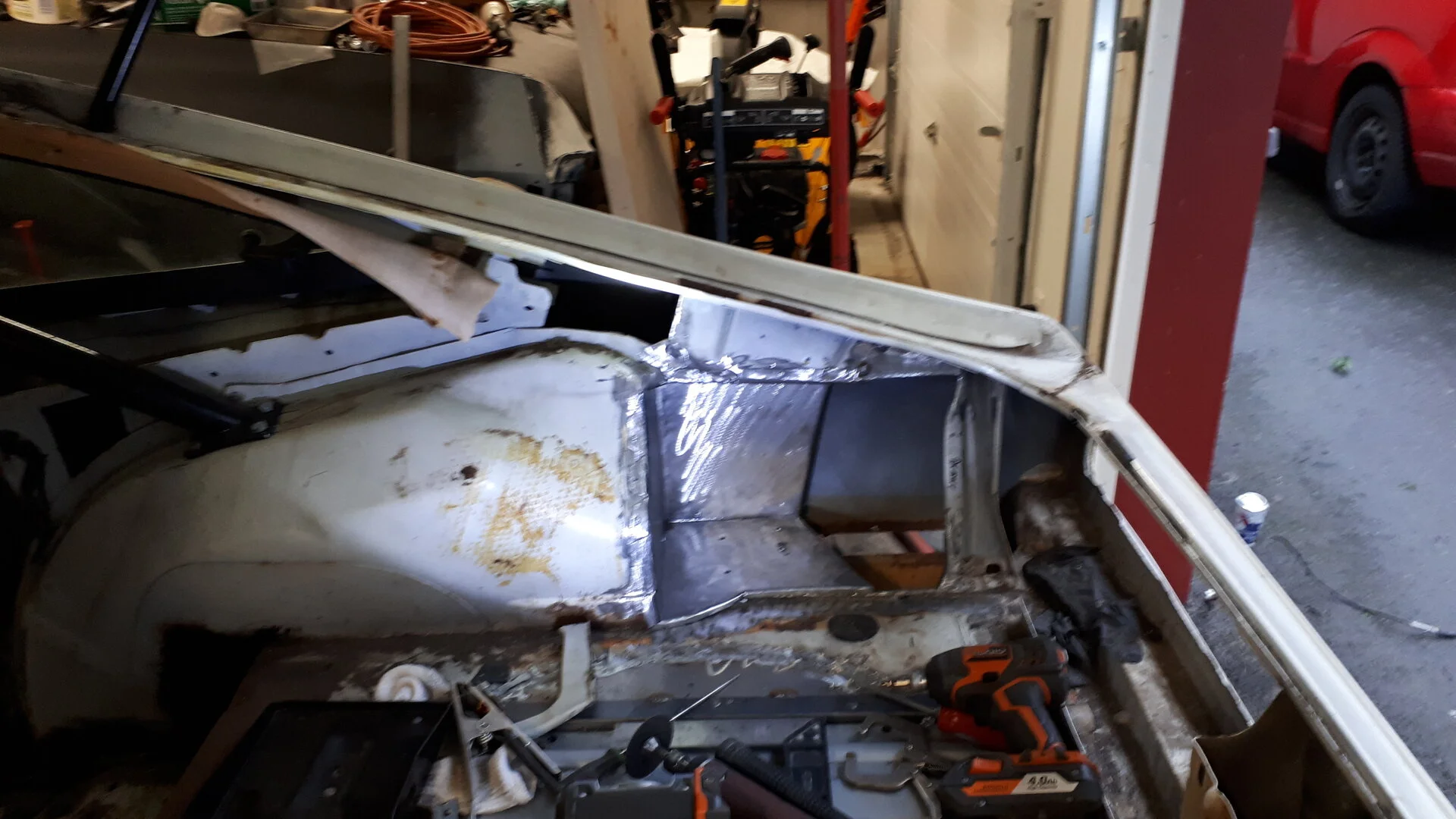

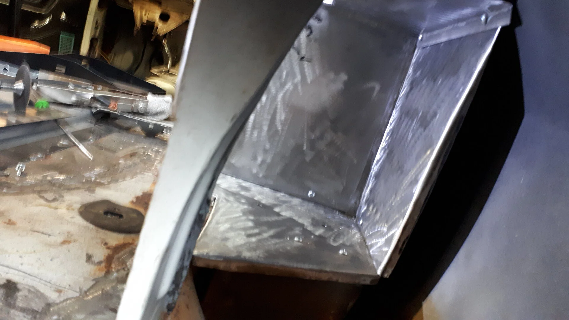

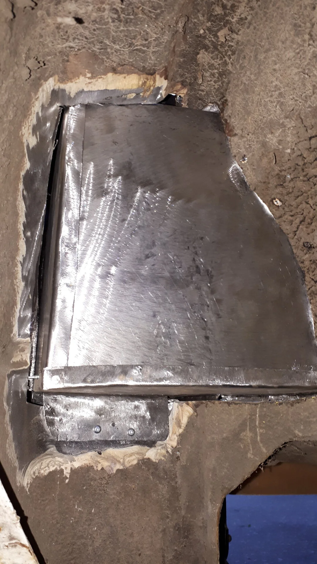

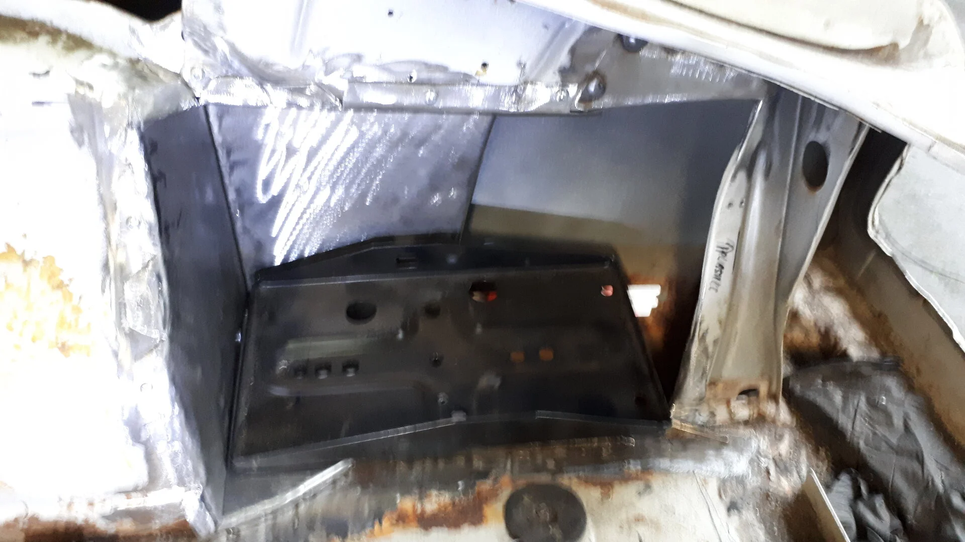

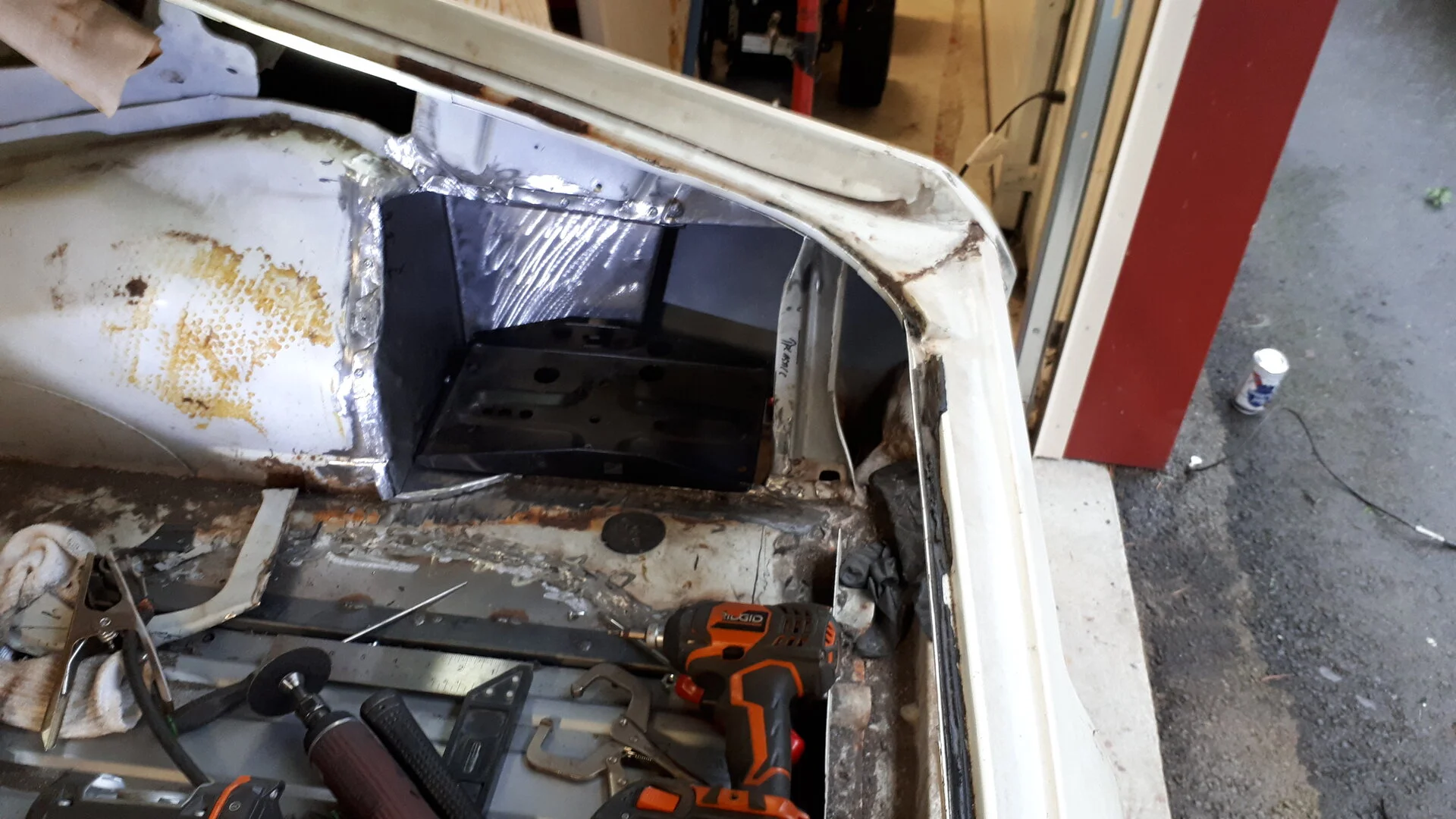

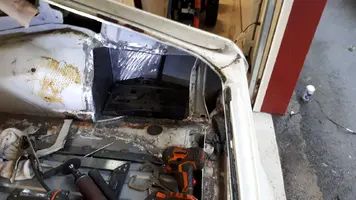

Finally have battery area roughed in. A lot of metal banging lol. Nothing really welded yet except the small patch at the back. Didn't really protrude into the wheel well as much as you'd think.
I'm going to have to make a few more pieces to fill in around the box in the wheel well, but other than that mostly done rough in.

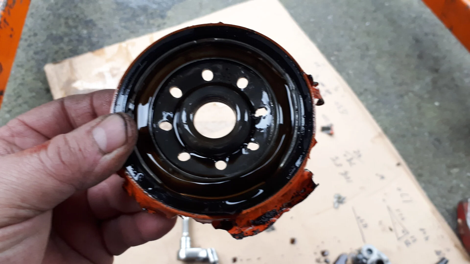

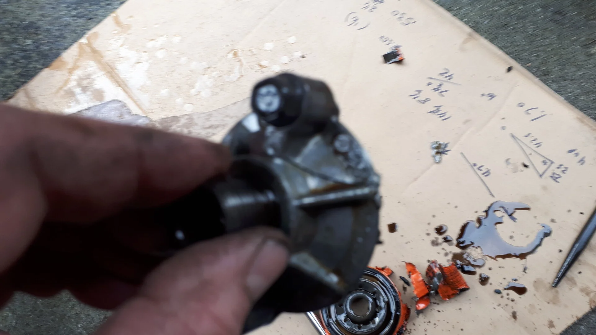

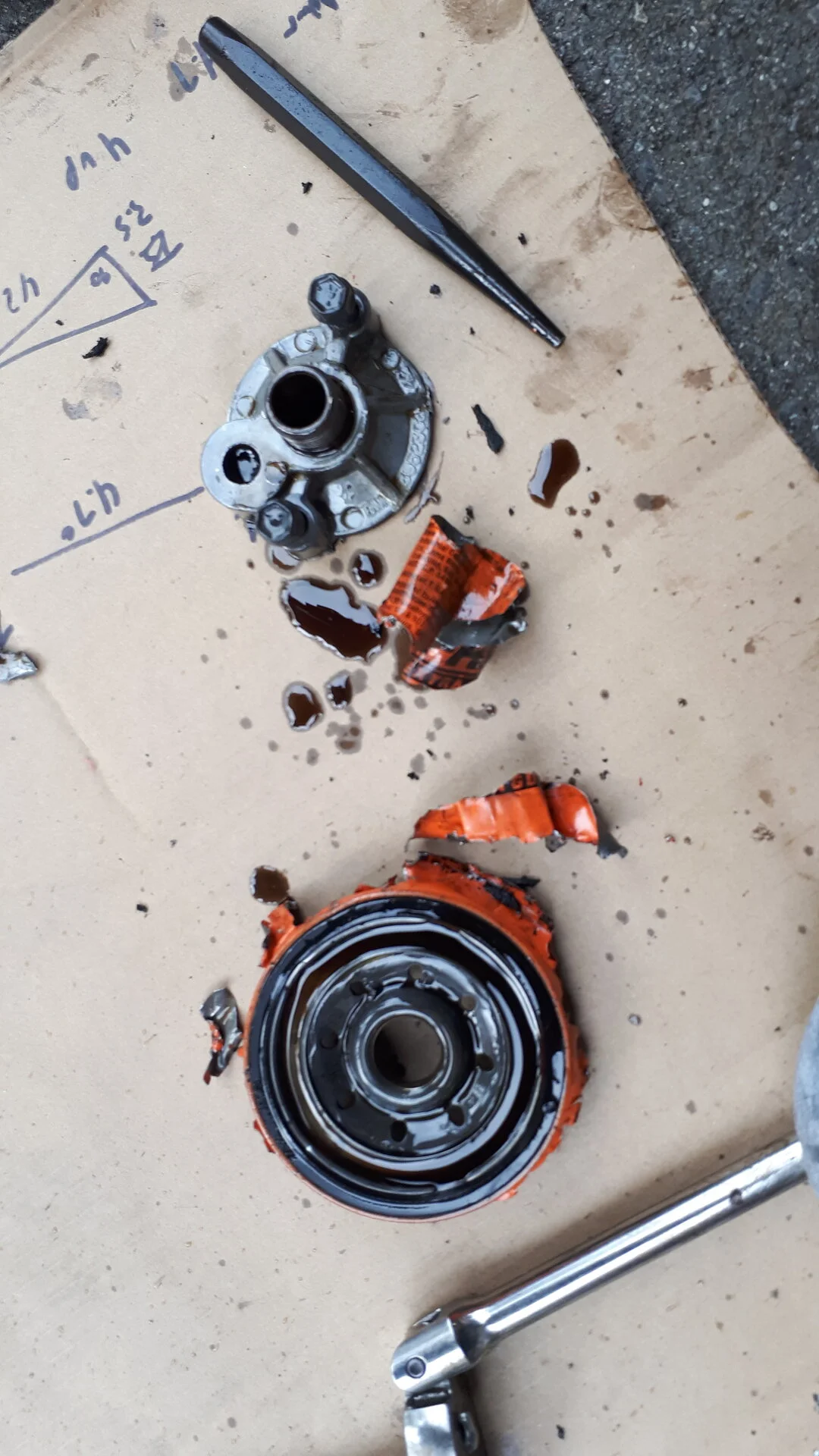

Look what happens when you put a filter on too tight.
Some j@cka$$ tightened the oil filter on so tight, that it squished the filter when I tried to take it off with a filter wrench. Then it squished so far that a filter wrench could not grab it, then I tried the old knock a big screwdriver right through the filter to use the extra leverage and two effective handles to rotate the filter, all that did was shear the filter in two.
I then had to cut off the remaining tin leaving the metal filter base only. an take a punch and a hammer and try to tap it off. That did not work so I got a 3 lb mini sledge hammer and a pin punch and beat the crazap out of it and it finally came off.
I am replacing the filter mount now due to the fact that I don't trust it and it looks to have a crack in it. Not sure if that was from the installation or removal of this filter, but I'm sur they installed it with an impact wrench.
I learned two things from this.
1) There are still a lot of people that should leave even simple jobs to professionals. If you don't know how to install a filter, don't, and if you aren't an electrician, do not install your own baseboard heaters. There was a guy at the hardware store the other day wiring in heaters and he was asking me what the white wire and black wires meant.
2) Fram filters are garbage, and are paper thin. I chucked the media parts, but let me tell you it is a crap product, very lacking in quantity and substance, and the metal casing is paper thin. I can crush one with my bare hands.
I am exclusively using Wix filters myself now (Napa).

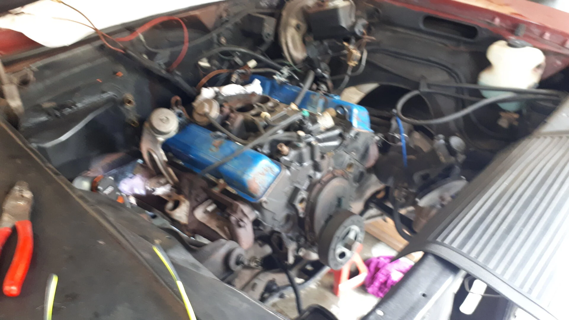

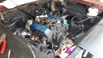

So, this filter debacle is part of my Nova refresh. For those interested, some time ago I bought a 1977 Nova 350 4Spd. as a cruiser. It has 77k original miles and has all it's original drivetrain etc. Bucket seat, console, gauges, F41, so really nicely optioned.
It needed some cleanup from lack of direction by earlier owners, so I am removing the drivetrain to re-gasket, re-seal and maintenance/ wear items such as hoses, filters, timing set, oil pump etc. will be replaced. The thing ran like a top, but leaked everywhere.
Also,somebody spray bombed the engine black, and I want to return it to original blue.
Engine is now out and on a stand, replaced the timing set already, next is oil pump and rear main seal.
Also found out why the trans was leaking oil so badly was that some idiot overfilled it as well.
Sorry for pic quality. It's time for a new phone....... I have chucked this one across the room too many times now....:rolleyes:
