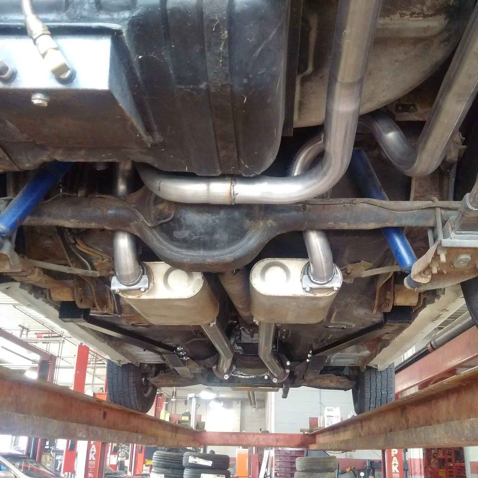

Got a 65 mustang gas tank. This will take up less space in the undercarriage and make space for dual exhaust split evenly underneath.

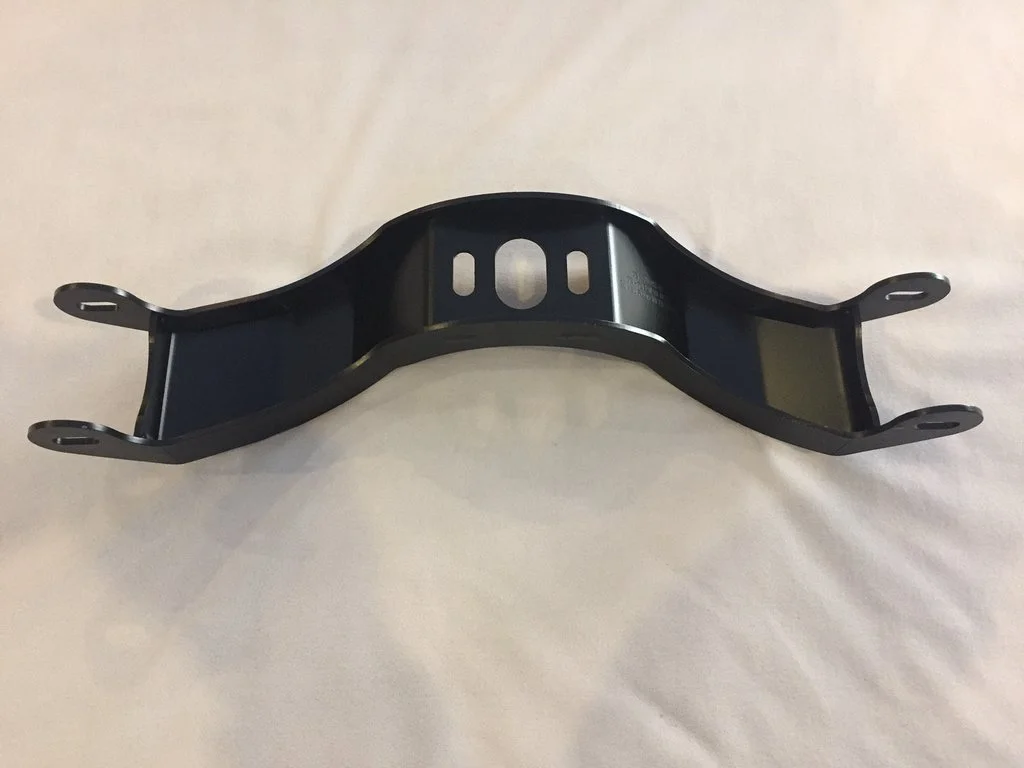

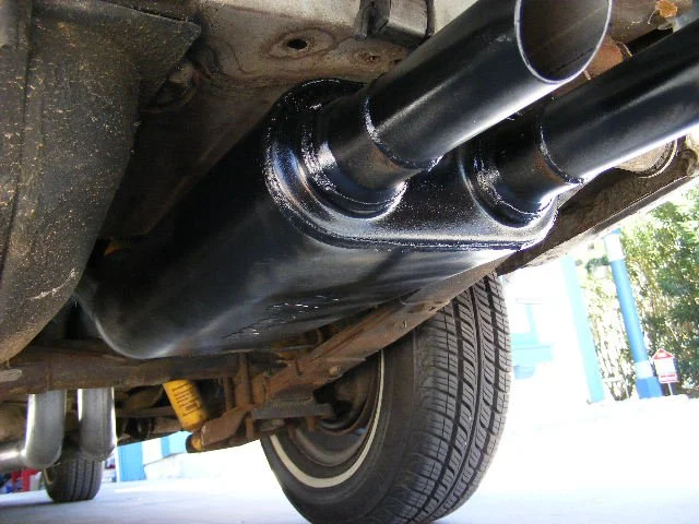

This is interesting, Ive been thinking dual too. So far it seems a double hump crossmember and this muffler was the way.
All on one side. That or side exit.

IMG_20160413_125322.webp 2007_0201exhaustnewIIMustang0002.webp IMG_3825_1024x1024.webp
Unfortunately the Fox tanks are so damned wide!! That's what I installed in my car, there's a video on youtube that I made a few years back for anyone interested, the link is shared here as well. I ended up just running dumps at the axle, if I wanted to run the pipes out the back of the car I'd probably have to have them wrap pretty close to the tank and exit through the spring shackles, or somewhere very close to it! Running the Fox tank allowed me to keep the spare tire well and not have to make any modifications to the body to speak of. :) If you decide to watch the video I'm gonna apologize now!! My narrative skills kinda suck!! lol

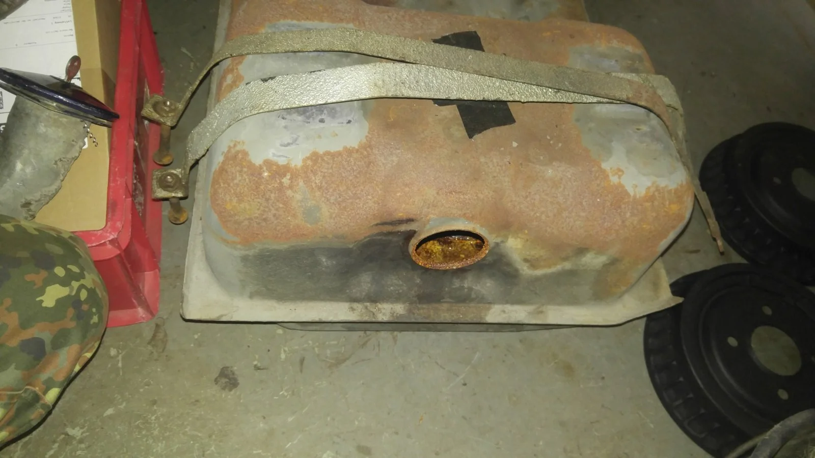

Your absolutly right. I checked my tank and the seal...
That bead on the tank that holds the seal is quite thick. I think that removing this section from the old tank and welding into the "new" tank whould be the way to go.
Here is a picture:
Reactions: 2Blue2
That is exactly what I did with the Fox tank. The Fox car's filler tube is a little smaller than the II's tube which necessitated the change for me. As you can see in the video, I kept the auxiliary fuel tank in the quarter panel, so I needed the proper sized hole for everything to work. The wonderful part about welding the fuel tank and where the filler tube is located is that it doesn't need to look pretty, just functional. As I stated before, I ended up having a little porosity in my welds and I ended up coating the inside of the tank with Red Kote. If you're looking to cut that section from your old tank to weld it onto another, I would advise you to be prepared for that scenario.
