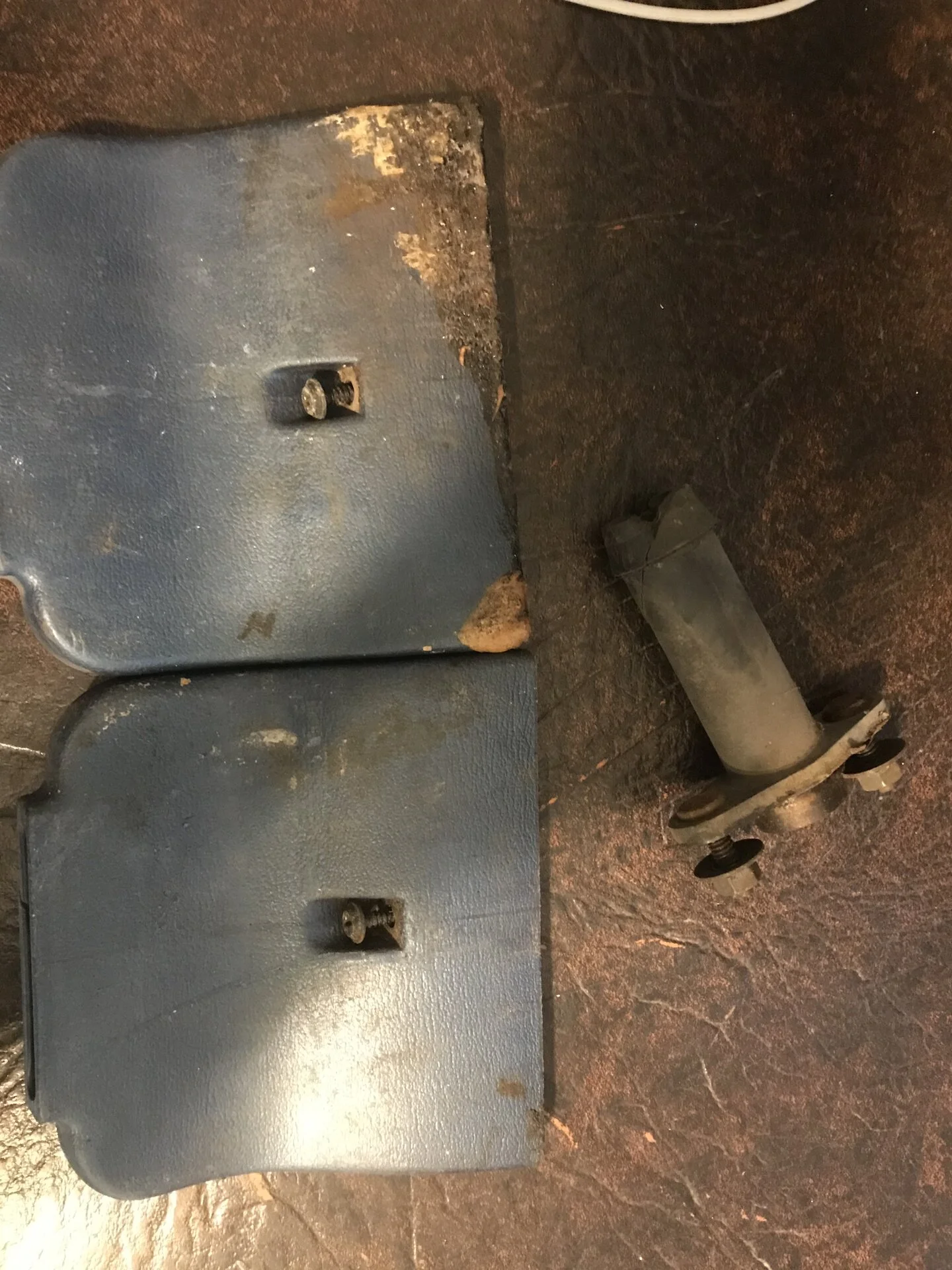

@2Blue2 here is what I got today. 46 degrees, cloudy and windy so it was a good day to be at the salvage yard. The clutch tube is...used...as they all are. I didn't realize they were plastic. Other than the teeth being worn, it has a small crack in the tube. Still way better than the one I was using. The seat belt covers are in pretty good shape. Blue with some carpet glue junk that could be cleaned off. Let me know if you're interested. If not, no big deal.
No letters, sorry.
